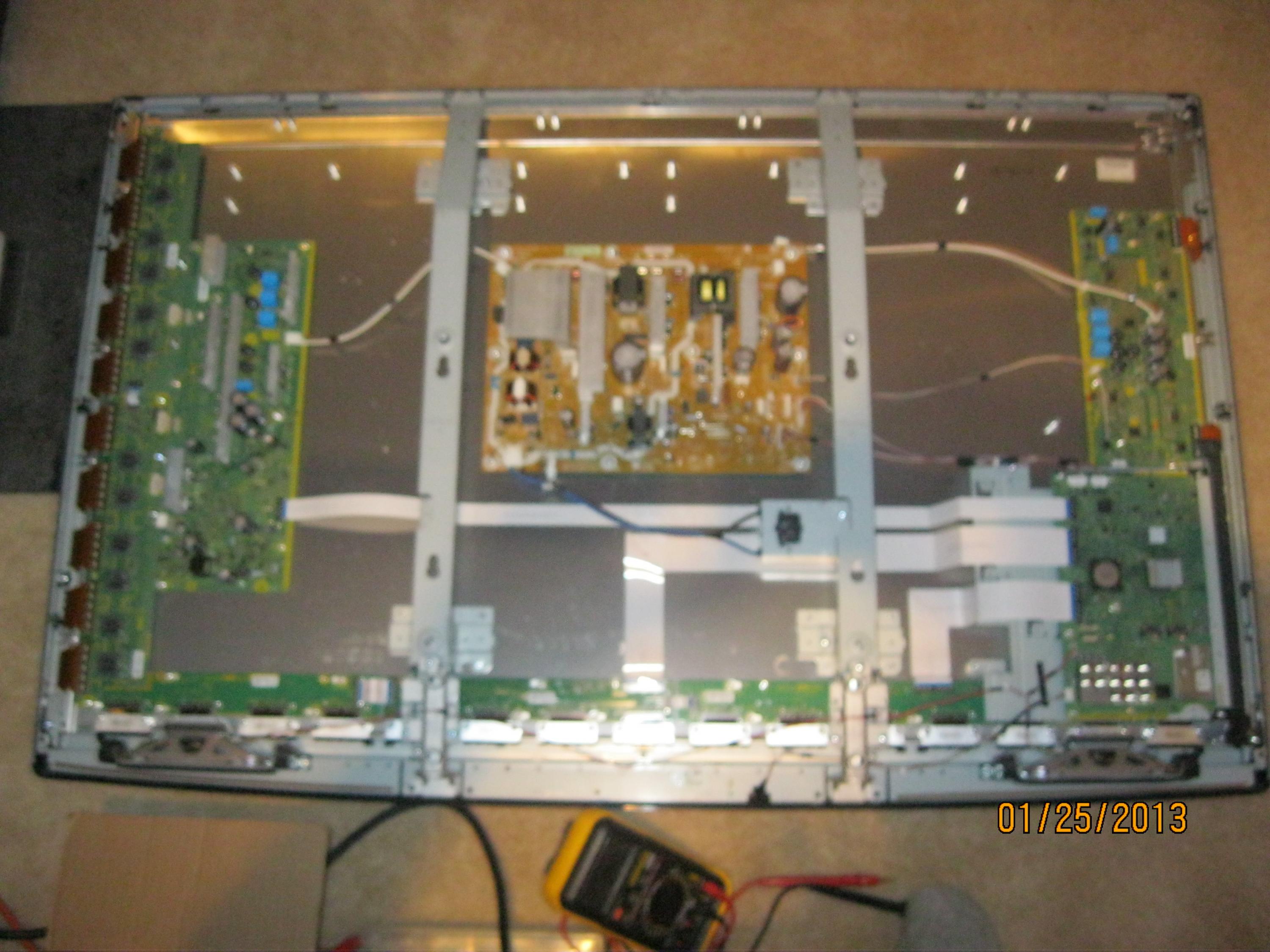

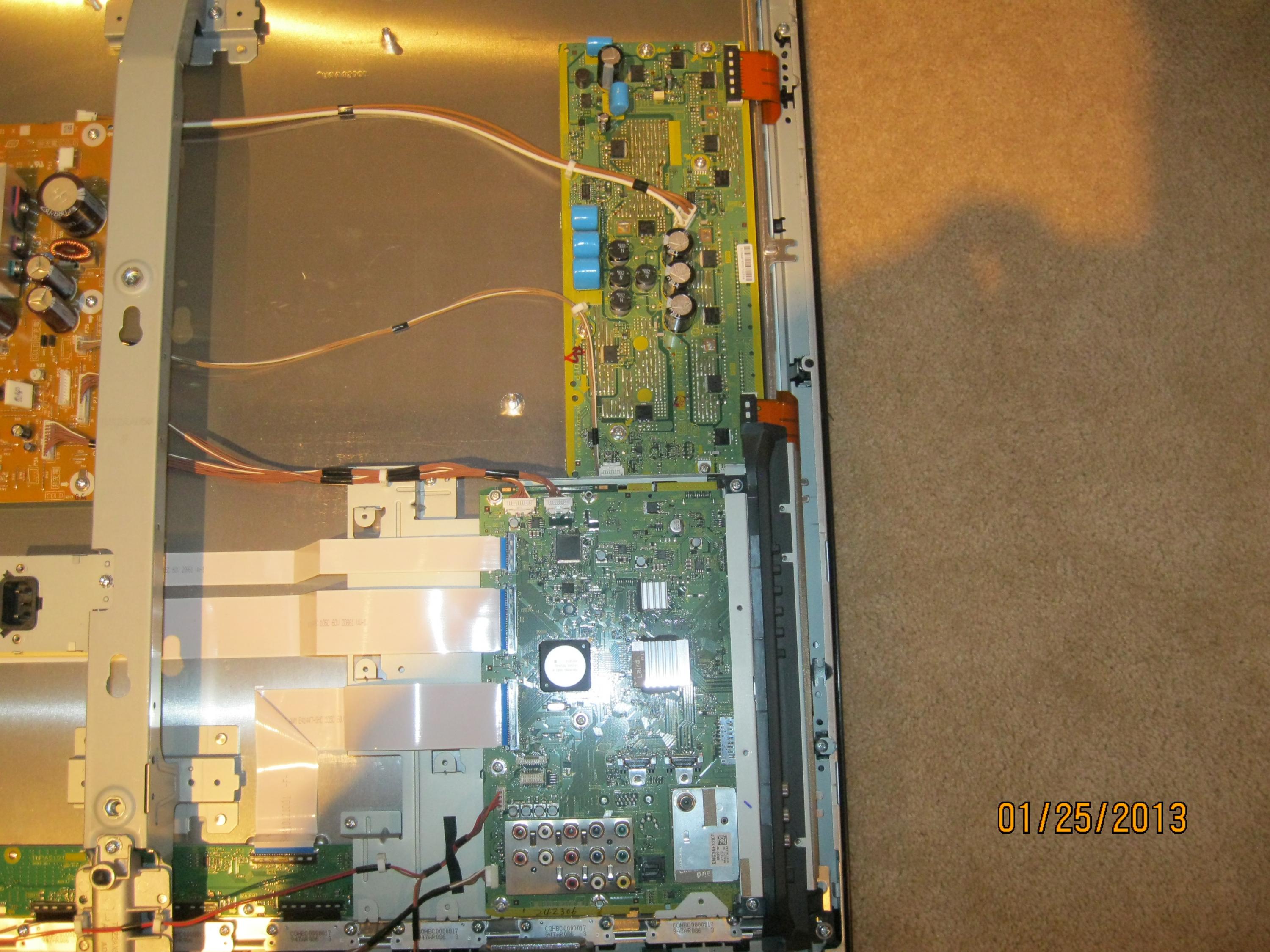

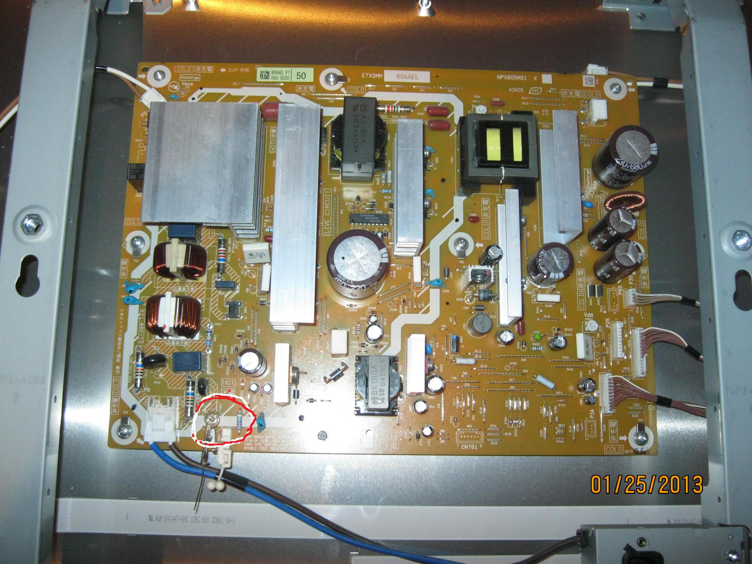

    Blinking red light ,10 blinks.
    unplugged SS board still blinks 10 times
    replugged SS and unplugged SC 7 blinks
    SU and SD unplugged from Sc 10 blinks
    There is a white light bulb next to where power in goes to SC board ( circled in Pic 3) does this light light up with power on ?Because it does not light even briefly when power cord plugged in or power on button pushed.

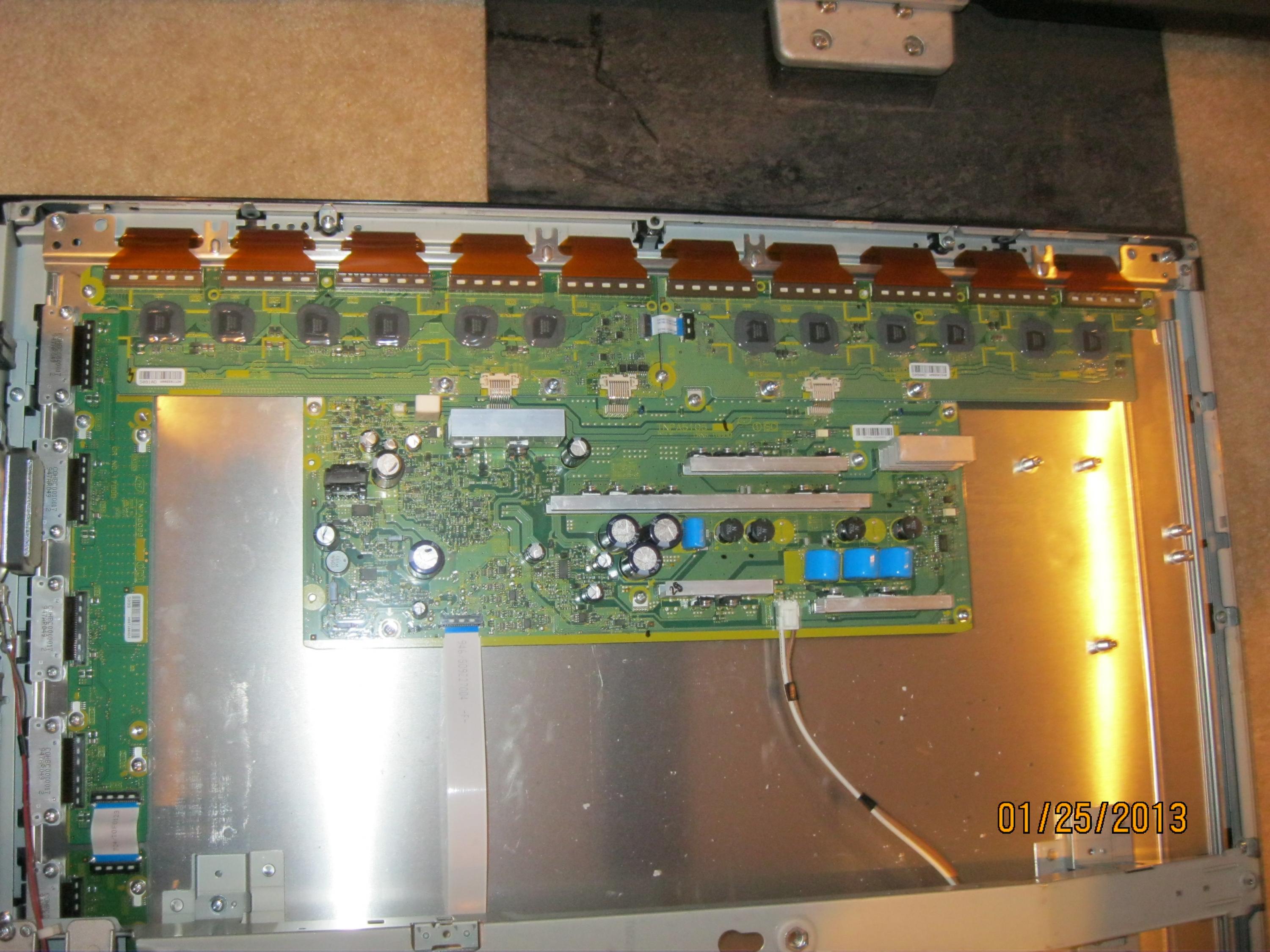

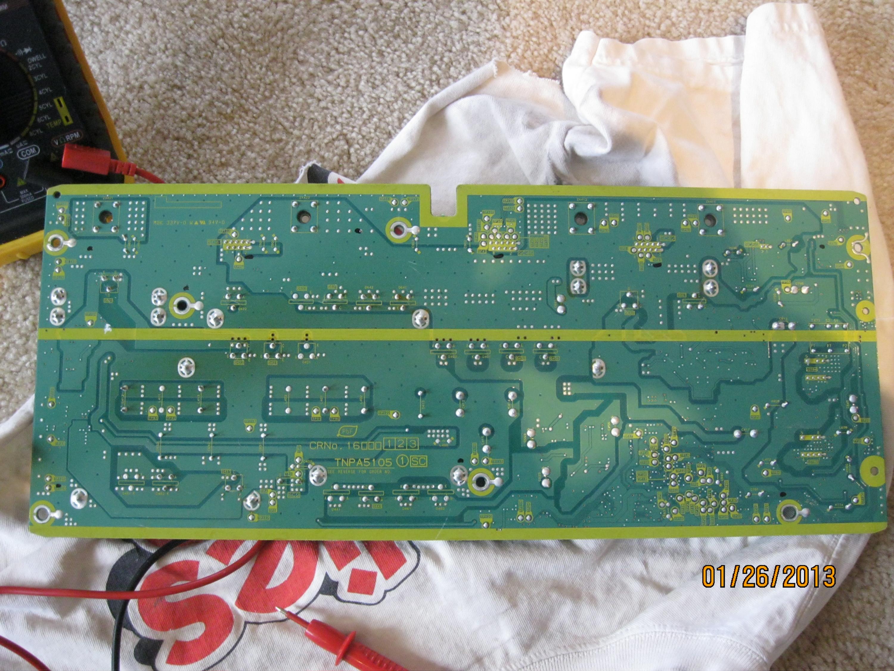

                      Hi Tom ,Took the SC board right out for easy testing.Here are the readings i got.
                      1.316
                      .515

                      Have posted a pic of underside of SC board with this.

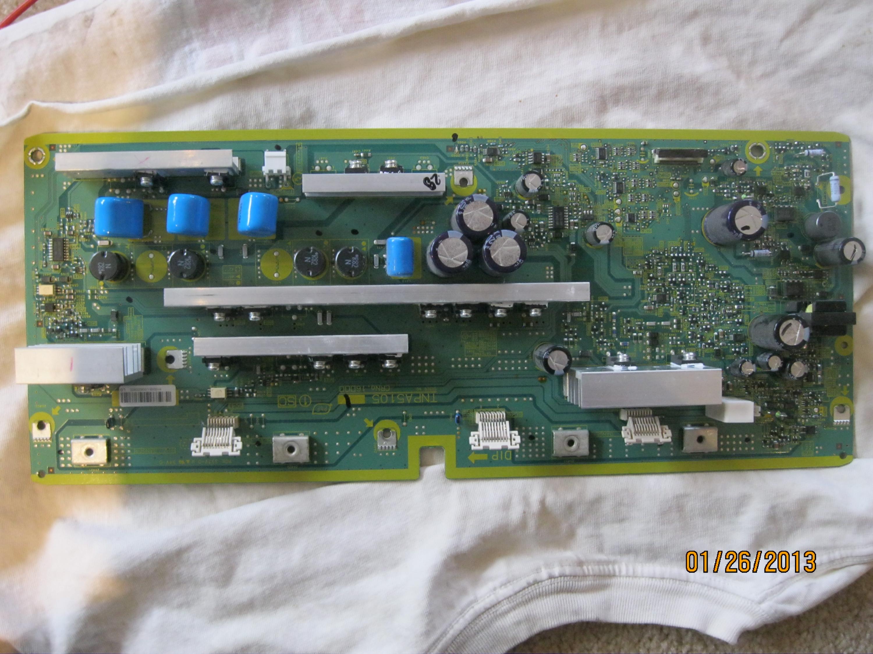

                        here are pics of sc board top and bottom
                          Re: Panasonic TC-P50S2
                          You'll need to remove each of those devices reading near zero (002, 006 etc.) and test them out of circuit.

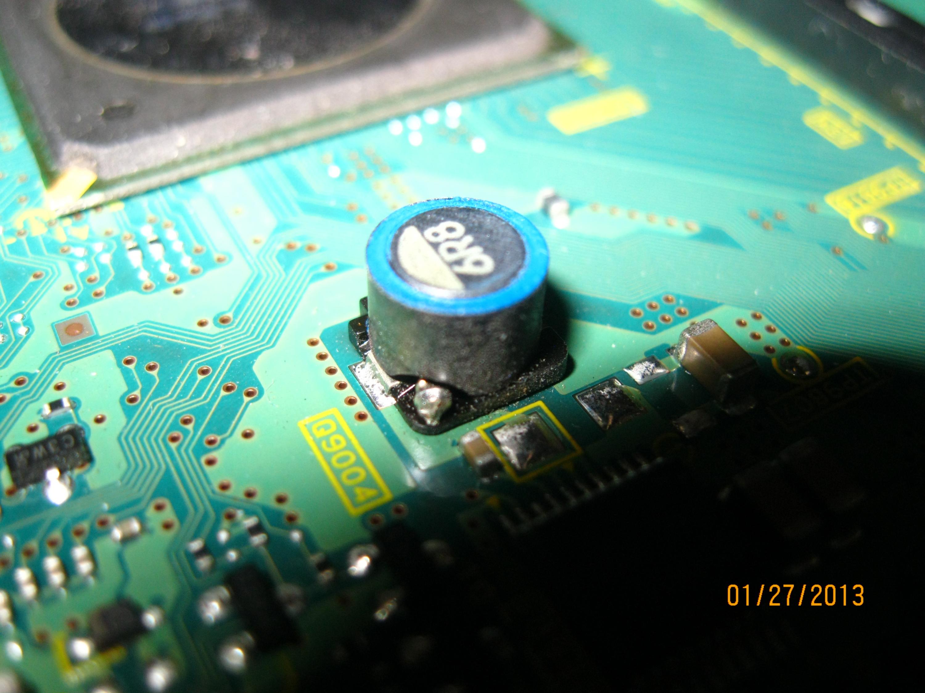

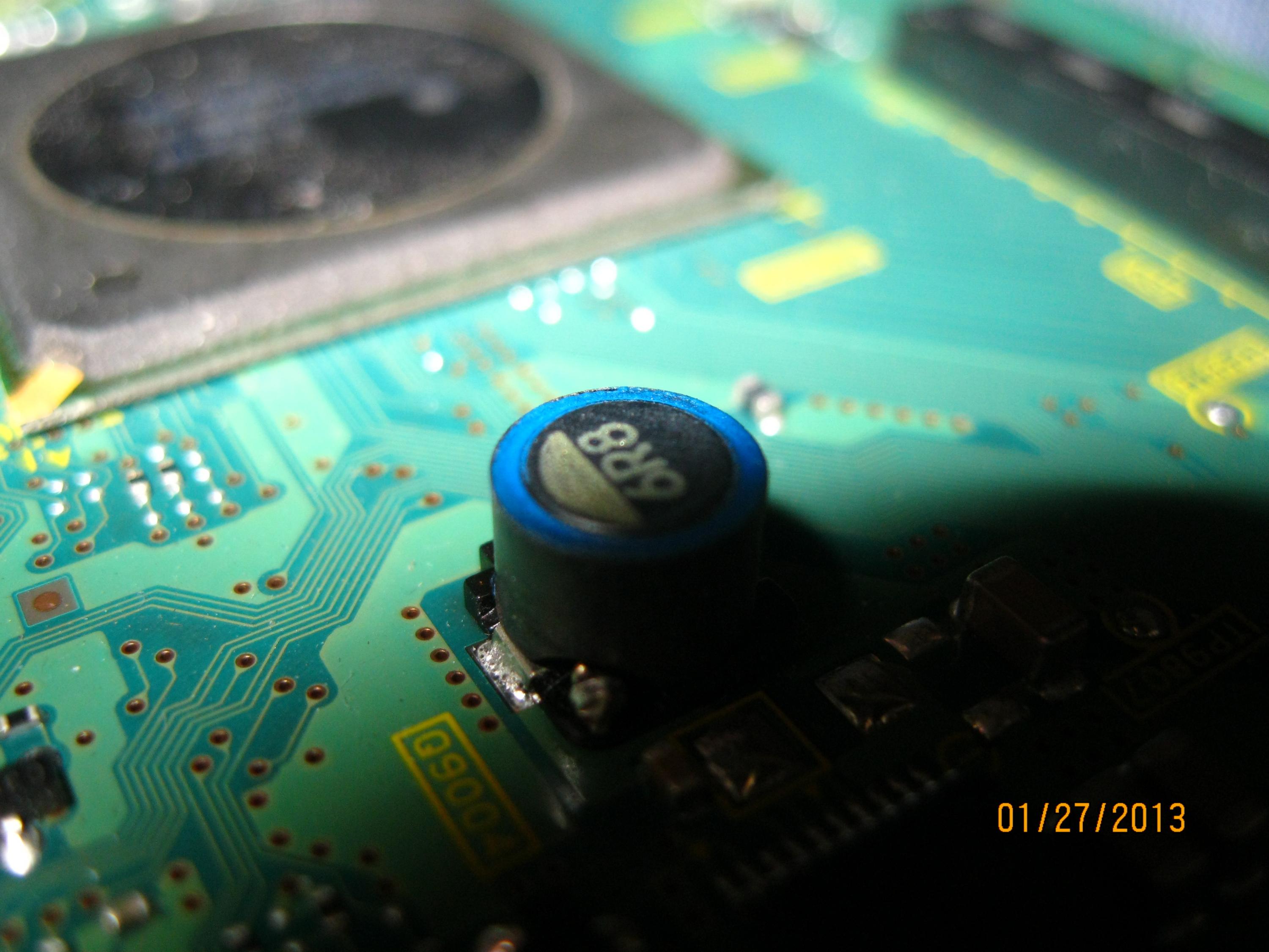

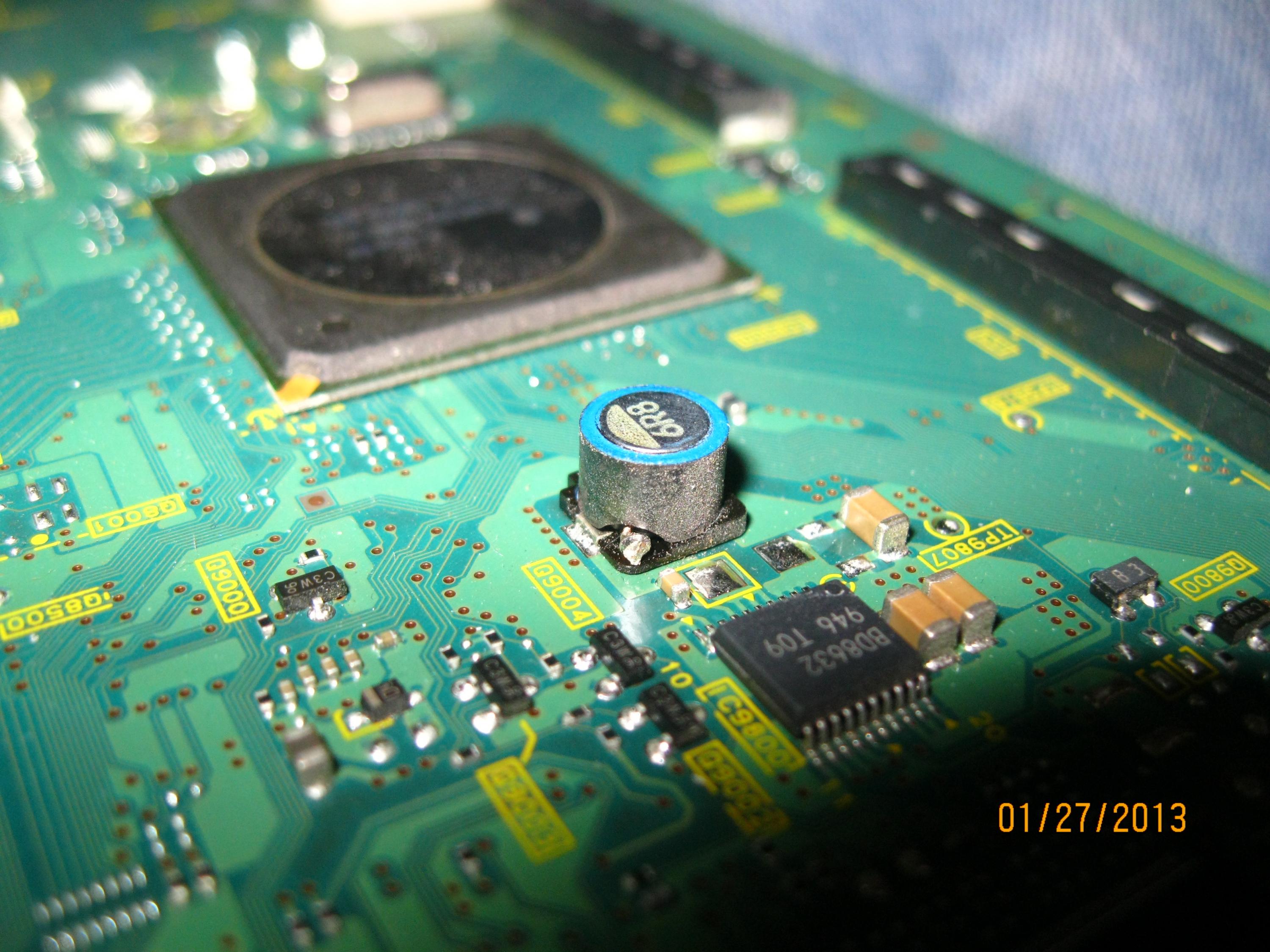

                              Hey Tom have not pulled them from board yet .Did some further testing from Panasonic trouble guide and seems to be problem with the A board.I removed it to look at it and found a funny looking transistor on it. I am posting pics of it can you tell me if its normal to have a gob of solder coming out of it on both sides from the what looks like vents?Thanks
                                That is an inductor, not a transistor. It looks normal to me.
                                  OK thanks Still learning here and have learned a lot from this board and the great guys on it.
                                    Q9004 probably refers to a nearby device or is a mistake.

                                      Hi Tom i have a question on a zener diode.I checked them all on psu and one on psu at z206 in pic 3 in post one reads .707 one way and 1.647 the other wouldn't that 1.647 indicate a bad diode? all the others read .707 and OL the other.
                                      Thanks again
                                        If in circuit, pull it and re-test. If it reads the same it's bad.
