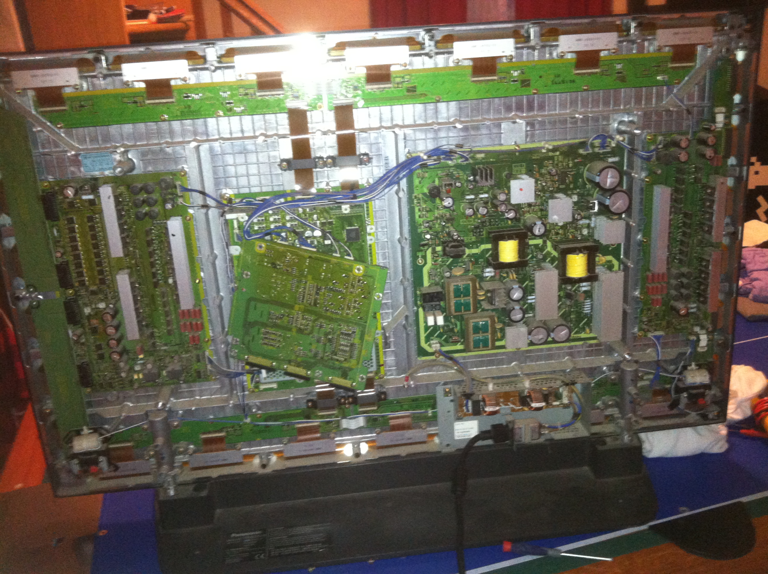

    Found another project to work on and learn from
    Panasonic EDTV Model TH-42PW4UZ
    Symptoms: Unit powers on, you hear a relay click, green LED on front indicates Unit is on, nothing happens on screen at all....? No light no image, no distortion... nothing. I left the unit on for a while and I think it went in to standby mode since there were no inputs attached. The light went from green to red, stayed red steady, blinked 6 times, then steady on the last. I don't think this is an error code since it took a long time for it to do this.
    I am in the process of looking for service manuals now, tip suggestions and etc.
    I know this is an EDTV but for me it is more about the experience than the unit itself.
    I have attached a pic of the unit with the back off.
    I would have assumed some sort of error lights would have given some indication of what is going on, but no luck.
    I did notice there were LEDs on two of the boards (I think SC or SS board and power board) neither of which were lit up (could either be dead LEDs or pointing toward the problem.
    Physical inspection revealed no cracks in the glass as of yet.

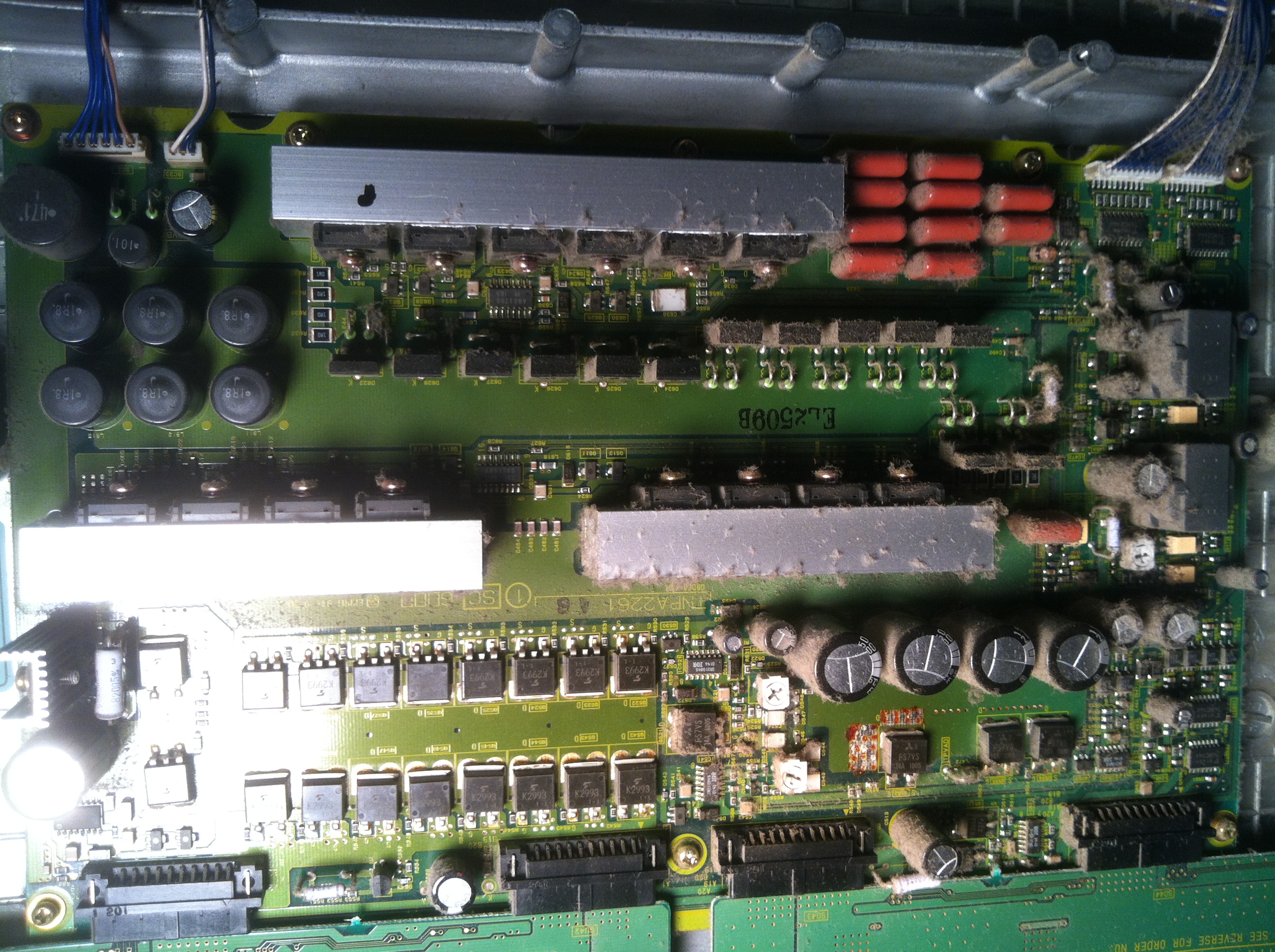

                  Re: Project 2: Panasonic TH-42PW4UZ green light on, nothing on screen
                  OK, can I have a clear shot of the SC board (left hand plasma driver)
                  • nintari
                    • Jan 2013
                    • 29
                    Just were I was moving to next led on sc board is dead. Not much info on testing the sc board so far but still looking gimme a minute to get pic of sc board
                    • nintari
                      • Jan 2013
                      • 29
                      sc board
                      I can get some closeups if needed or upload the service manual I have somewhere

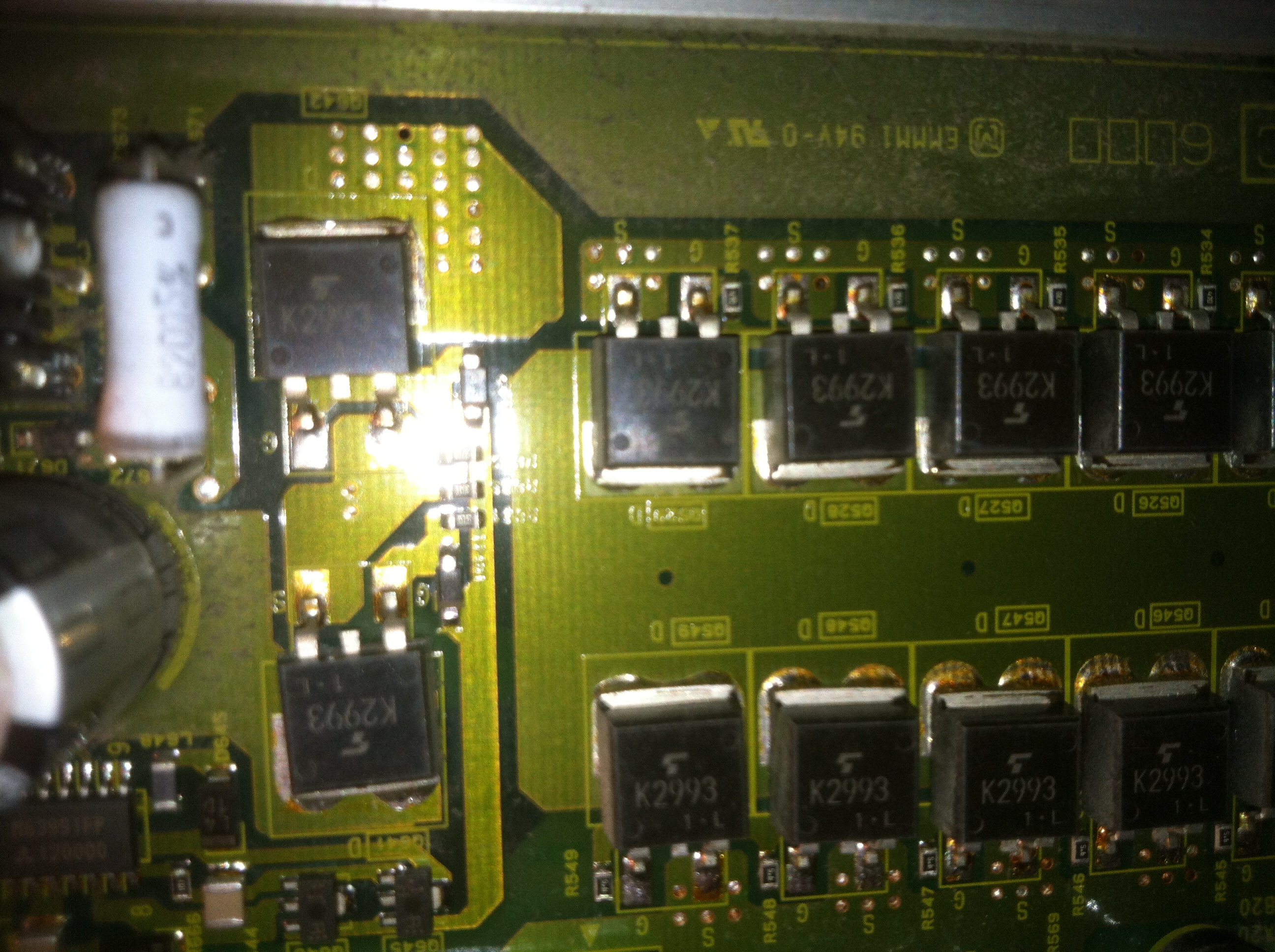

                        6 blinks: Suspect ERC circuit -- If one of those is a 2SK2993/2995 SMD fet you probably found the problem, it's a very common issue with their HDTV sets too.
                        Check those SMD FETs for shorts.
                        • nintari
                          • Jan 2013
                          • 29
                          Yes getting odd readings from a few of them
                          In particular the one pictured in the lower left (picture rotated on upload) is reading 159.9v out while all the others were at 13.9v.... but now none of them are reading out.... not sure if I accidentally shorted something or if something overheated further lol
                            You should be measuring with power off.
                            They are all in parallel and one usually likes to short.

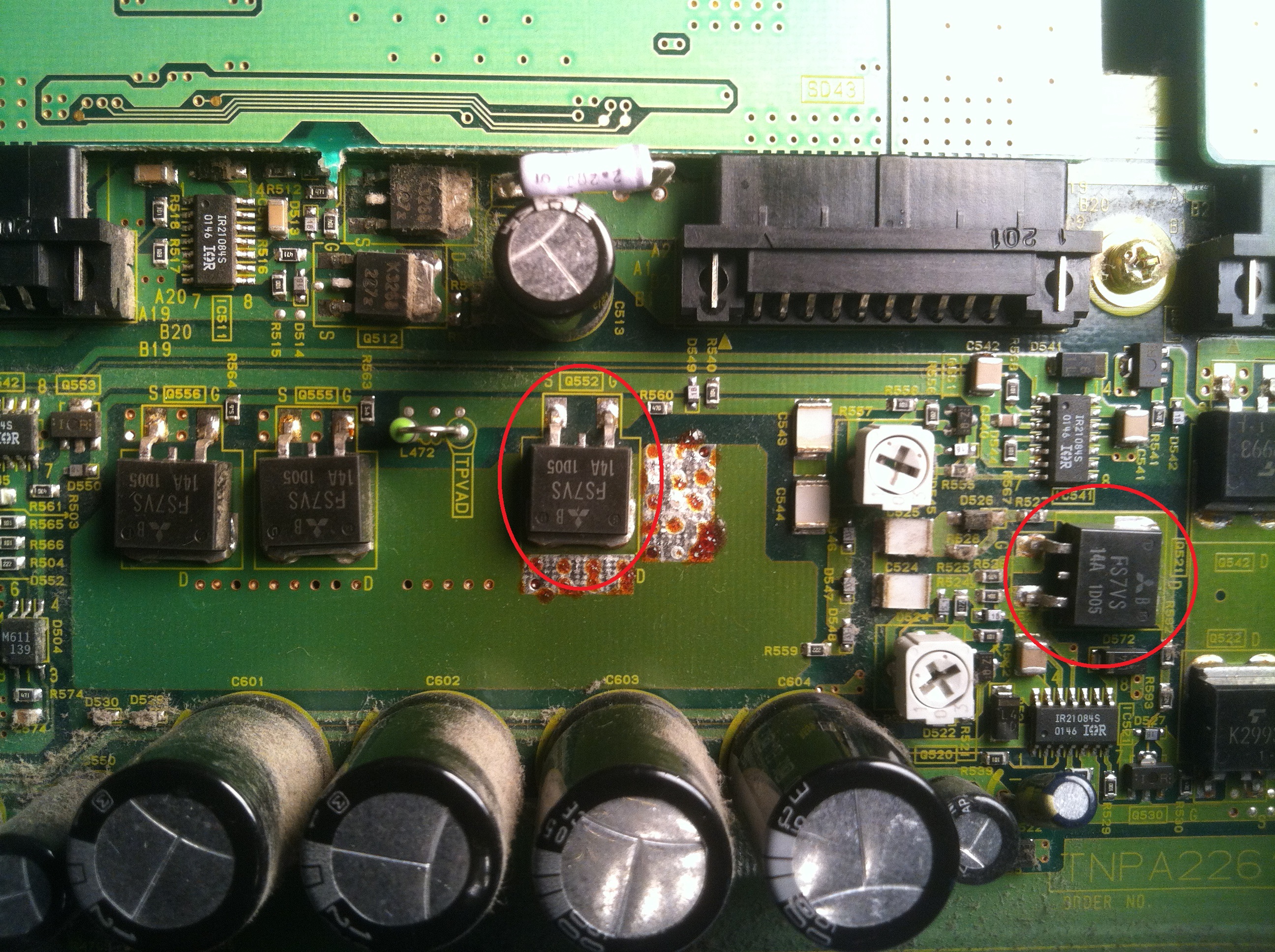

                                        Spent time last night and this morning trying to learn more about these FETs and testing
                                        I went a bit further down and found the following (pic attached and components circled in red)
                                        again still trying to learn so I may me measuring wrong
                                        Mitsubishi MOSFET FS7VS 14a
                                        The two circled ones with meter in Diode test mode
                                        Red on source black on gate I get a reading of 653 on the meter, the others not circled I get OL on meter
                                        would that indicate these are possibly shorted?
