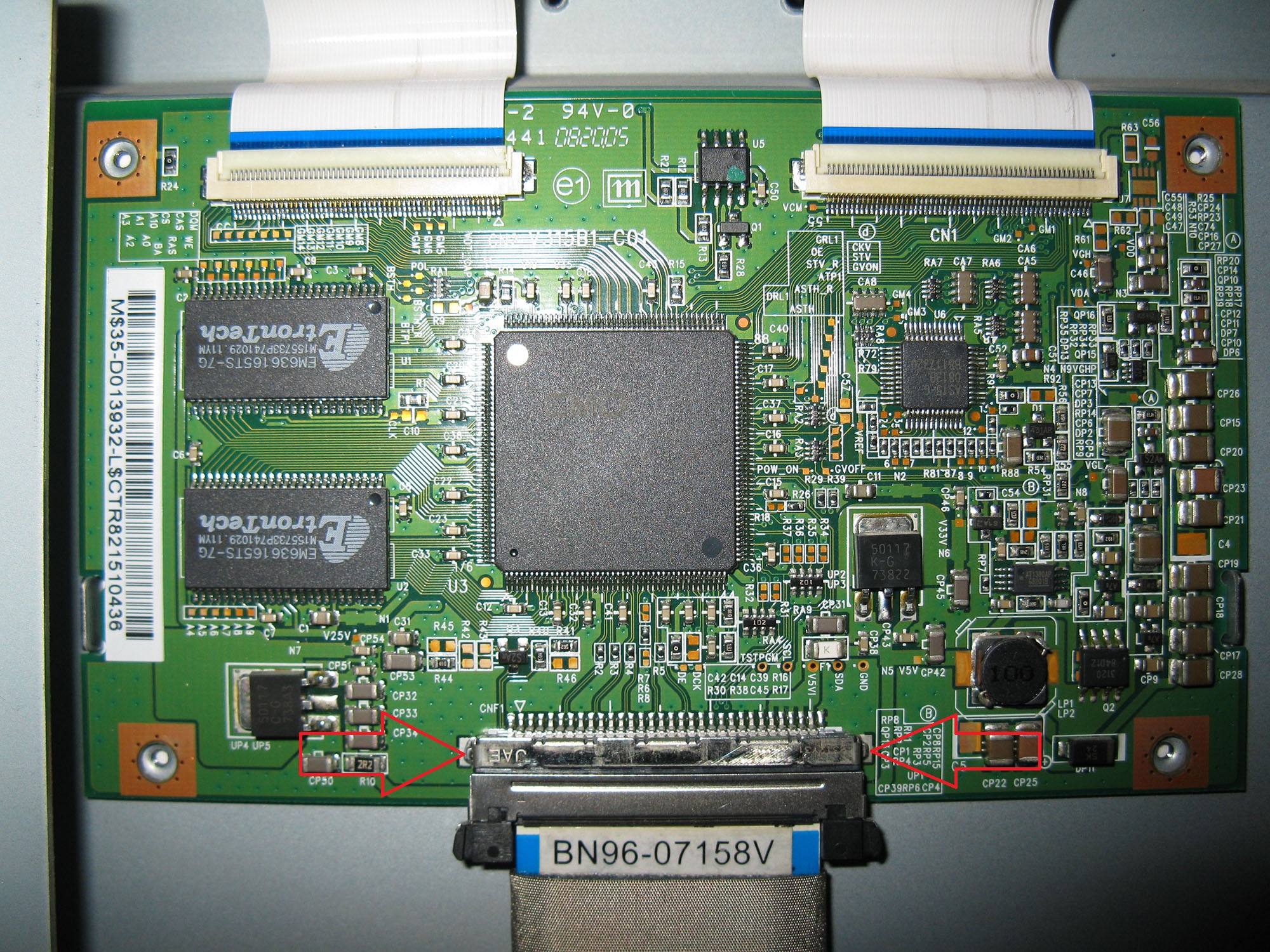

          #44
          Re: Samsung ln32a330j1dxza - faint white screen
          Originally posted by wheatfield
          Actually, I was just thinking, if the video corrects itself when I create that ground, does it mean that the board itself isn't grounded properly?
          Just try to make a better connection of those points I have marked in the picture. Just do it with the soldering iron(re solder them) Sometimes it helps.
