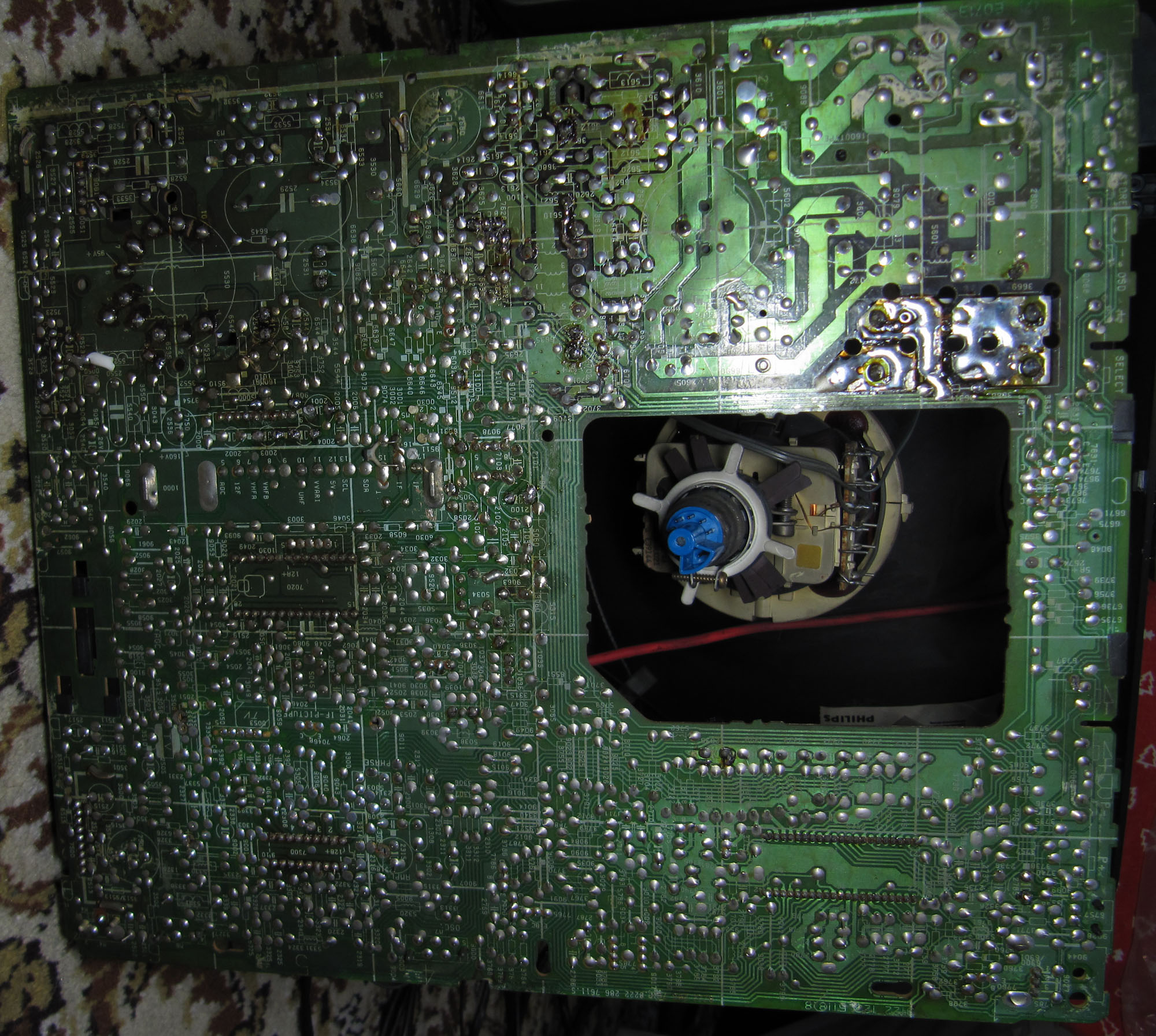

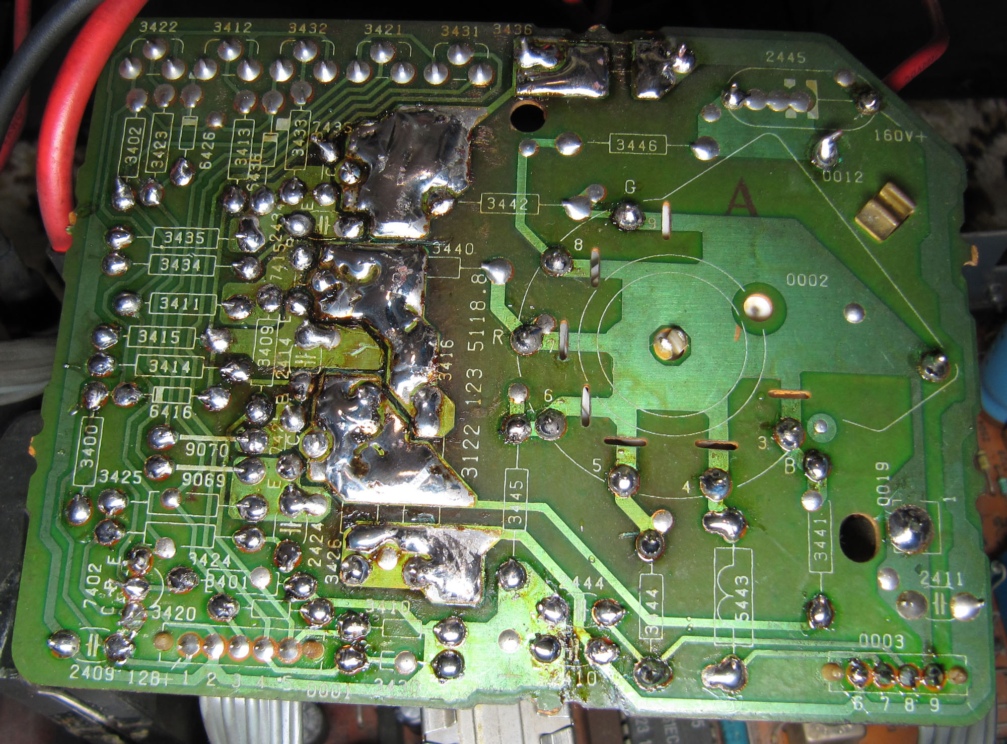

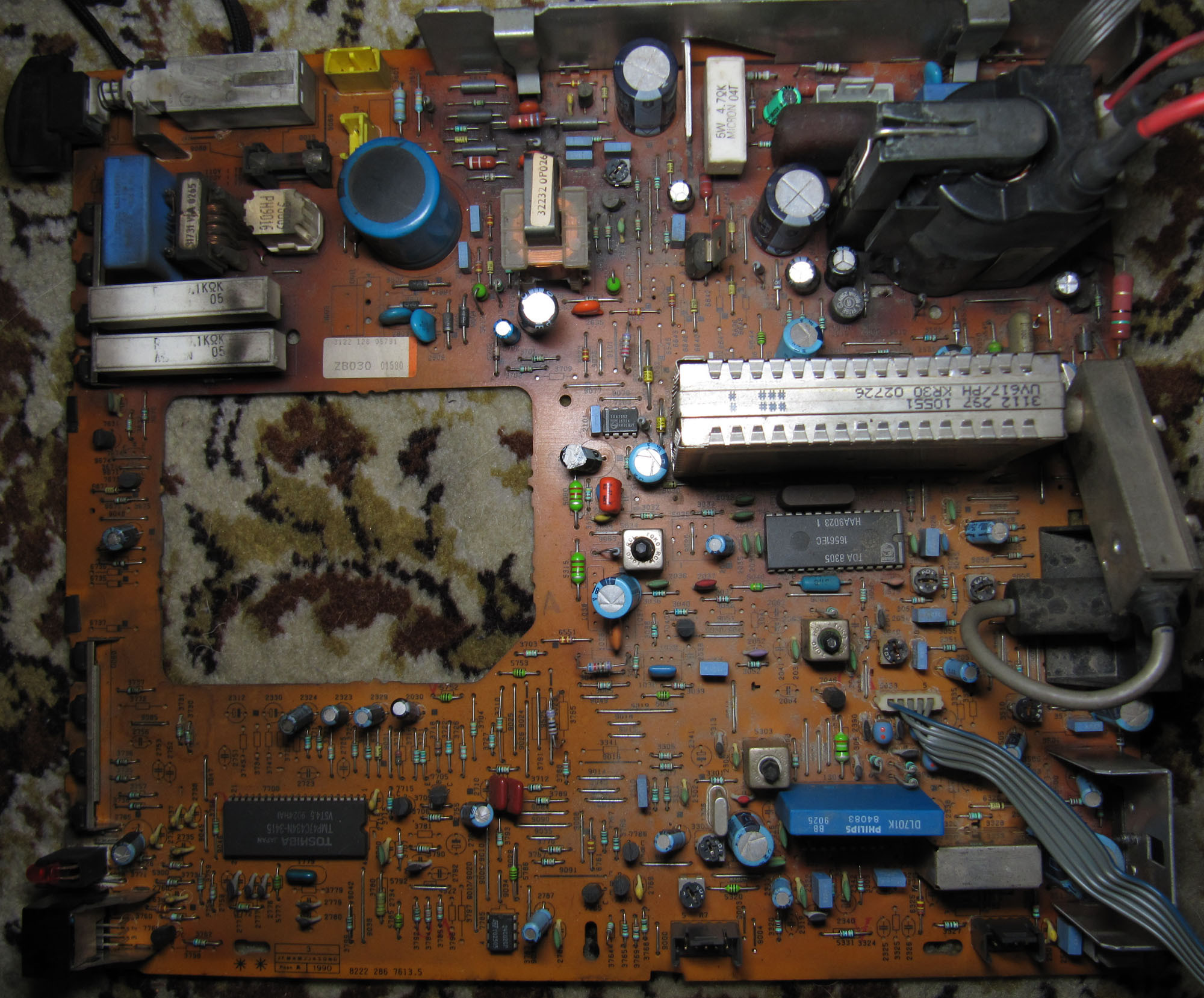

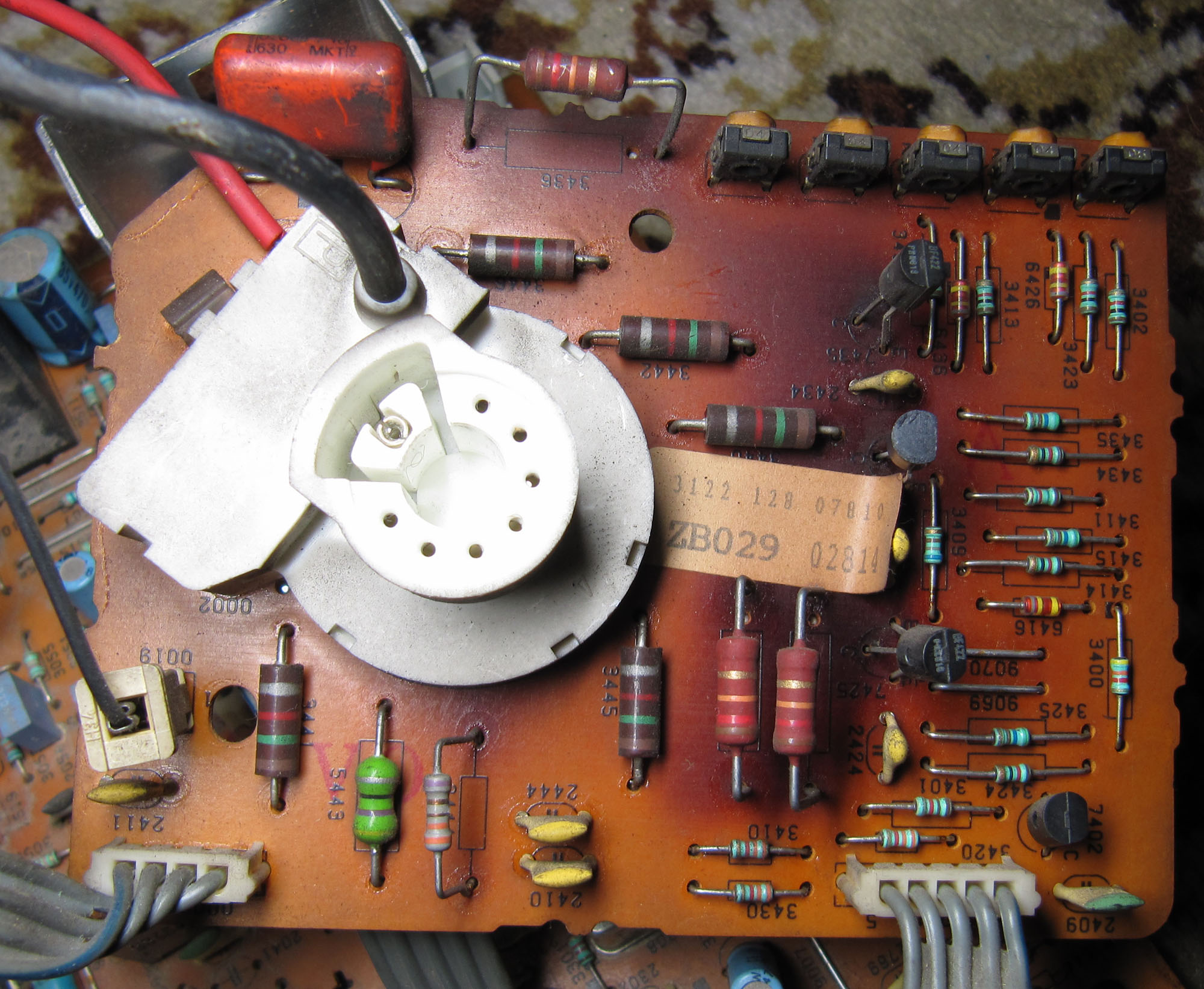

    I fixed another CRT TV, a Philips 37KV1232, chassis GR1AX

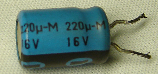

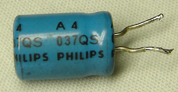

    I found 5 bad caps and replaced them. One of them was Philips 220uF 16V with real capacitance 45uF and ESR ~8ohm, not bulging though.
    The colors were bad and I found that 1 of the 3 transistors on the board on the neck of tube, a BF422, was bad and I replaced it. The colors are good now. Not great, but acceptable for a 20 years old TV.

    Philip's capacitor (and other passives) business was spun off to BC Components, then Vishay BC Components.
