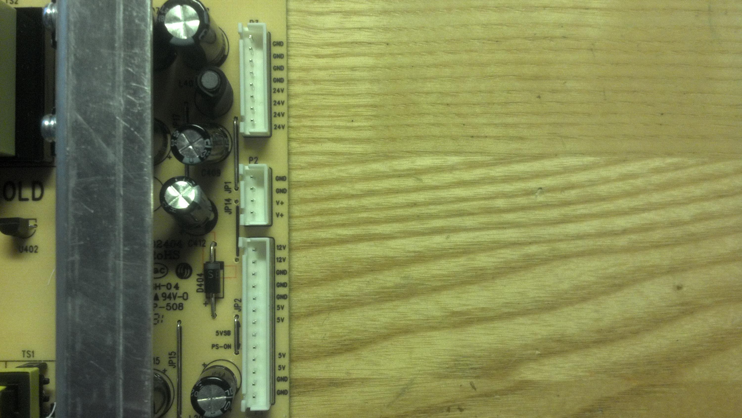

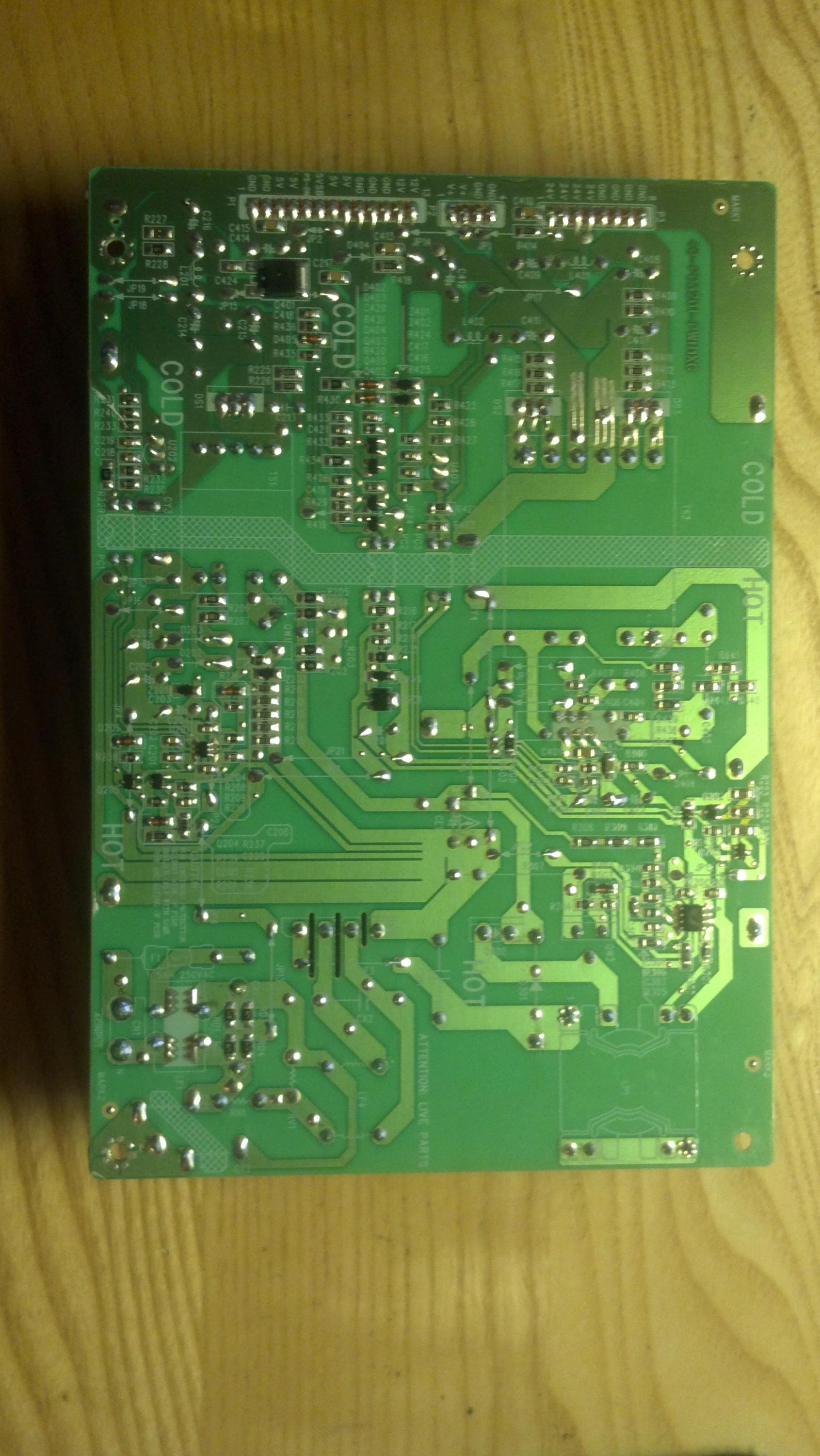

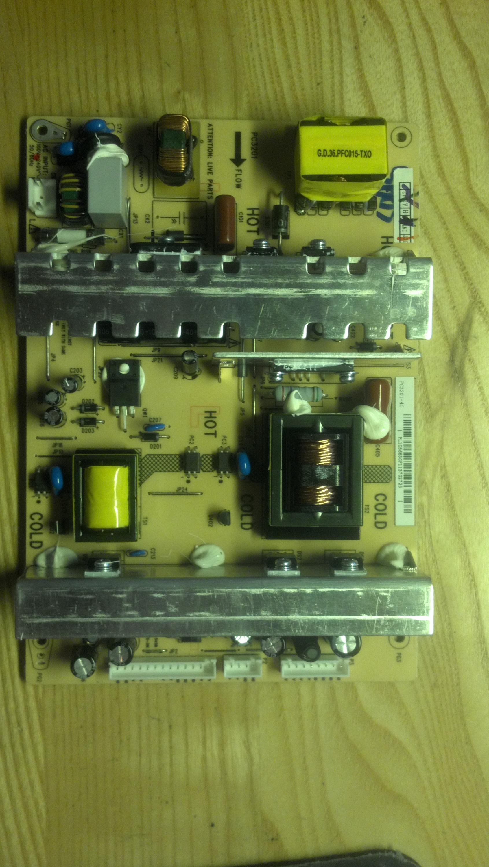

    Can we have a listing or picture of the labels along the connectors on the output of the PSU (cables go to main board (with video inputs), inverters, etc.)

      Re: Colby 32" TFTV3229 Power failure
      No problem. I'm pretty sure this is what your asking for.
        OK, see the pin marked 5VSB.
        Install board into chassis, everything connected.
        Set up DMM on DC 20V, red probe in volts/ohm, black probe in COM.
        Stick red probe into connector where 5VSB is (you will have to touch the metal ring around where the wire meets the connector.)
        Black probe on chassis.
        Tell us the reading.
          Im getting a reading of 5.0v

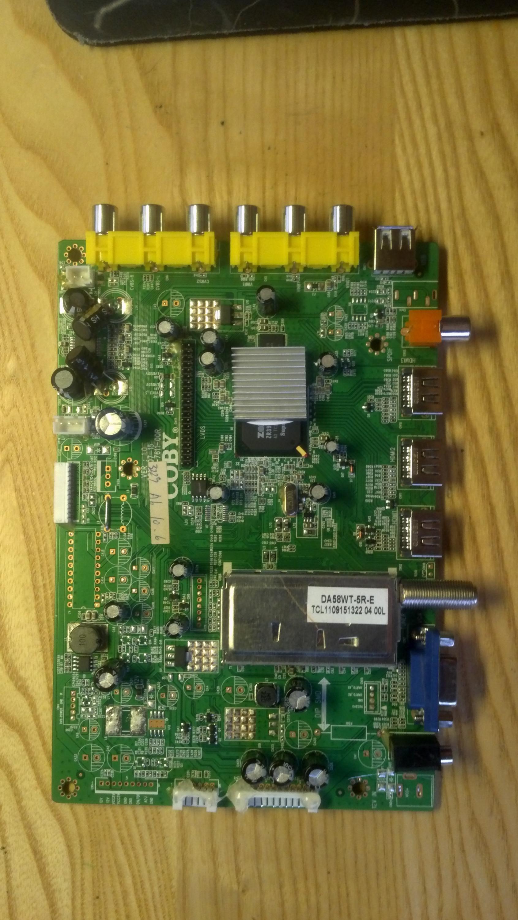

            That's a good reading. Test the "5V" and "12V" pins, and the "PS-ON" pin. However, if the main board is not telling PSU to switch on, we will see none of the 5V/12V voltages, other than the single 5VSB which is always on.

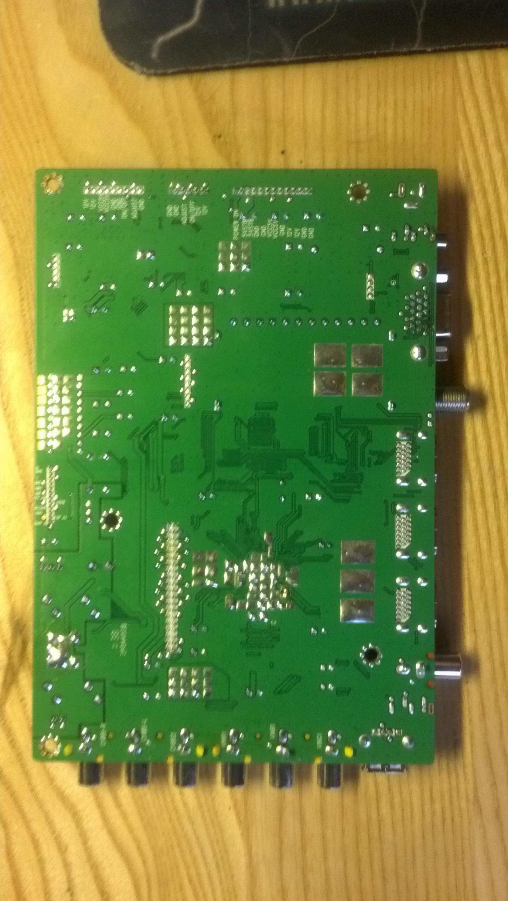

            You see no standby light? Can we have picture of the AV board?
              Yes i do not see any light coming from the front led. I also checked the other voltages and they are reading correctly

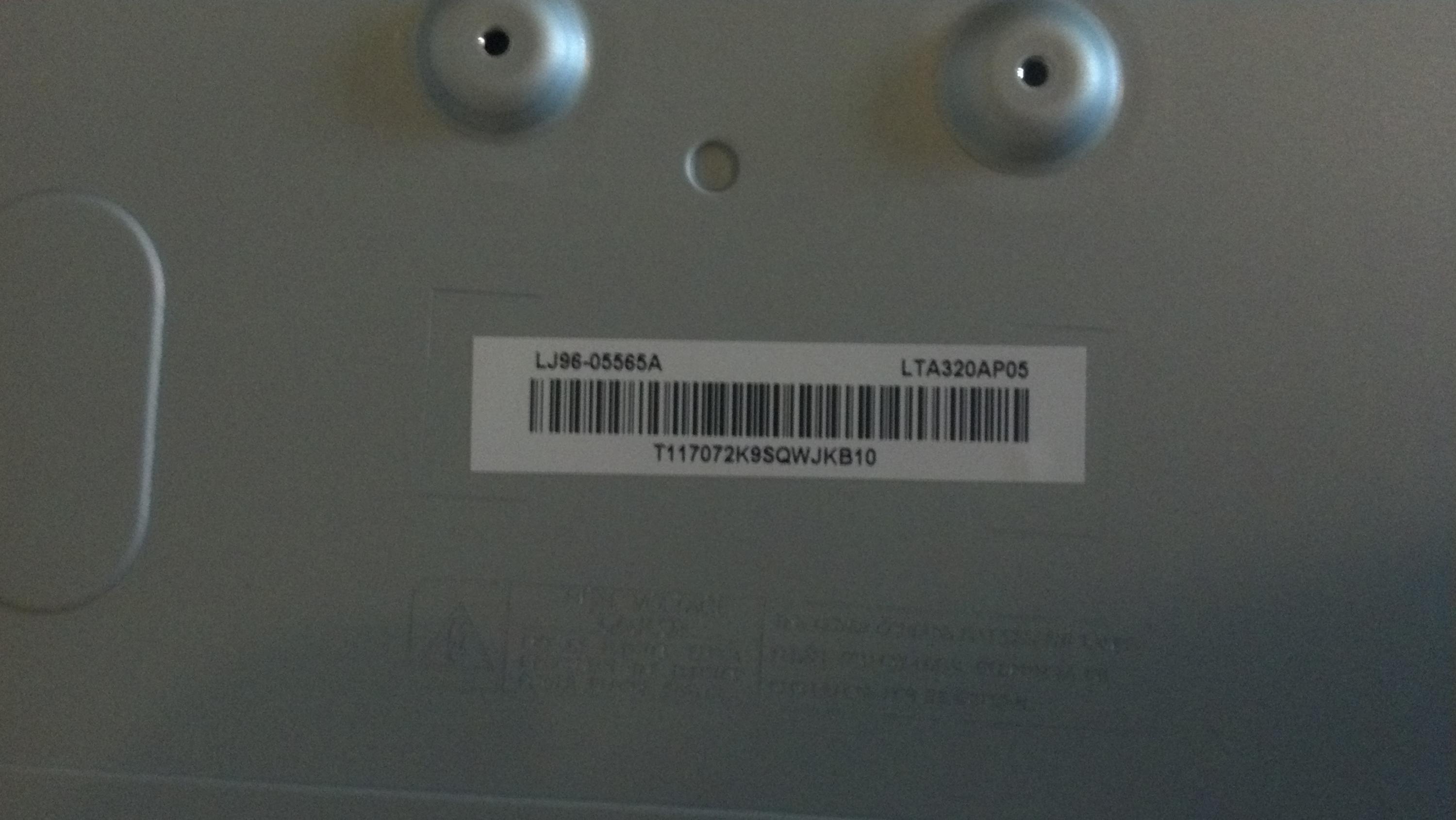

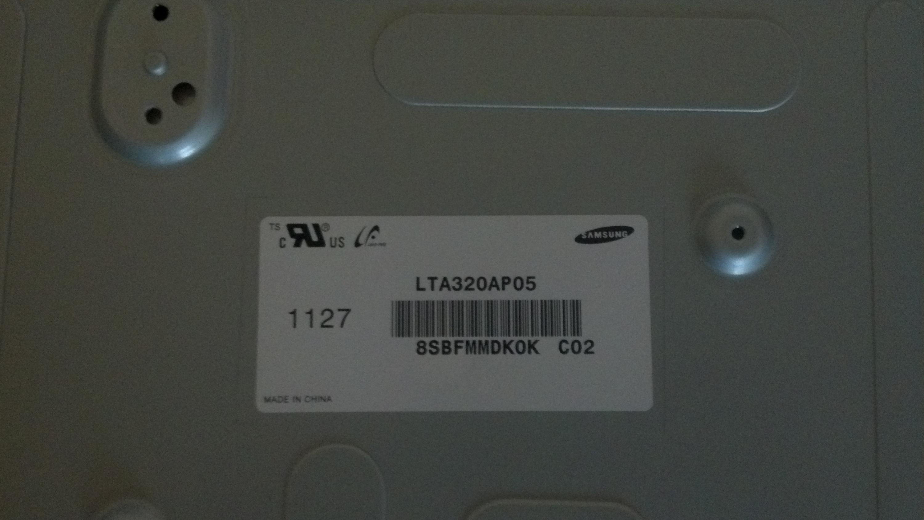

                I had this set back in the summer and it did exactly what yours is doing. At first the LED on the front would turn blue then go out. After several tries the LED stopped coming on. Voltages on the psu were all correct. I had to replace the main board and it fixed this tv. What panel is in this tv?

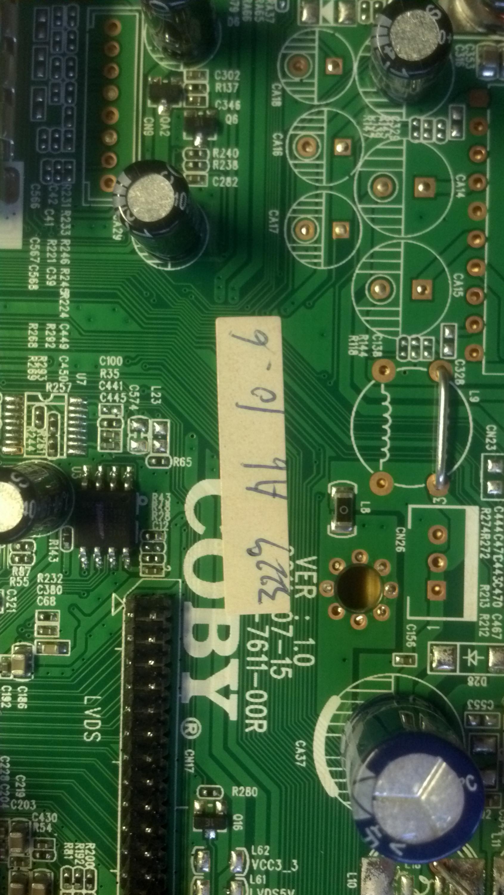

                    Can you recall if your tv had a cable connected to the four pin slot on the motherboard because when i opened my it did not have one connected and i cannot see one for it. could it possibly be used in manufacturing or for another model?
                      That's the same panel that was in my set. It was a royal pain finding a main board that used this panel. I think Coby uses several panels but if you would look on ebay for the board most of the sellers at the time didn't list the panel it came from. I would email them and ask. Naturally they didn't know or couldn't tell me since the rest of the tv was scrapped. Hopefully you'll get some good assistance here and be able to repair it without having to do a board swap.
                        i Found a board on Ebay but im a little worried about the red wire going across the board. Mine does not have it. it is the same model number could the wire be a possible fix?
                          That board is not the correct version for your TV. The one for your panel has a shield over the microprocessor area, about 2" x 3".
                            A wire like that indicates a manufacturing screw up that some poor guy in the factory had to work out and fix with the wire. It's called a mod wire or bodge wire.

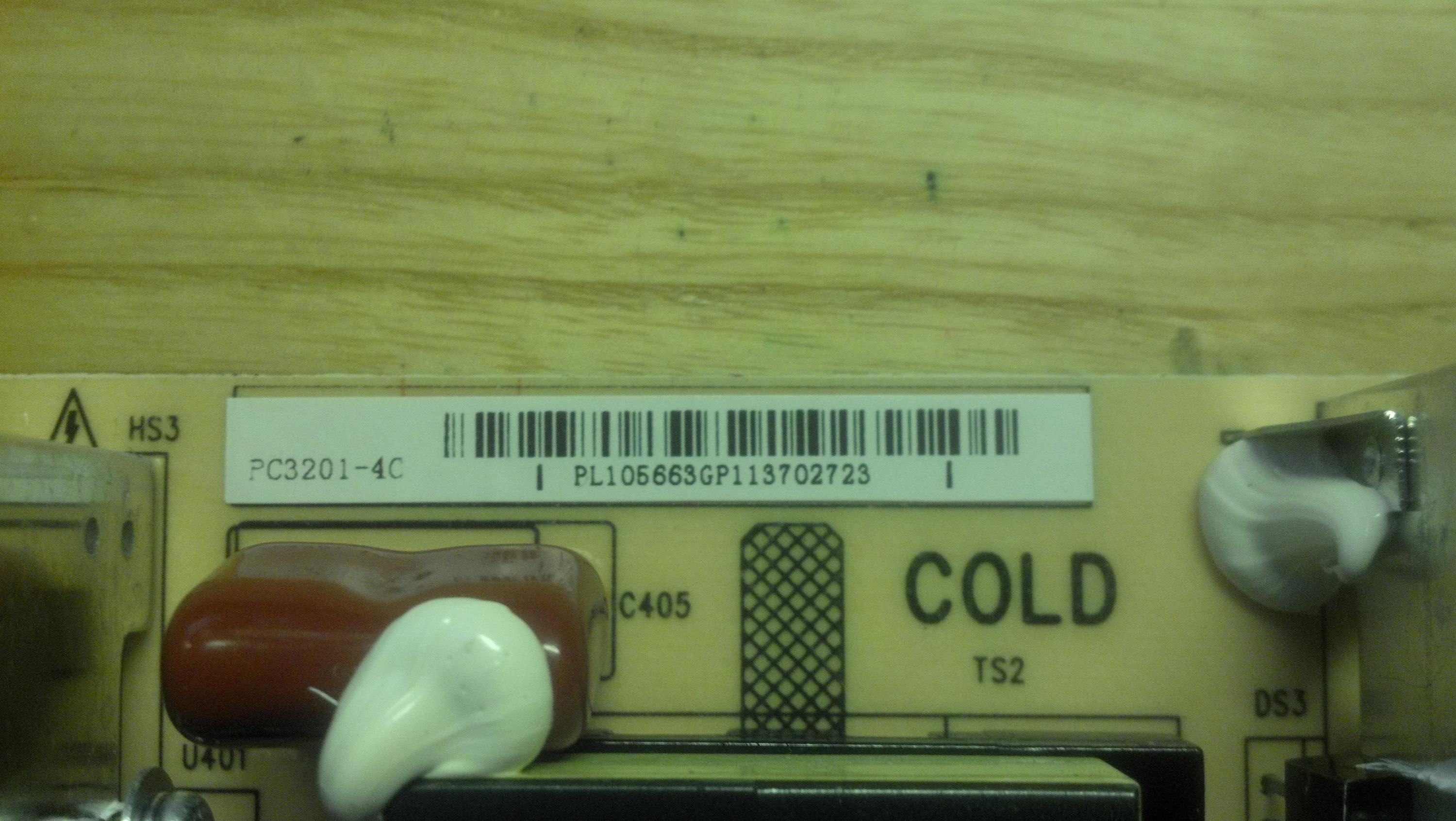

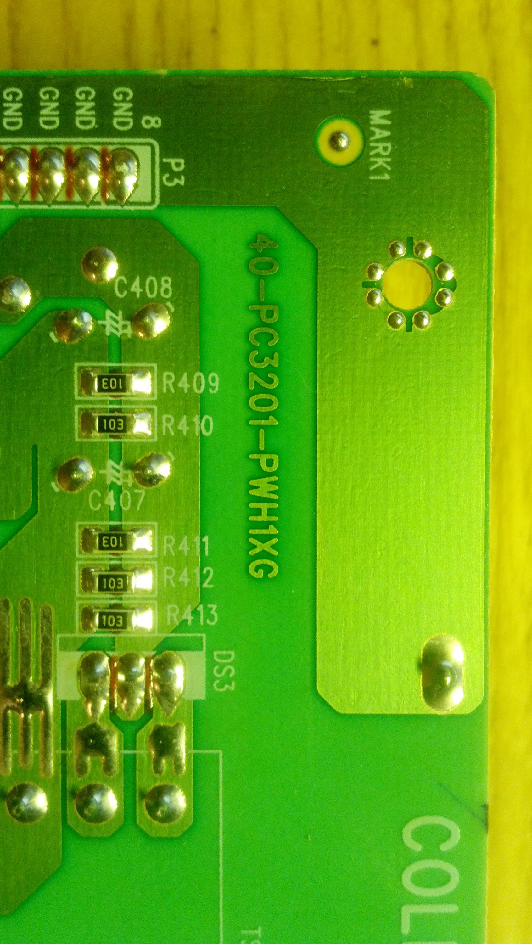

                                anyone know where I can get a power board for Coby tftv3229? I see a bunch on EBAY but the pictures don't look like mine. Part # is 40-pc3201-pwhixg .
                                UPC is pl100066gp113423637. Blew a diode @ D301 but I don't have equipment to see what else might be wrong.
