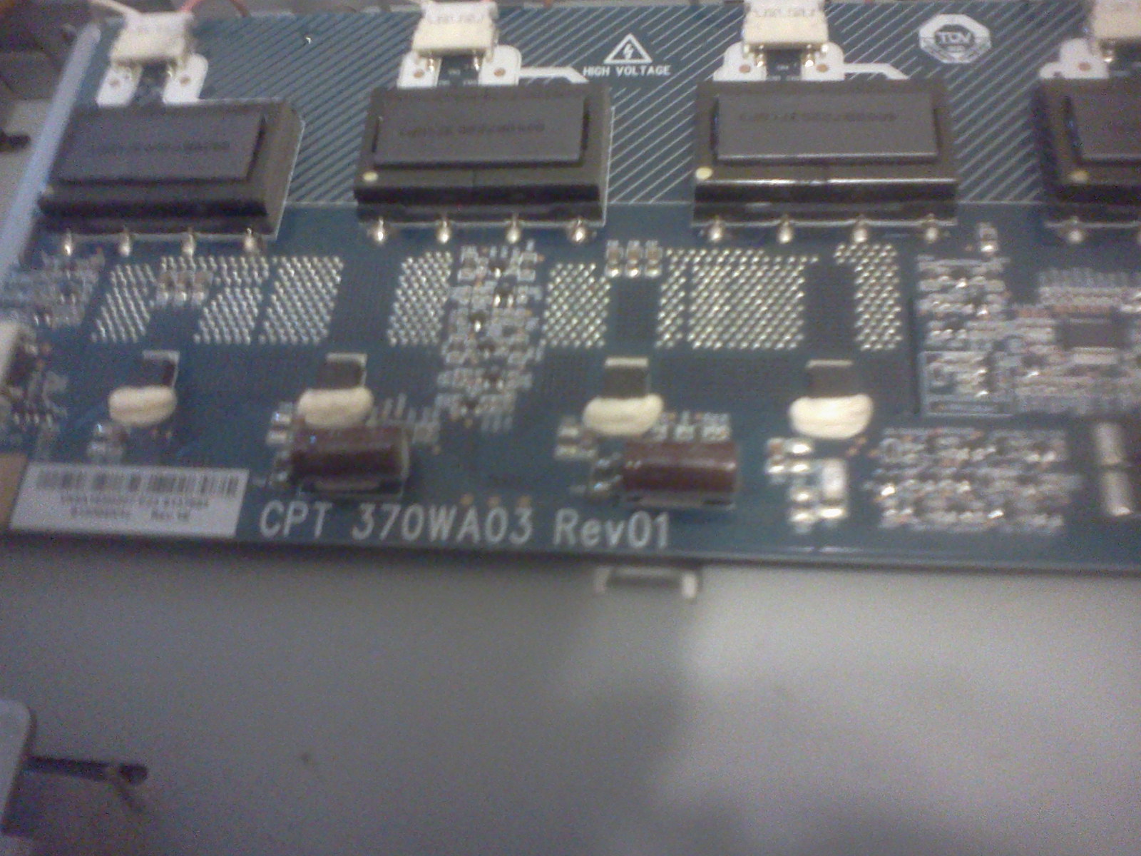

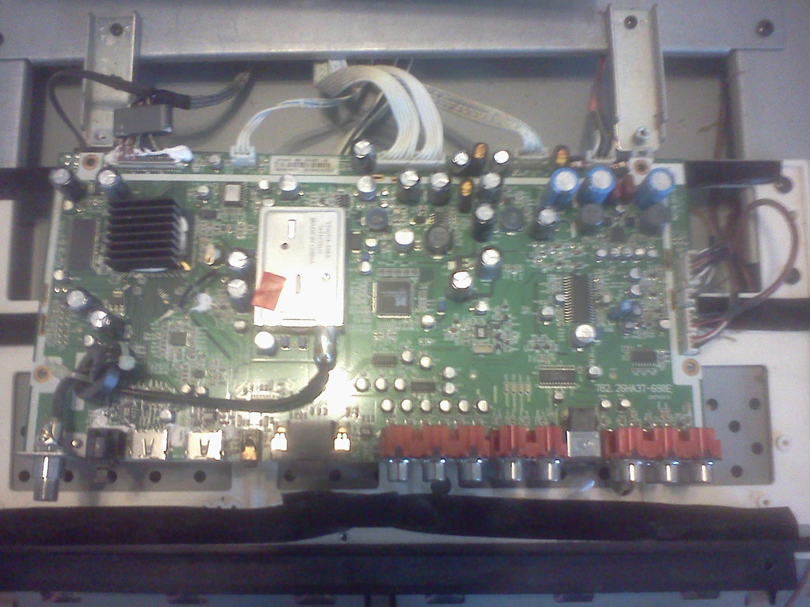

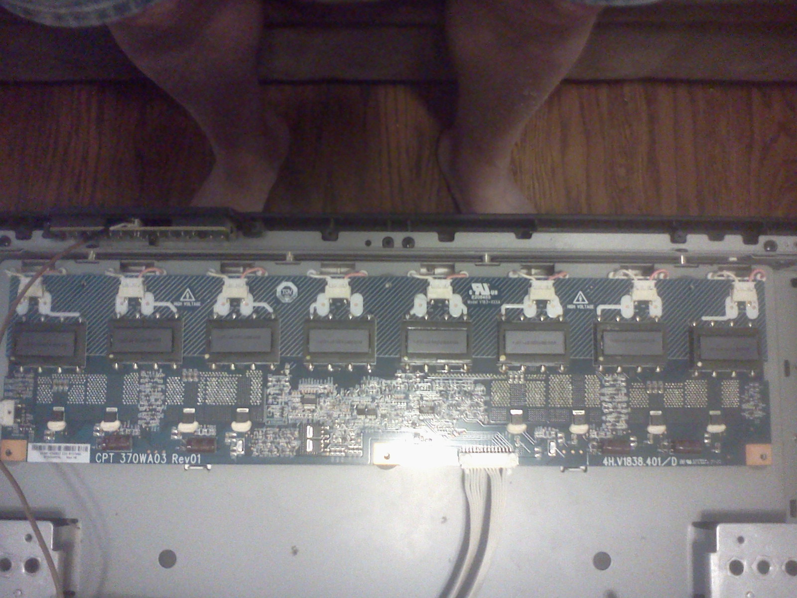

    Pic of main board and inverter board:

      As you thought pictures are useless . You need to state the ohms test in ohms 2.2 is not sufficient. Do you still have sound - a dvd film playing is good.
      On the inverter board there will be some small fuses have you tested them.

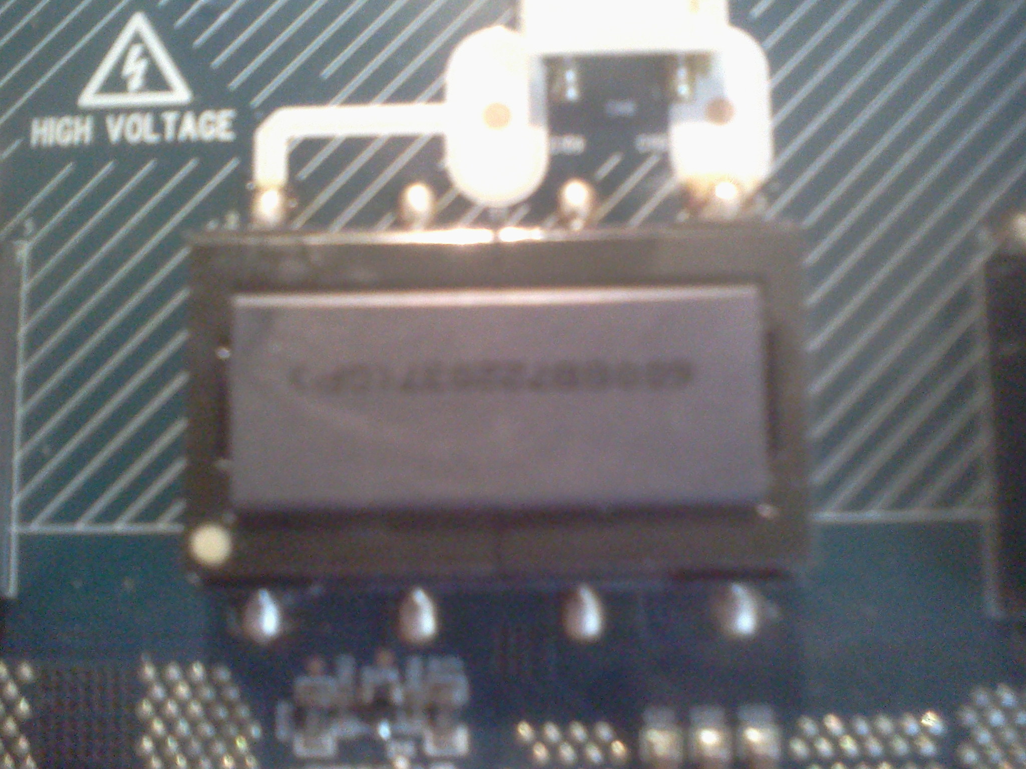

                    I took the inverter board out and checked all. What I have is 8 transformers labeled T1 thru T8. Each transformer has 8 leads, 4 bottom labeled left to right 1 - 4 and 4 top labled left to right 8 - 5. I measured bottom left to top left and bottom right to top right (1 to 8 and 4 to 5). All measured with meter set to Ohms 20K.
                    T1 1-8 = 2.24 4-5 = 2.24
                    T2 1-8 = 2.23 4-5 = 2.24
                    T3 1-8 = 2.22 4-5 = 2.25
                    T4 1-8 = 2.25 4-5 = 2.24
                    T5 1-8 = 2.24 4-5 = 2.22
                    T6 1-8 = 2.24 4-5 = 2.21
                    T7 1-8 = 2.23 4-5 = 2.28
                    T8 1-8 = 2.22 4-5 = 2.21
                    Attached is a pic of T7.
                    Please let me know if I am doing this the right way.
                    Thanks.

                      Terrible picture - you try deciphering an upside down out of focus number
                      Anyway you have tested the correct pins and in the main seem ok. Only thing slightly awry
                      is the 2210ohms on one v 2280ohms on another but nothing major enough to say for certain it is bad. At least that is my interpretation
