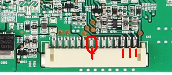

        OK, there are 4 DC Voltage test points, Black probe to the chassis, red probe to each one of those points when the TV is turn on and when it is turn off.

          Okay so I just wanna say that the cage that protects that board is off so I don't know if its still grounded correctly. But after I checked it at all the pins you asked while everything else is connected and with either power on and off they all read 0. Now should I be using the meter that reads 75/200 V? Or 1000/200/20/200m/2000m?
            Re: Insignia NS-LCD37 - One Second to Black - Another one
            You should use the screws to mount the board back in place to get the ground connections. Your meter cannot do less than 75VDC? What kind of meter is this?

                          OK firstly have you figured how to use your DMM?.. because no using AC tests for DC doesnt work... One is alt current other is direct.
                          Use 20 dc test for the connectors, test all pins as stated before and make sure you ground the black test probe to a screw Report the results back

                            OK, so the 24VDC power supply is working, but we need the DC reading of the other 3 pins I have marked, they are (cannot tell which pin is what right now) for Backlights On control pin, Dimming control pin, the third one I do not know. The main board may not be sending the BL_ON signal. Please read my Basic LCD TV troubleshooting guide to understand what it needs to work. Those 3 pins should change state when TV is powered on and powered off.

                              Okay so I've tried the other pins as you asked from your diagram. There is nothing present 0V, and from the side you asked for me to check there was nothing, but the other side actually powers up on five the pins, these all lead to the main a/c board and they are stamped 24V on the bored, they all get 24.7V once I turn the tv on. The last pin when I follow to my A/C bored reads DIM but like I said its reading 0V. So there is no ON signal obviously, what do I do next?

                                That means the main board is the problem since it is not sending the BL_ON, DIMMING signals required by the inverter board to work. I do not have too much luck repairing the Insignia main board, you may be able to do some DC voltage checking of the voltage regulators.
