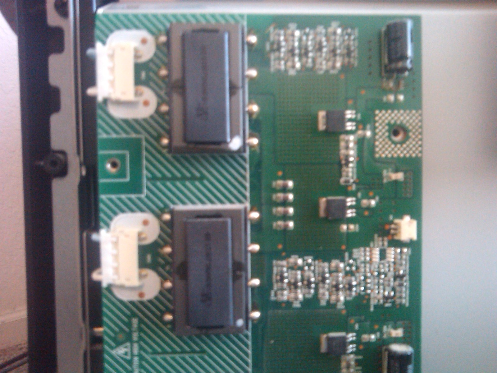

                  Hi all I have to thank you all for sharing what you do, but I'm having a problem with my Insignia NS-LCD37 also. Having said this, everyone talks about the red light on then going to green, but mine goes to blue, and I see nothing but black? I have read as much as I could about similar models but, I'm not sure where I stand in comparison to others with similar models.
                  The TV worked great for over five years but now no longer powers up, I only have that red light stating that I'm plugged in and when I hit the power I don't see anything but the blue light on and no sound. I have it apart but I definitely don't know where any main fuses are or know exactly how to check the transformers. All my caps look super clean and I went as far as I could testing my main ac board. The values didn't all match so I condemned that board, ordered it, installed it and no luck. Transformers are what I'm assuming but the ohm test you've posted to test doesn't match what I read, but still not sure as to which direction I need to go in my case. Any help will keep my daughter and wife's faith in the daddy can fix it phrase alive . Please advise

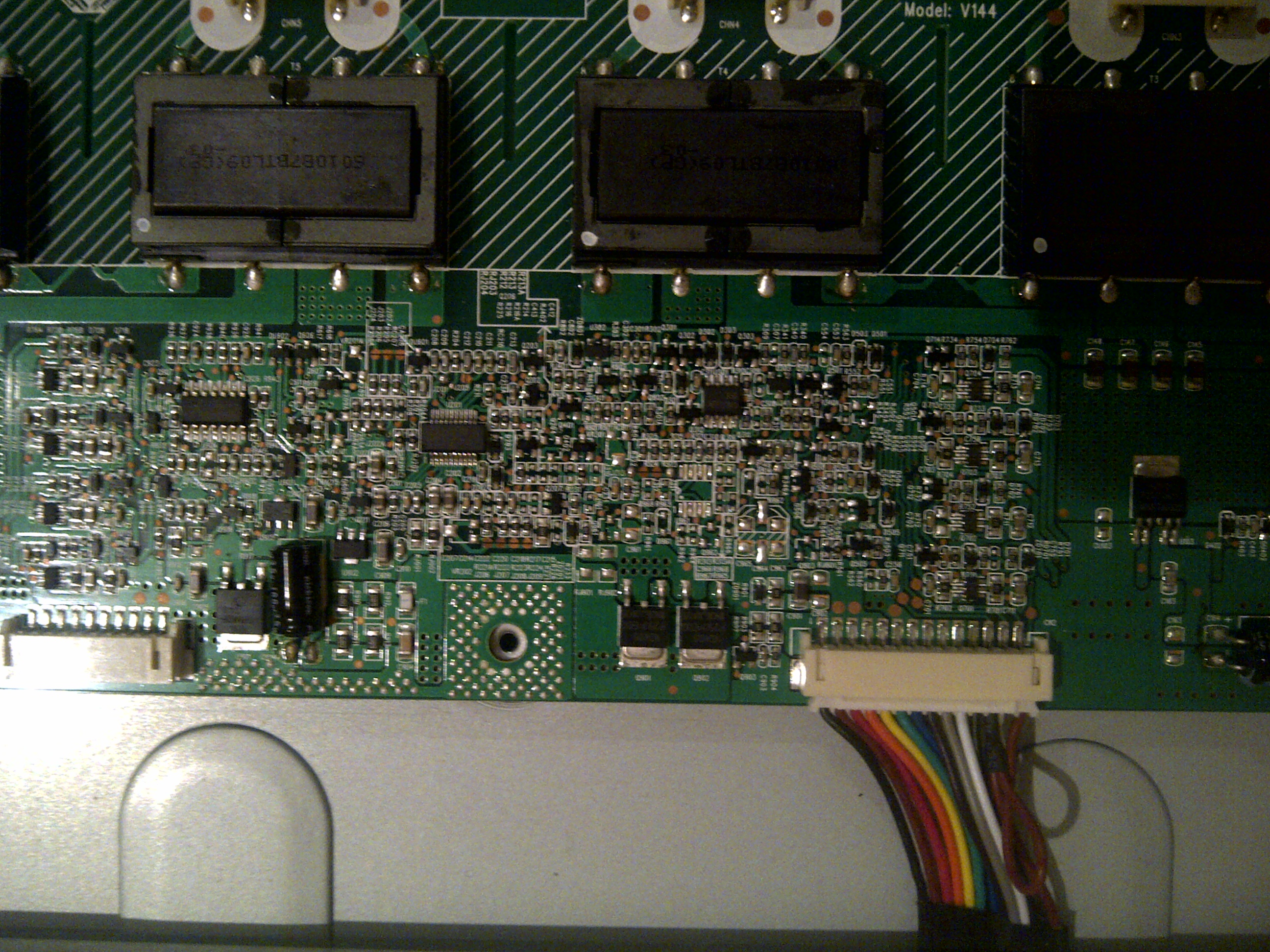

                        So S1 - S2 = 2.2 Ohms and the rest all read the same all across all 8, pic is the second one. So what do I check next?

                          Are my pics clear enough? The 1st is both ac and video(?) card and the last is the ac board I pulled out and replaced all ready.
                            Re: Insignia NS-LCD37 - One Second to Black - Another one
                            OK, the picture's resolution is way too low, it is not focused and I cannot blow it up bigger to get better inspection. The second picture is the backlights inverter board, I will need to closed up pictures around the white connector, also need the board P/N then I may be able to get better pictures from shopjimmy.com

                                Are these better?
                                  Can you do higher resolution? The white connector is the one where it has bunch of wires that go back to the power supply board, I am trying to see all the fuses on that inverter board. I have to be able to read the printing on the board, if you look at the pictures and you cannot read the printings, then it does not help.

                                    There's a few differences in the board, very similar but not identical

                                      Sorry is this better?
                                        OK, is this the one?
