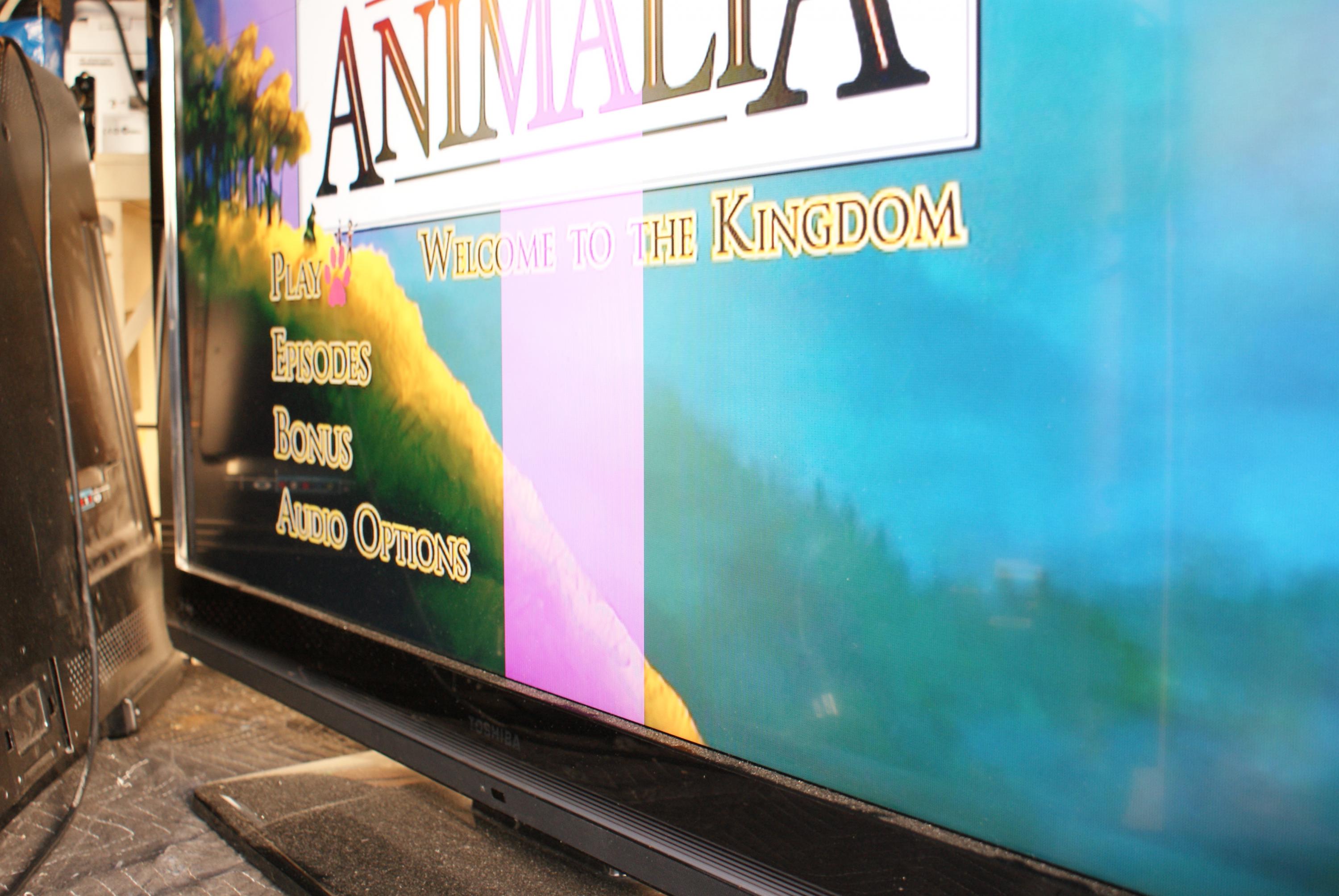

toshiba 52RV535u help! pink band on screen
  • ealequi
    • Dec 2012
    • 212
    • usa
    I replaced the t-con board and the main board and it still doing the same. I dont know if maybe the screen is bad or it may be the inverter. Help please.

    Re: toshiba 52RV535u help! pink band on screen
      This is most likely the LCD panel at fault, it may or may not be repairable.
      The t-con and main cannot usually cause localised distortion.
        should i go into the panel conection and check or is a lost cost?
          For a 52" I think it's worth at least trying to fiddle with the tab bond.
            I going to try and i let you know the end result. Thanks.
