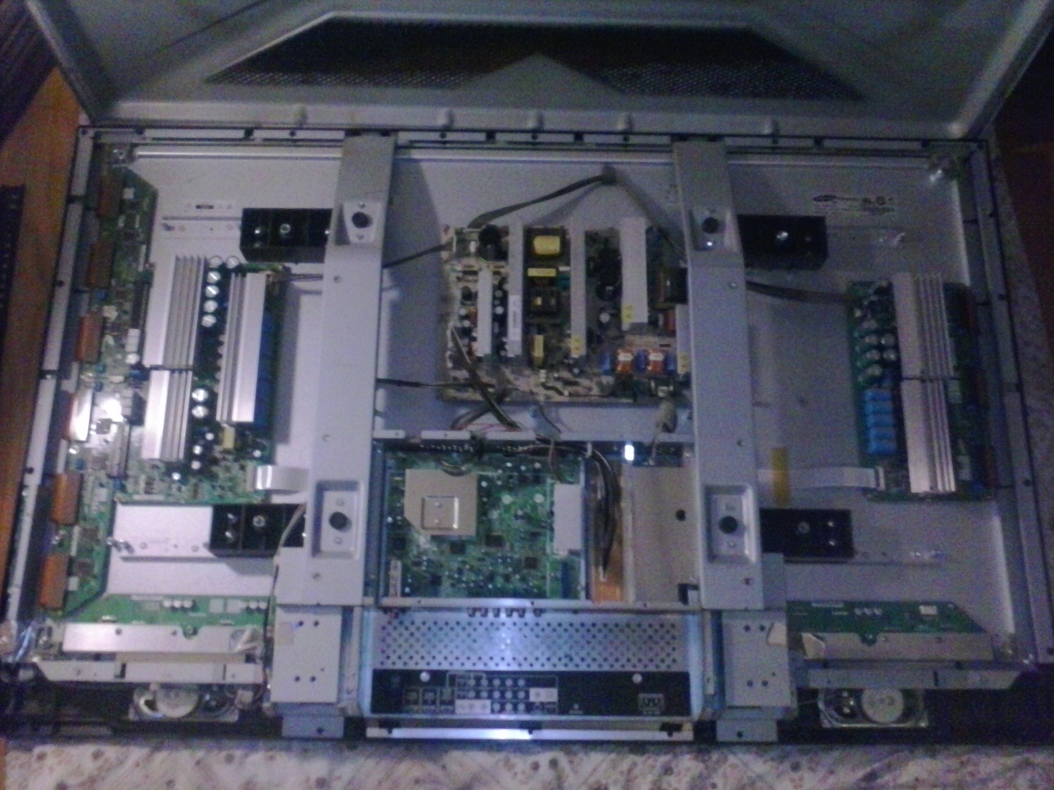

    Please forgive me if this should have been posted to an existing thread but symptoms are different than what i could find in threads already listed.
    Tv started to shut itself off the turn back on. Frequency of events became greater over a month period and eventually it would not turn on at all and the power on light did not come on either.

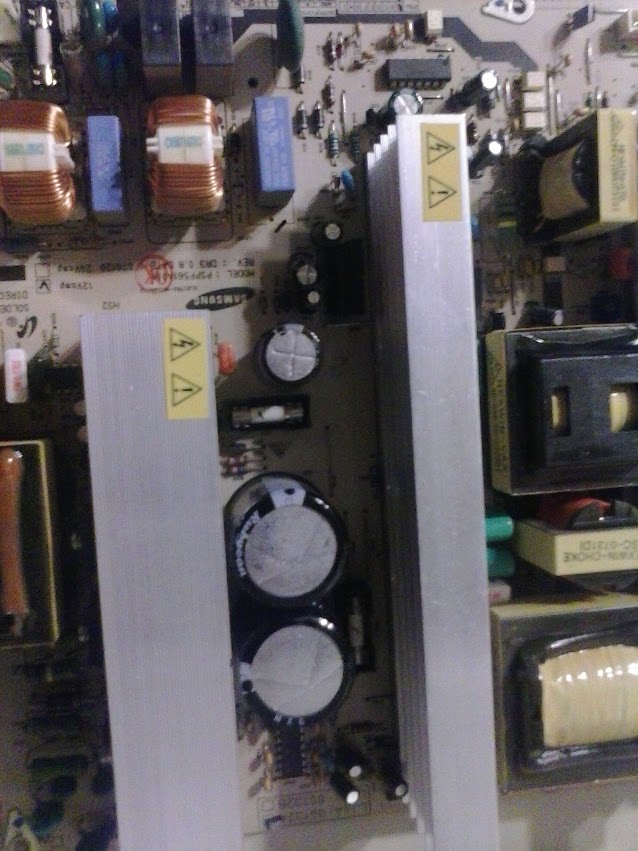

    I replaced 3 bad caps and a questionable one on the power board.
    This solved the problem.. for 2 days. the symptoms started again and this time within 4 days the tv would not power up at all.
    I have rechecked the board and can not see any visibly damaged CAPs.

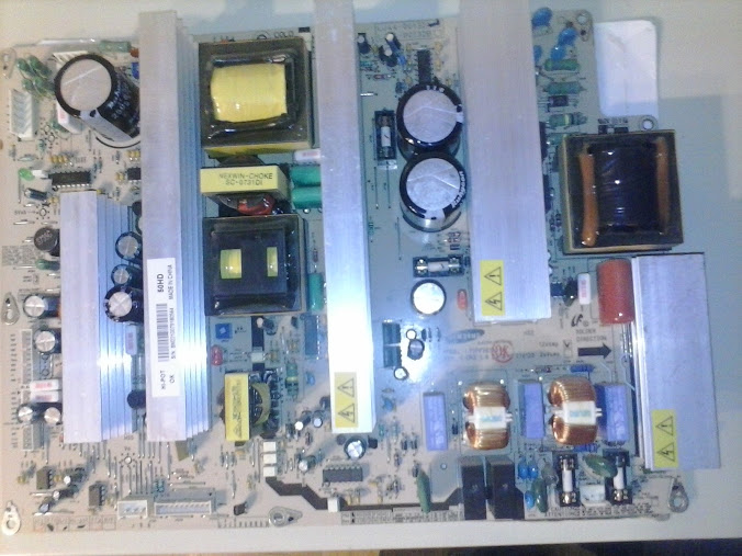

    When i hit the power button, i hear a click (like a relay) and a light hum (like a transformer) but it only lasts for a couple of seconds.
    I did check all replaceable fuses on power board and sub board.
    Ok, Volt meter check.. there is power to the board from the sub power board.
    On the power board there is an 11 pin connector.
    Pin marked A12V/AC-DET reads about 3v
    Pin marked PS-ON reads about 5v
    Pins marked D5V on any of the connectors carry mimimal (milli volts)

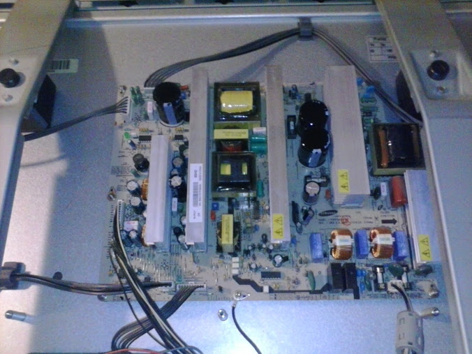

                Now that Ive found my magnifying glass, let me correct my earlier information.
                On the X and Y sustain boards there are Vs, Grd, & Vg pins
                On the 3 pin connector from the power supply board, there are 3 pins. Va, Grd, D5V.
                This is the only connector on the board where i found a pin marked Va.
                With the TV on and the cable disconected from that connector, i get the following readings: Va pin - 63 V dc, D5V pin - 5V dc
                When the TV turns itself off the power on the Va pin drops quickly, you can watch the meter display continually changing. after about 30 seconds it gets down to the mV range and continues to drop to about 140 mV. The D5v pin drops to about 10mV
