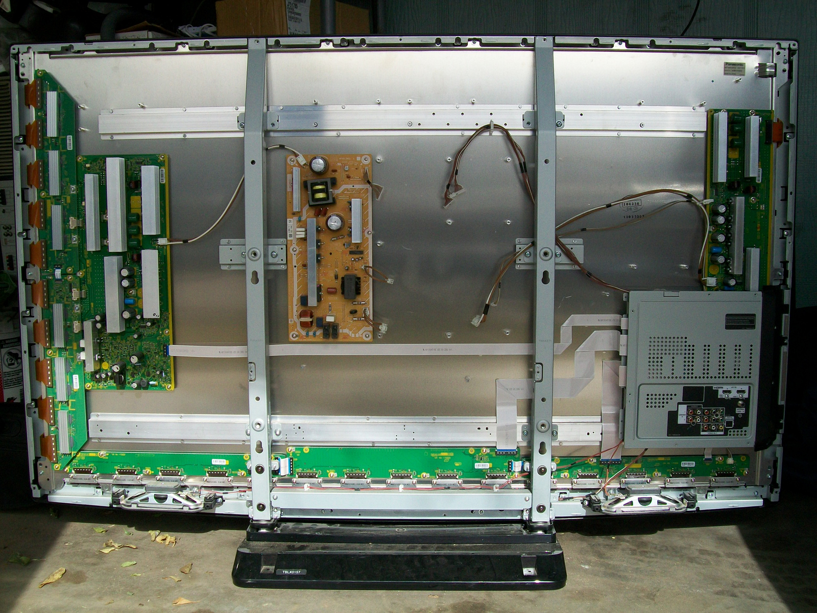

    Hey all, happy holidays
    I'm working on a panasonic viera wth what so far appears to be a faulty power board. This has two power boards- a master and a sub ppwer board and i need help isolating which one is the problem.
    So far i havent done much, what surprises me is the lack of wires in this plasma, i've never seen one with only two plugs, where does the main board get its power? I guess its routed thru one of the sustains? But i dont see any wire coming off those
    Anyway back to the task at hand, i've tested the voltages on the two plugs, which lead to the z-sus qnd y-sus respectively. The both have one gray wire and four brown ones. The grays are around 2 or 3v with the the TV off. However with the TV power button pressed, I briefly register 170 to 180v on both gray wires, and it QUICKLY starts to drop all the way down to 3v again.
    All the browns are 0.0v, so I assume those are gnd.
    Disconnecting the sustains does not affect the readings.
    The power led on the front blinks reds continuously, and only way to make it stop is unplug the TV.
    I havent check the bridge rectifier yet, but i will do that and report back my findings.

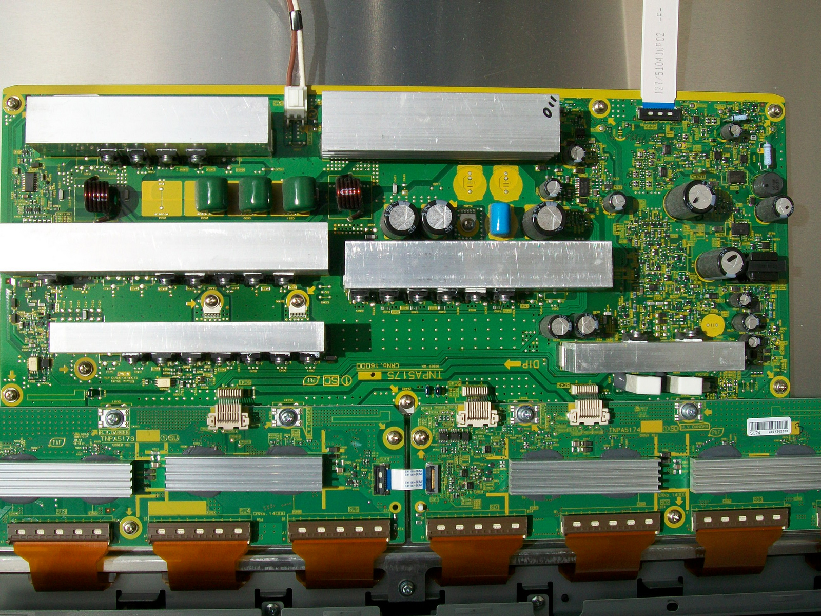

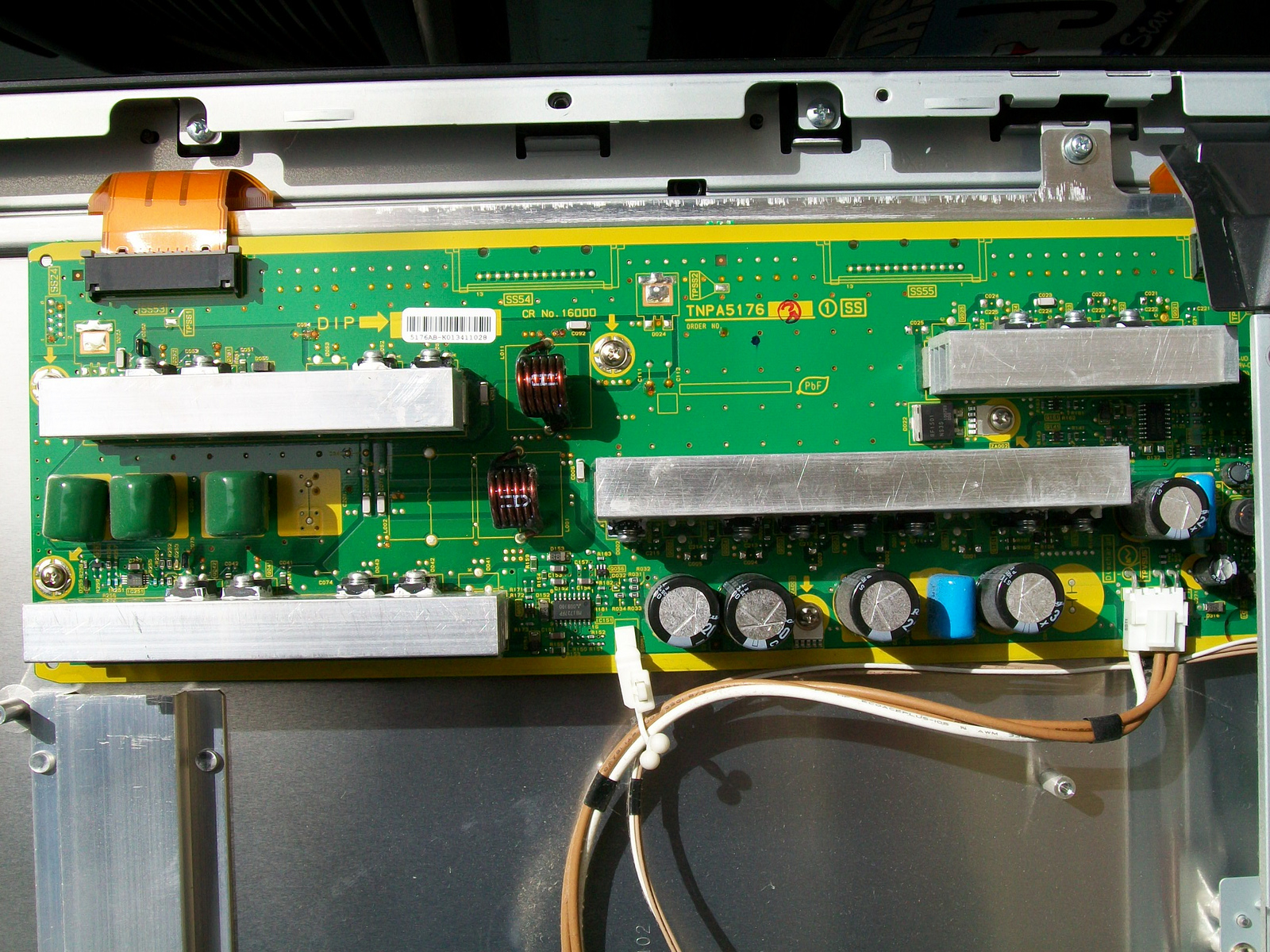

      Here are the rest of the boards.
      Can someone explain to me why the sustain boards don't have fuses? I don't even see an SMD fuse, this makes it harder to rule those boards out.
        Re: Panasonic TC-p58s2 no power
        Red LED blinks once every 3 seconds? "No specific check point"
        There are no fuses because:
        a) it's very rare for Panny SC/SS to short to ground
        b) the fuse is usually saved by the semiconductor, not the other way around
        c) they cost money & don't do anything useful (see a, b)

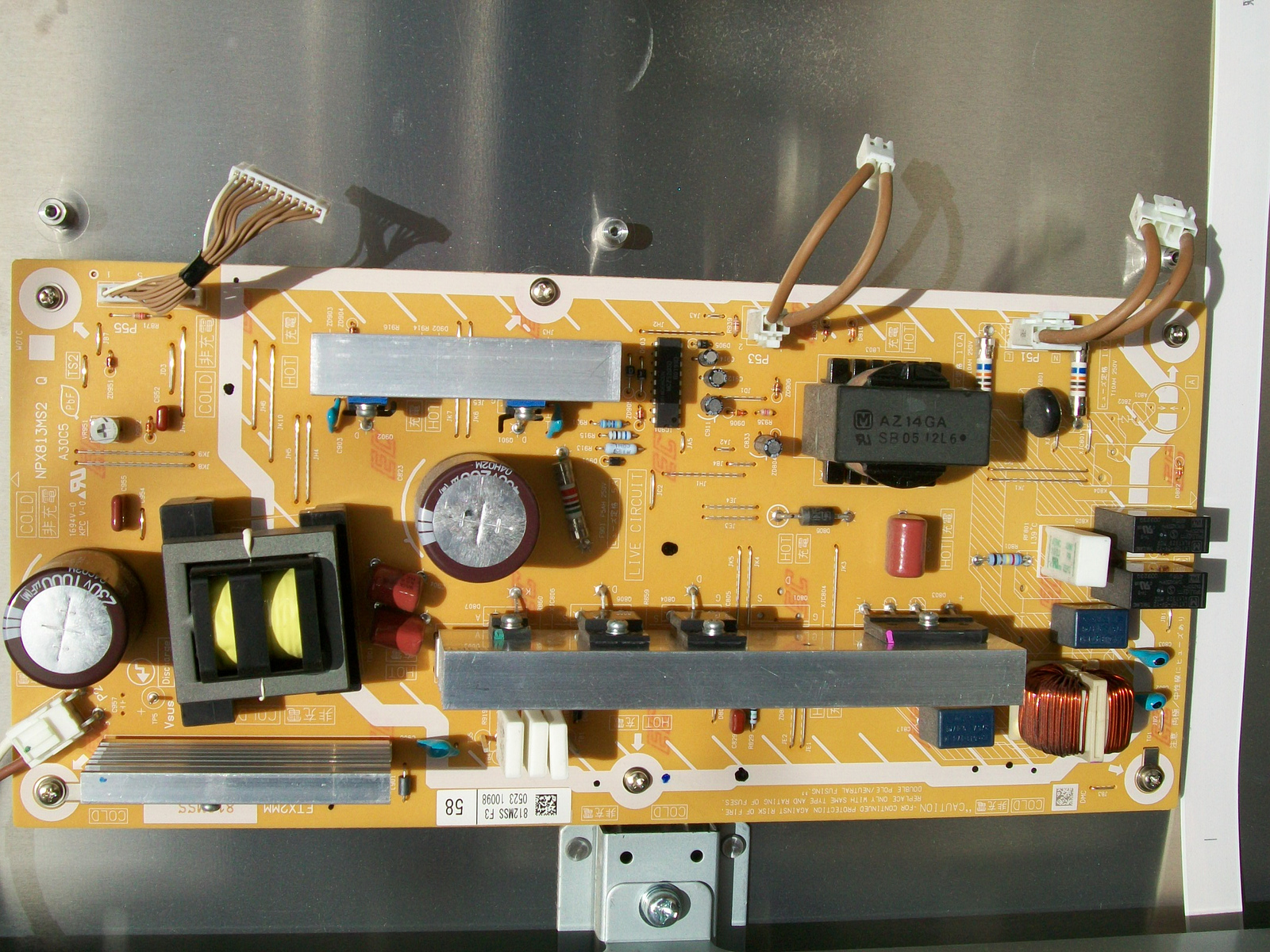

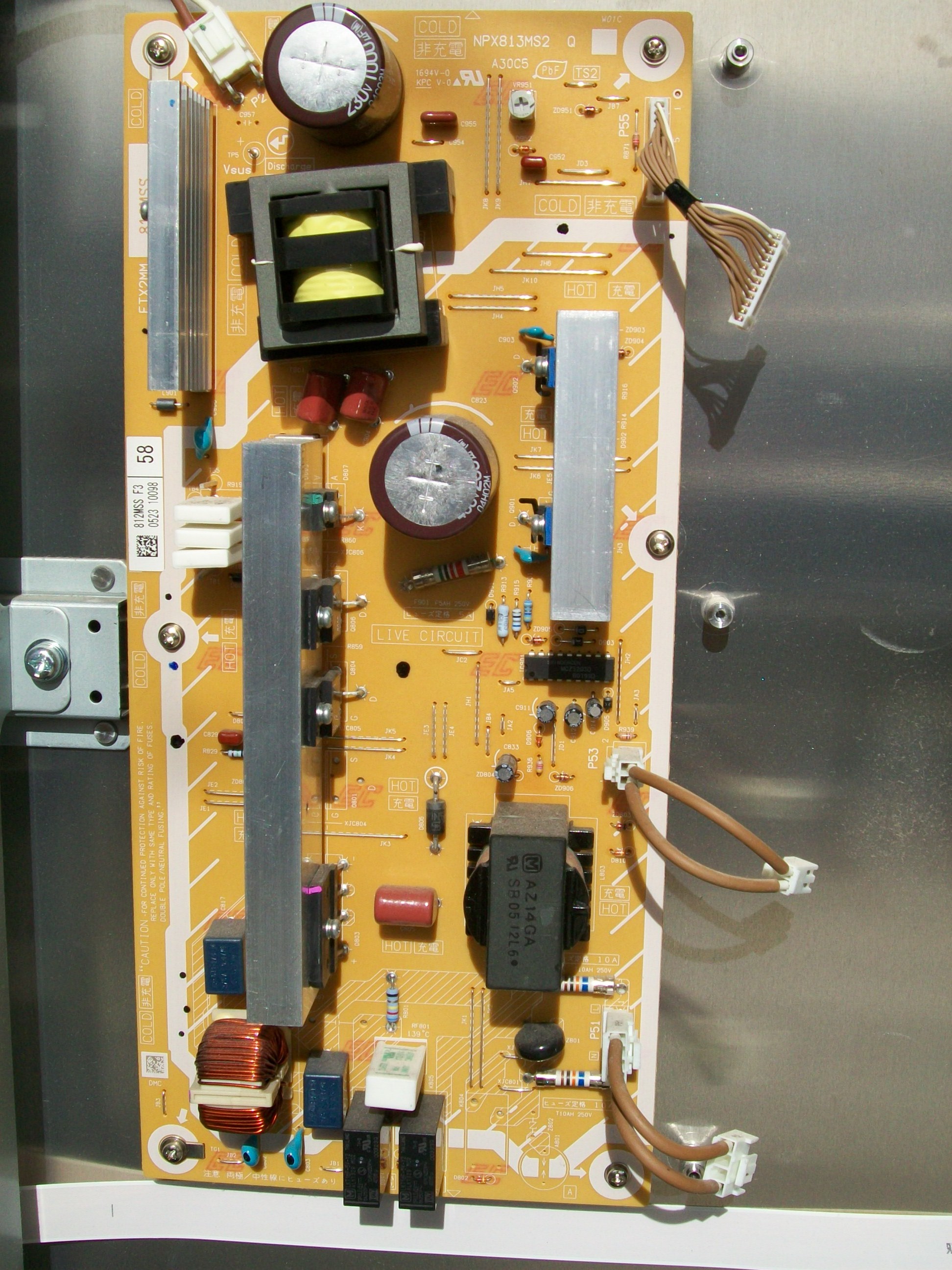

                  I've finally attached a photo of the main (master) power board. And I'm reposting the subpower board this time in the proper orientation.
                  Is there any way to isolate which board is bad?
                    Looks like there are two separate Vsus supplies, plus a Vda supply. Make sure each Vsus and the Vda are good.

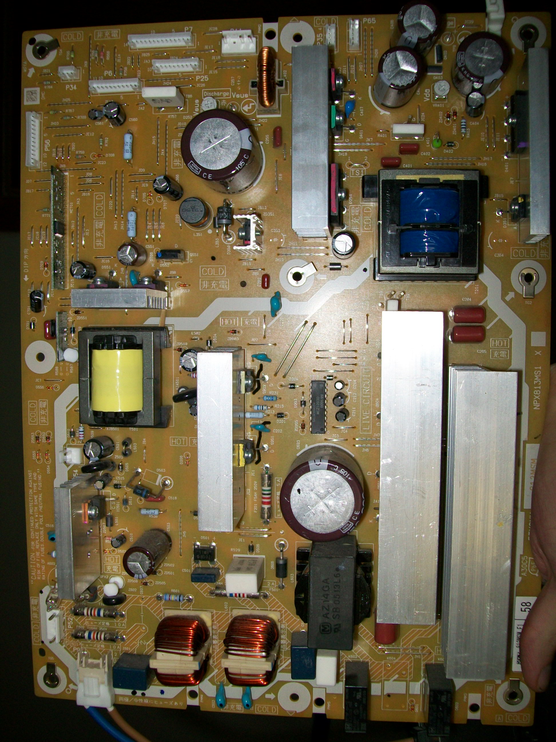

                      I ordered the main (master) power board, took a long while to locate one at a reasonable price and i am very disappointed to say It did not fix the problem.
                      At this point I'm really worried that this falls into what you call a rare phenomenon: a shorted Y or Z board.
                      How can I rule them out? Please help, I don't want this to turn into a money pit
                        Well, if it helps, this TV uses two Vsus supplies, one for each side of the plasma panel (one for SC, one for SS.) So if you measure Vsus on one side but not the other then your suspicion should lead to that side.
