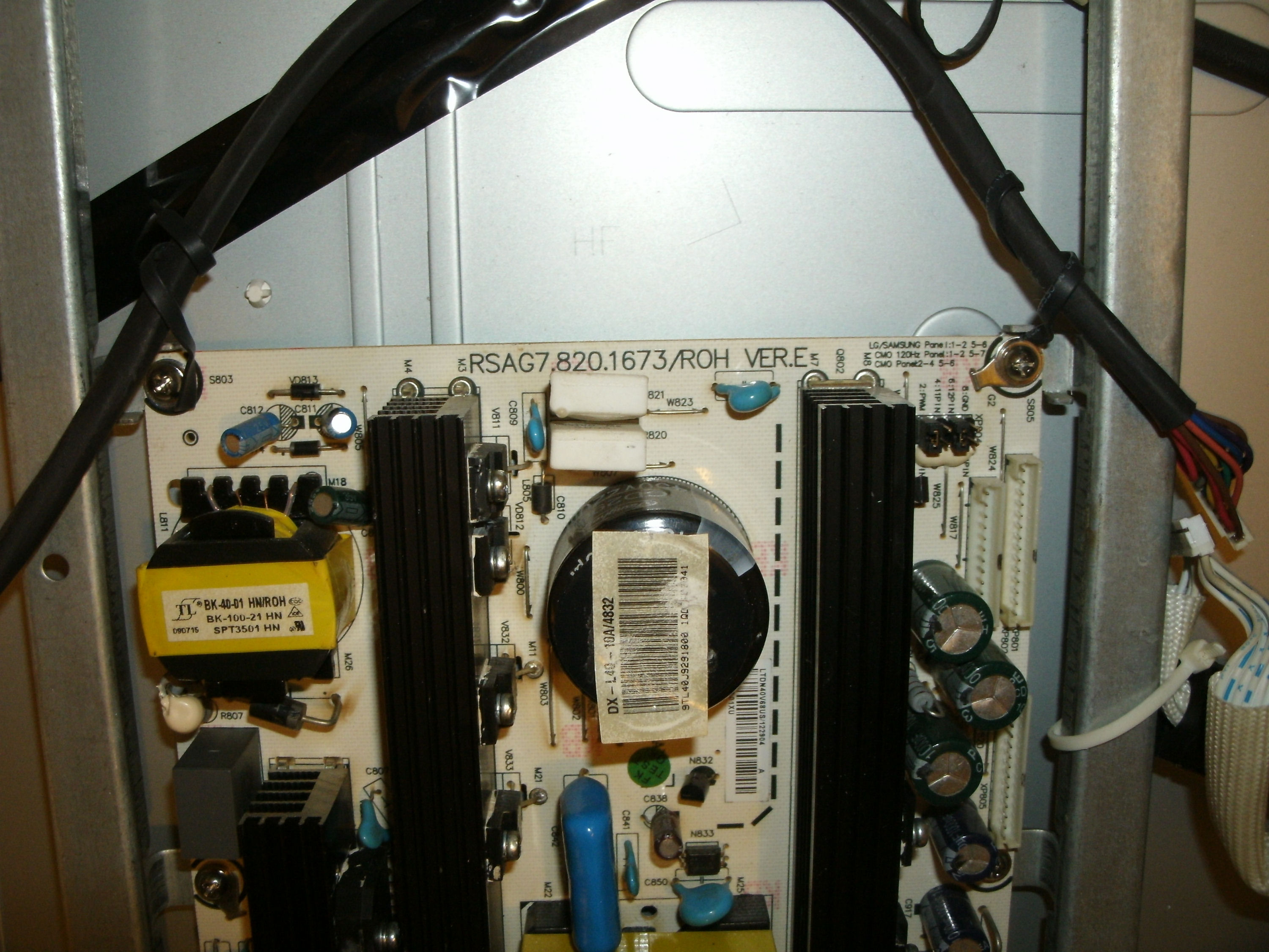

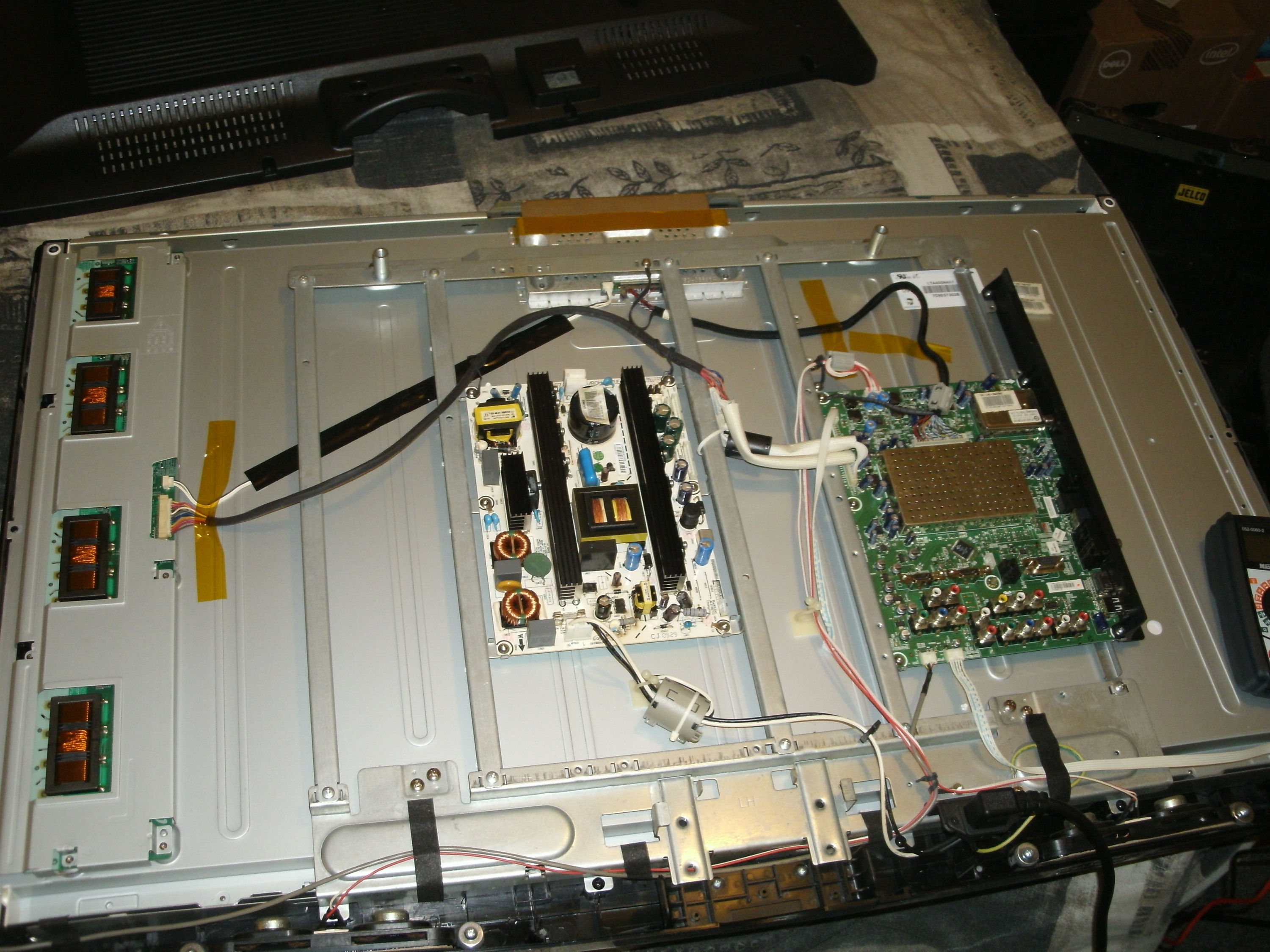

    Hi All, I am new to this forum. I have a basic background in electronics repair from a Computer systems technology course that I took. I have forgotten most of it lol and thus why I need your help please!
    Here is the background on this unit,
    - 1 year ago was running fine
    - gave it to my sister
    - 2 months later starting having problems turning on (standby OK, power on and power light would come on for a second or two then back to standby)
    - if she unplugged the AC and plugged it back in, would typically come back on. or display a white screen.
    - she kept using it like this for 6 months.
    - progressively got worse until it now does not turn on. (stays on standby) but you hear the relay click when plug/unplug the AC.
    - She gave it back to me, go figure lol
    Here is what I have done so far :
    - I have checked over all the circuit boards for visibly bad caps and do not see any.
    - checked for cold/bad solder joints, found a few that looked suspicious, so de-soldered/soldered them. Still same.
    - searched online, and found this great website with GREAT people, badcaps.net
    - Found a couple of posts relating to this type of tv/problem, went thru them. most relate to replacing the large blue heat wrapped cap. but mine shows no visible signs of a problem. (although I do not remember how to test them )
    - some of them related to problems with the voltage rail on the power board (model : rsag7.820.1673 ver.e), so I checked mine, here are the results with the other boards attached and without (these are done with AC plugged in, without powering on(cause it doesn't lol )):
    _________with boards___________without
    STB_________2.8v________________0v
    5v-s_________4.9v_______________4.9v
    12v_________12.8.v_______________0v
    BR1__________4.0v________________0v
    SW___________0v_________________0v
    5v-m_________5.1v______________0.03v
    I triple checked the readings.
    Seems very strange to me that the 12v is present with the other boards attached but not there at all with the boards unplugged ??
    And I am not sure the other readings are what they are supposed to be ?
    As I said I do have some basic skills at this (from my course, which I have forgotten a lot of. and from fixing blown caps on computer monitors)
    I have attached pics. Please take a look and let me know if you see something I am missing here ?
    Thanks,
    Roger

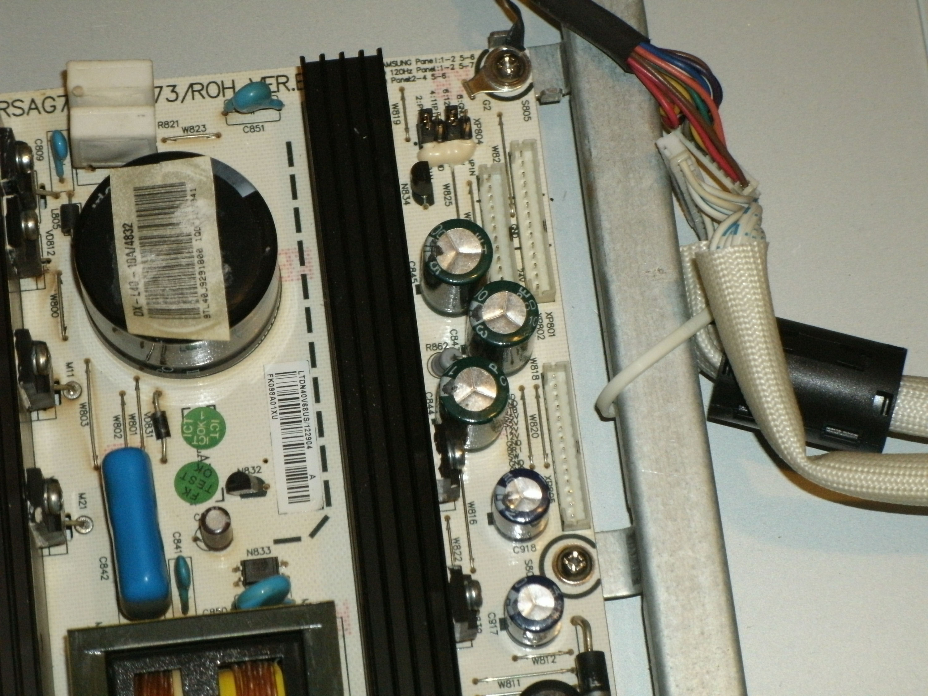

    There's been quite a few issues with this power supply and it usually turns out to be that blue C842 capacitor. It usually shows very few external failure signs.
      Re: DYNEX 40" Model DX-L40-10A/4832 Will not power on.
      Ok, I will replace it tomorrow if I can get it at my local electronics depot here. If not I will to order it. mine has these markings on it : 2000v 22 nJ do you know of a suitable replacement ?

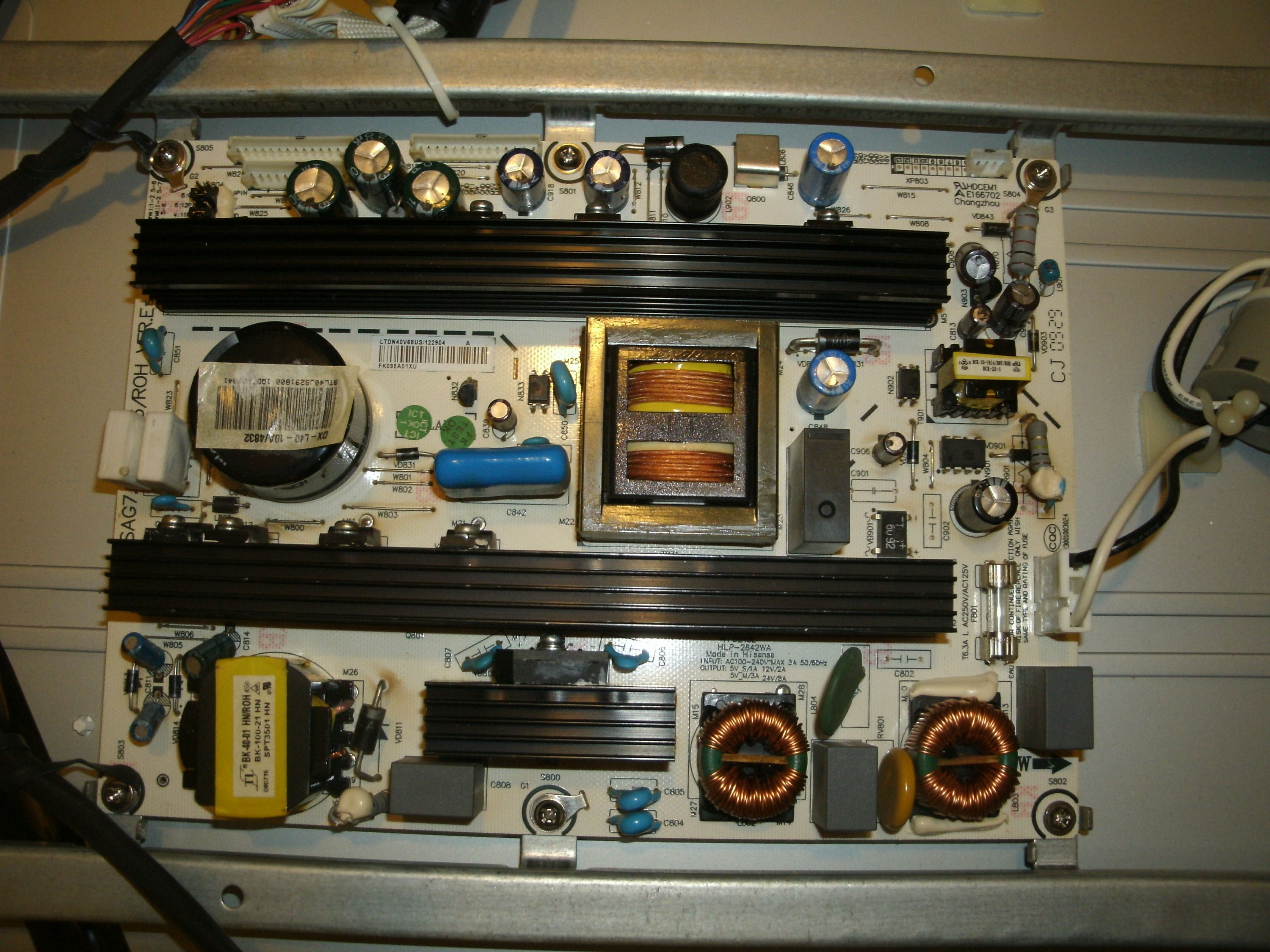

                  Ok, so I have tested the output of the pins going to the inverters. I attached a pic with the results, which are as follows.
                  Once again, with only the AC attached, haven't touched the power button.
                  Pins 1-5 have 24v, the second last pin has 5v
                  So to re-cap with only the AC attached, WITHOUT turning on the unit, I am getting the 5V, 12V and 24V signals. But the unit stays on Standby (red light) no response from the power button on TV or remote. And apparently no backlight at all.

                                      I just wanted to inform everyone that the root cause of my problem seemed to be that 3 capacitors tested HIGH ESR. They are: C811 (10uF/25V), C812(10uF/25V), and C814 (100uF/35V). C814 was not too bad, but replaced anyway... C811 and C812 wouldn't even register on my ESR meter so they must have been quite bad.
                                      All other caps on this power supply tested ok, including the potential suspect C842 which measured at 22nF...
                                      Thought I'd share this info in case anyone else has same issue and I can save them some time
