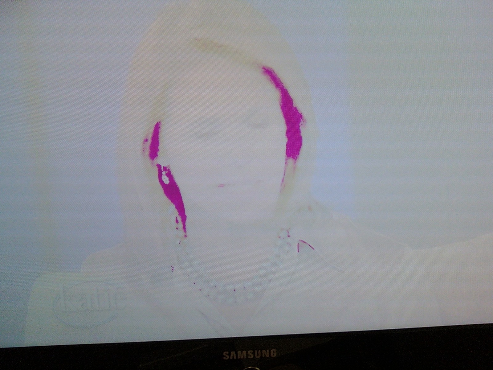

    Samsung LN-T3242H
    it's got a very "washed out" picture, like the luminence is up too high. the picture is normal for about the first 5 seconds it's turned on from stone cold. if it's the least bit warm, it starts up with the problem happening.
    i've freeze sprayed every component i can find, to no avail.
    sorry about the no pictures, but of course, i'm in one place and my card reader is in another. hopefully, tonight i can post some.
    i do have the service manual, but so far it hasn't helped me.

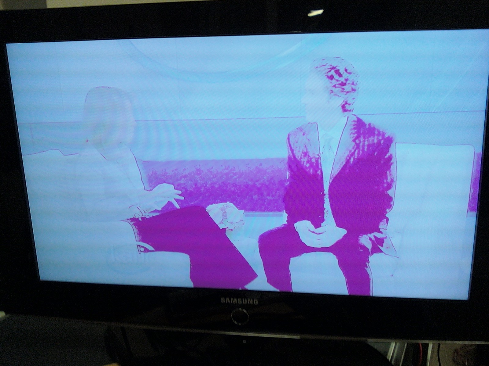

    Re: Samsung LN-T3242H
    these are examples of the "washed out" screen:
      Please can you update your profile with country and mains voltage.
      Initial thing to check would be the cables to the panel. Any that are removable, remoe clean and reseat.
      Have you tried different sources.
        thanks for the reply, selldoor.
        as you can now see, i've updated my profile.
        i've tried component input, with the same result.
        i'll try to find the panel connectors, clean and reseat them.
        the picture does seem to improve somewhat if i whack the side of the t.v.
            selldoor - there were 2 ribbon cables that led from a small board (referred to in the service literature as LVDS or LDVS) to 2 smaller circuit boards that seem to connect directly to the lcd panel.
            i took off the cables, cleaned them and reinstalled them. no effect.
            i'm afraid to remove the small boards that connect to the panel. don't want to screw things up. do you think it will be safe to do?
            ben7 - i'm a tech, but i'm not really familiar with lcd tv's. it doesn't "feel" like a bad solder joint.
            and my mother says i'll need glasses someday if i keep whacking it.
                Please provide clear pictures of your boards including close shots of each connector from the PSU.
                Have you done any testing yet?
                  I'd think more or less a gamma issue within the AS15 processor on the tcon board. Qouks need to confirm voltages
                    Yeah was thinking it might have the AS15 in it.
                      I'd try a tcon, if you can get one reasonable, if it don't work, you can rule it out and you'll have a spare, thats if the one you buy is good.
                        as15 sounds right just need voltage on gamma 1-22 ?
