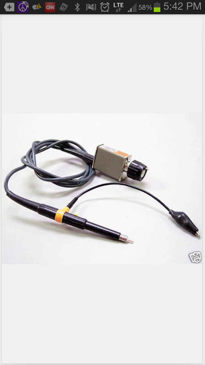

                Excellent insight. I think I only have 2 10x probes, they both terminate in little metal boxes. Is a 1x probe the same without the box ?
                  #208
                  Re: Samsung 50" Plasma HPT5044 No Picture
                  I have never seen a probe terminate into a little metal box...

                    #209
                    Like so... the box has the bnc male connector built into it.
                    • Agent24
                      I see dead caps
                      • Oct 2007
                      • 5037
                      • New Zealand
                      #210
                      That box probably has the adjustment capacitor in it, probably just older and bigger than most.

                        There IS an adjustment pot on the one side. So in this case is a 1x probe physically different from a 10x probe other than that little box ? I ask because I have another probe that doesn't terminate in the box but not in a bnc connector either.

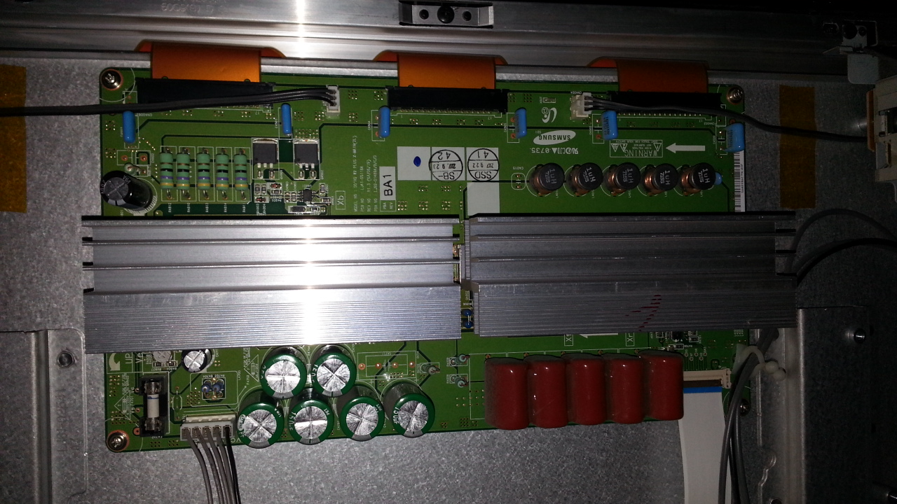

                                Hey tom here's a pic of my xmain could you point out where to attach scope probes to check its waveform ? Thabks

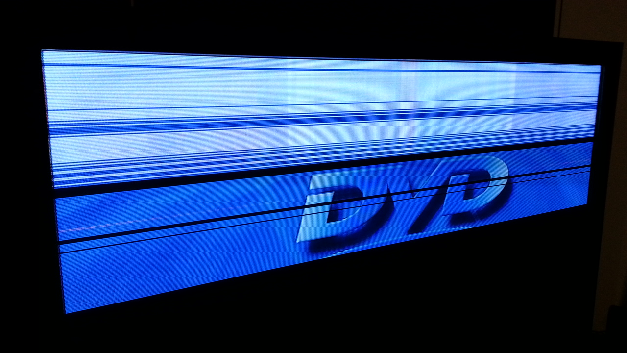

                                  Since both YMAINS appeared identical (and non-shorted) in circuit I went ahead and installed the buffers one at a time.
                                  With upper buffer alone there was no green light on the YMAIN but the buffer ic's look like they need some work as there were many black or white scan lines.
                                  When I installed the lower buffer as well I didn't manage to get a look at the screen as almost right away the YMAIN protection/fault led came on so I pulled the plug. Both buffers still register NO shorts.
                                  Since the buffers on these sets seem to run in series from upper down to lower could the upper buffer having so many no connects and possible output-pin shorts cause a cascade effect to the lower buffer which would throw the YMAIN into protection ?

                                    This is what it looks like when you do a piss poor job on the top two ic's on the upper buffer board. Much better job on the bottom two.
                                    Soon after the pic was taken there was a "snap!" and the top ic was blown. Strange artifacts on the upper half of the screen I hope will be cured by a better soldering job.

                                      You can hook your probe on the right hand side of the blue caps on the X-main, near the orange ribbons; looking at the image though, you do not have an X-main problem, just an issue with buffer IC soldering or loose/misaligned connectors for the panel ribbons.
