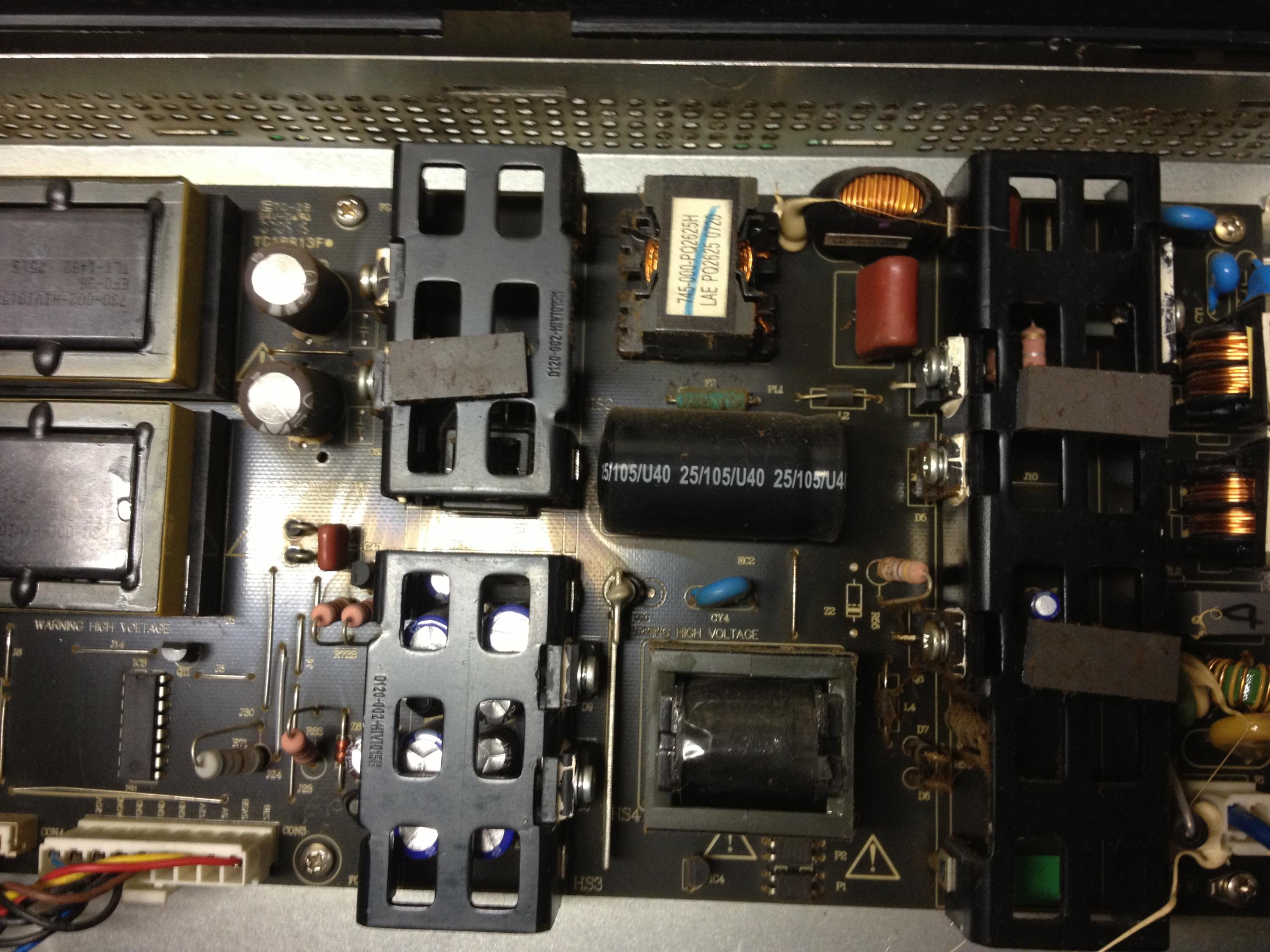

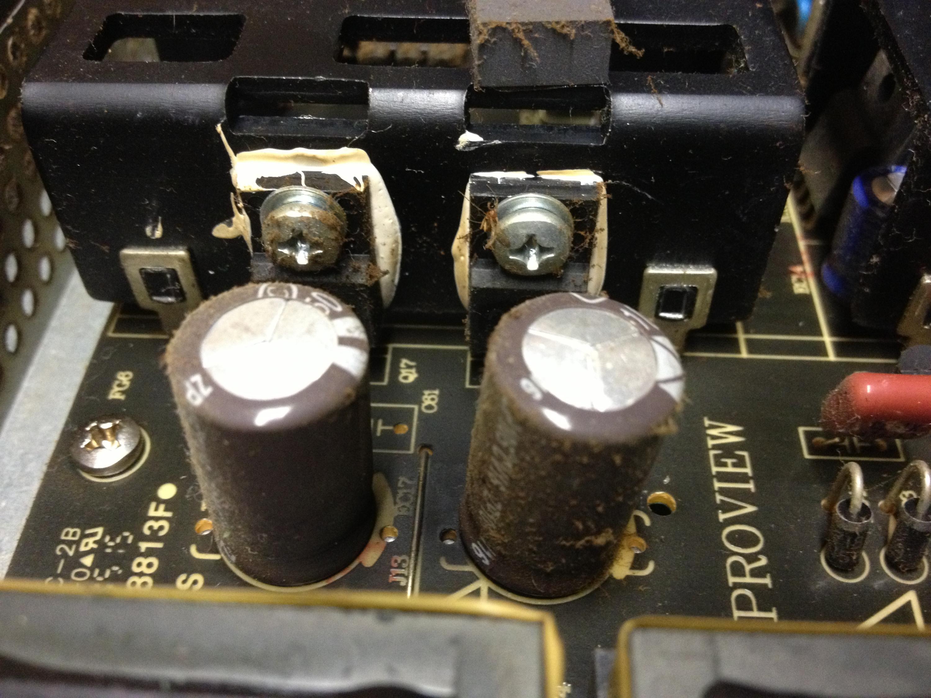

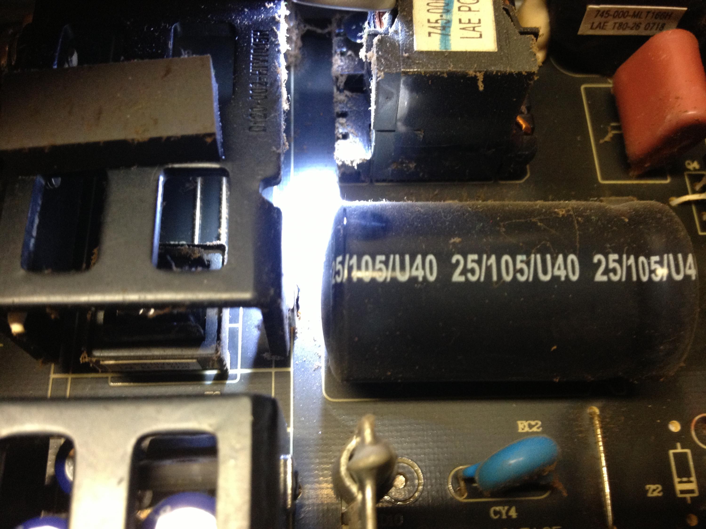

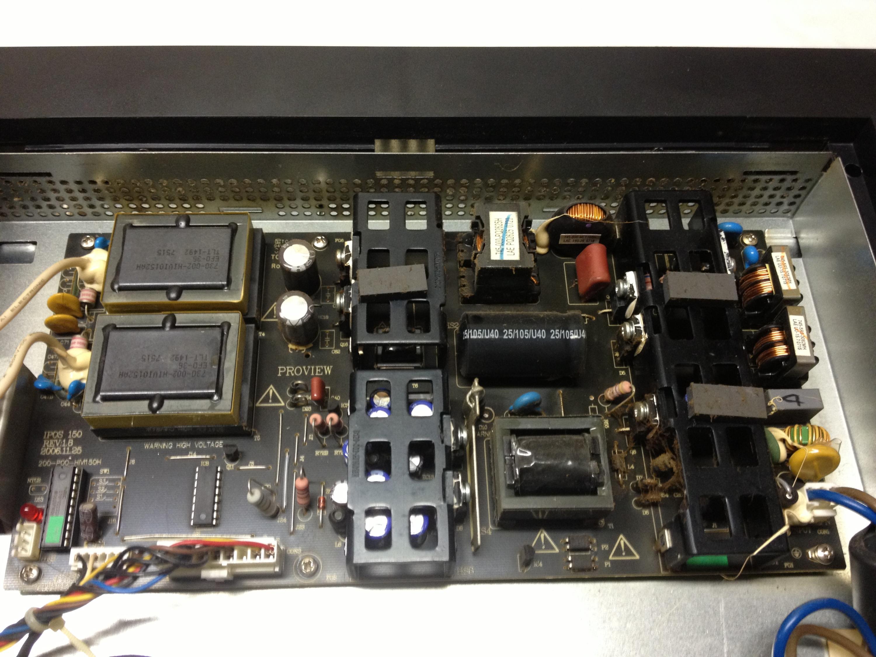

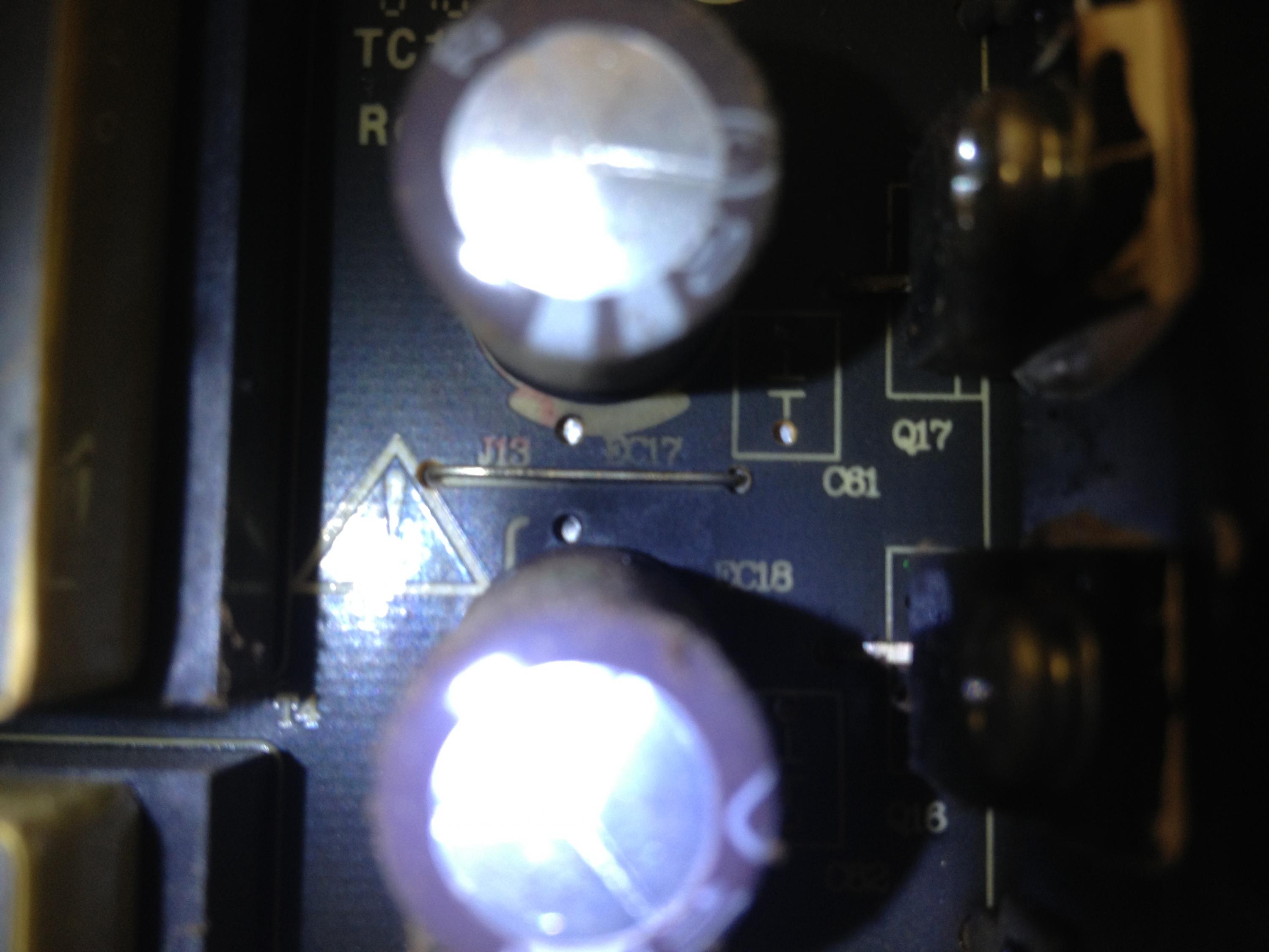

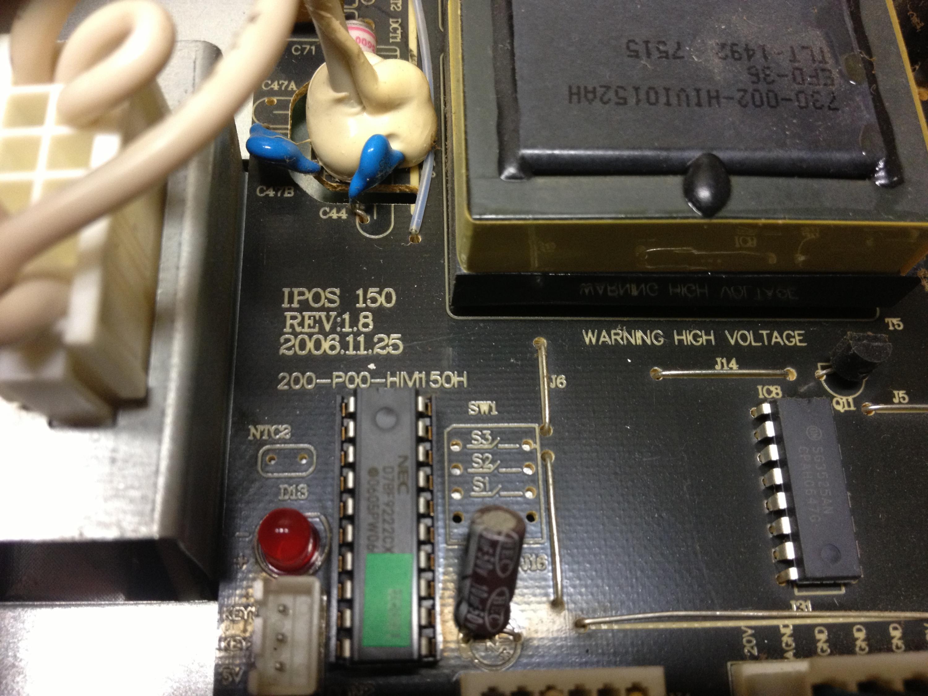

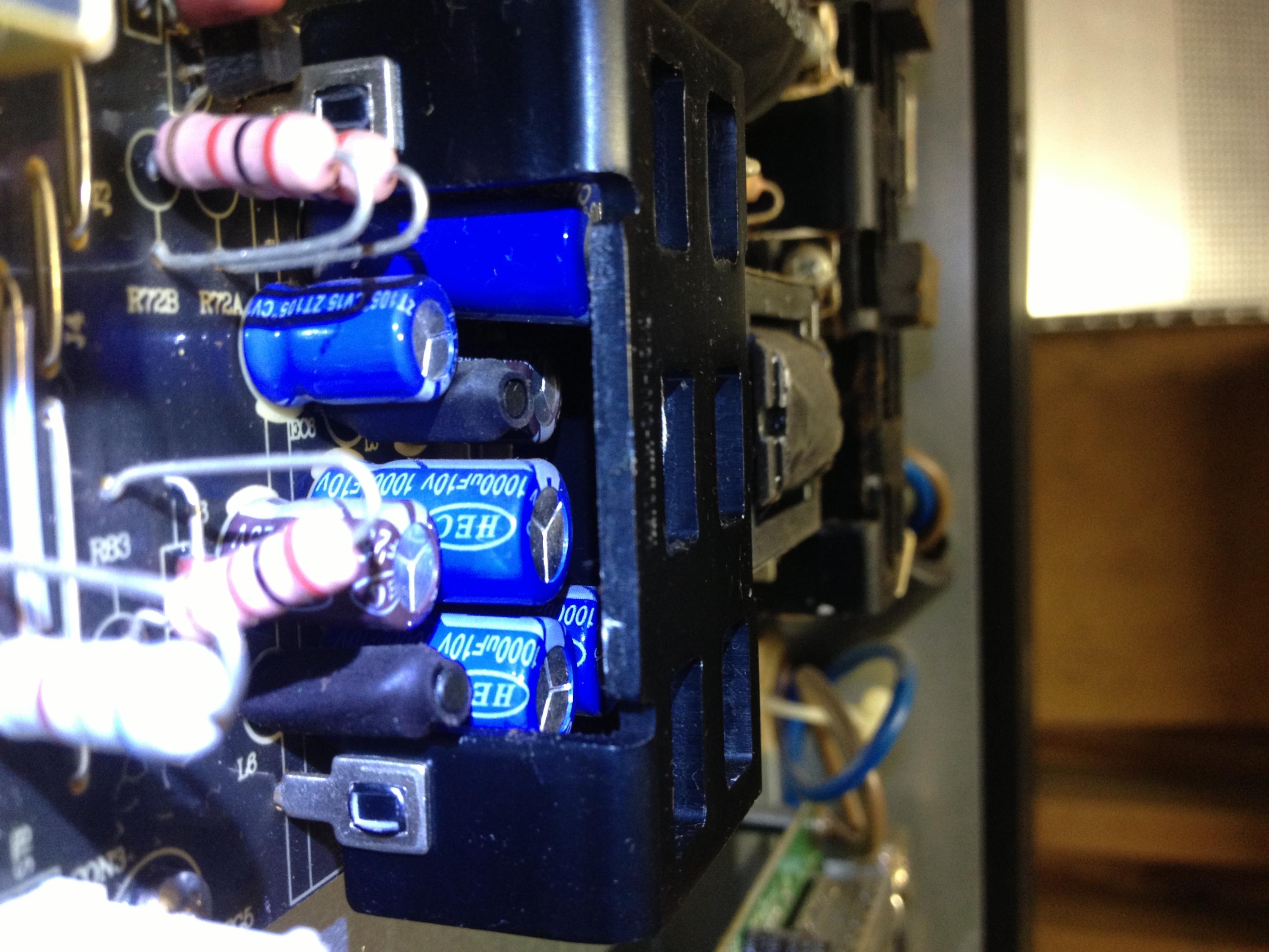

    Hello, I found this TV in a rental I cleaned out. Here's what it's doing. Red standby light comes on when plugged in. Blue light comes on when I push power button. DVD player operates and shuts off. There is no picture. I put a flash light to the front and could see it reading no signal. I pushed the menu button and could see the menu. I took the back off and can see where the board got really hot under the two caps that normally go. Also the biggest cap has a dome top. I was thinking starting with these three caps. Who's the best place to get just those three caps? Thanks for your response. I attached some pics to look at. Also, the red LED on the back blinks with power on. Oh, sorry if the pics are to big. I had no way to scale them down on my iPhone. let me know if their to much.

    pics are just fine as far as i can see. i would sugest replaceing all of them if you can get at them all. you can get caps from ither badcaps.net they sell them or http://www.digikey.com/

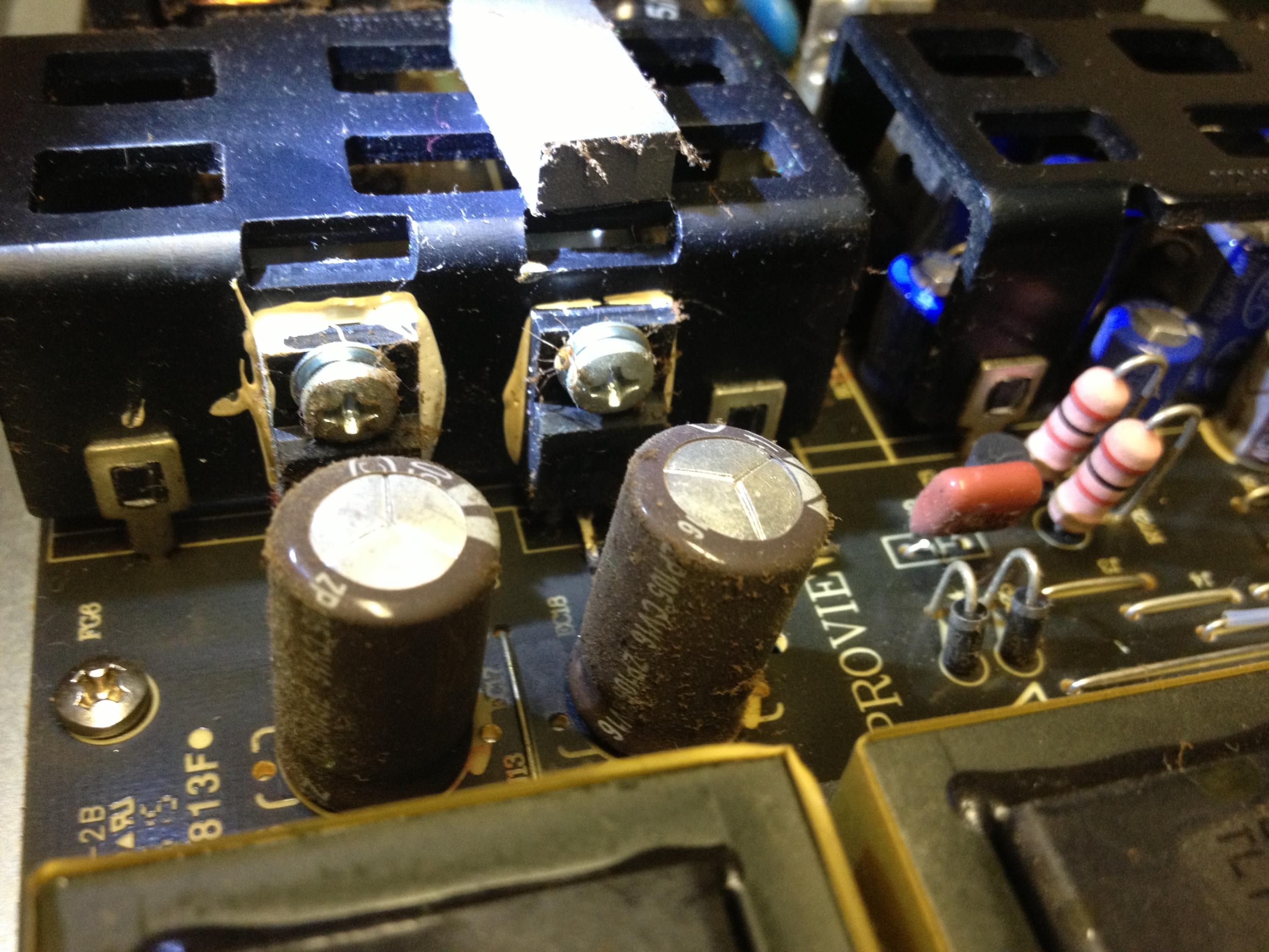

      Those two 450V for the backlights power supply are bad, you can see the domed top, they are common failure. Might as well replace all the caps at the same time.

        hi i have just repaired one off these power supply boards the two 10uf 450v caps at ec17/18 need to be replaced ,then check if it works if it does fine if not check fuse F2 along side the big cap looks like a green ressitor if this is ok replace Q16/17 mosfet 9a 500v but try the 10uf 450v caps, by the way the red LED needs to be out when the board is working it is only on when faulty
