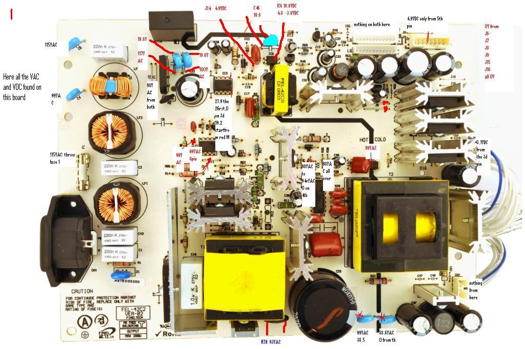

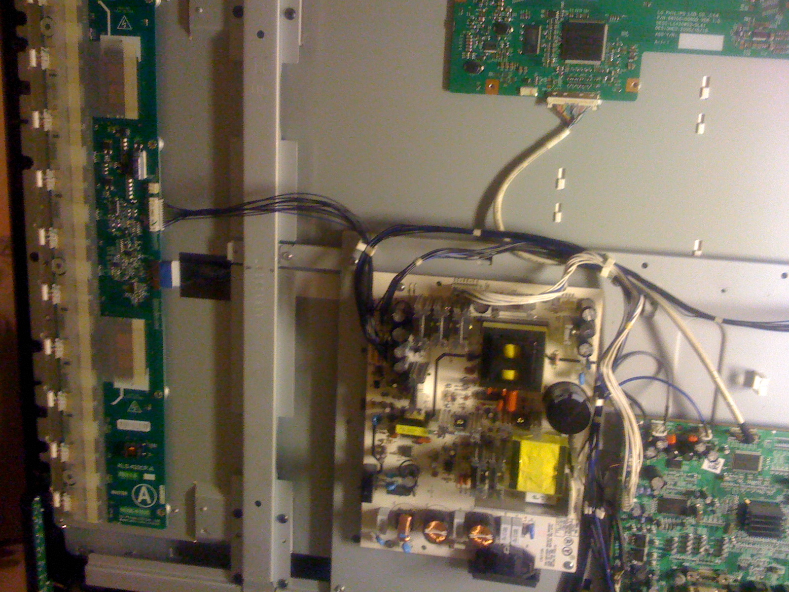

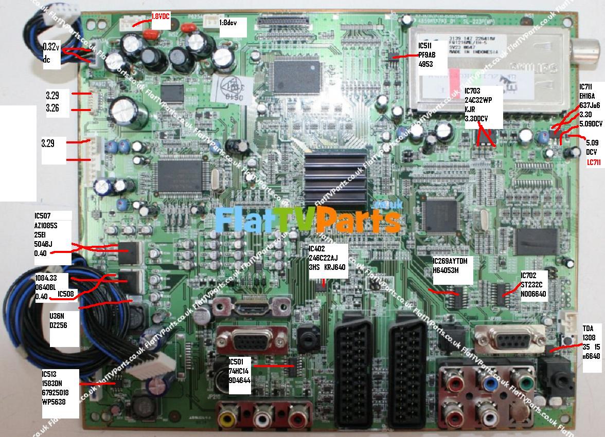

    Daewoo LCD 42" model DLP-42C1
    hey everyone i have this Daewoo that I have found in garbage, I thought it would be easy with a few capacitors to be replaced but i found a blown resistor R14 on the power board I hope you can help me.I have taken some pictures but they were bad so I add here a copy from the internet I have done some measurements but I'm not sure if they are right for my dmm is not of the best quality but I have a "Digi Check 3 from Steiner" that did the trick when it comes to VAC and VDC I have started with power board FEL-42-C2 on which I have marked the different values of the image itself and som images of the tv i have to say that all the DCV are done with power on otherwise nothing att all.We use 220VAC in Stockholm.Any help are realy welcome thank you

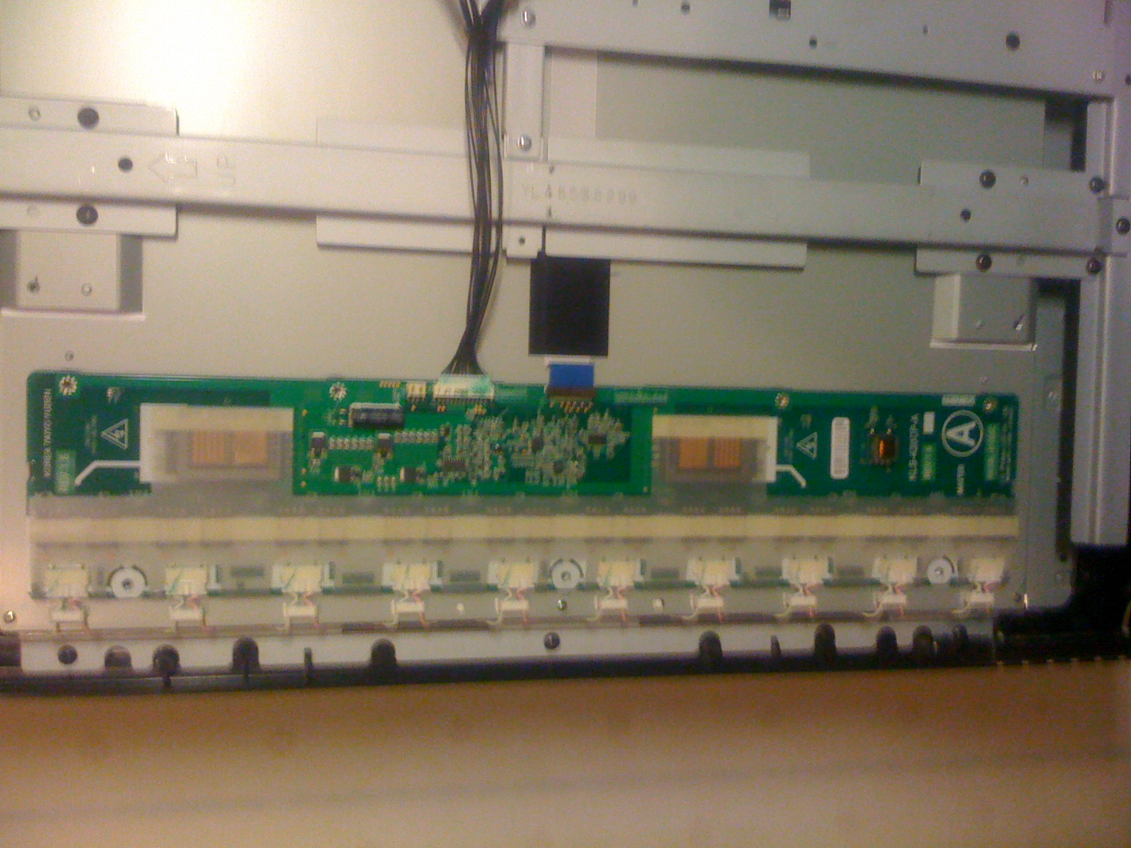

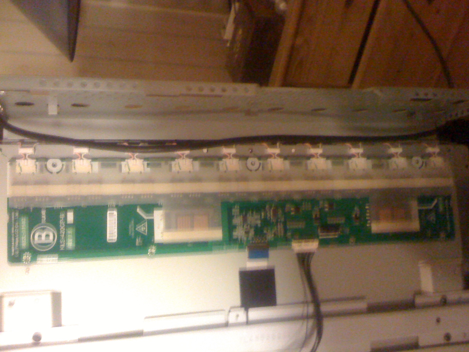

      Re: Daewoo LCD 42" model DLP-42C1
      No one is going to help you without good pictures of your boards. Distance troubleshooting is too difficult without them.
        thank you i´ll try to fix a better pics very soon i hope

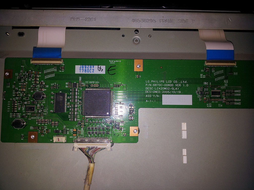

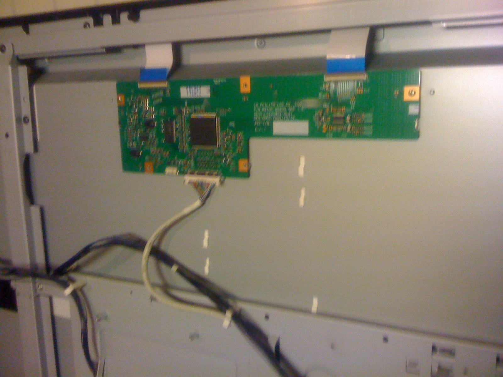

          Hi i add here a new pic of the TCON it is the best i can get jut now
          but please Selldoor the pic of the power board is quite clear no?
          thank you
                            so i have to start with the main first i did some mesure on it only when power is on
                            i ll add a pic so you can se but i am using my iphone for that and the result is very bad anyhow i add here a pic from the net

                              Test the regulators:
                              https://www.badcaps.net/forum/showthread.php?p=274391
                                wich ones? i did as you se on all
                                  See the post -- it explains exactly how we like the data presented.

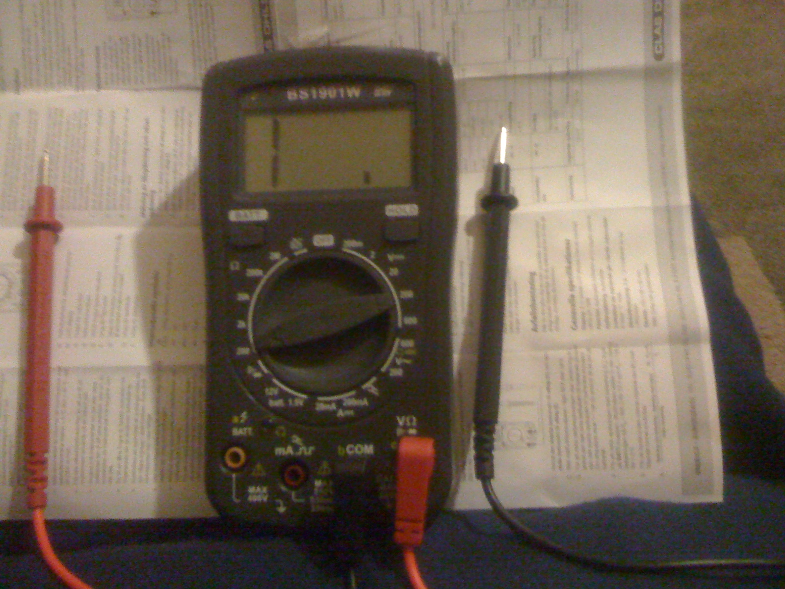

                                        hi again first i want to explain that i have an usual Dmm :BST=British Standard Tester
                                        model number BS1901W and when i test with this on ohms he is standing all the time on 1 to the left side of the screen it seems to be normal when i asked the seller here is some pics
