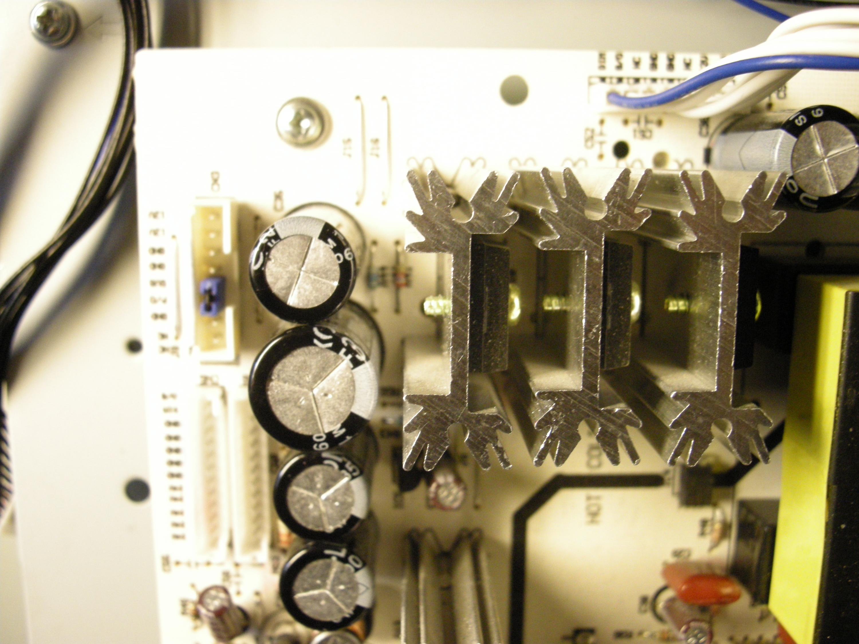

                    #29
                    Re: Daewoo LCD 42" model DLP-42C1
                    Hi tom,selldoor
                    The dmm is quite ok i did test a new battery and it is ok
                    i think is something on the psu ho is not corect yet maybe the big capacitor that i replaced
                    the old one :180uF450v and the new one have 220uF450v i d´ont know if it can affect
                    or maybe because i use a pc jumper with out a transistor to short the 5vs and P/O pins

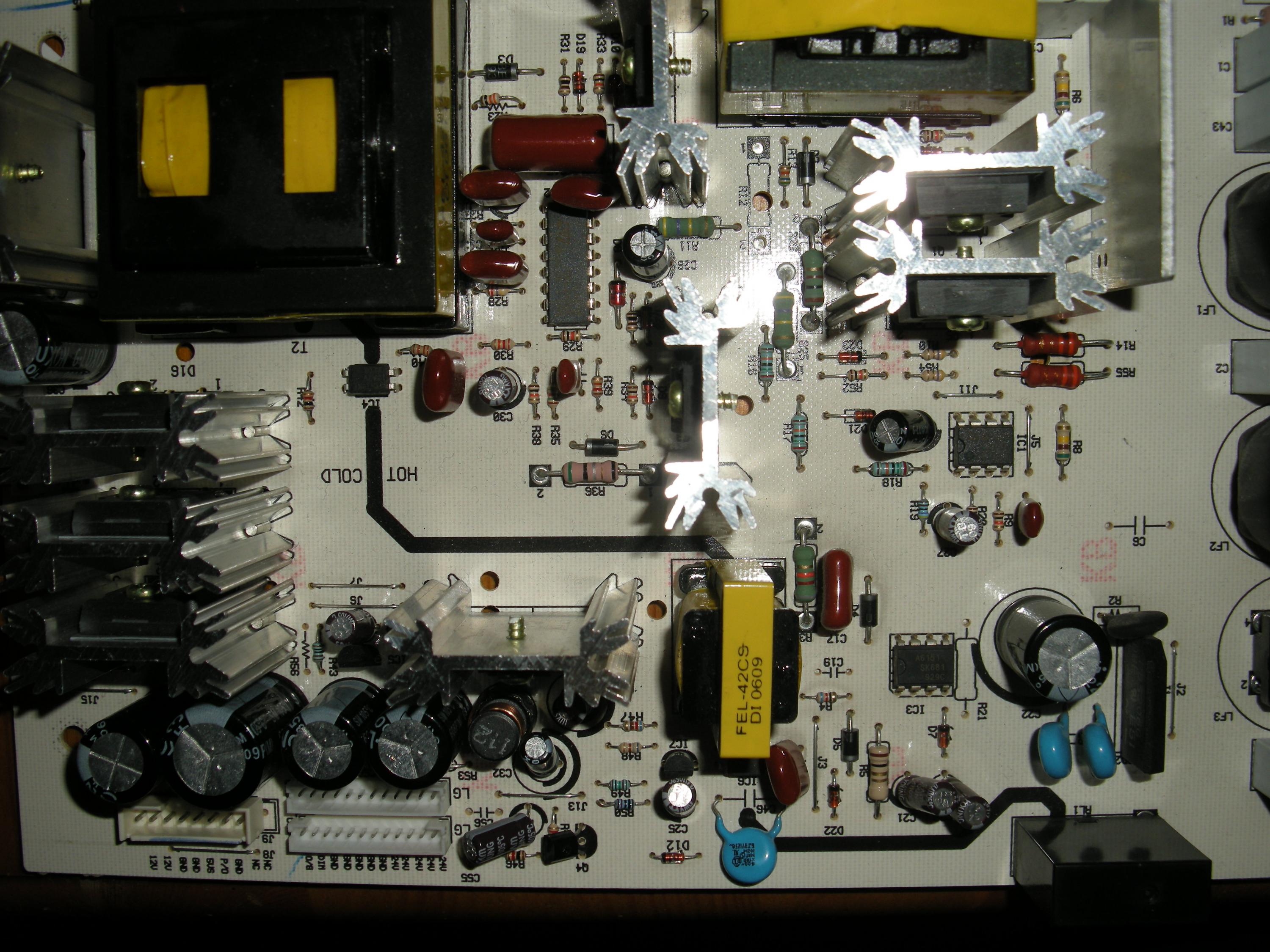

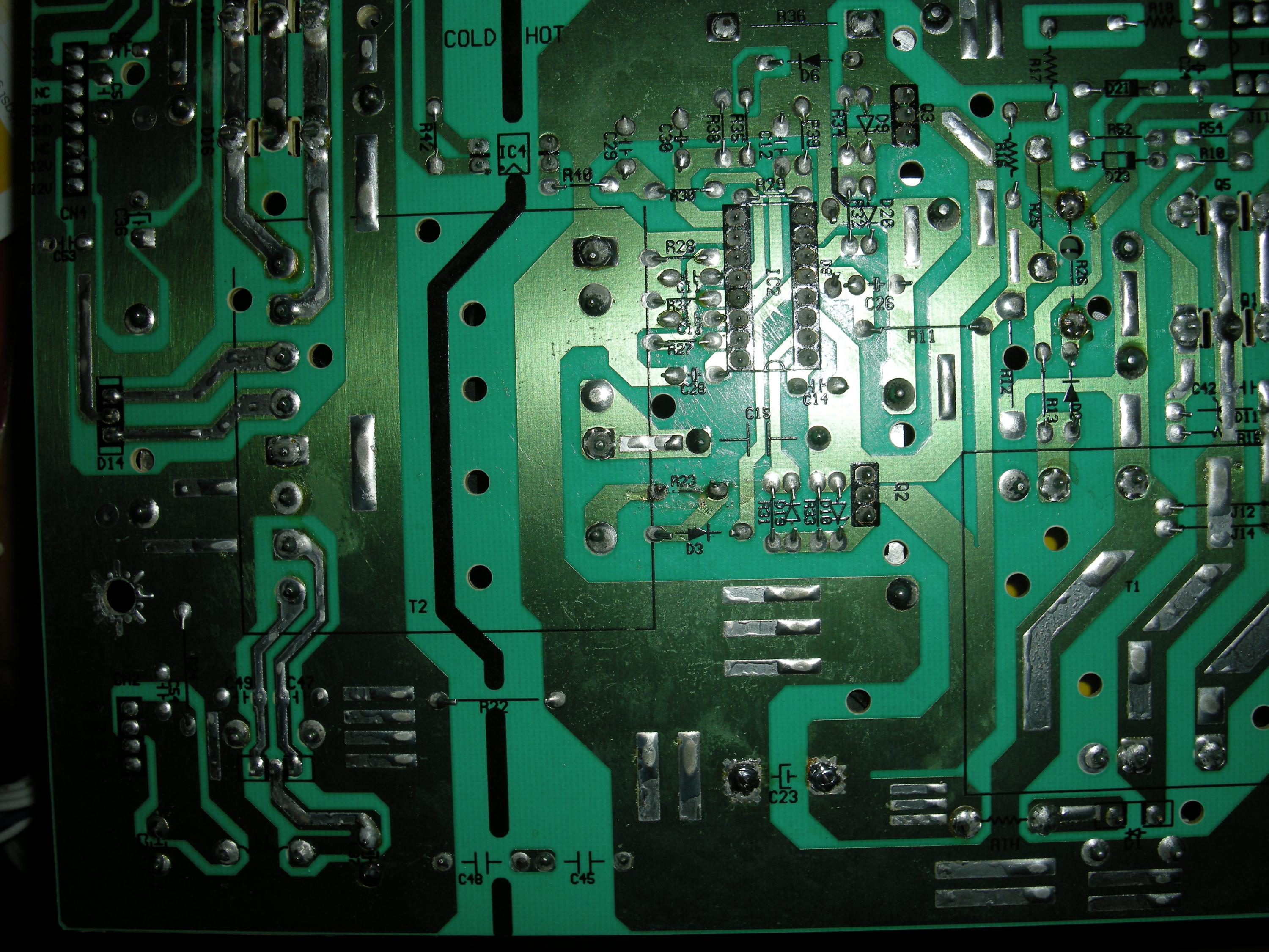

                    as you can se on the attached pics
                    selldoor yes i have a camera now lol here some pics
                    thank you

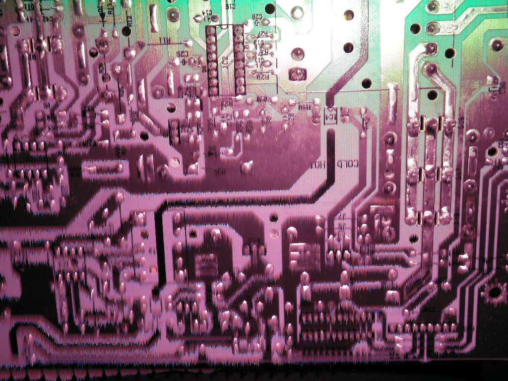

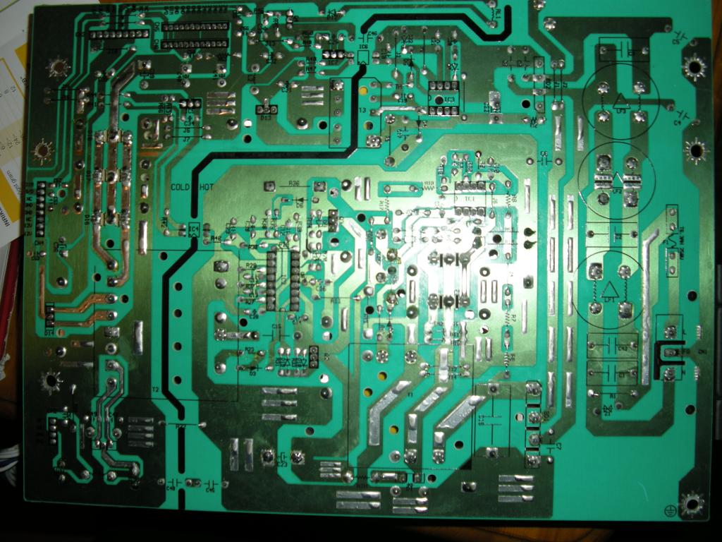

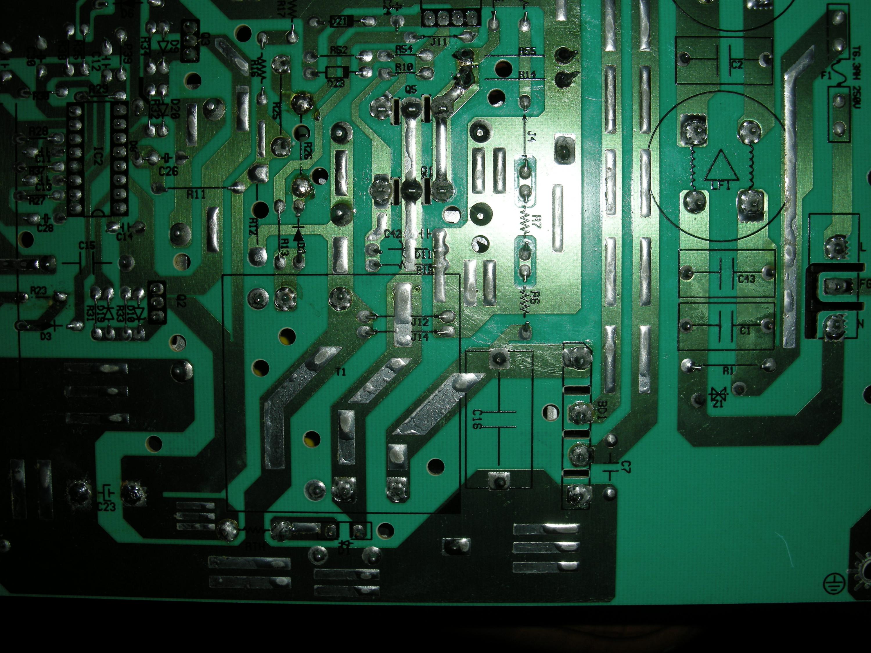

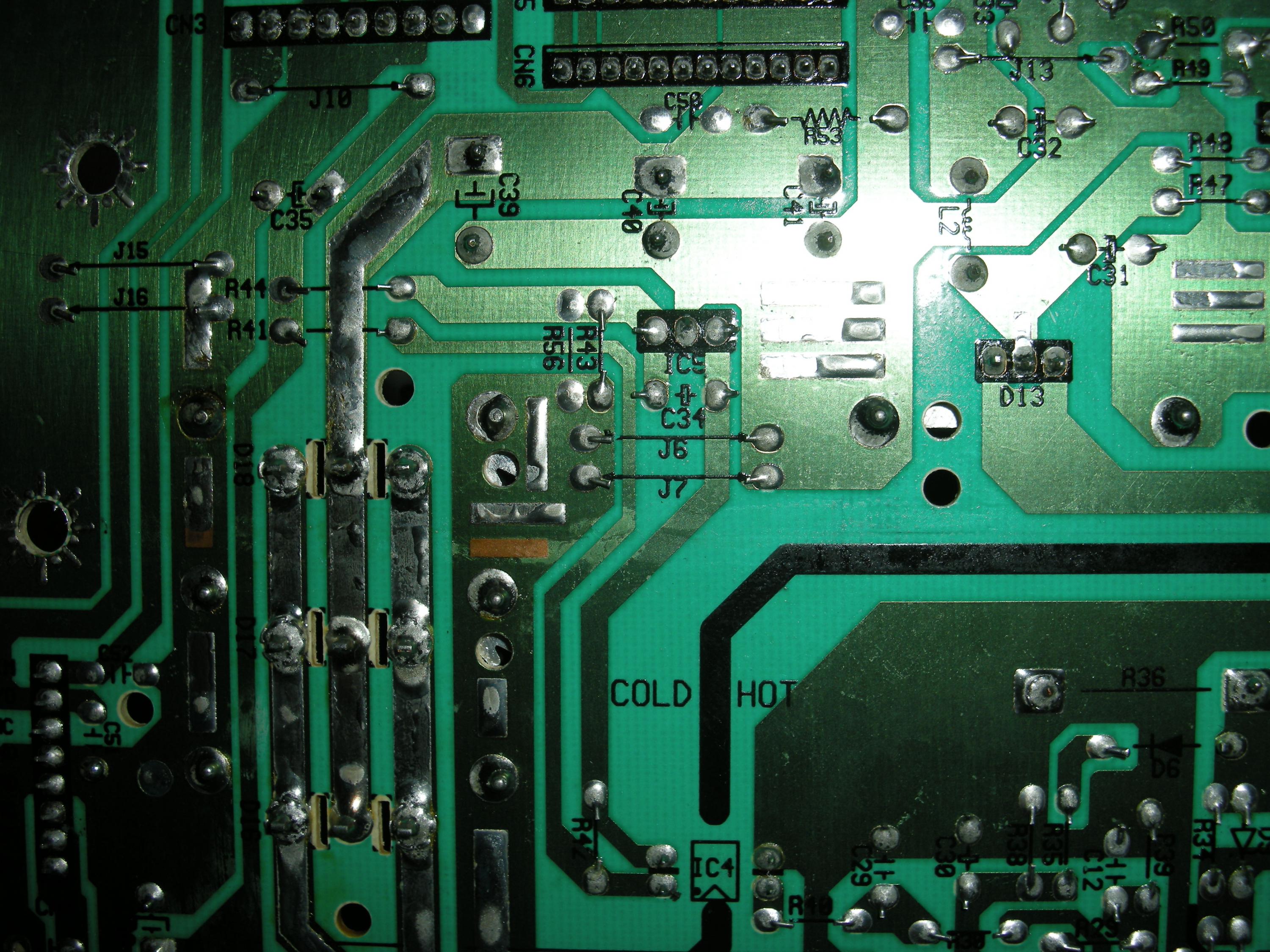

                      #30
                      Hmm not sure about the photos - perhaps try again in daylight near a window if it ever gets light in Sweden.
                      The flash makes every joint look suspect!
                      If you can get it, one decent well lit picture of the whole board is better to follow.
                      Resistors R14 and R55 dont look soldered back on the left side?
                      Re you measuring VAC are you sure your meter was set on AC
                      not DC and what did you use for ground? On the primary side it is usual to use the negative leg of the Big cap ,not the chassis or ground screw.

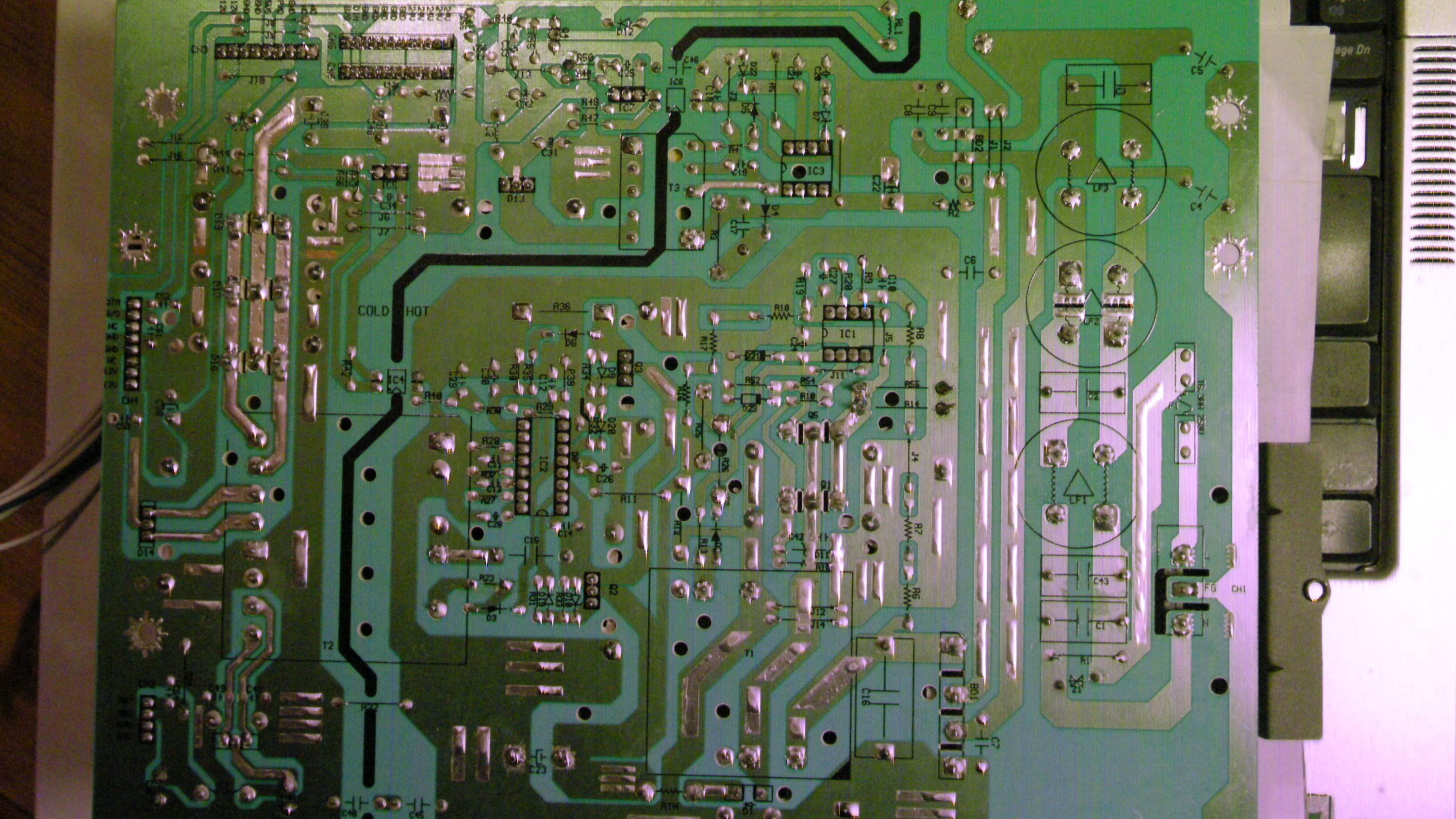

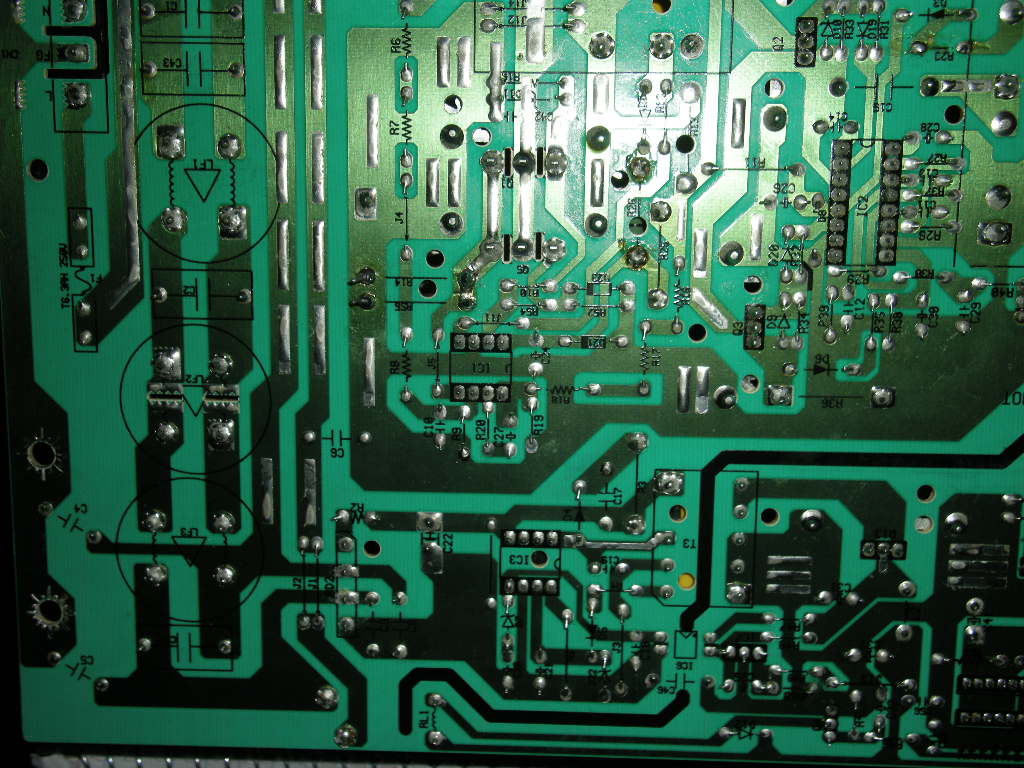

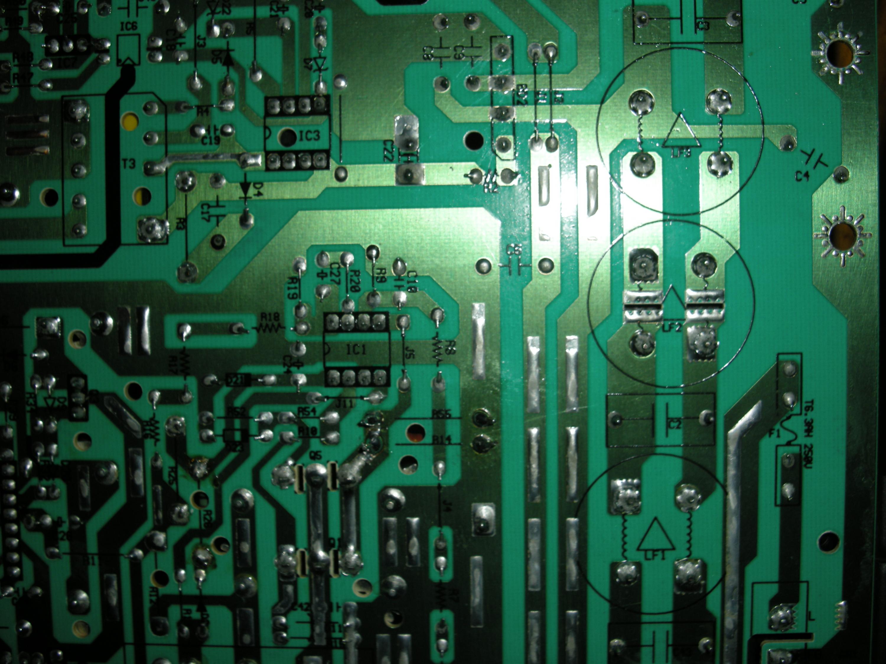

                          Hi again selldoor here some pics i hope they are better you did not say anything about the big cap i assume it is ok then or do i have to put back the 180uF 450v
                          thank you
