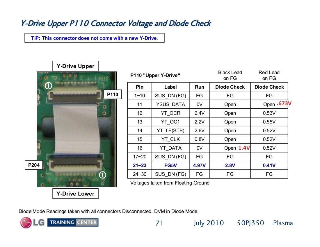

                  I have not been able to do the run tests on anything but the power board. The Y-SUS and Z-SUS have multiple shorted\damaged FETs.
                  3) The only test on page 71 that would lead to some ambiguity is pins 21-23. It says the "correct" reading is 2.8V. If your 77 IV shows 0L and around 0.41V, I would say it is probably good.
                  I used a poor choice of words to discribe my results. Two readings were completely different from what the book said they should be when tested.
                  YSUS_DATA (Red probe on FG) was supposed to be open but I had a reading of .637V
                  YT_DATA (Black probe on FG) was supposed to be open but I had a reading of 1.4V
                  My issue with the manual is that I have found several mistakes throughout it which makes me have doubts about completely trusting it. Look at page 110 for example. D1, D501, D504, and D505 pin "C" is being called pin "A". On page 69 it has:

                    Re: LG 50PJ350-UB Power board problem
                    Unless the diode reading reads the same both ways or very low (like 0.023V), I usually don't tread the above readings as a short especially when they are done in circuit.
                    On the Fluke that I'm trying to fix, I measured a zener diode in circuit and it showed 0.023V both ways. I desoldered on leg to verify, found it was good, tried to re-insert it and the other leg broke off!
                    For finding shorts, I like to use resistance measurements or continuity. On the Fluke 77 IV, continuity is defined as less than 25 ohms. If it beeps, it is likely shorted. As you know, the Fluke continuity feature is very fast.
                    Either that or there are multiple revisions of the board and you may not have the same one?
                    I would have tried to repair these boards if I could have sourced the FETs for a reasonable price but I got the entire boards for approximately the same price and I do not have to wait for them to get here from China.

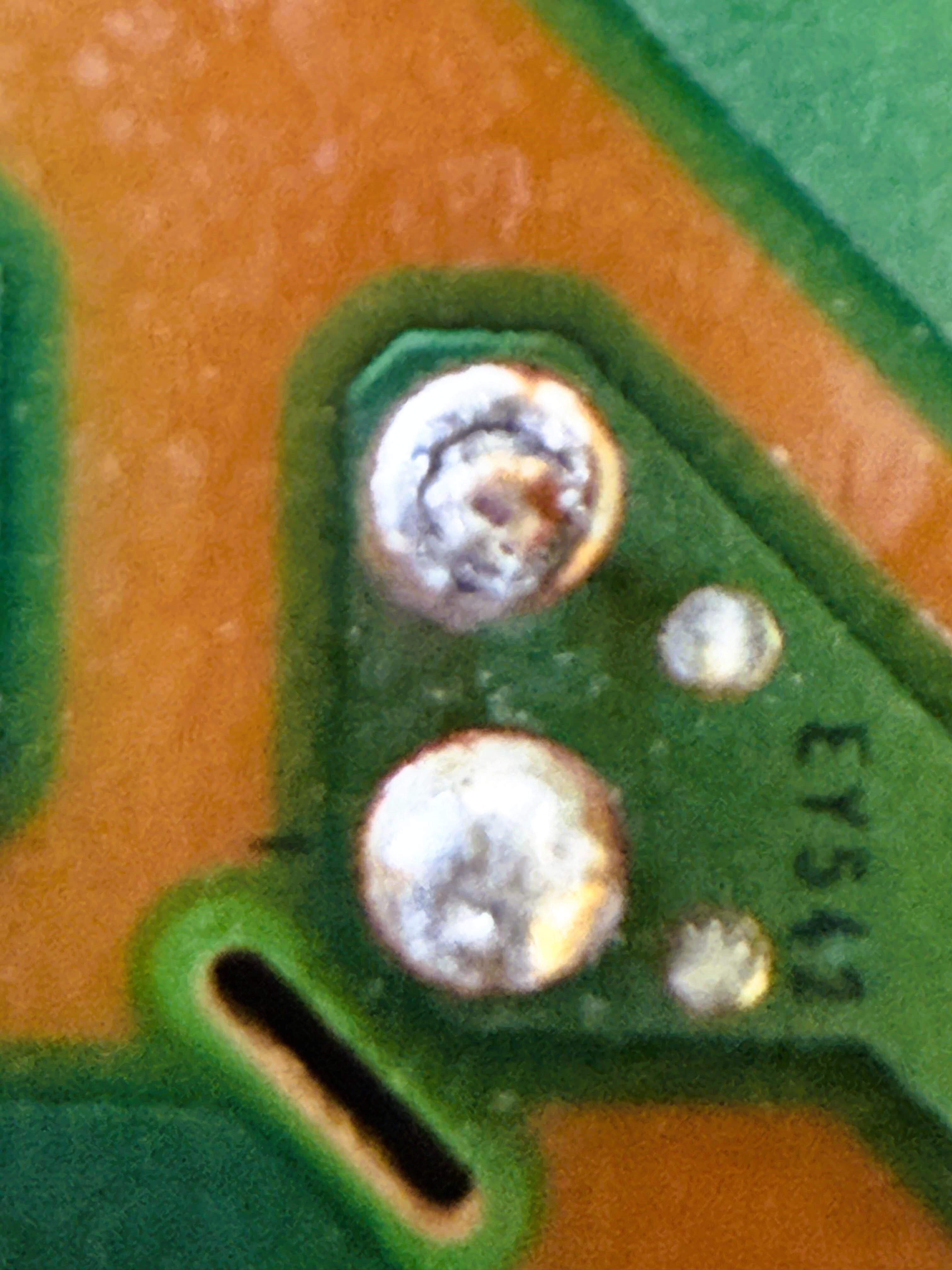

                                      For what it's worth , I had one of these (50PJ340-UC) in for repair, bought the repair kit, installed everything correctly, and all I got was the "click" twice just as before.
                                      5v was present all the time.
                                      After inspecting the P/S board with a magnifier very carefully, I found poor solder joints on the two big yellow xformers . (Very small rings around the joints) After re soldering,
                                      Everything worked just fine !

                                        Repaired 2 of these Power Supply boards recently with both suffering cold solder joints.
