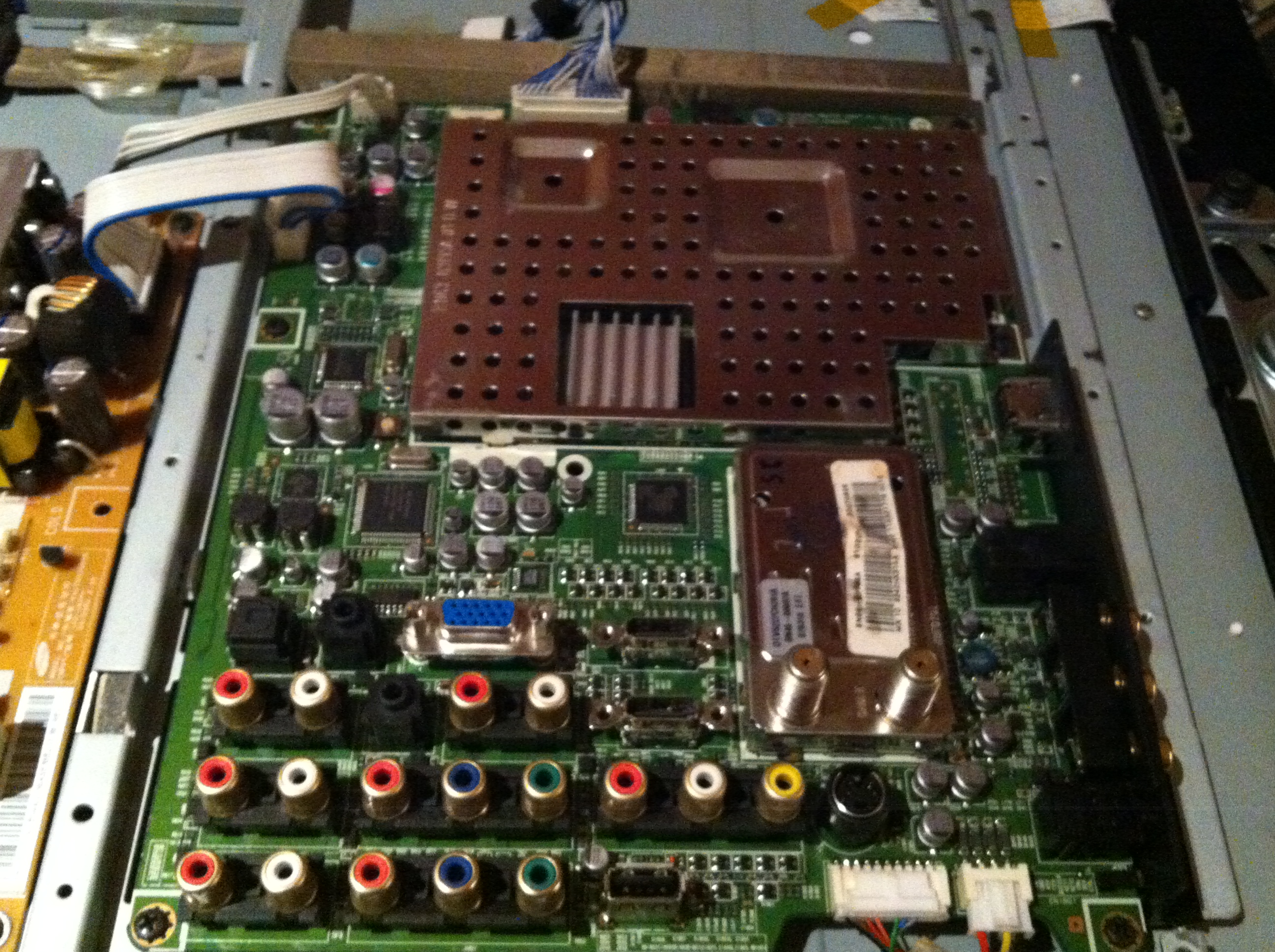

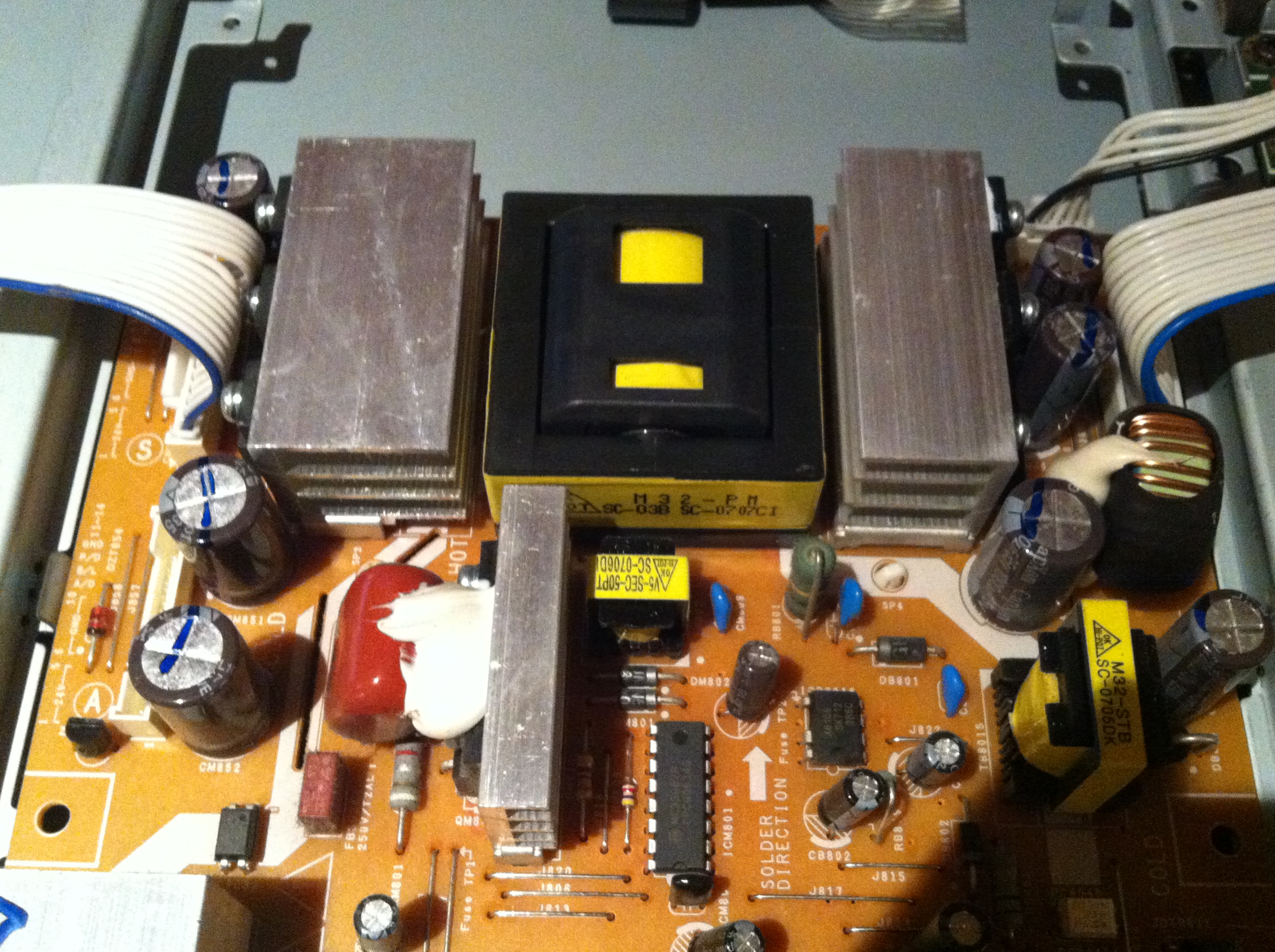

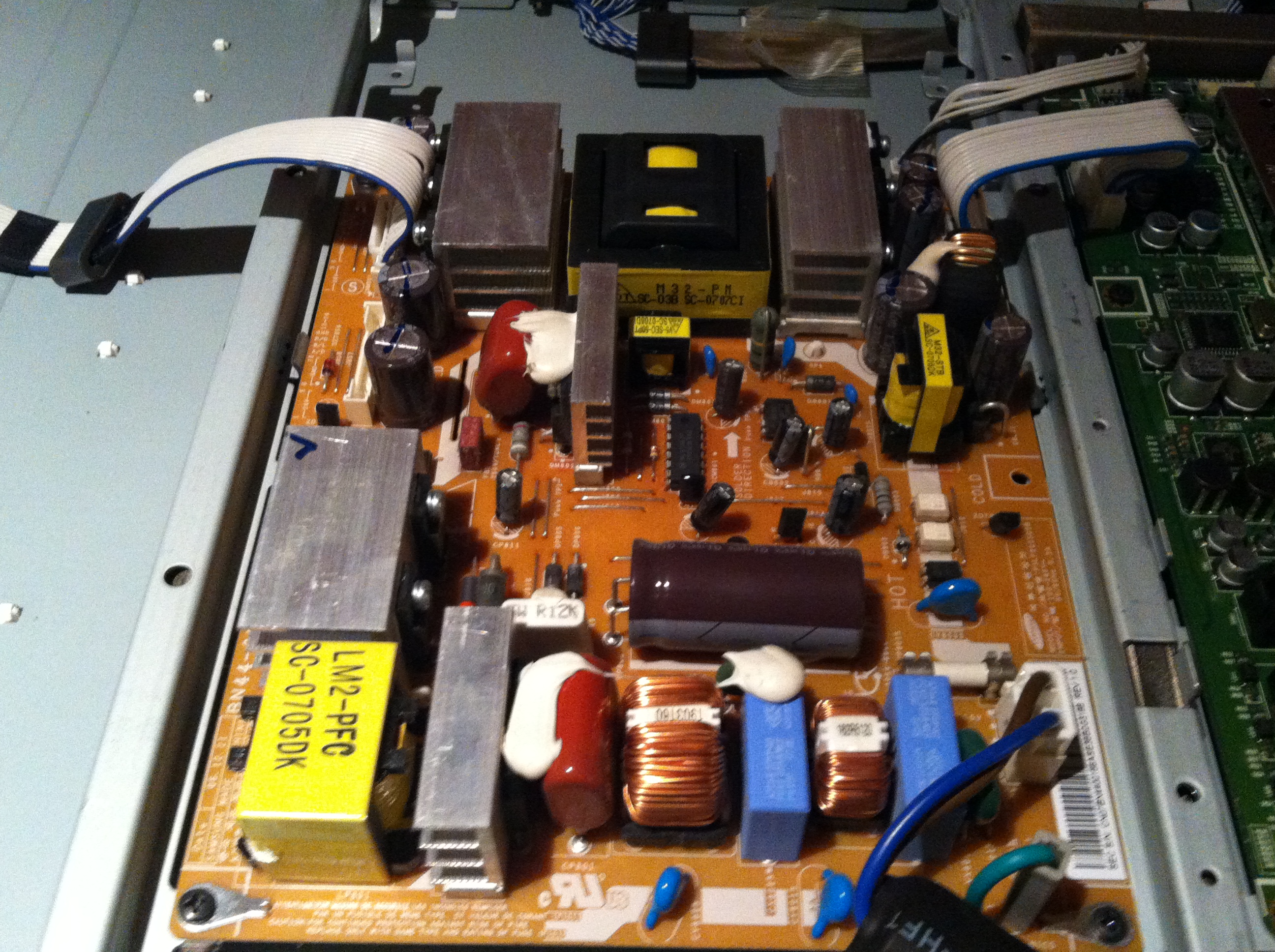

    I've got a Samsung 32" LCD TV. While watching it one day, I switched channels and then hit the "last" button quickly, and the screen went black. Audio works great.
    The testing I have done thus far:
    - After leaving tv on overnight (~7-10 hours), still no picture
    - After 24 hours unplugged, still no picture
    - Shining flash light on screen in dark room shows no hint of image on screen
    - No back lighting around edges of screen in dark room
    - No apparent bulging or leaking capacitors or burnt components
    Model: LNT3242HX/XAA
    Series: AH6S3CHP309942H
    Version: PP01
    A service manual, or any additional input would be greatly appreciated. I'd rather try fixing it before giving it up (it is 5 years old, so rather than pay to have it repaired, we'd rather get a new one later down the road). I'd like to save it because I hate to add to the landfill... but, if there's no chance, then I'll guess I'll have to.
    Any suggestions are welcome.
