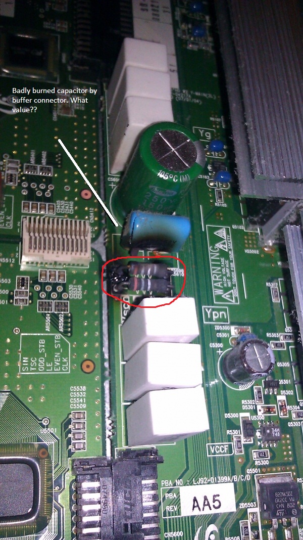

    I was wondering if someone could tell me what the values are for the two resistors in the picture I found in the forum, they got really hot due to a shorted upper buffer board and I am not sure of the color bands. All other parts test good.

    Are there any for the lower buffers? Most likely, they will be the same.
      Re: Vizio HDTV20A Y-main JL41-04217A
      No, there are no others that are similar. These two are located in the center of the board between the two buffer board connectors.

        I found this hires picture of a working board:
        http://futuregatetech.com/Websites/f...d5a7eee21d.JPG
        But I still can't be sure on the value :/ Maybe brown black black gold which would make it 10 ohms 5%, looks to be about 3W.

          http://www.shopjimmy.com/samsung-bn96-06519a-y-main.htm
          This shot is also pretty good
          Looks brown,blk,blk gold
          No shorted 88n30W FETs?
