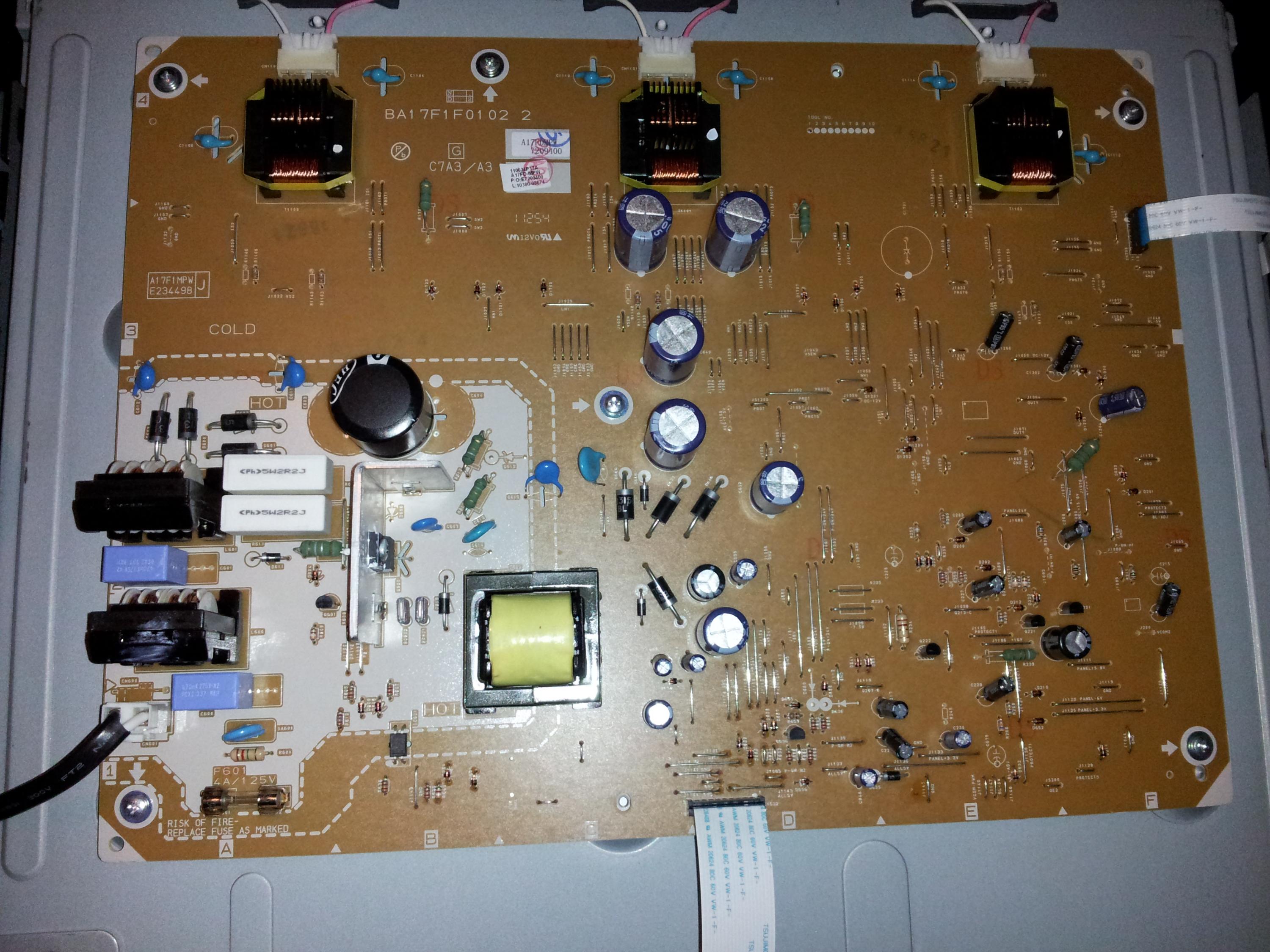

    Long story short, I bought this tv black friday of last year (so one year and 2 days ago) I get home today, try to turn the tv on, the power light just blinks. No screen flash, nothing. Unplugging it and plugging it back in causes the power light to blink 6 or 7 times before going to the usual solid red light of off. I opened up the back, and everything looked good.
    Experience wise, I have been building computers awhile now, but I do not have any tools other than a screwdriver. I can post picutres of the two boards if you all think I should.

    Post a picture if you have a camera. You're going to need a multimeter. I've fixed a sylvanaia and an emerson with a similar power supply and both times it was a shorted diode.

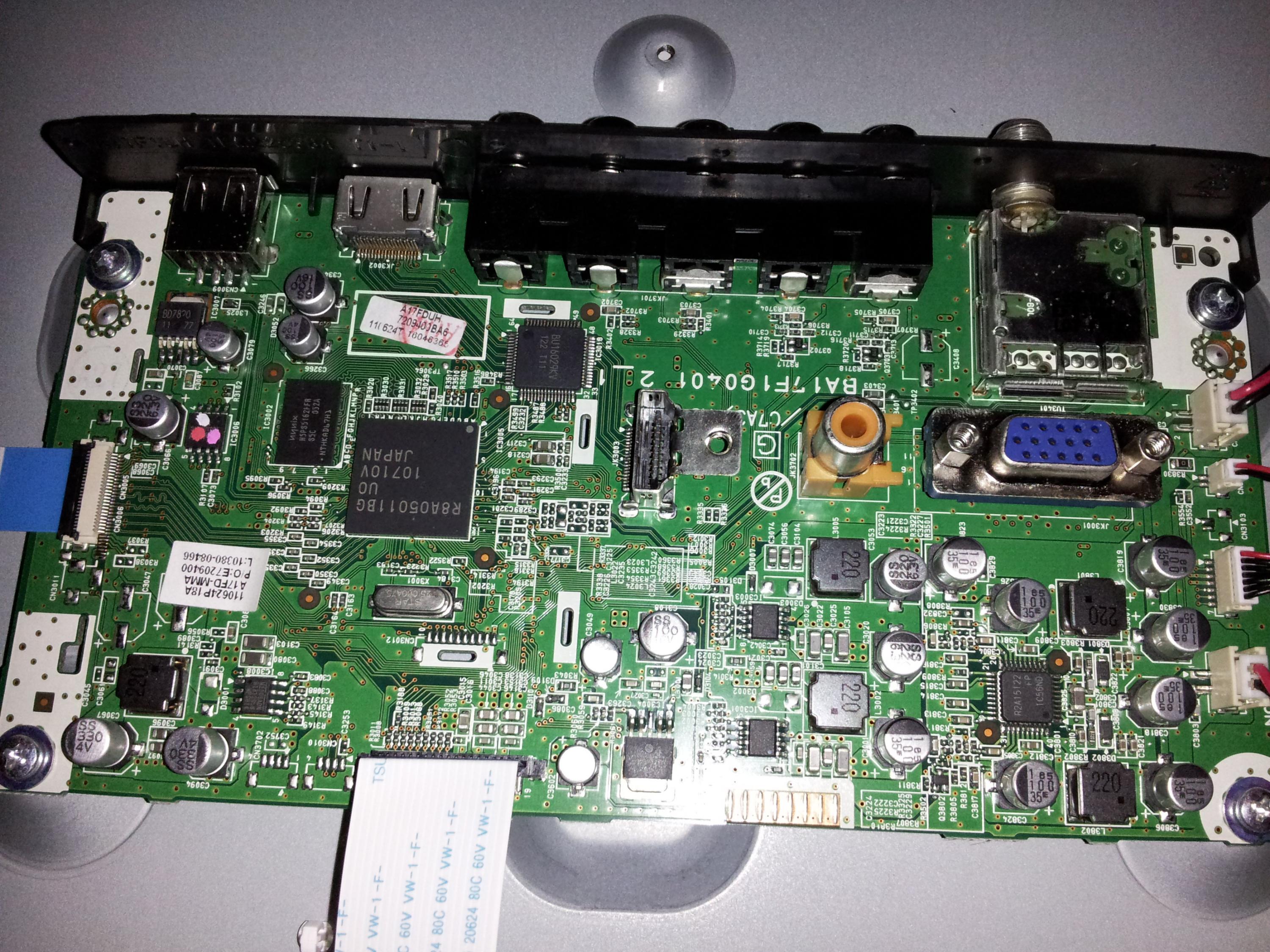

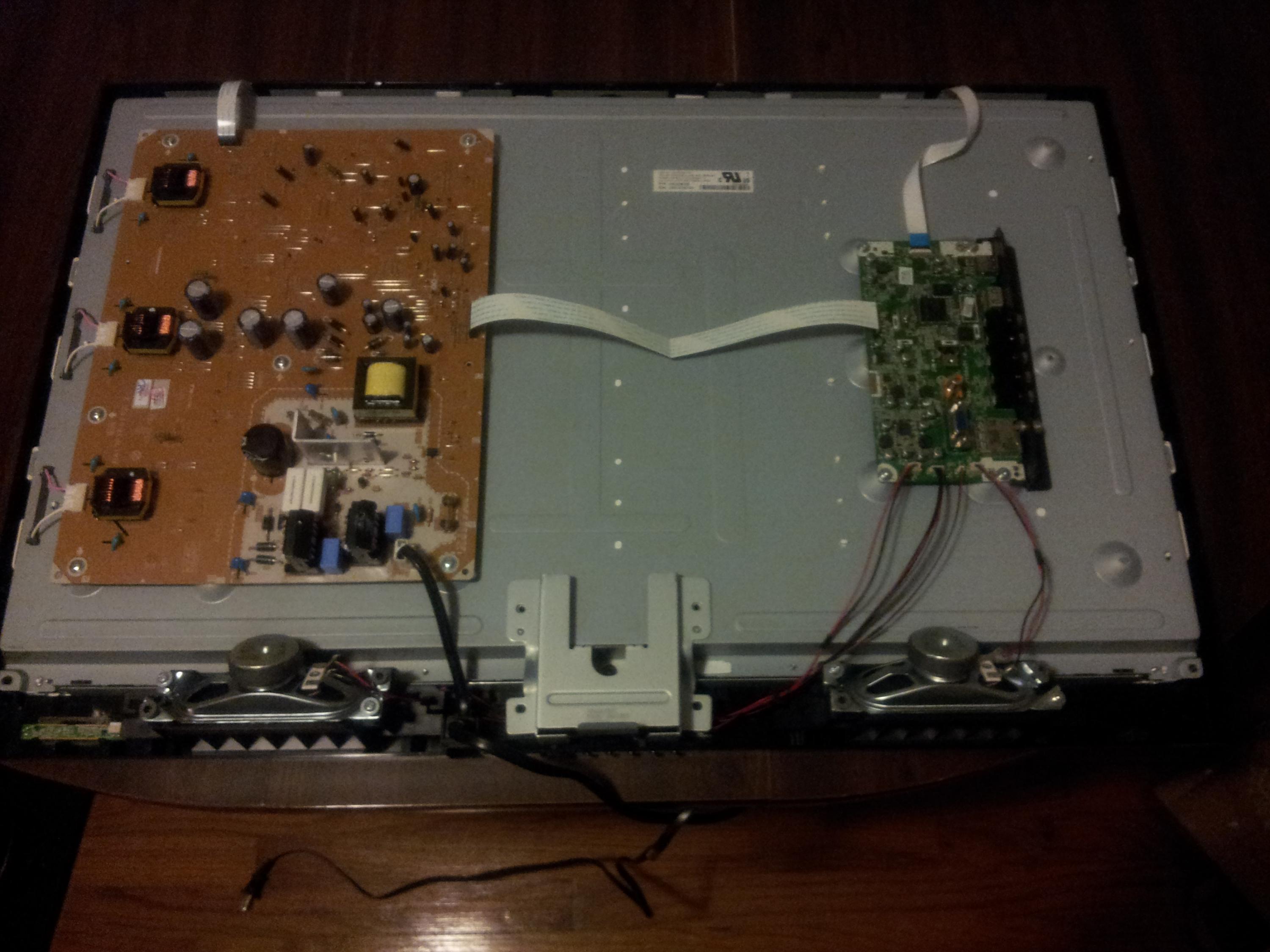

      I can look into getting a multimeter tomorrow from the local hardware or pawn shops. The pictures of both boards together, then the close up of each are attached.
      I am guessing my issue is with the board the power plugs directly into, but both boards are pictured just in case. The fuse is intact because the picture does not show it.
      If it is the Diode, since it would be difficult for me to remove the broken one and replace and resolder, plus the cost of buying all new tools, should I just buy a new board? Shopjimmy.com had alternate model numbers since my exact model number(BA17F1F01 02 2) is sold out. It said there was a sylvania board that would work just the same. Its model number is BA17F1F01 02 1. Is there a difference between these two boards? The Sylvania one is on Ebay for about $23.

        If you want to just get a basic meter harbor freight has some reasonbly priced ones. I think you can get a basic craftsman meter from sears for about $10. Whatever meter you chose just make sure it has a diode test function on it. I'm pretty sure even the cheapest meters all have this ability.

            A replacement board should put you back in business. But if it is a bad diode then you should be able to replace that part for less than $5 including shipping. You can post a link to a site that's selling your board. Linking inline photos are mainly what is frowned on here. Some members internet has a cap for data and if they exceed that limit they have to pay an extra fee. It makes the page load slower too.
