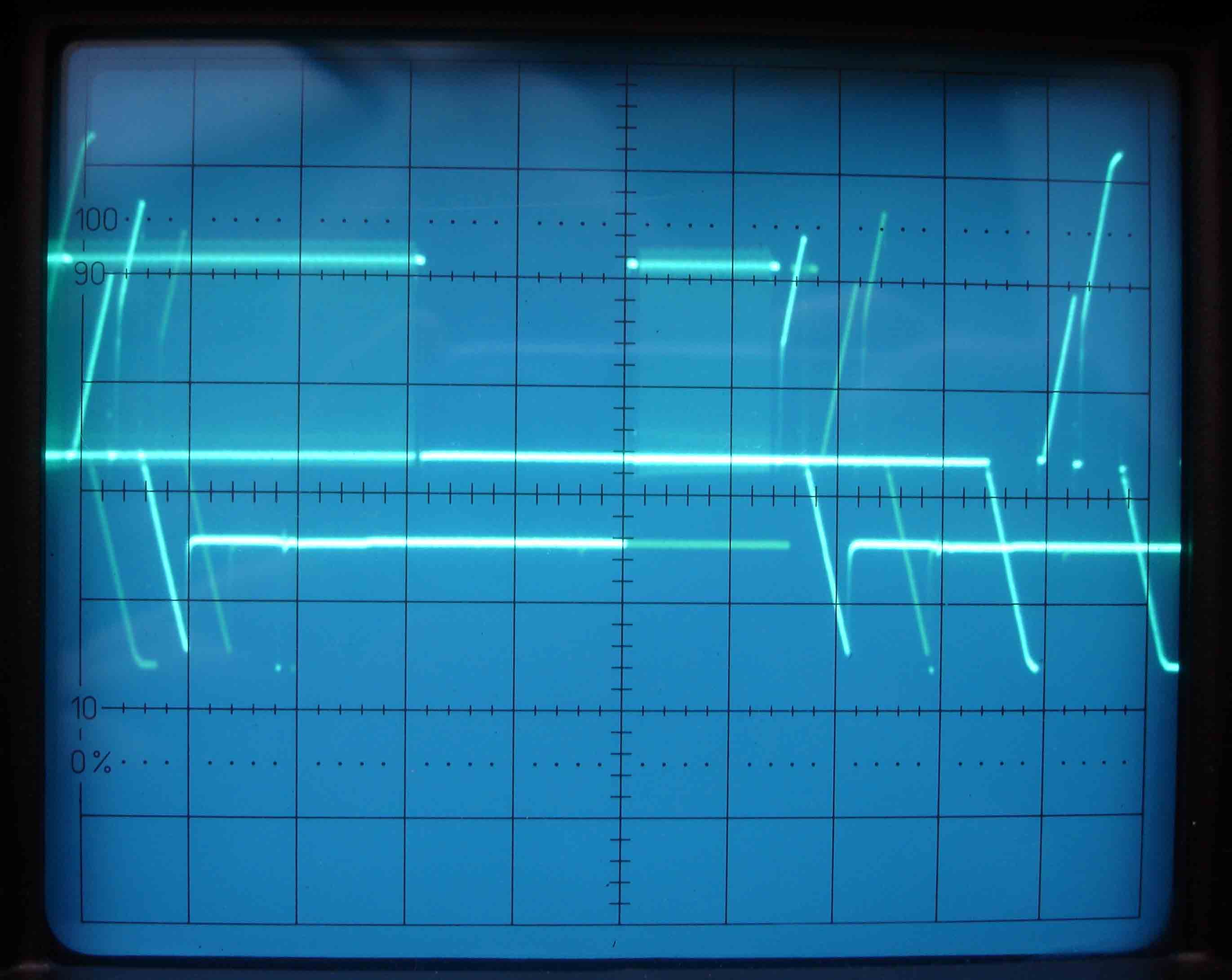

                                    Re: LG 42PC1DA Plasma Sound but blank screen
                                    Scope set to 10V/Div (probe x10) 0.2ms/Div.
                                    Scope trace attached.
                                      Y sus is working, that looks normal. Check Z sus too.
                                        Scope set to 5V/Div (probe x10) 0.2ms/Div.
                                        Z-sus scope trace attached.
