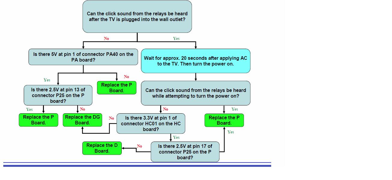

                                Re: Panasonic TH-50PX60U 7 blinks
                                Sorry if I'm hijacking this thread, but I also have an issue with my TH-50PX60U. It is completely dead. No lights, no blinks, just kaput. I found a troubleshooting manual that Tom66 had posted, and it led me to either a bad P board or bad DG board. Here is the quandry, which board is it? AC relays did not click when power cord was put in, so went to step 2, which was to test if either pin 1 of PA40 or pin 1 of HC22 had 5V. PA40 had 0V, but HC22 had 5V. The problem is, HC22 had nothing plugged into it.
                                According to the chart, if I answer the "or" proposition above with a "yes" since one of the two had 5V, it's the DG board. If the answer is "no", it's the P board. My question is, does it matter that HC22 connects to nothing at all? Simply because it has 5V and PA40 has nothing, should I assume it's a DG board?
                                  What guide are you using? I'm looking at the technical guide 9th gen
                                  • tw2005
                                    • Oct 2011
                                    • 6458
                                    Actually, it would be better to start a new thread with a title that relates to no power rather than a 7 blink. helps someone else down the track if they do a search.
                                      I must have been looking at an older guide. According to your thumbnail, my issue is clearly a bad P board, as there are 0v at pin 1 of PA40.
                                      I'm apparently so new to the forum that I cannot yet start a new thread. I will be more than happy to do so once I'm allowed.
                                      I haven't yet looked at the guides contained in your second post, but I will, just to be absolutely certain my diagnosis is correct.
                                      Thank you for the quick and on point advice!
