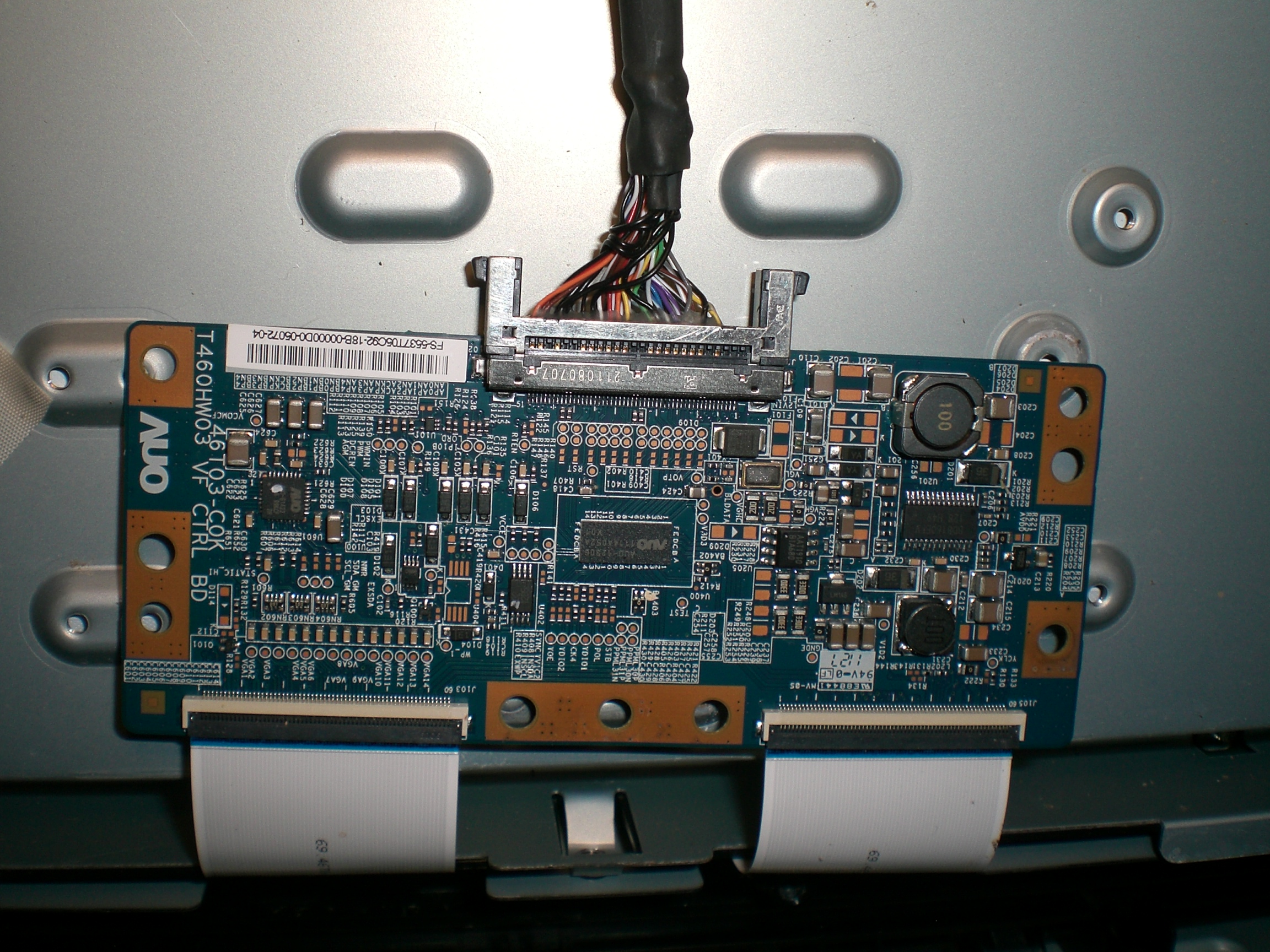

    Just got a Visio E321VL from the trash. It turns on/off but no picture. Backlights are lit (blue screen). Suggestions on where to start? T-Con failure?
    Re: Vizio E321VL - backlights but no OSD
    No video, no OSD, check t-con fuse.
      Having a difficult time identifying the fuse. I see an F101 and F102 but don't see either component.
        That little green device next to F101 may be the alternate placement for the fuse (different part but same number.)

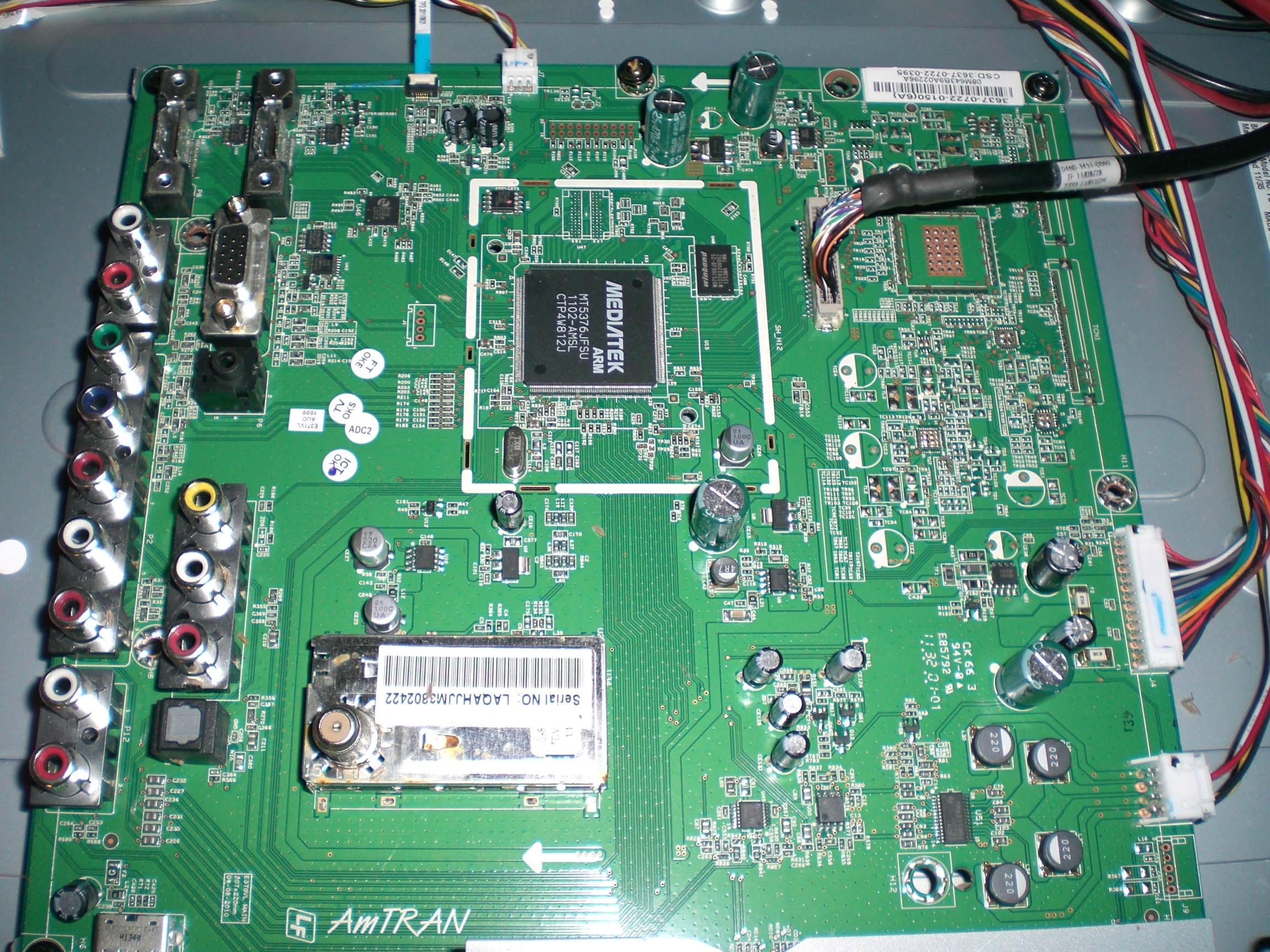

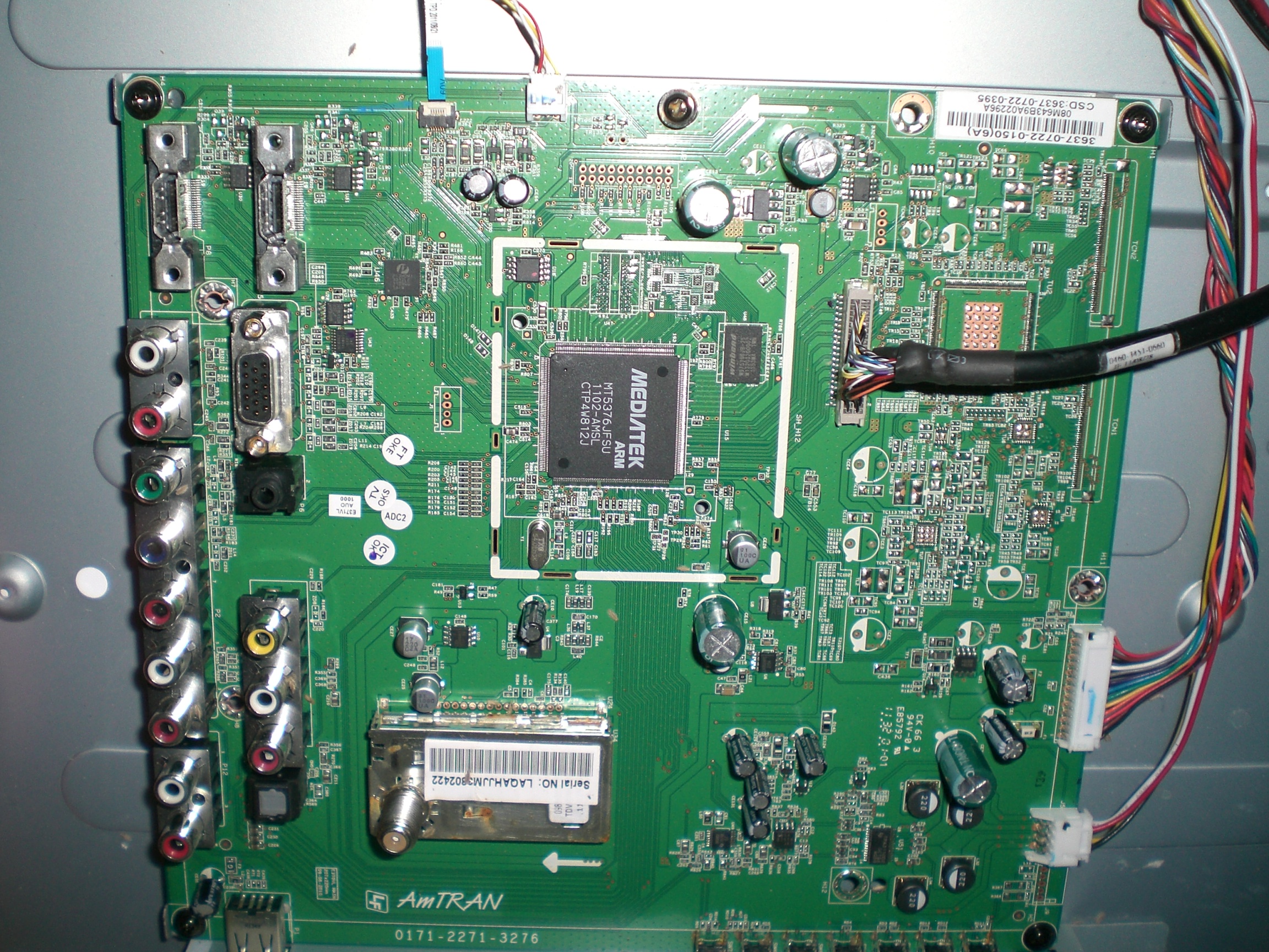

                          Snap shot of main board?
                            Both fuses on main board good? 12V and 5V?
                              Yes.

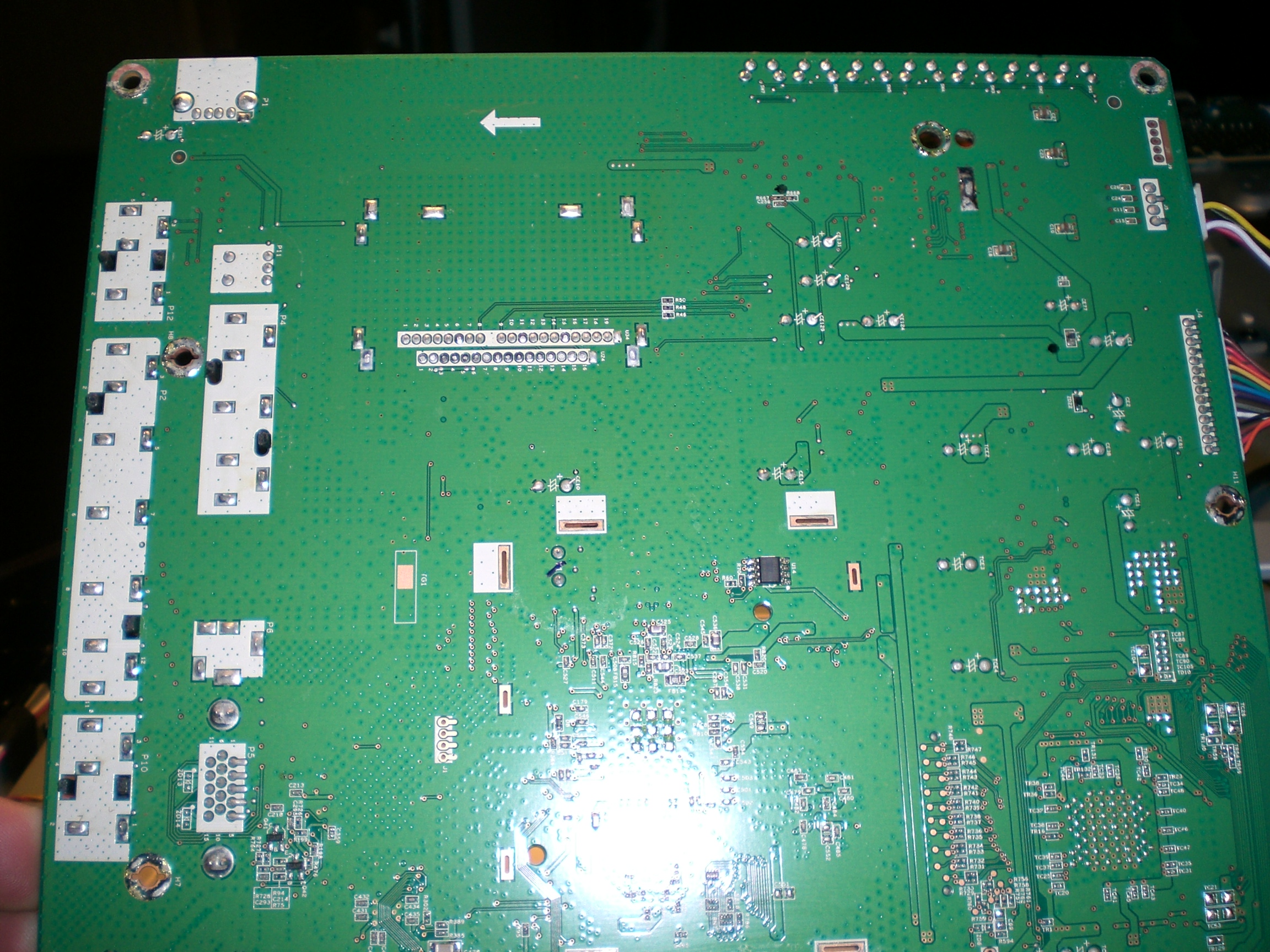

                                    Can I get a shot of the other side of the LVDS connector on main board. May help to remove it. Trying to see traces leading to it.
                                      Hard to get it all in.
                                        Sorry, miscommunication. I meant the other side of the connector, not the bottom. To the side where all the other components aren't there.
                                        But that may prove useful later.
