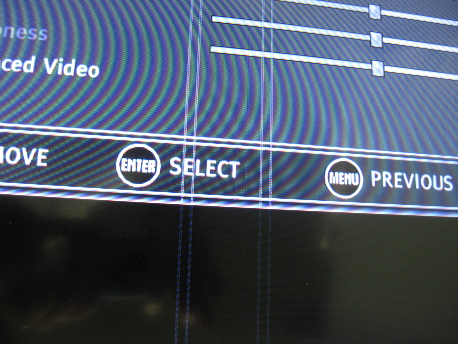

    Dynex LED-LCD TV DX-32E150A11 vertical lines on screen

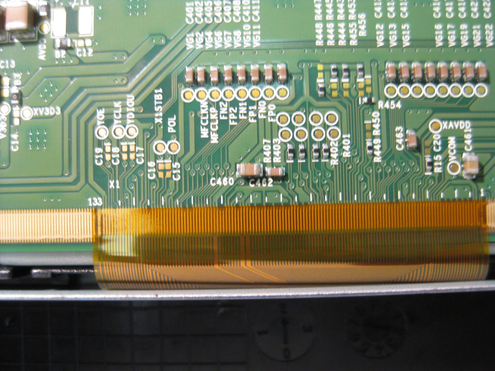

    Almost one year old, this LED tv has two rows (symmetrical from centre) of vertical lines. No visible defects on capacitors from power supply or main board
    Applying pressure on LCD panel or ribbons did not change this problem. Should I check the T-Con voltage regulators…or most likely is a bad LCD panel (AU Optronics) ???

    It's most likely a bad LCD panel.
    If it's not quite one year old, call the company up. They should (and are legally required to) replace or repair it. In fact, even if it is over a year old, it should be possible to get at least a partial refund.
