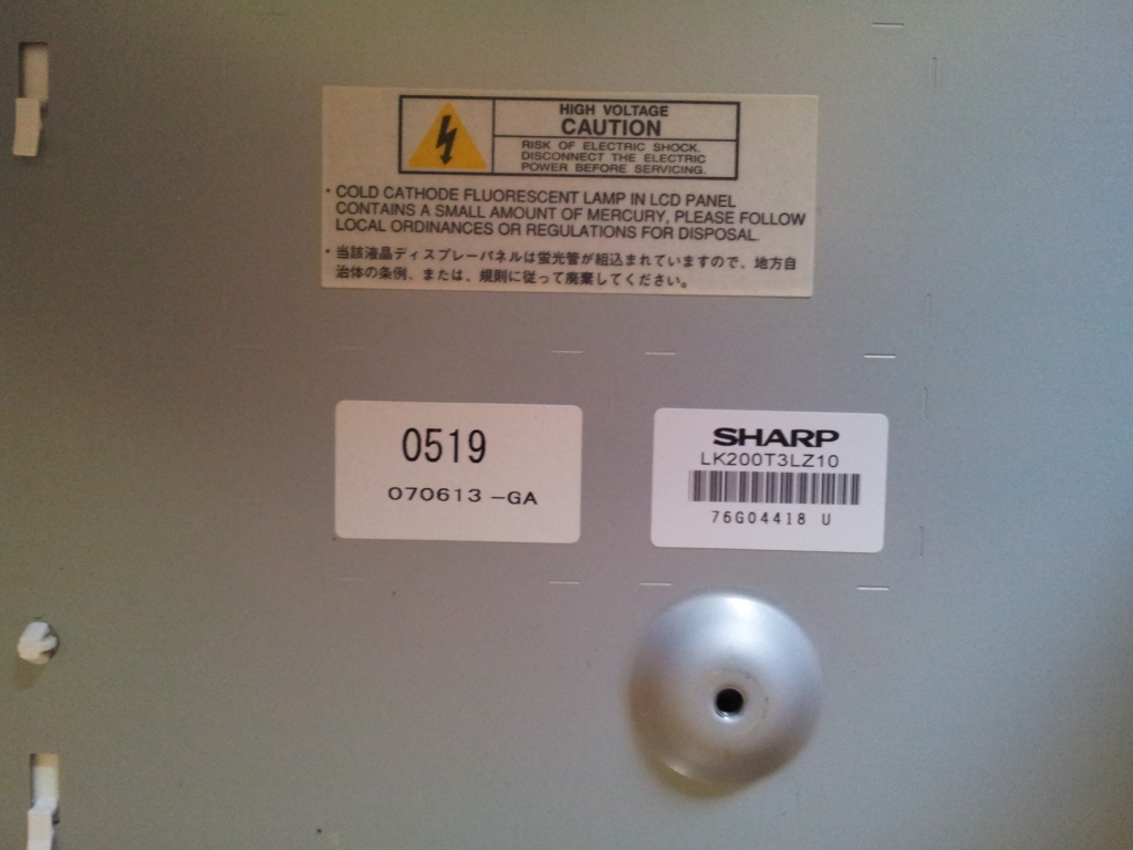

    Picked one of these up from the dump in the hope the tcon board would fit in my 32" but alas, no.
    This one has a broken screen but otherwise works fine. You can get a picture and just about make out the menu's working, so I was wondering if anyone had one of these screens knocking about and how much would they want for it?
