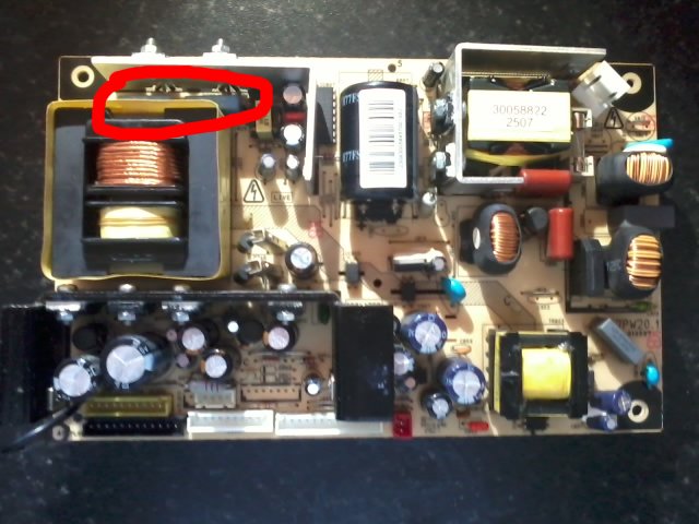

    as i says above the tv stays in stand by mode and wont turn on. tried all the usual stuff like plug it out fa few a days and plug it back in. had a look at the capasitors and they all seem fine. does any1 know what the problem might be.
    the board type is 17pw20.1 010507

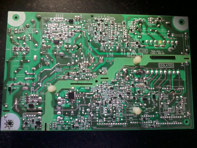

    welcome to badcaps! please post clear pics of boards an just because they look ok does not mean they are! what tools do you have, a multi meter>? esr tester? soldering iron>?

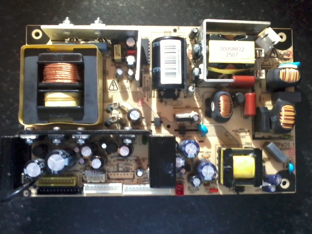

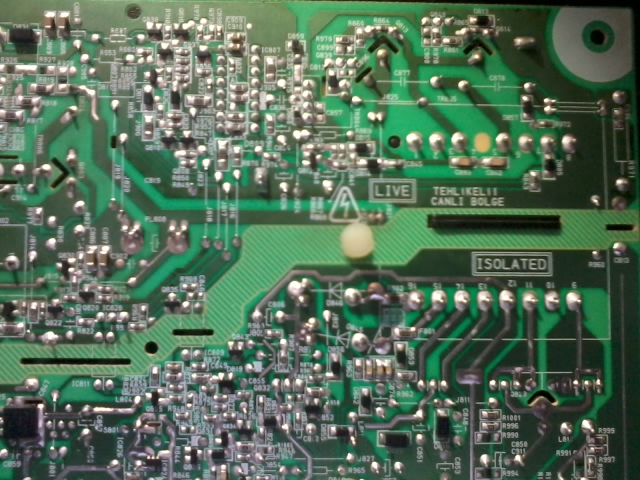

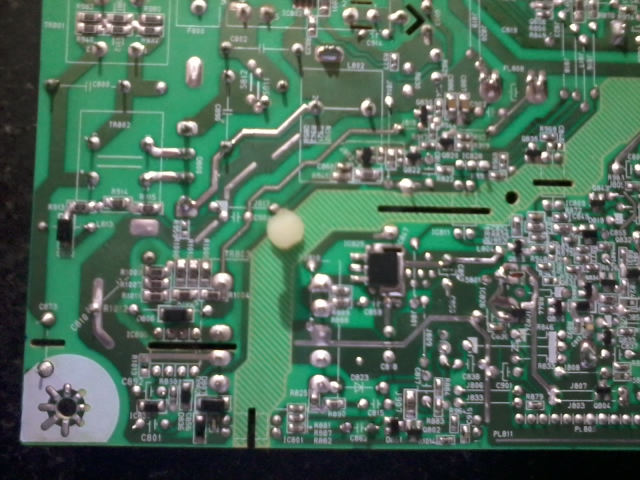

      in the first pic bottom right you can see a orange colour fuse (c862) thing (new to this so dont have a clue)

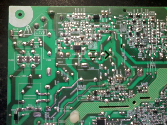

      this fuse is not giving any reading. were as the same fuse (c836) on top left i giving a readig of 1427. could this be my problem an what is it called.

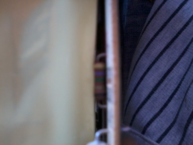

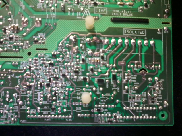

      ive also got a fuse (r960) under the box thing on top left not giving any readings. ive added a pick of said fuse. also no reading off c874 10uf but getting reading off c848 10uf of 972.

        Ah, Vestel. We meet again :/.
        You can either replace the PSU (about £18) or you can fix it by replacing those two grey boxes (15nF 630V capacitors) near the top of the main transformer, as I've indicated in the image.
        Sometimes there are other causes of the fault, so I like to just replace the entire PSU when I work on a Vestel which is getting stuck in standby.

          hi tom. them two that you said are giving readings of 622 and 623.
          so will i still replace them? what about the other things i mentioned esp the orange fuse.

                Recommend you replace those components. 90% of Vestels have those caps failed. But personally, I've always found they have one or two more problems, and spent hours chasing the problem around, with no luck. Then again, I usually get the TVs in much worse condition, usually completely dead, so maybe those caps kill other stuff. Personally, I'm not sure.
                You can use 17PW15-9 as a substitute IF your connections match - check photo very carefully (I have done it before on a 32 inch Goodmans and Wharferdale, both Vestel chassis):

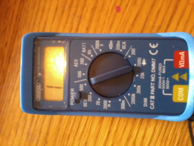

                  pic of meter below and settings its on.
                  sorry as im a total newbie here

                      Your meter is on 2kohm range, those caps do not seem right, but put back the resistor.
