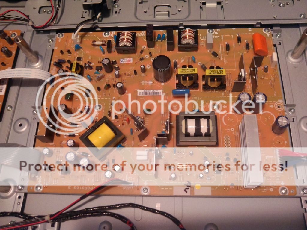

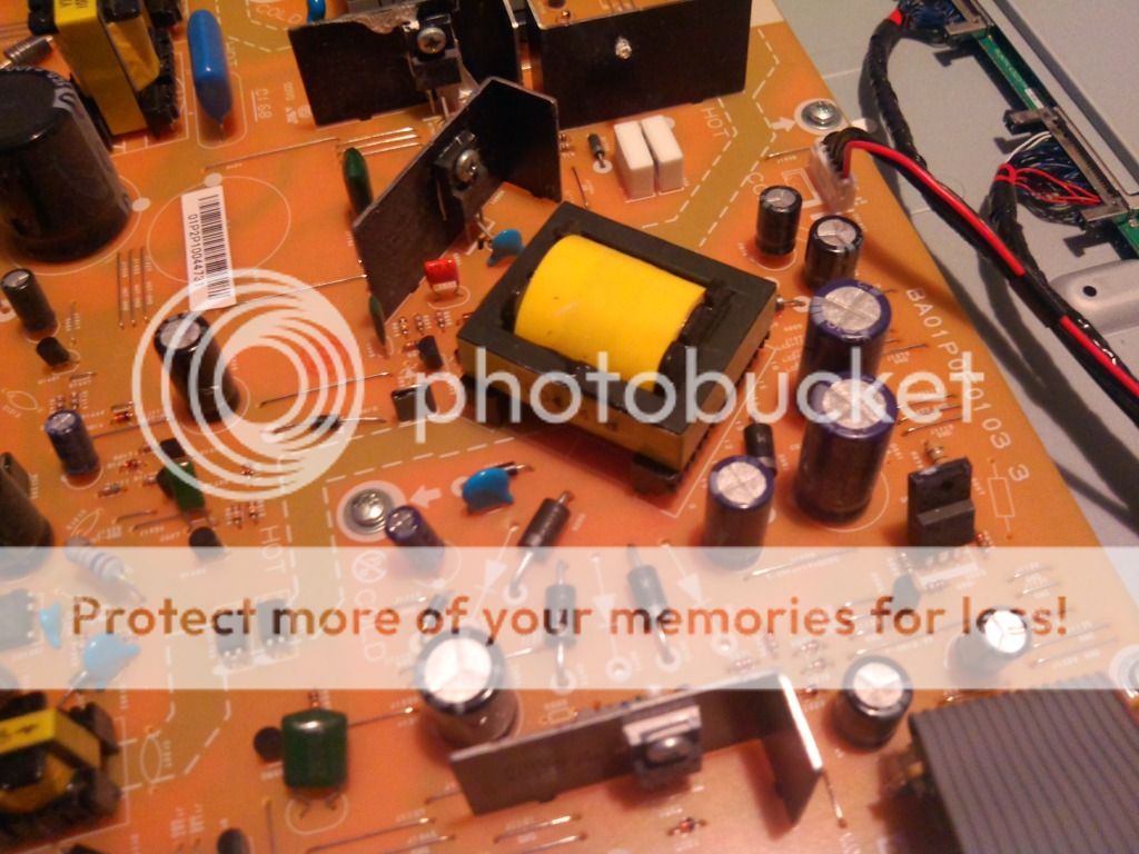

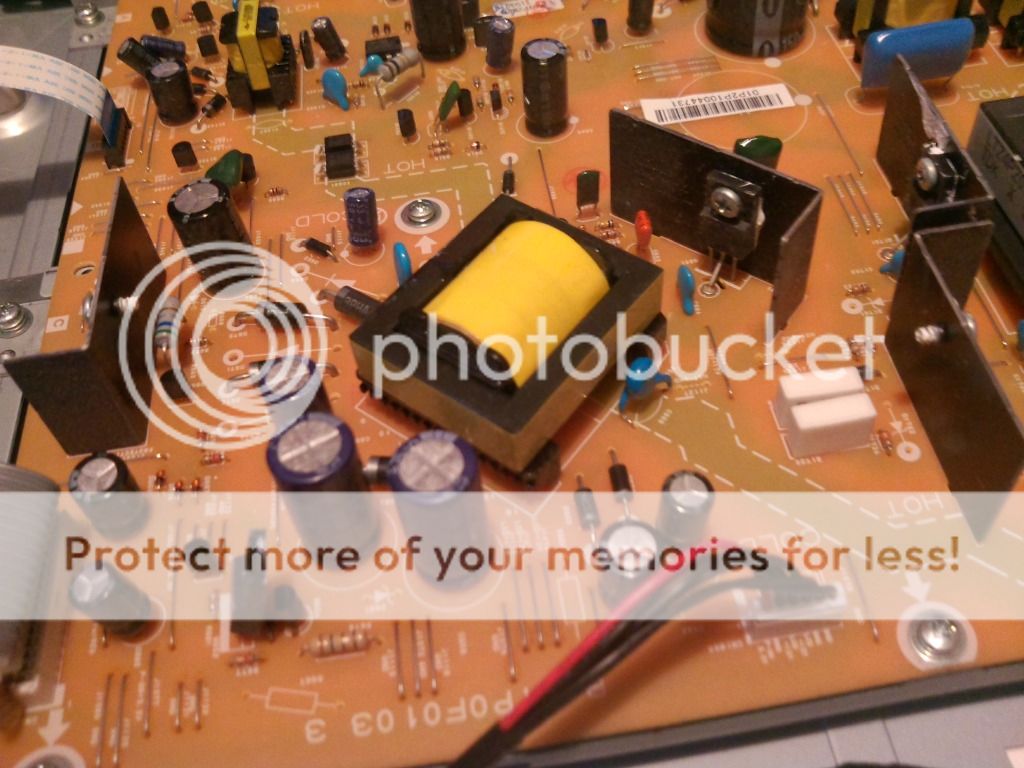

    Well I had this tv repaired once for "a bad fuse" not even a month ago.
    I was watching a movie when it just powered off I tried to turn it back on only to hear a hissing sound (like a small air leak) Then it just goes back off. no power to the screen at all. so I unpluged it over night, and now when I plug the power in it makes that same hissing sound just when plugged in. so for now its staying unplugged. I pulled the cover off the back to check for bad capacitors only to not find any. I believe the sound is coming from the yellow box on the mainboard.

    Check the larger diodes around the transformer and see if they are shorted.

      Also check for cold joints. Show us voltages coming from the psu to all components, use ms paint and point to us each voltage and which pin it is.
      Sorry for the layman's terms.
      Do NOT touch heatsinks when testing for voltages as they may be LIVE!

          All you need to do is set your meter to the diode test mode and do a quick check "in circuit". If one reads shorted then you'll have to lift one leg out of the board or take it out completly and test it again. You won't need to discharge or recharge any capicitors. If the tv has been unplugged for 5-10 minutes you should be fine if you are worried about being zapped.

              Did you find a shorted diode? The transformer is more than likely still good. I had a 42" sylvania that a diode shorted out and the transformer would buzz/hiss. It had the same style power supply that your tv uses. I would replace whatever diode was shorted and try that. Transformers are usually pretty solid unless they physically break.

                With my equipment I get a number 1 on the display. and Is stays at one even If I swap the probes direction. this occurs on all of my diodes on the entire TV. I'm sure I'm not reading it right.
