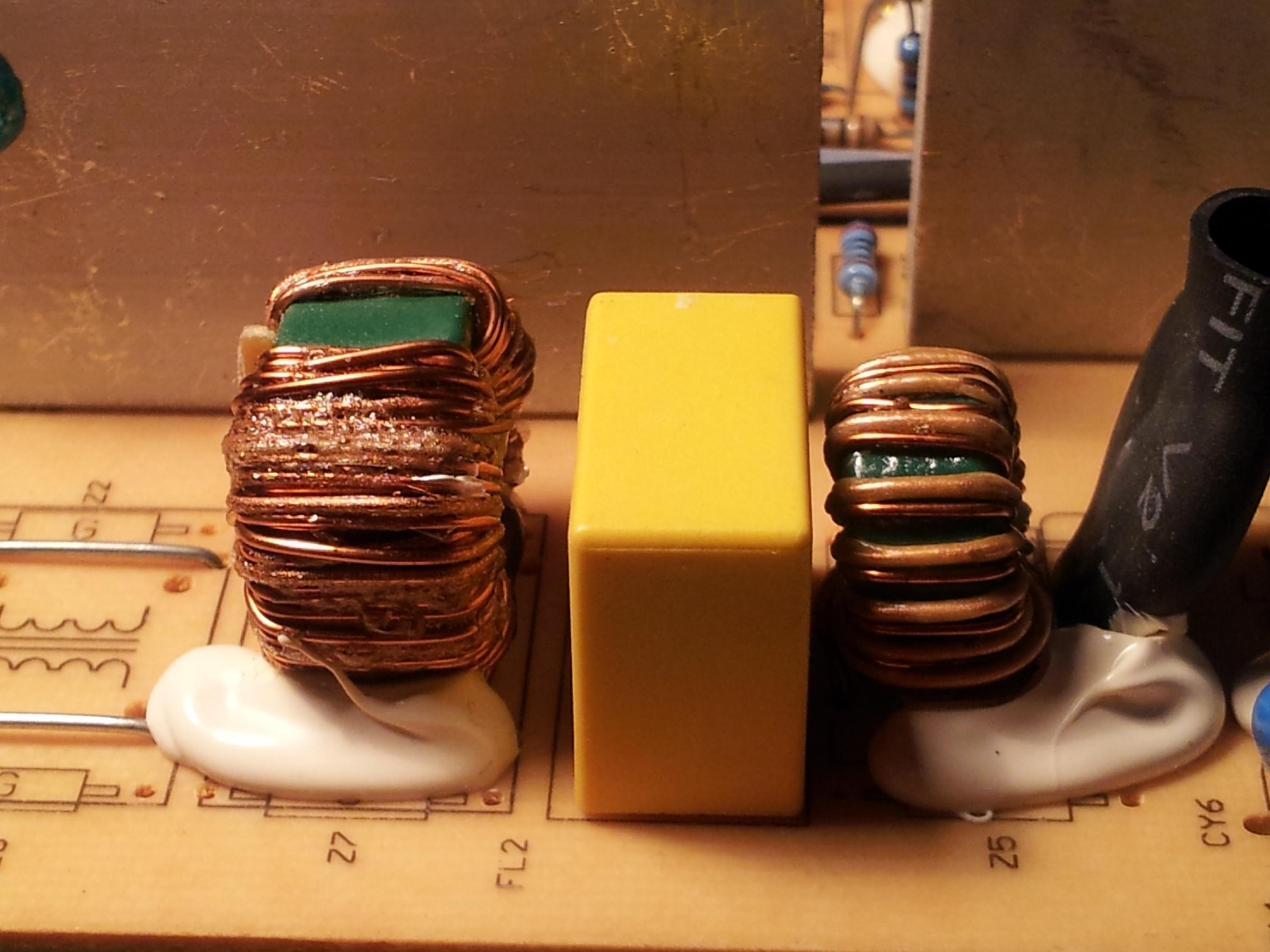

                              I found three things I need to replace before I continue. The bridge rectifier is shorted between 3 of the 4 pins. Both chokes look terrible, though only one measured shorted. The one on the right has both phases wrapped together and the insulation melted, causing a short. The one on the left doesn't read as short, but thats only because the phases don't come into any contact with each other. The insulation is badly melted on that one too, therefore causing each side of the windings to short in line, thus causing less windings. The bridge rectifier is a US8K 80R. What part number would it be on digikey? I have no idea how to identify the chokes. If someone could point me in the right direction on digikey as to what I need to order, I would be forever grateful. I have a hard time differentiating between their vast inventory.
                                I'm no expert on inductors, but from the little that I do know, if you measure them with a multimeter, it should read like a short. In 2+ years of participation, I don't think I recall an inductor going bad. We have a lot of shorted rectifiers and power mosfets from people doing an "oops".

                                  Those are common mode choke line filter with very low DC resistance, it looks like just poorly applied varnish. They have to be low resistance, otherwise you will have too much voltage drop on them. I would take out the bridge rectifier out and test them out off the circuit since shorted MOSFET will make the bridge read shorted also.

                                      I forgot to mention that I already did pull them out. The bridge rectifier should in diode mode read as bridged diodes should it not? It looked good from the first pin to all the other pins(short in one direction only). when I tested from 2-3, 2-4, 3-4, they all showed short in both directions. Is that normal? I pulled the bridge rectifier out and still had short on my feed. I then pulled the inductor on the right, and the short went away on both sides. I tested the inductor out of circuit and all 4 leads are hard shorted.
                                      I only assume that the left one did the same thing, because the right one did. It doesn't show short across the circuit, but it can't, the coils are isolated from each other. However, the coils can be shortened(short circuited),on the same conductor, and without some sort of ring counter, I won't know. I'm just afraid, that it is acting simply as a jumper now.
                                      By the way, these faults were all caused by me flipping the board over and arcing it on a metal housing while it was still plugged in on the bench. Complete goof up, I know, but not your normal tv problem none the same. Sorry about forgetting to tell you, but yes, I did isolate and test the components out of circuit. The inductor at least is bad, and I would think those readings on the bridge rectifier are no good. It's essentially no more than a single diode now.
