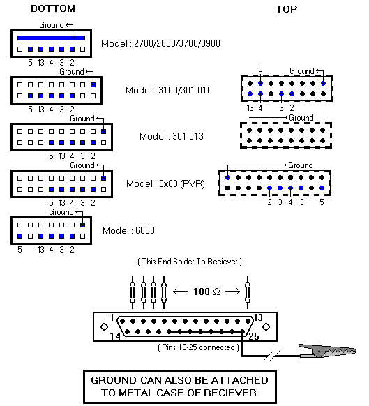

3100 receiver will not acquier signal

    jkeys.. hehe been a while yes. does the ird boot up (green led lighting up at least one quick second on bootup) ? any firmware on it ?

      Re: 3100 receiver will not acquier signal
      is it a uni jtag? make sure cable in right slot! an make sure ya have it the right way, pogoed will take a couple of stabs at it!
        Ya it worked back in the day (non buffered soldered) nothing has changed? It will not read now? 2700 no problem must be something to do with the 3100 Its been a long time loss my touch.
          did you try the top jtag ?
            make sure no cold solders on the head of the jtag!
              It is the top jtag and the solder is good. I seem to remember having a similar problem way back when that was an issue with the 3100 only and I can't remember what it was and what I had to do to overcome it.
                dont ground to ground pad, tuck under a screw, an try wall if jkey fubarren!
                  well if the cpu isnt detected, wall will not do much. what i did on some ird's that wouldnt be detected at all with jkeys is to pull the tsops and flash them externally
                      Can you point me to the steps to move my sc to another ird? I have changed the IRD # and boxkeys in the tsop (new ird) with flashedit and have flashed that using jkeys. Thats all I can remember from days gone!! by there must be something else I need to do? Do I need to flash the eeprom? If I am in the wrong fourm let me know
                        just virginize eep! use jkeys to make you one!
                            load tsops in flash edit , got to save area! an will see save eep! just save a new one, make sure to enter build correctly an write that to ird!
                                  Not a problem got her done thanks for your help
