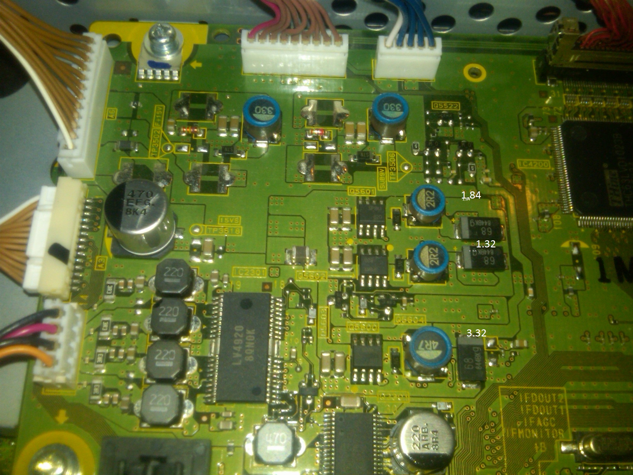

      Re: TH-46PZ85U no picture
      Maybe it's possible to repair the D board if you post some detailed photos I can point out some things to test.
          Sorry, I meant to say the A board. D board is probably OK in your case.

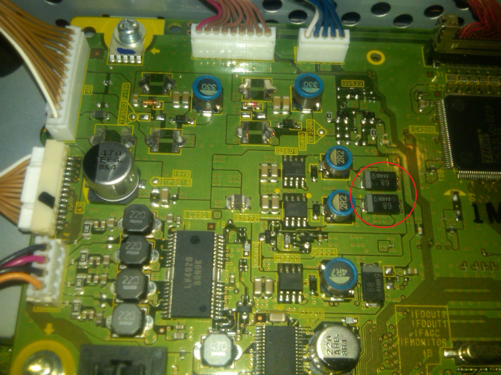

            Here is the best pic I can get with my old iPhone3g.
              The power supplies are in the bottom right corner, see if you can get a clearer pic of this area.
              • dietzcj
                • Mar 2011
                • 114
                here ?
                  Thats good did you use another camera?
                  Test the voltage across the black components with "68" written on them... they are caps.
                  • dietzcj
                    • Mar 2011
                    • 114
                    #29
                    the one labeled 68 are caps ?
                    Wow, okay. what setting should I use with the volt meter for these ?
                      #30
                      Yep, tantalum capacitors. Different format to electrolytics and ceramics. More expensive too - you only tend to see them in better TVs, they have better reliability and lower ESR.
                      DC 20V will be fine.
                        You mean these right ?
                        With TV on, my Vmeter set to Dc20, and which side goes to witch ?
                        I assume the light side toward the end of the 68 is the neg ?
                          #32
                          Yes, and the other, facing the other way.
                          Polarity isn't important, we're only looking for an absolute value here.
                            Sorry for being such a n00b at this, but I am confused with the multimeter setting.
                            can you cirlce that for me ?
                              #34
                              See pic.
                              Also move probe from 10A DC to Volts/Ohms/mA jack.
                                Top one 1.84
                                1.32
                                3.28
                                  #36
                                  OK - those seem OK.
                                  There are two marked test points TP3502 and TP3506. There are F+15V and SUB9V.
                                  Test the voltage on the test points; same range, red probe on the metal pad, black probe on the chassis of the TV.
                                    15.8 and 8.9 respectively
                                      Also test point TP3518 15vs = 15.8
                                      And then test point Tp4007 = 4.7
                                        #39
                                        15V seems a little high but probably OK. I didn't notice there's also a 15VS at TP3518, test it the same. I'm heading to bed now, got lectures in the morning .
