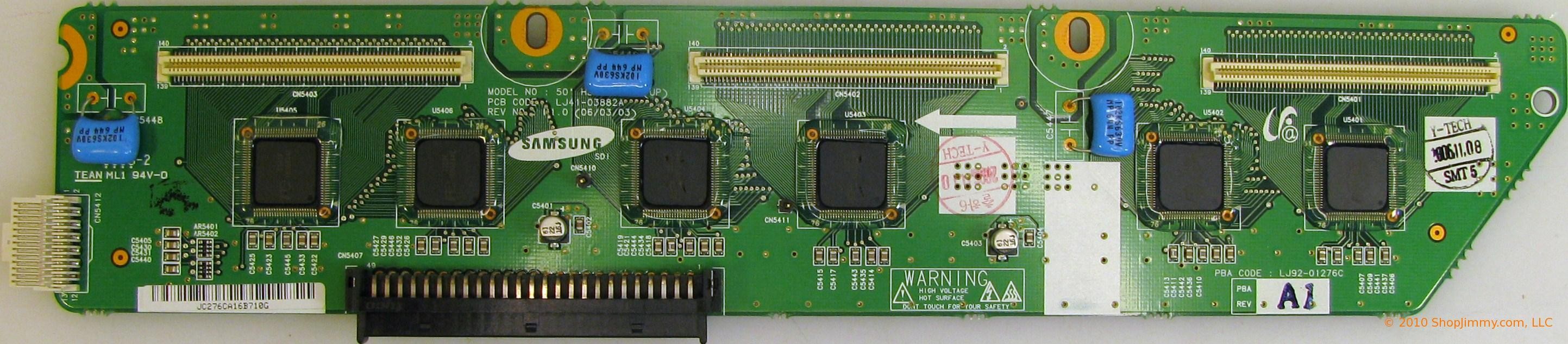

    Samsung plasma model number PH-T5040 , no picture has sound, open the back cover and test the Vs(207v),VA(64V),normal. The fuse on Y-Board (left sdie) and Z-Sustain(Right side) board, good.
    However, when I touched the heatsink on the y-board, three of them were cool,the z-board, the upper heatsink is cool but the lower one is hot. So I suspected the y-board is bad, the z-board may be bad.
    Search ebay and find the boards, wait.. too expensive ! and some one mentioned the y-buffer board would be broken if y-board was damaged !
    I check carefully and found the top IC on the y-buffer board was burnt out! So need to replace the three boards (y-board and upper and lower y-buffer board) at the same time, total cost is around !250! and may need to replace z-board as well.
    I abandoned due to high cost to fix the set.

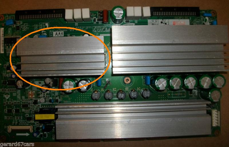

                      I've fixed 3 Samsungs with this particular YSUS.
                      The ysus can be easily fixed and on all 3 of the ones I did it was the 88N30W FETs that get shorted.
                      All three had blown upper buffers, it's a common fault. Lowers on all mine were good.
                      I would check out all the other fets just in case as it's assumption you have the same faulted parts and of course ther could be an exception
                      They are cheap as chips to buy. I purchased mine on Ebay from the same seller, all were brand new and good.
                      If one shorts the remaining 3 will be shorted on the board so to find out exactly which one or how many you will need to remove and test individually.
                      From what i saw on my sets, yes you can get the voltages up, I could not get the set to run a picture with the upper removed and all 3 had blown upper buffer and dead ysus.
                      I think blown xsus is rare on these.
                      If your in the USA then I reckon you could get this up for under a $100 if you can handle a soldering iron.
                      Finding cheap buffers is probably the hard part, but what I did is use a different buffer part number which did work on this panel. S50HW-YB02
                      If you're interested in how I went about it and want to have a go at this let me know.

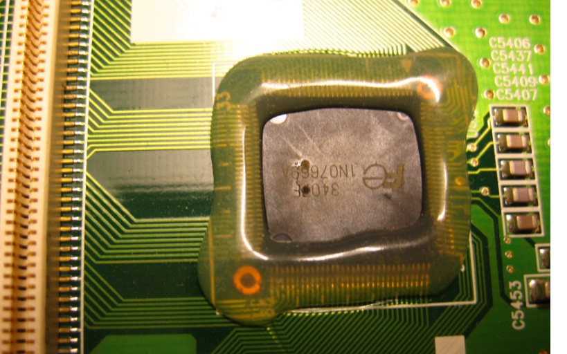

                        Hi thank you TW2005, your experience sharing is very appreciated, how ever I'm in Cadana, so may be hard to get it fix.because I can't replace the IC myself.
                        I attached the broken IC photo as well,it's thetop one onthe upper y-buffer board, other ICs looks no damage.

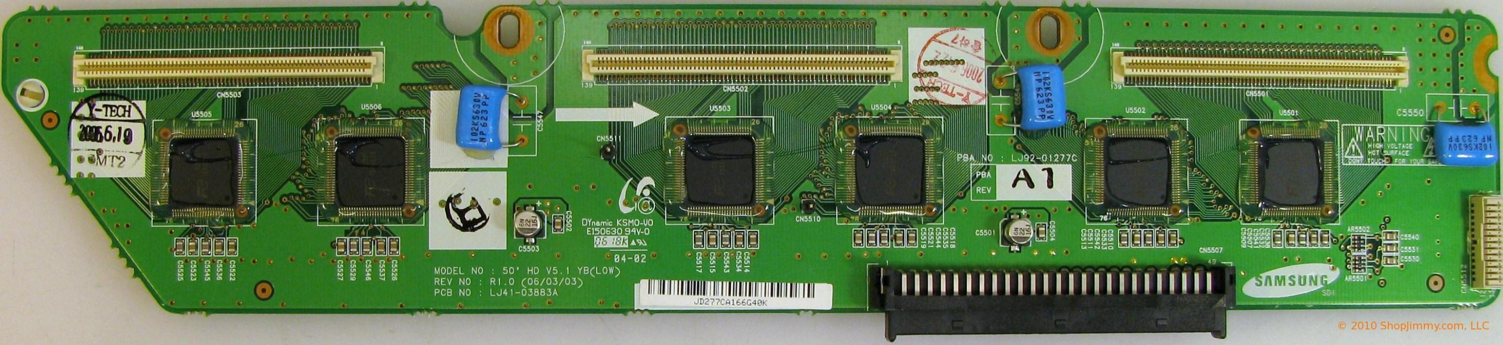

                                      Well, then you can fix the Ysus and purchase the buffer boards.
                                      Here's the alternate boards I used. Essentially the same, I transferred the rubber blocks from the original boards to this and inserted the plastic pcb support standoffs.
                                      Worked perfectly, even mixed 1 original and this one also no problem with the picture.
                                      Upper: BN96-03361A,996500036824, LJ41-03882A
                                      Lower: BN96-03362A , 996500036825, LJ41-03883A
                                      Photos c/o Shopjimmy
