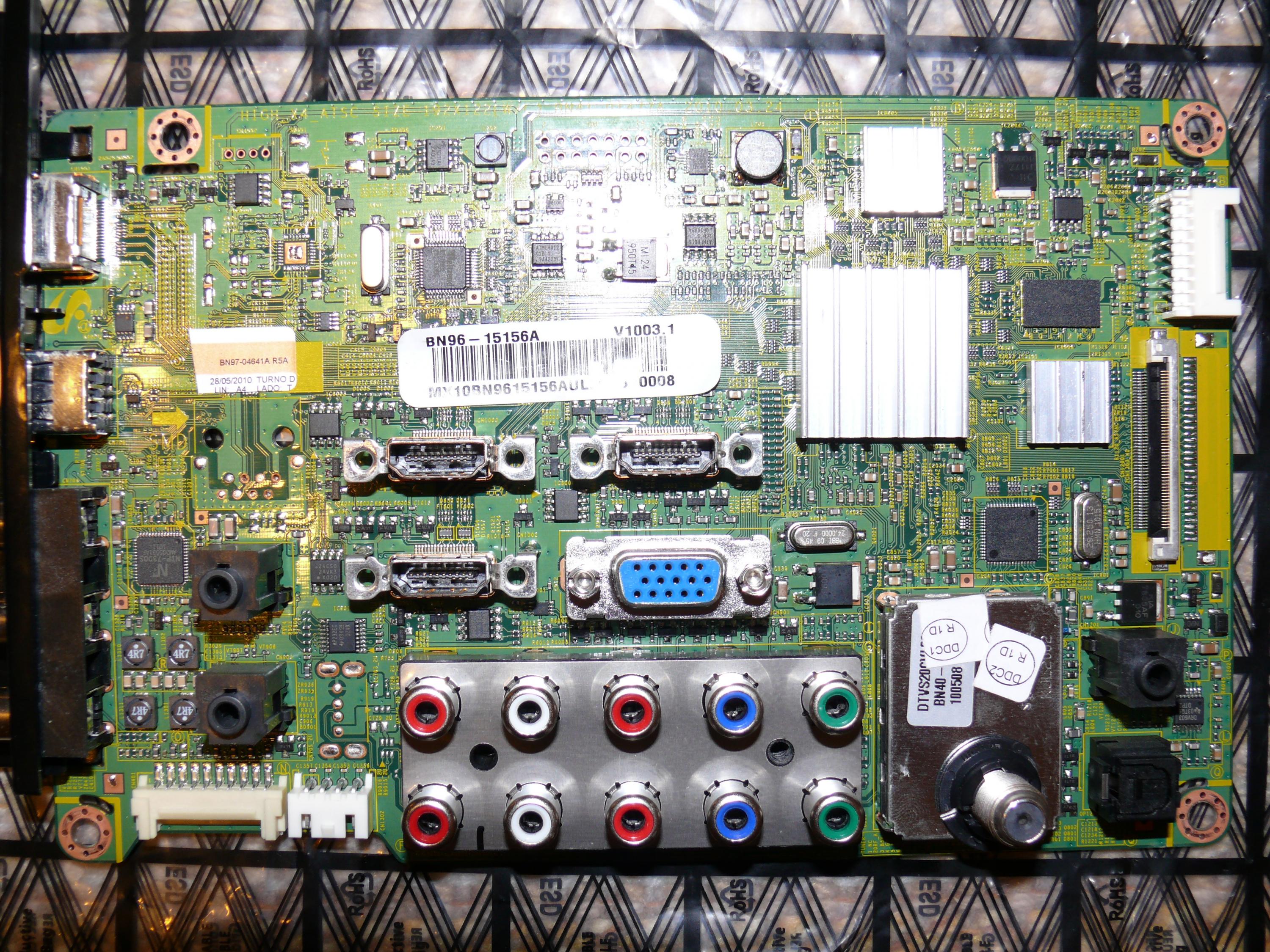

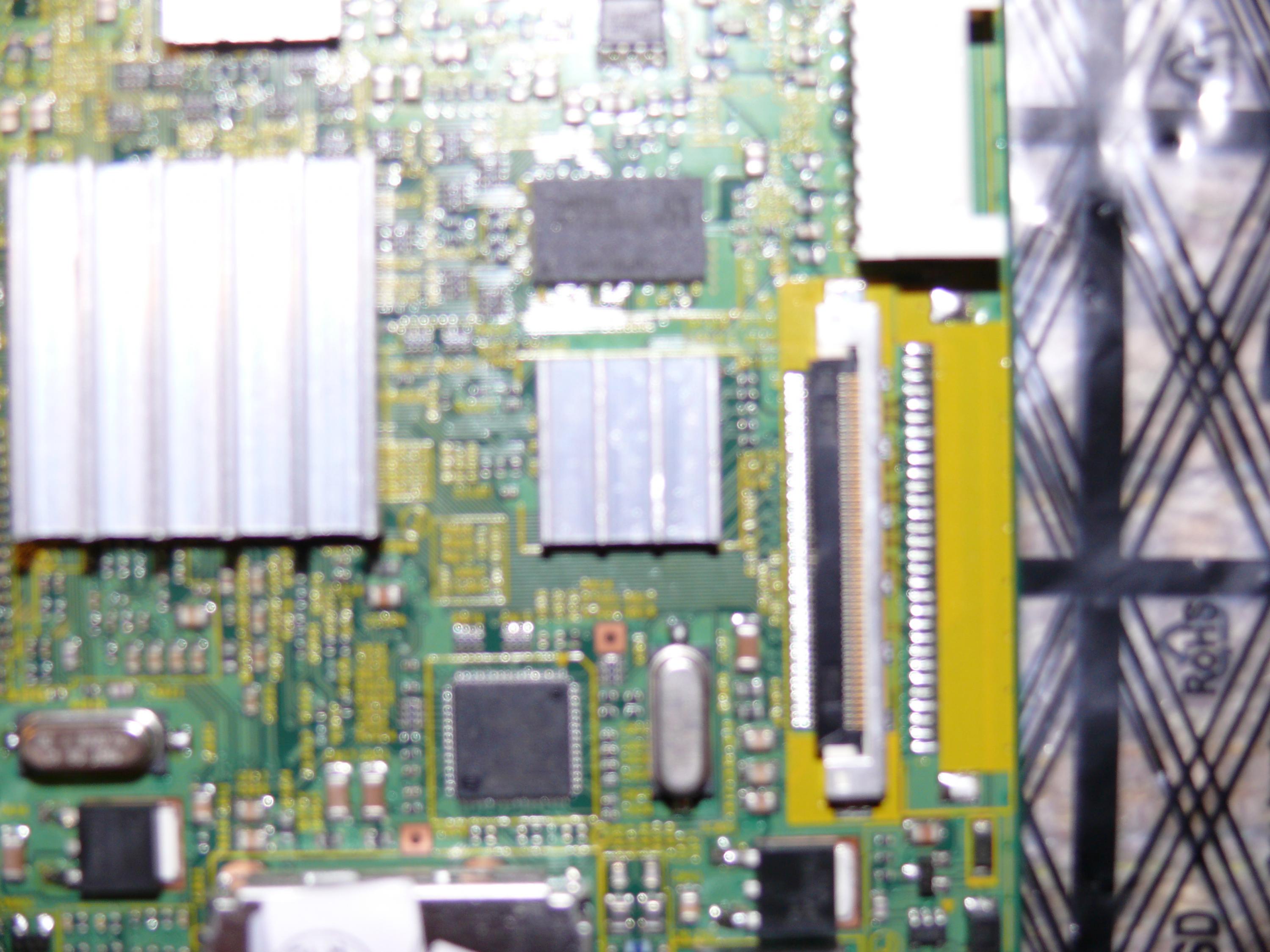

                              First picture is the main (input) board, the half dead one. The fully dead one is different and appears to be an earlier model. Second picture is a closeup of the part that when cooled by freezing spray allows the set to turn on. That part is under the small heatsink in the center. Cooling the bottom underside does the trick. I removed the heatsink and the 'leads' are under the very thin flatpak. No way to solder them again and I don't have a hot air pencil.
                              Anyone have any suggestions on how to re-heat the connections under this chip without destroying the board?
                              I closed up the first set with the dead board replaced by the LN40C550 main board. Correction on the upgrade. It has 2 additional connectors. The LAN port and a USB port.
                              I am waiting for the second board to fix the second set, but playing with the half dead board in the meantime.

                                Leads on the underside? That's either a QFN or a BGA. Reflow time... If you don't have a hot air gun, you should get one. Or if you really think you won't need it (you will), see if you could borrow one.
                                A working TV? How boring!
                                  Re: Samsung LN40C540 Turns on when it wants to...
                                  ^Or a paint stripper. I've used one before in a pinch.
