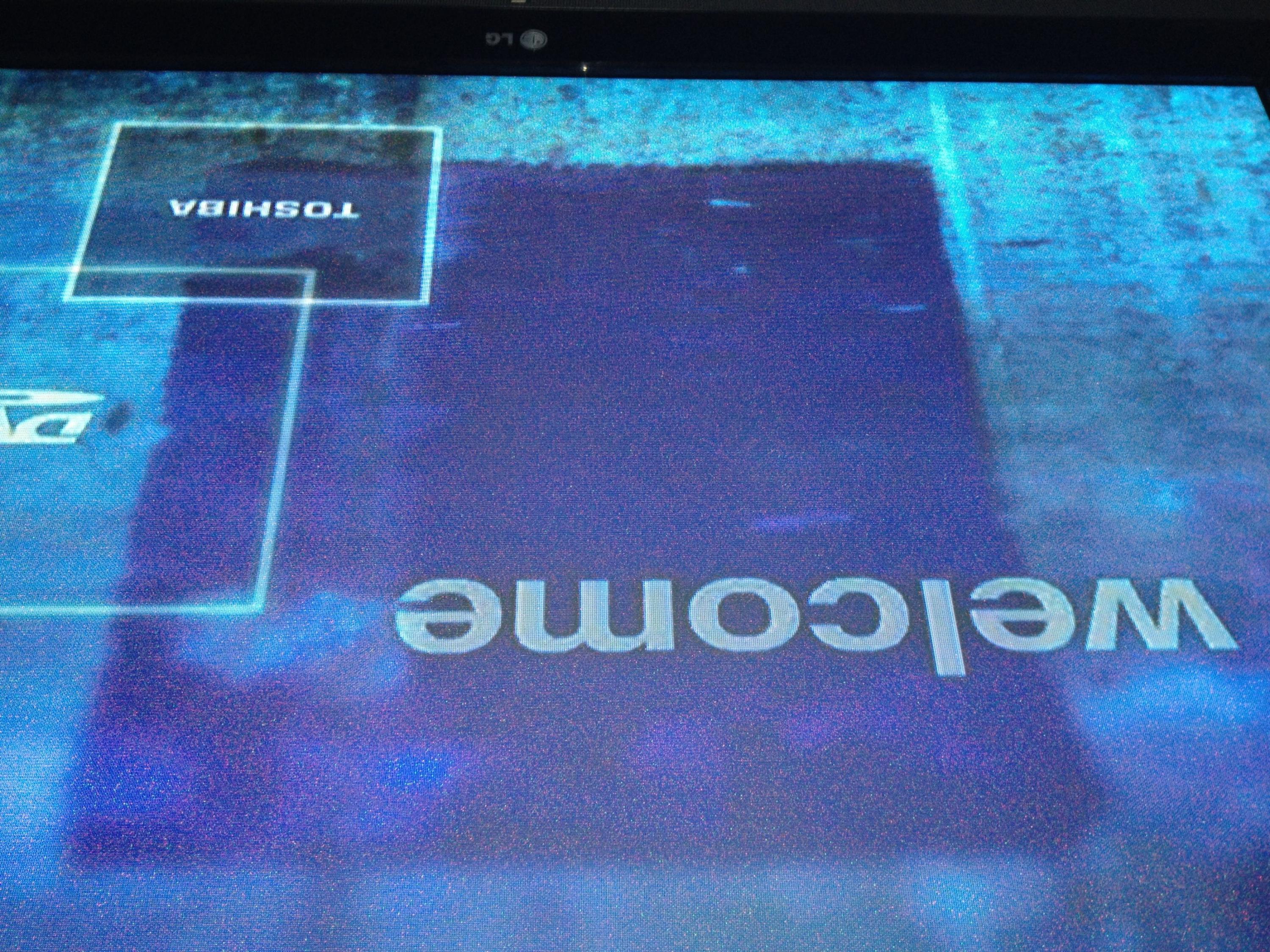

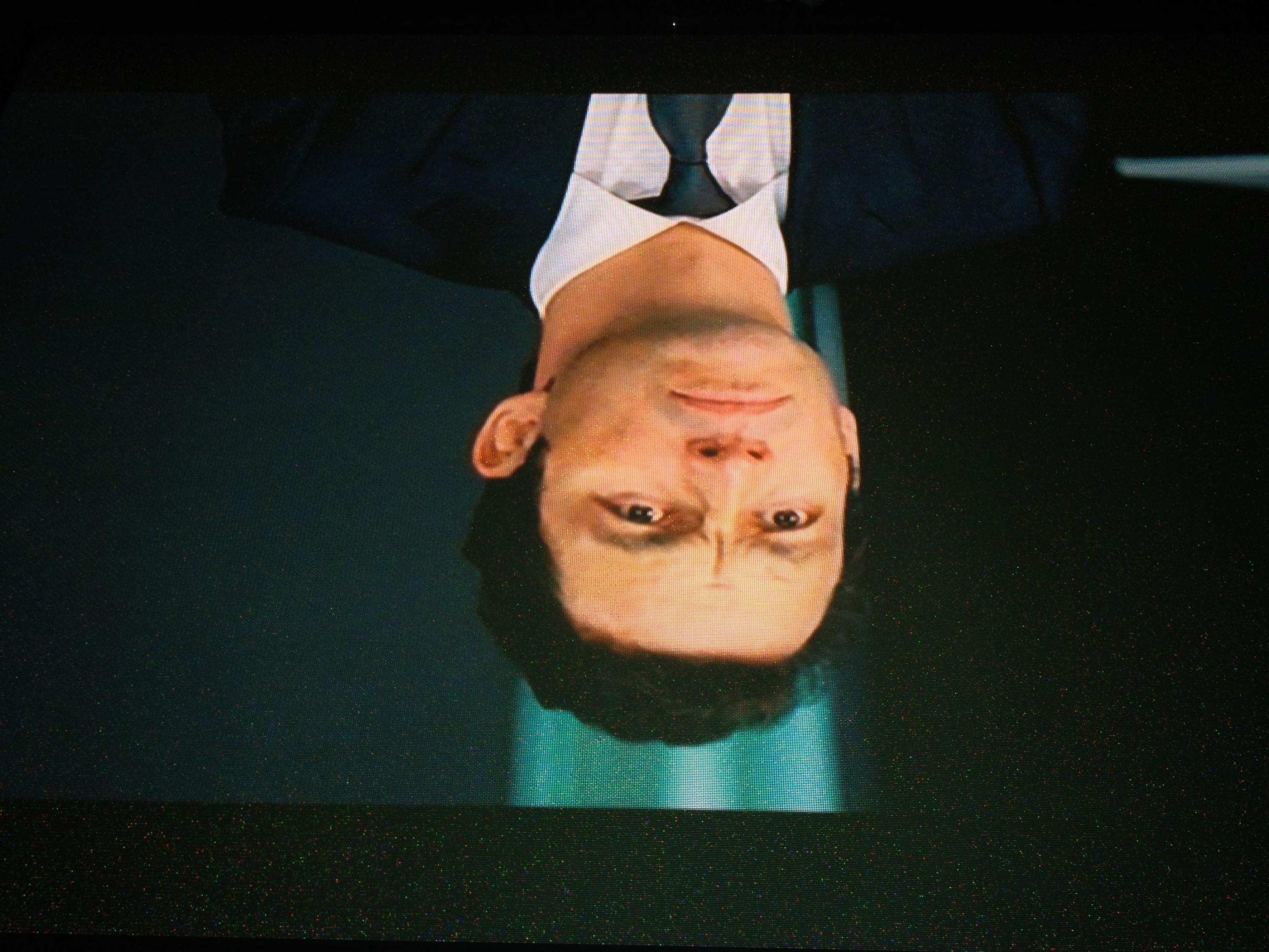

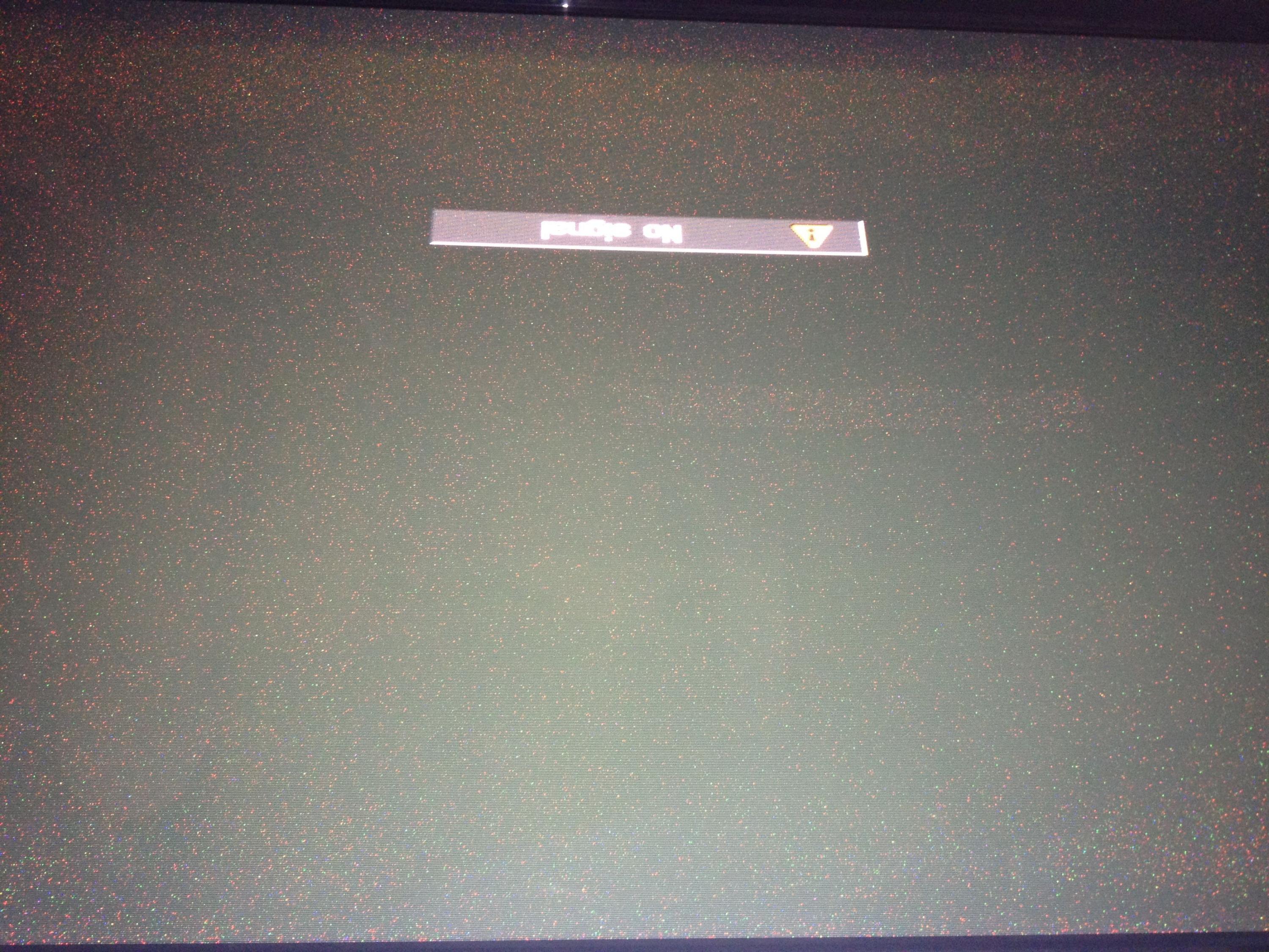

    Hey Guys,

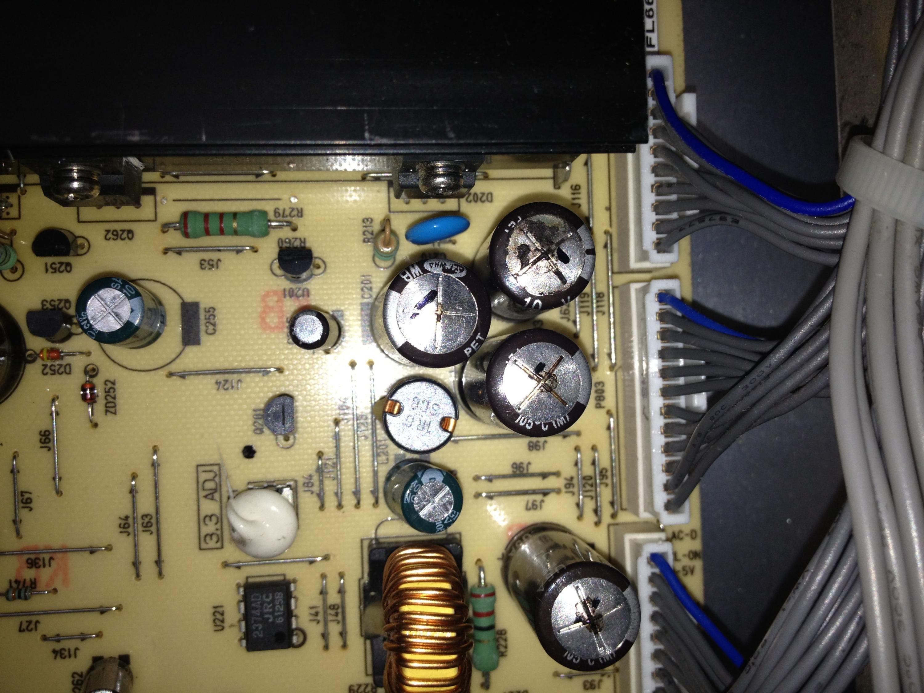

    I have been given this plasma for free so thought I would have a go at repairing it. It had sound but no picture. I traced it down to the IPM and a blown fuse on the YSUS. I have replaced both and now have picture but it seems to have a fuzzy look to it. The power board has a few swollen caps, could this be the causing the problem? I have added some pics for you to have a look at.

    Those definitely need replacement, they could cause the issue but I think it's more likely you have the common LG sparklies problem which is very difficult to fix, the panel has aged and the control board needs to have a firmware update.
    You can try knocking Vs and Va down by about 5-10V and see if that fixes it; if not, tweak SET_UP and SET_DN on the Y-sustain.

      I have already adjusted the SET_UP / DOWN to get rid of the "red snow" which worked for the redness but not the sparkles.

          OK great I'll give that a try. Would you do it before replacing the caps?
            Re: LG 42PC1D Fuzzy Picture
            I would recommend replacing the caps asap as the TV will start having problems powering up. It should work for now though.
