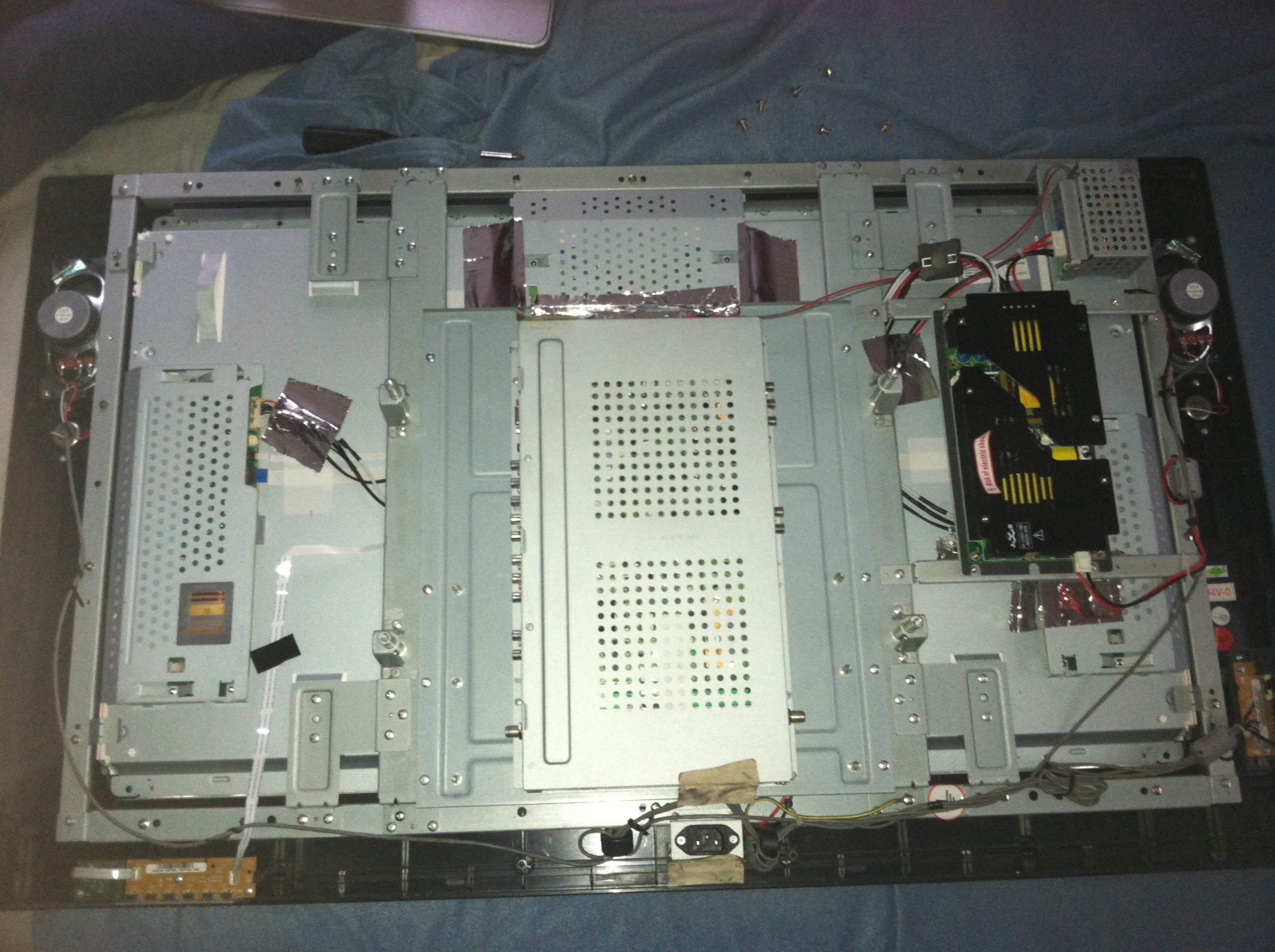

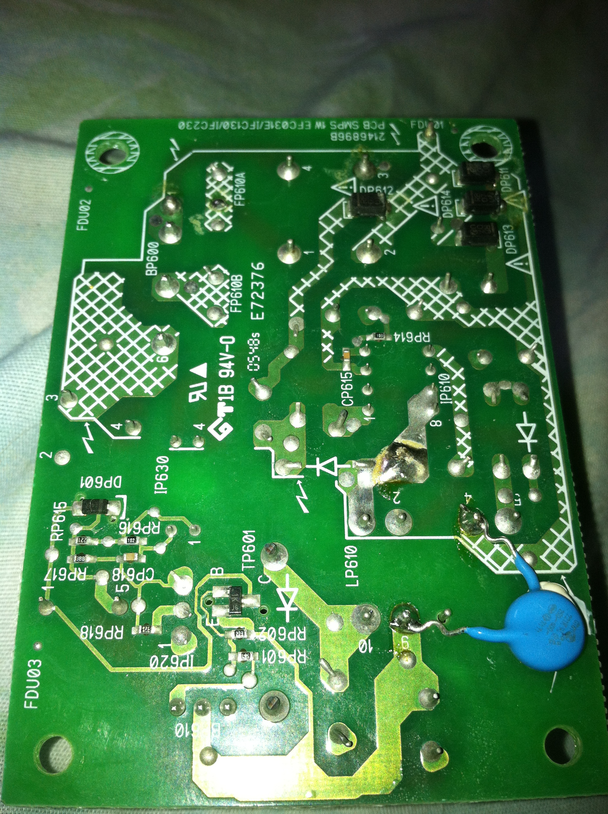

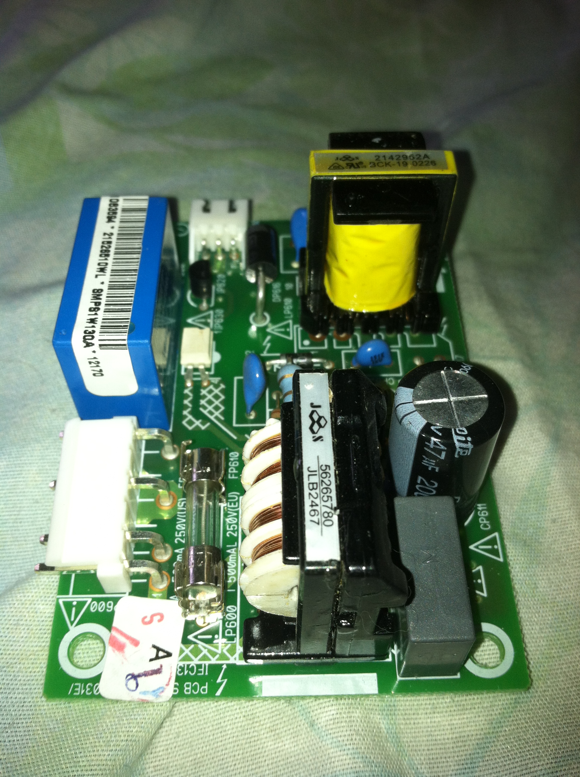

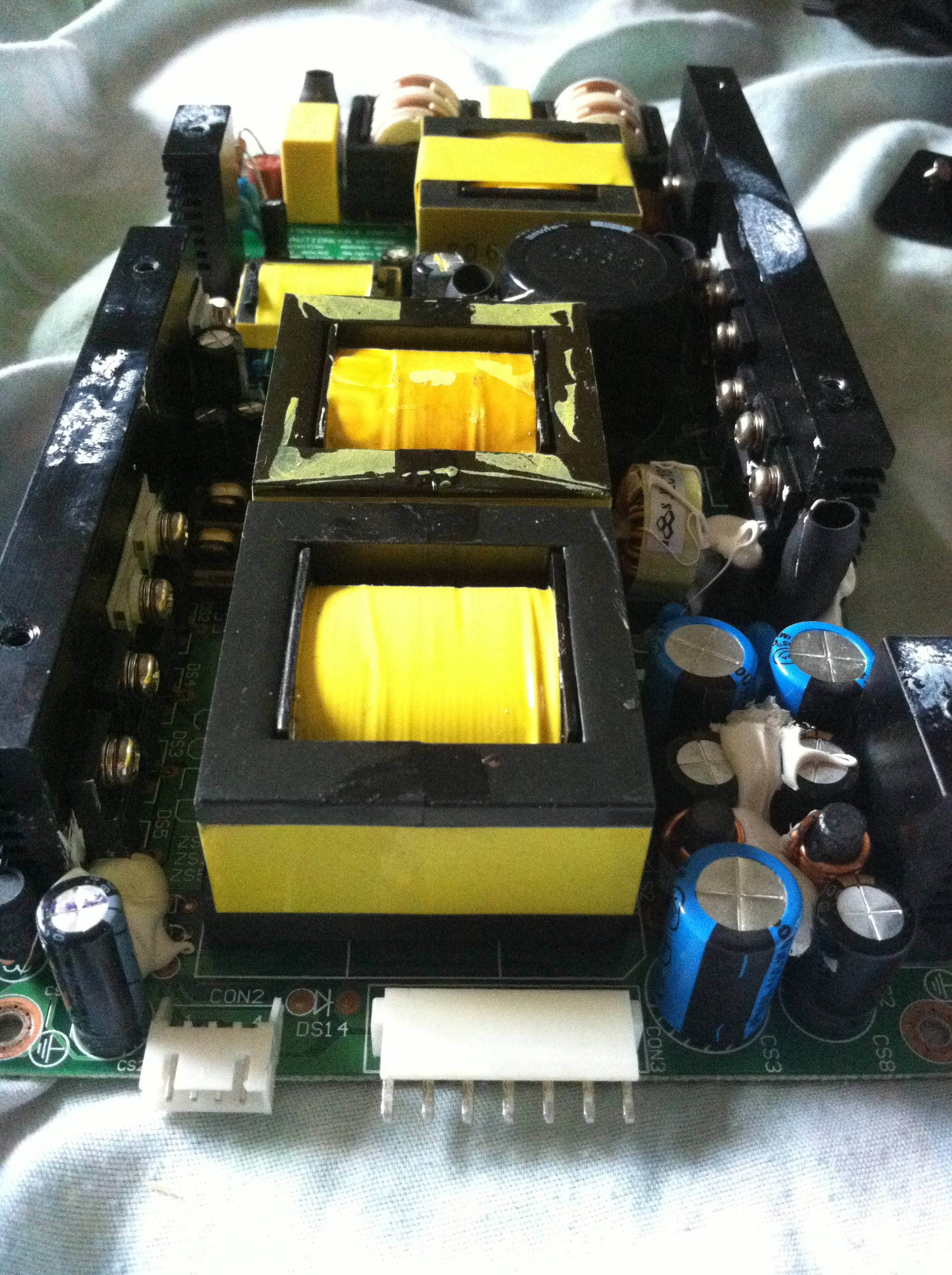

          Re: RCA L37WD12 LCD TV works fine then powers off and wont turn on
          1st picture shows the layout of everything in the chassis
          2nd is the power board. (blue capacitors are ones which i already replaced)
          3rd is the small board in the upper corner of the tv the 5 volt or watt cant remember what its called.
          4th is the underside of that board which seems suspicious looking for some reason.
          Originally posted by tom66
          It does sound like a capacitor problem, and caps can fail without visible bulging. Can you post some pictures of the general layout and boards themselves? Retiredcaps' signature has info on the ideal pictures.
            Those blue replacement caps don't inspire a lot of confidence if they were purchased from Radio Shack as they are likely to be general purpose caps. A SMPS requires low ESR caps to work properly.
              The problem was happening before I replaced those caps. For some reason I thought I was onto something but turned out I was not. But once I find the real problem I guess I will have to swap those out again with the premium ones.
              The underside of that small board has dried up gunk spots could that be a leaky cap?
              I'm no electronics expert but I plan to take some college courses eventually once I finish my degree. So I'm very much a beginner. I figured a capacitor was a capacitor as long as it has the same uf and voltage.

                That dried up gunk could be solder flux. The 3 caps that you replaced, were they bulged? I'm betting there is another cap on that power supply that has failed but not bulged. With the 2 transformers side by side and the covers over the power supply leads me to think that board gets pretty warm.
                  Flux makes sense seeing as there's no caps on the other side by the gunk. I'm sure it gets hot but it can't be overheating since it has the issue even when cold. I feel as though the tiny capacitors would be very unlikely to fail unless there was a manufacturing issue. I'm wondering if its the large main capacitor which is in the middle with the black top.
