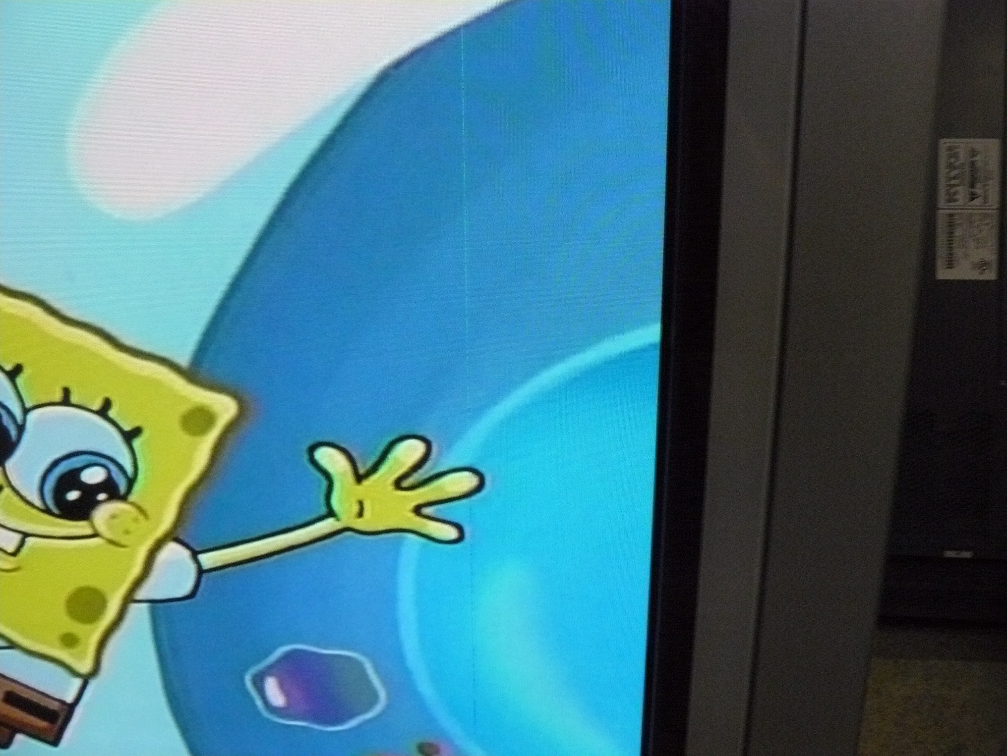

    Philips 50PF7321D/37 Line in the screen
    This tv was FREE!!!
    The guy said it had the 6 blink error code but for the moment it turns on. There are a few buldged caps under a heatsink which will probably be a big-ol-pain to replace but that can be another thread
    There is a faint green line on the right side of the screen one pixel wide. Does this look like a buffer starting on its way out or the panel is starting to show its age. It's not terribly noticable but i'm curious if it will get worse as time goes on.
    Re: Philips 50PF7321D/37 Line in the screen
    It's a panel failure, not repairable. Fairly common to have that with older TVs. But otherwise, looks in good order.
    Not a bad TV for free.
    • Mr Bill
      • Nov 2011
      • 648
      Do you think it'll get worse tom? I'm probably just gonna give it away since i have nothing invested in it other than a recap of the power board.
      Thanks for the input
        It's unlikely to get worse, just a defect in the driver IC which has developed due to heat/age/stress/manufacturing error. Unfortunately, the drivers are not replaceable (for some reason, I'm not sure why...)
