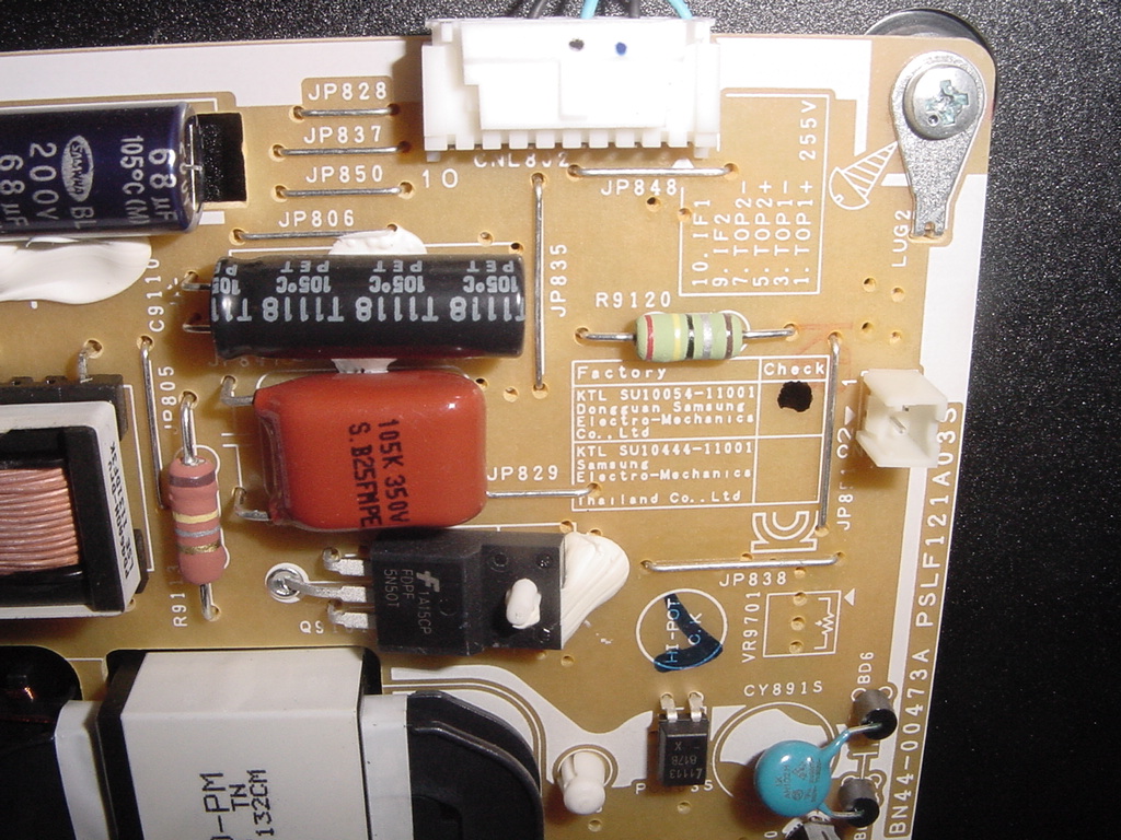

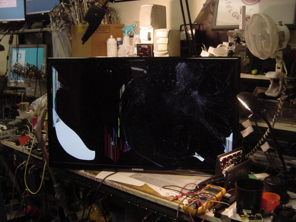

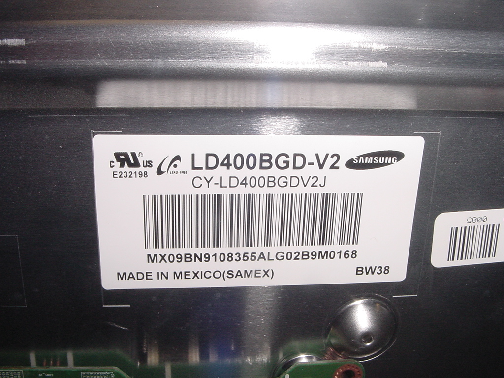

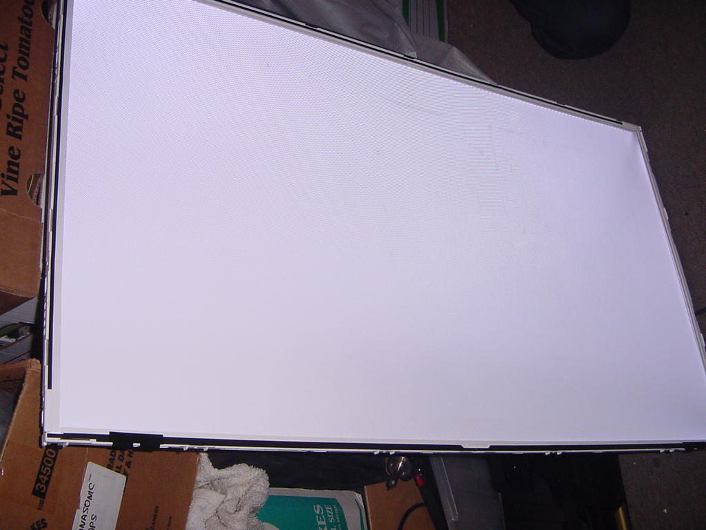

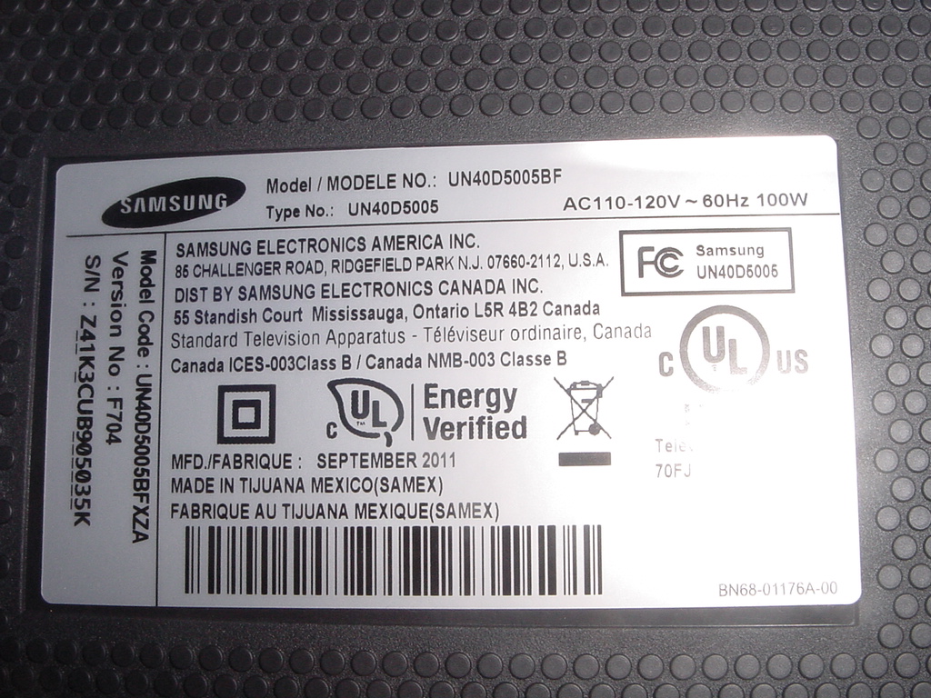

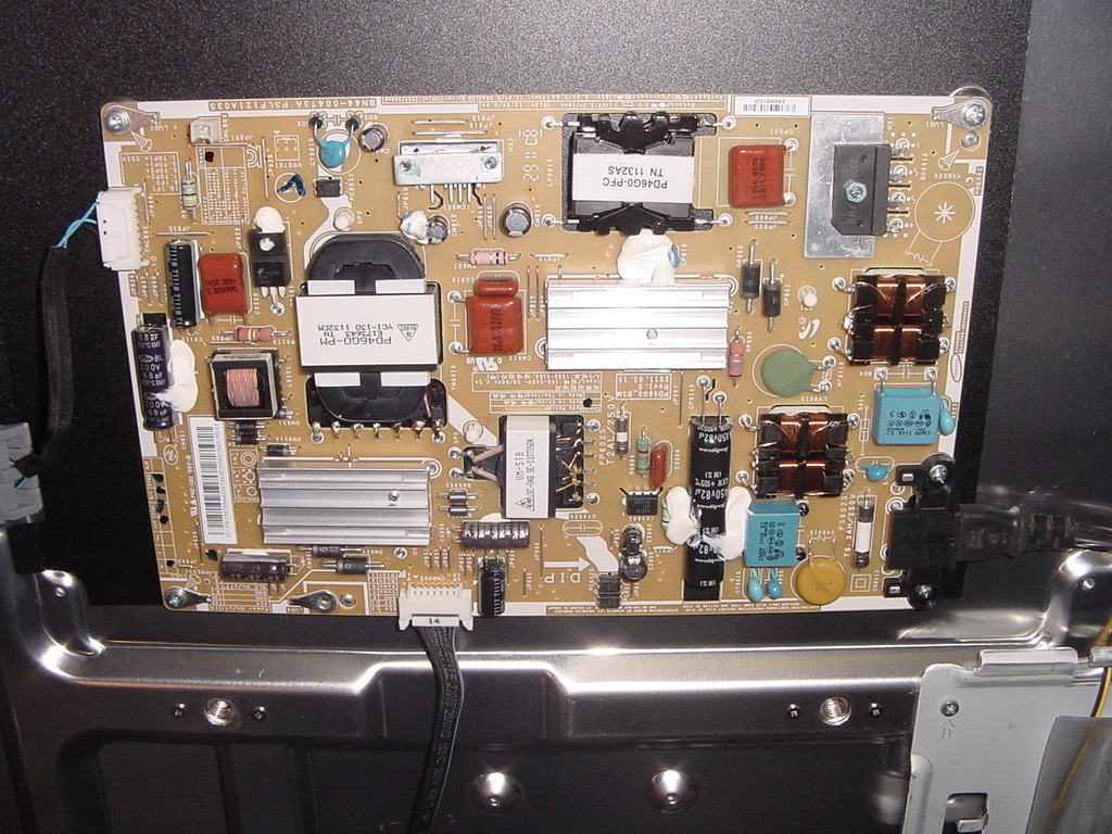

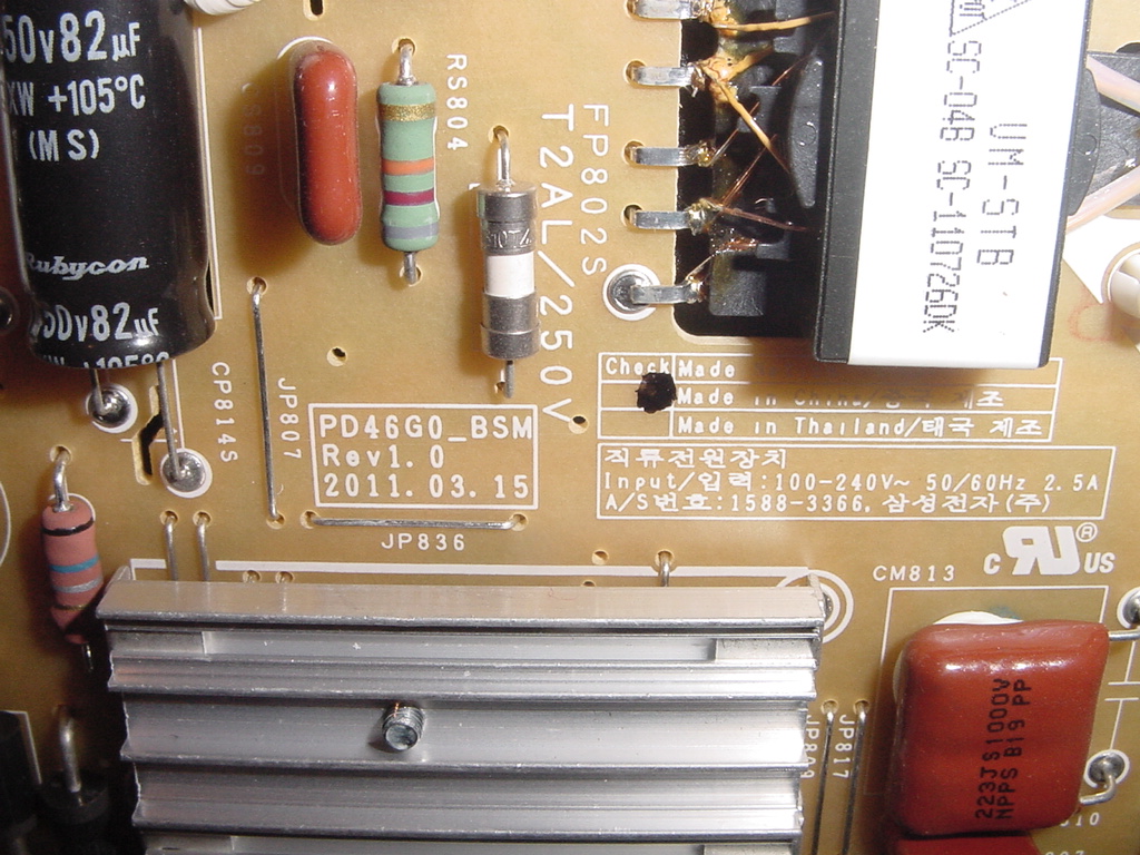

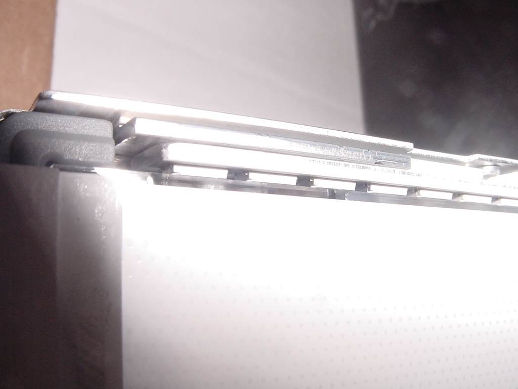

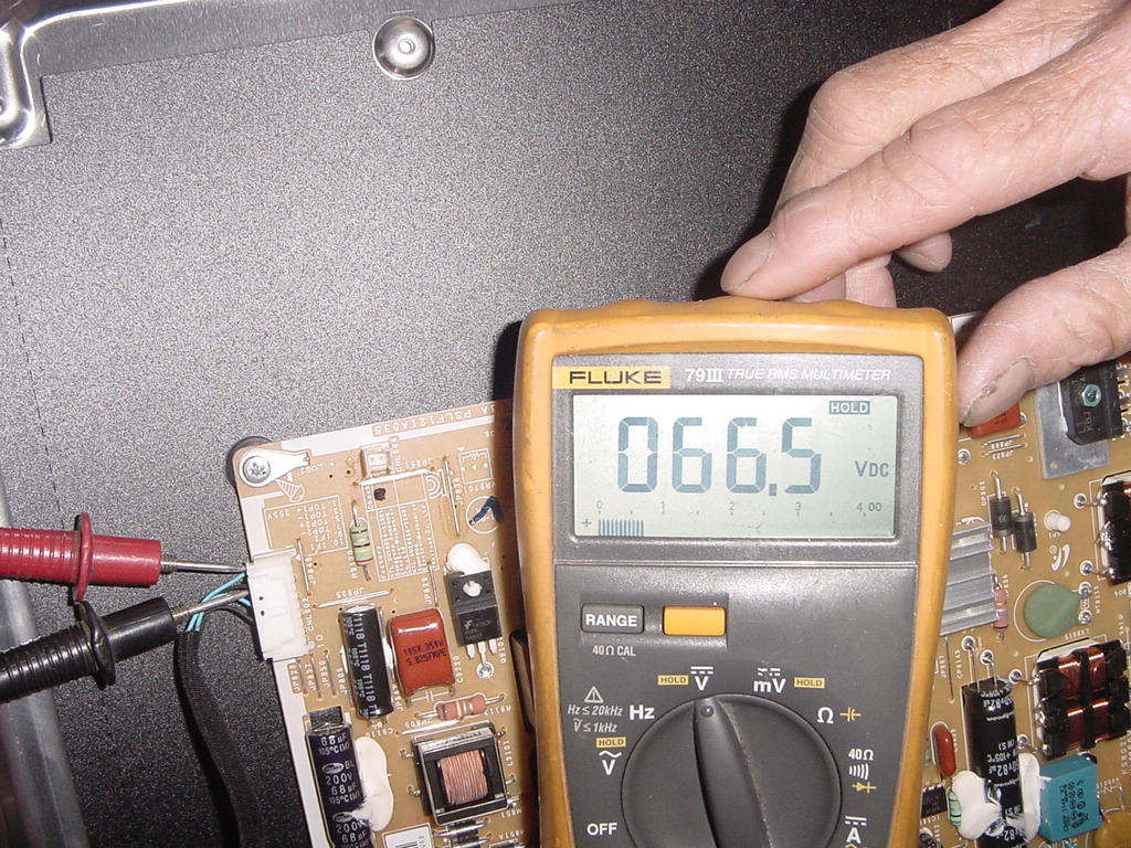

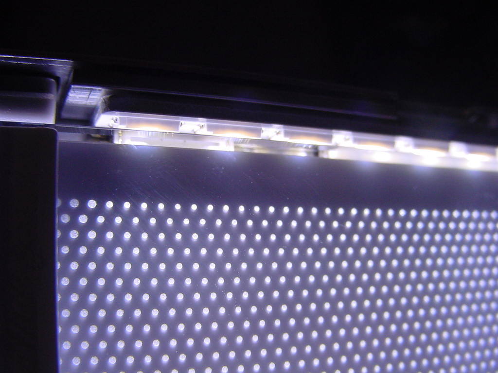

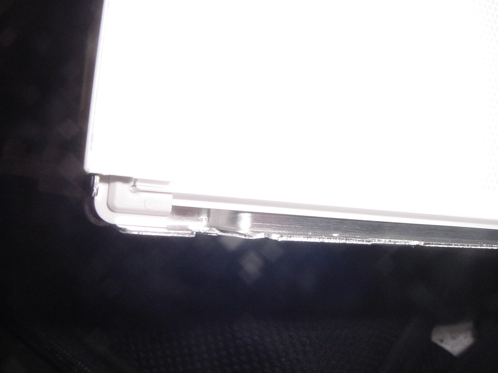

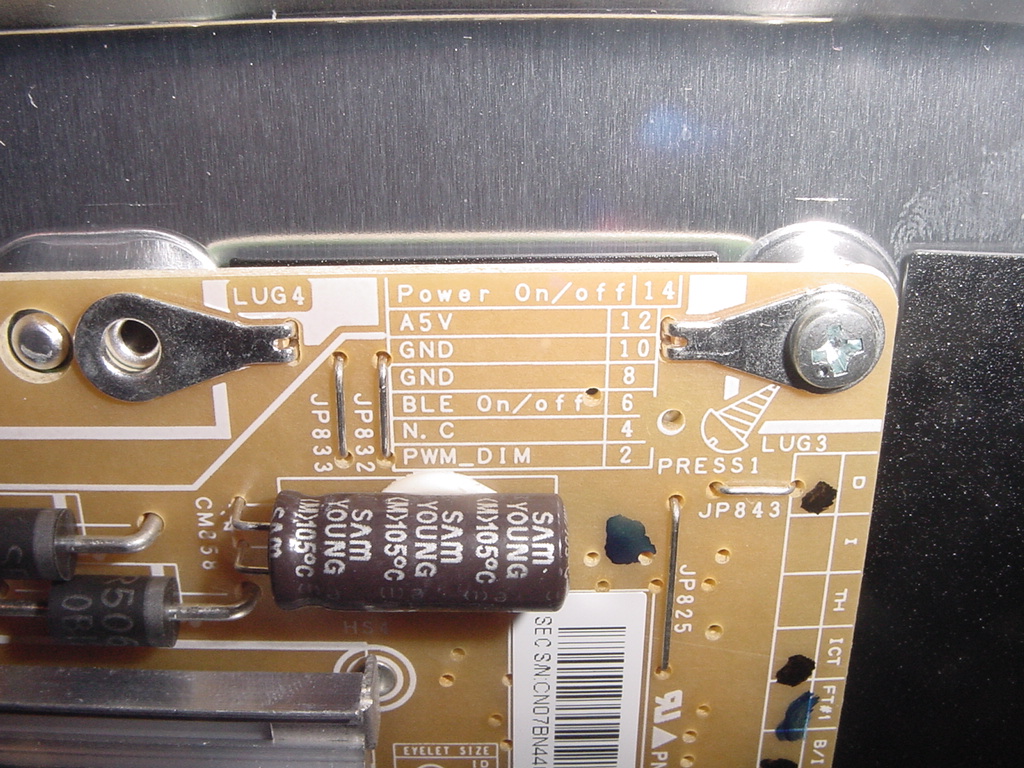

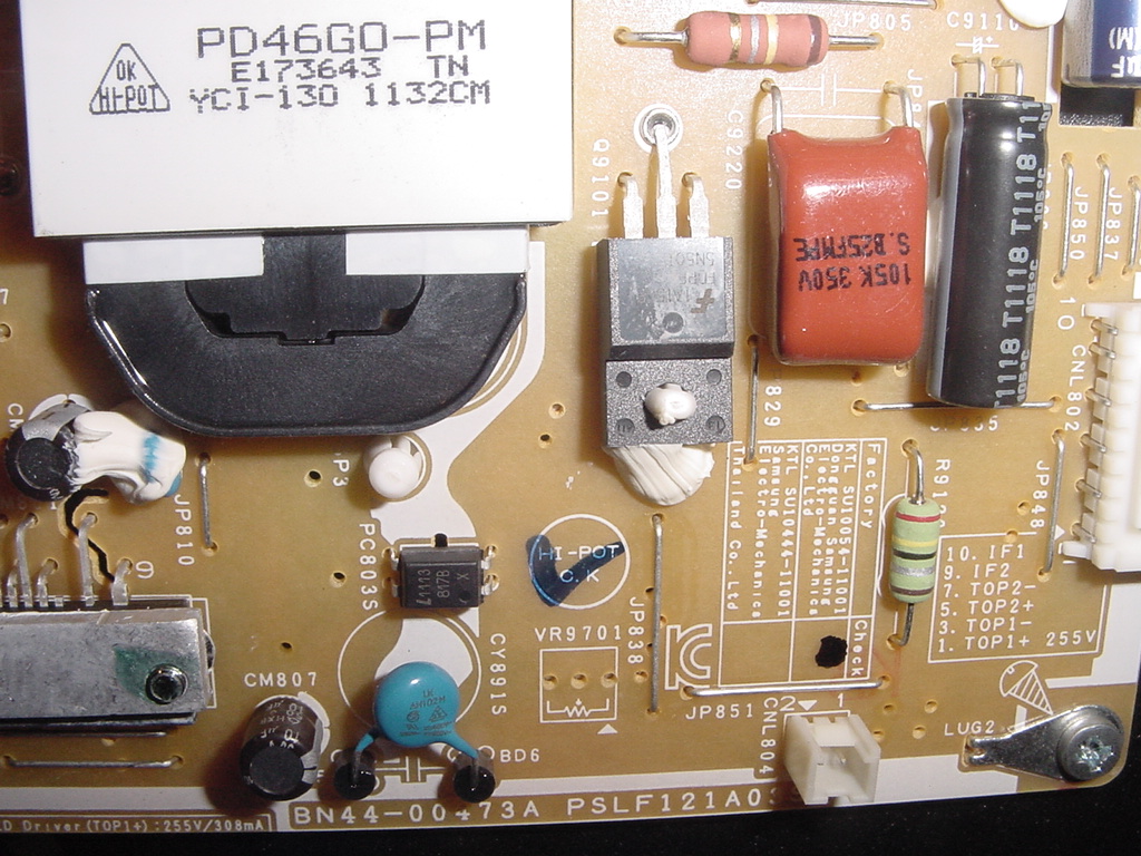

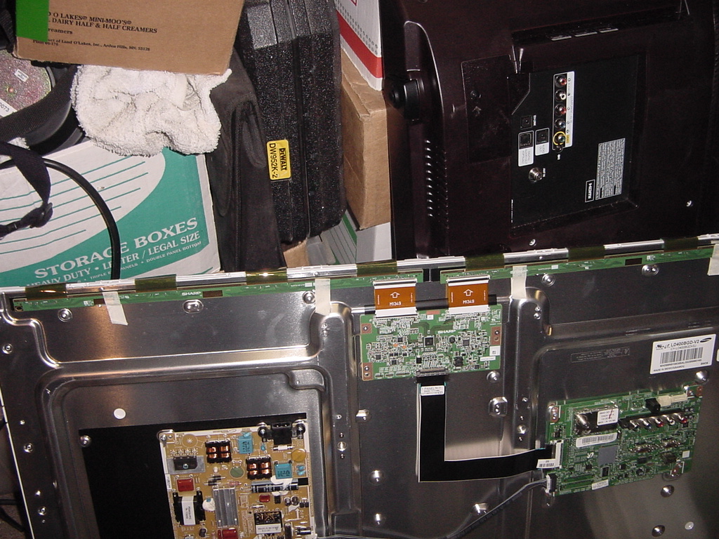

    Got this one in today, it had busted screen so I took it apart to see how Samsung designs Edge-lit LED backlights panel. it only has the LED assemblies (2) on the top edge, each assembly has 125 LED. The voltage feeding for each assembly is about 60VDC (I did not check it for AC reading, but I know it is being pulsed (more likely with PWM) which I can see it on my digital camera). The power supply has PFC Voltage booster, power consumption is almost 100 Watts.
    It is amazing how bright this thing with just one edge-lit setup.

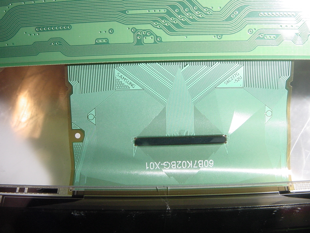

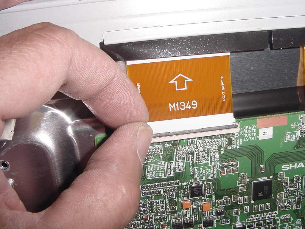

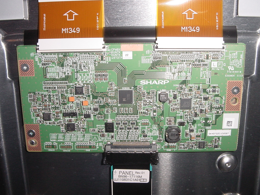

    The panel is made by SAMSUNG, but the T-CON board is made by SHARP (I did not know when Sharp starts working with Samsung, I know that Samsung is no longer making panel with SONY).
    This is going be a great light table.

    Looks interesting construction. Only thing I notice is that why is it that LED TV have to be the only thin TV? A thin TV could be made using CCFLs too. I don't see how an LED TV is better than CCFL (in terms of picture quality), although at least light failure is less likely to occur.

          @popeye: the scratch is on the top side of the actual LCD panel (the part that contain the liquid crystal), you cannot separate the LCD panel.

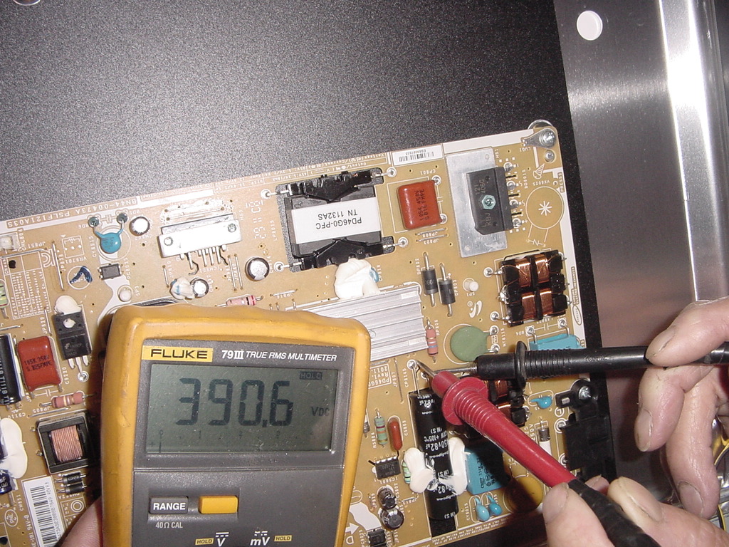

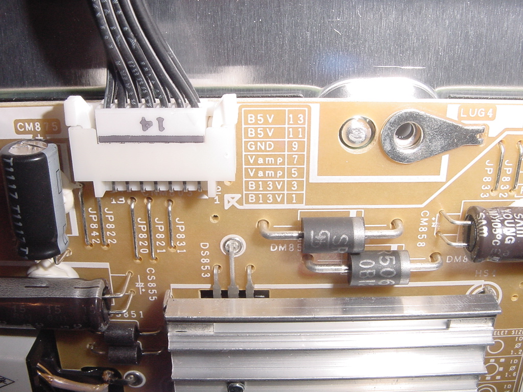

            Bud, I would like to see that 390V on my TV
            That 66V it's for the LEDs?
              Re: Samsung UN40D5005BF edge-lit LED backlights tear down
              The 66VDC is what I measured at the LED connectors.

                Thanks for putting those pictures up budm, they are interesting to me because i have a Samsung UE37D6100 led edge lit tv. I have had it 8 months with no problems so far, and it's still in warranty for another few months. But once the warranty's run out i was wondering if it would be a good idea to take the back off to see what caps it had fitted. Was thinking it might be wise to replace any that were not a good brand.
                I see a mixture of brands on the set you have torn down, so i guess i can expect to find a similar mixture in mine. Obviously i am not going to touch it whilst it is warranty, but do you think it would be a wise precaution to re-cap it once the warranty is up, even though it's not giving trouble?
                  Cannot really tell, one thing I notice is that it runs really cool since it does not have 16 or more CCFL running which they get pretty hot inside those TV with CCFL.
                  Only time will tell.

                    I must admit i was surprised to see that they are only lit along the top edge, i was expecting at least top and bottom lighting, if not all sides. Quite impressed it gives out such an even and bright light in that config.
