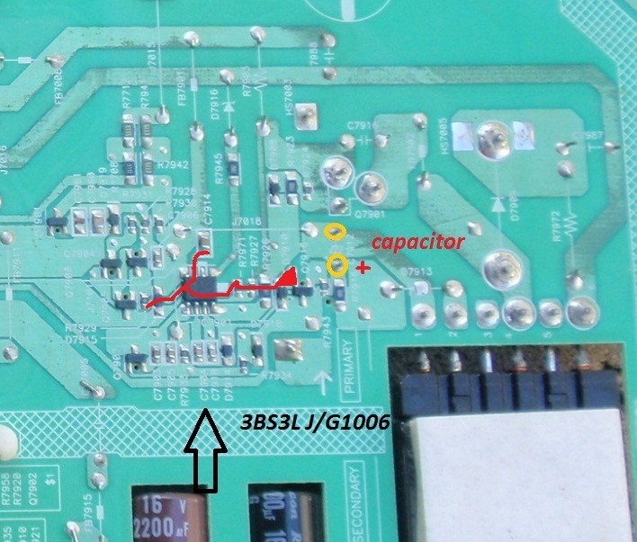

    That small capacitor value is 22uf/100V and I'm measuring E=0.63/25.7uf.
    On the connector of the meter it shows E=0.31.
    I don't have this capacitor with 100V value, only 50V.

                      #70
                      Re: Sharp LC-40LE810UN question
                      That voltage supplied to D7910 and the transistor is used for other circuit. The positive leg of the start-up cap should be connected directly to the VCC pin of the SMPS IC.
                      I am tempted to use a 18V source to feed the VCC pin to kick start the SMPS IC and see if it will stay running after removing the kickstart. Do it with the protection lamp you made.

                          #72
                          "The positive leg of the start-up cap should be connected directly to the VCC pin of the SMPS IC" I just want to verify if my drawing is correct that C7912 is hooked up as I traced it.

                            #73
                            The pin#7 goes to R7929. It's on the right side of the IC.
                              #74
                              I see the trace goes under the IC body and then split? to the left and also to the right toward the start-up cap. Please look real close again.

                                #75
                                It's not going directly to the cap, it's going through that transistor on the right side.
                                I have applied the 18V to pin#7, but nothing happened. The 109.5 at pin#5 (now it's lower 106V) became 126V.

                                      #78
                                      What exactly should I look for when I apply the 18V?
                                      I was measuring the main caps and they remained at 162V.
                                      Where I have marked with red that line shows 0.2Ohm.
                                      On page #8 they mention some voltage has to be under 6.23V and I'm measuring 5.99-6.1V. Not sure what they mean by that though.
                                      I'm suspecting the IC too and I can't seem to find it online, except from th Chinese dealers.
                                        #79
                                        Output voltages. I think it's switching but it sees a short on the outputs. Check ALL of secondary for shorts. Do you have a scope yet?
                                          #80
                                          Any voltage on those two 2200uf 16V caps on the secondary side.
