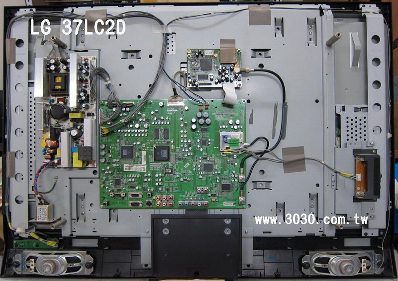

                Re: recapped psu 37lc2d lg tv no pic no sound
                http://www.3030.com.tw/Image/jv-LG-37LC2D-01.jpg
                  thanks selldor very close but not the same the set i have (will upload pics soon) has two mainboard side by side with 3 white and one grey multi strand wire connector joining them together one board has scart inputs one has hdmi/ldvs connector on cheers for trying to help have to pop out soon will check back later
                    https://www.badcaps.net/forum/attach...9&d=1353449783
                      thanks selldoor top link spot on i will replace the capacitors the put the harnesses back in correct place cheers again will update when done repair tomorrow.
                      second link i get download error on pdf?
