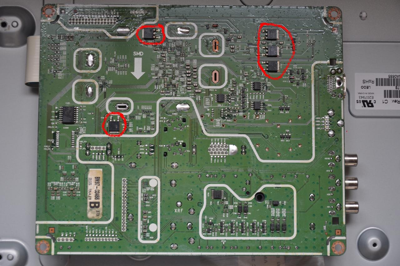

        Re: Samsung LN32B460 turns on only after repeated attempts
        Check the voltage regulators on the main board (circled in red). My sig file has instructions.
          I tested them but I am having a hard time finding the data sheets. What I have so far...
            Originally posted by Dardo
            78M098
            KV 9A
            8.84
            0.00
            13.07
            http://pdf1.alldatasheet.com/datashe.../L78M09AB.html
            78M09 is a 7800 series with 9V as the output voltage. At 8.84 it is 1.78% out. I use +/- 1% tolerance and others use +/- 2%. For now, assume it is good, but if you grasping at straws ...
            IC427
            119nB
            17-18
            0.00
            1.811
            3.26
            17-18 is a 1117-18 fixed regulator. 1.8V should be the output voltage. IC427 is good.
                If you turn the main board over there are a lot more voltage regulators on the back to test.
                          Yup, I didn't even notice that. Good thing selldoor is our resident eagle eyes. 5 more to check.
                              Thanks selldor and retiredcaps.
                              OK I checked the voltage regulators. I assume I need the readings when the screen is on, as some have power only when in standby.
                              IC601
                              1117
                              0944EG
                              pin 1 = 0.017
                              pin 2 = 1.264
                              pin 3 = 3.28
                              IC505
                              1117
                              0944EG
                              pin 1 = 0.631
                              pin 2 = 1.891
                              pin 3 = 4.75
                              IC109
                              17-33
                              0944DG
                              pin 1 = 0.017
                              pin 2 = 3.29
                              pin 3 = 5.10
                              IC106
                              17-33
                              0944DG
                              pin 1 = 0.017
                              pin 2 = 3.31
                              pin 3 = 4.75
                              IC110
                              7805AF
                              943
                              pin 1 = 8.82
                              pin 2 = 0.016
                              pin 3 = 5.05
                              I'm guessing there may be a problem with IC505?
                                IC505 is fine - adjust measures 0.631V so output should be 0.631V + 1.25V(ref) = 1.881V. Actually 1.891V but that's fine.
                                As you are trying to track down an intermittent fault, try to get measurements with the TV "failed". So, when it fails to start up, measure the voltages while it is in this mode, before it goes back to standby.
                                  IC505
                                  1117
                                  0944EG
                                  pin 1 = 0.631
                                  pin 2 = 1.891
                                  pin 3 = 4.75
                                  The readings say it is good. Re-read my link on how to test a voltage regulator.
                                  1.891 - 0.631= 1.26.
                                  Having said that, there is a possibility that the voltage on pin 1 is incorrect. The components feeding pin 1 could be off or pin 1 itself on the regulator can be bad.
                                  Without a service manual, there is no way to be 100% sure.
                                  The "common" output voltages are normally 1.25, 1.5, 1.8, 2.5 and 3.3.
                                  1.891 is 5.05% out of tolerance when compared to 1.8. So if IC505 is really supposed to be outputting 1.8, then the regulator is bad.
                                  edit: tom66 beat me -> I'm too slow today.
                                    The regulator should be OK, I have seen some Samsung LCDs which use 1.9V rails instead of 1.8V. Don't ask me why, though! The Vref is 1.26V, which is 0.8% out.

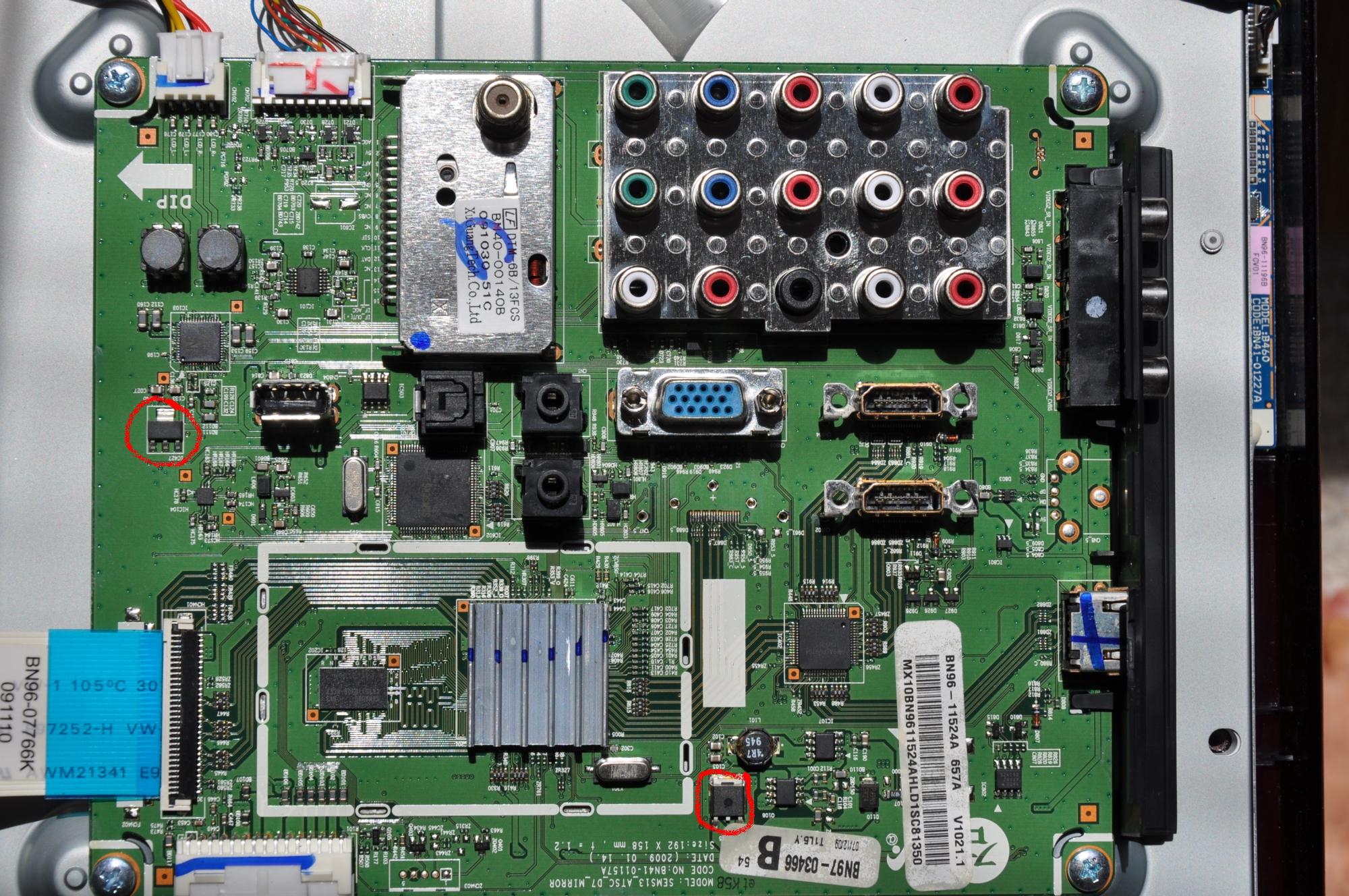

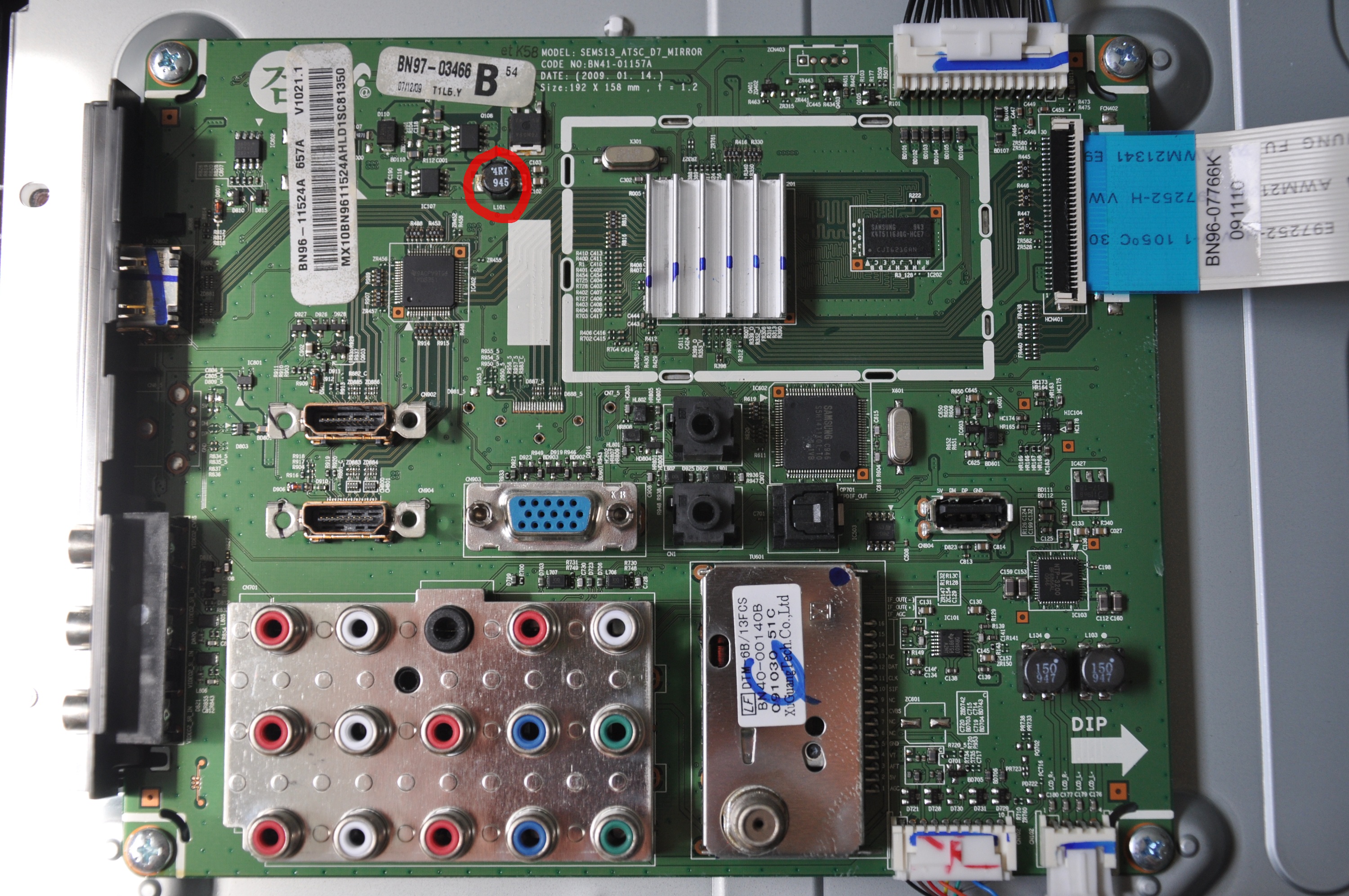

                                          #40
                                          Can anyone tell me what the part circled red in the pic is? Does anyone have a schematic?
