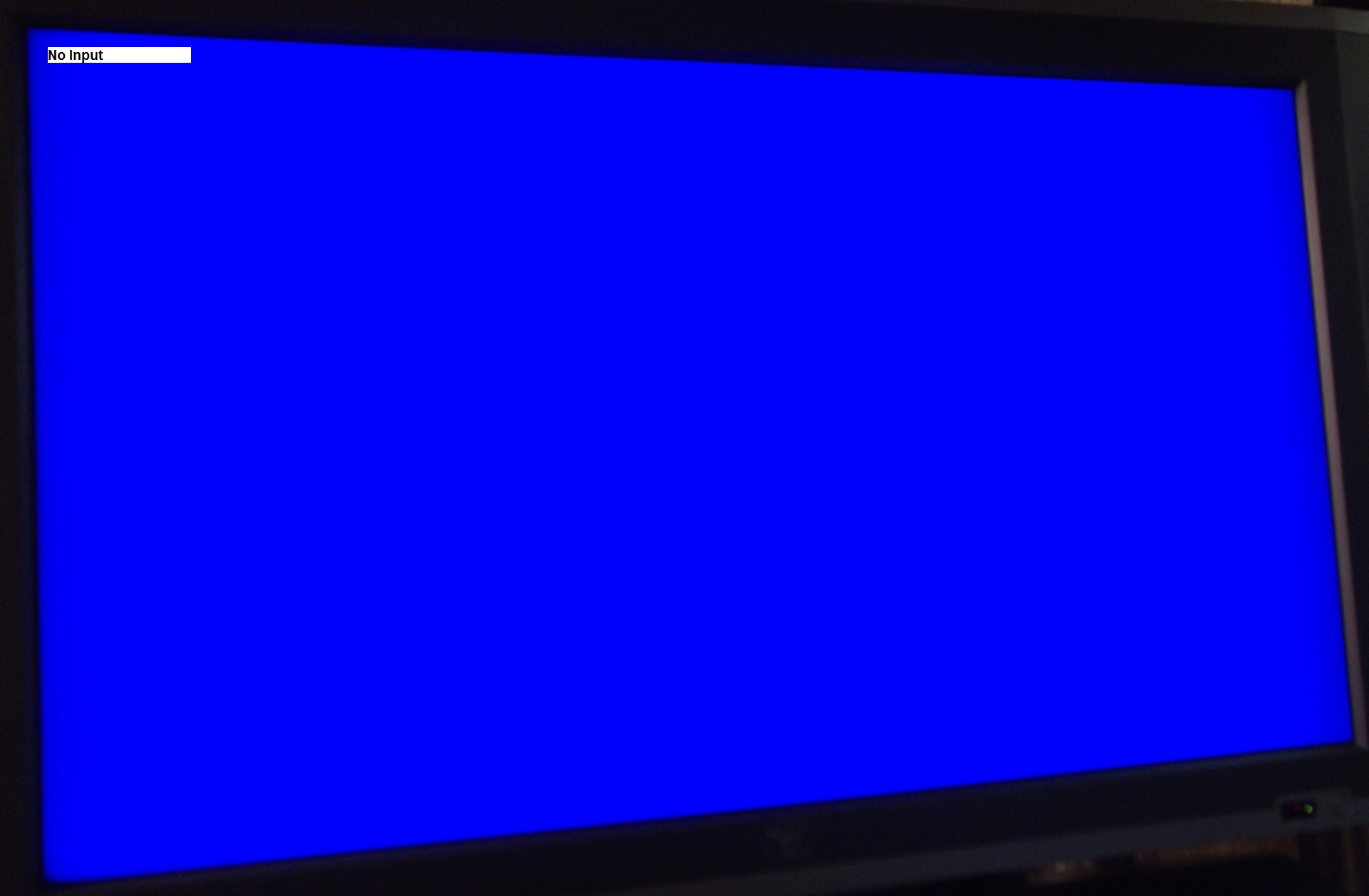

    Greetings BadCappers:
    1) Am I correct that the "No Input" blue screen picture, indicates that the LCD screen itself is OK?

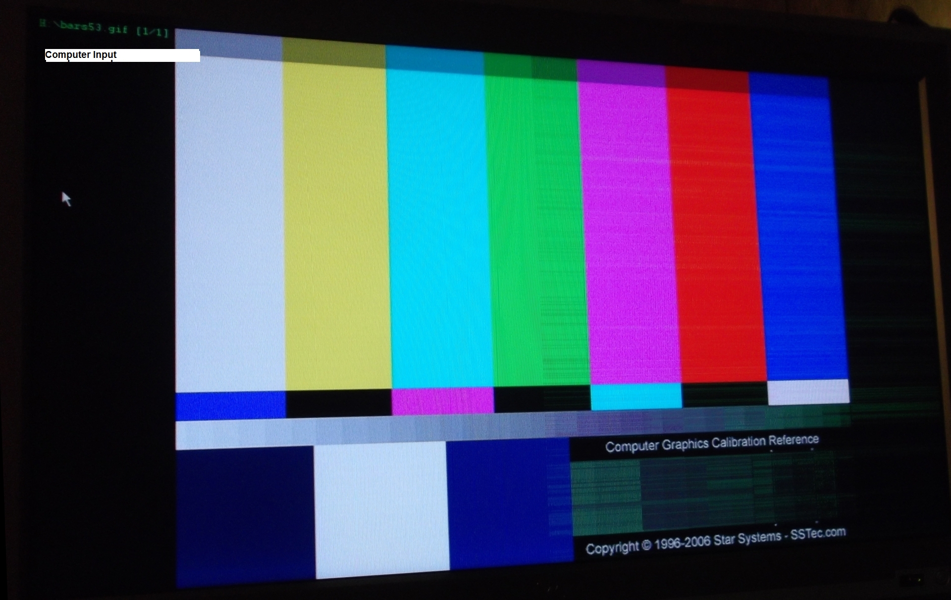

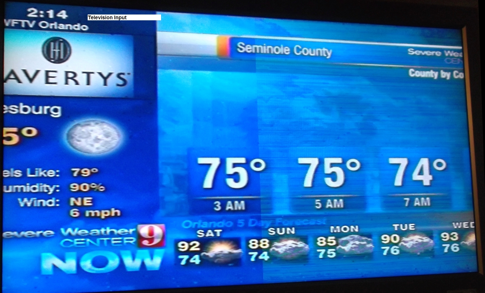

      --Thanks for the prompt response. "Display???" is mentioned in the title of the thread. I am trying to use the good offices of this forum to determine if the problem is a bad LCD screen or whether the problem is more likely a circuit board. Either eventuality will require opening her up. The display with no input seems right enough, but with the Computer and TV inputs, there is a quite noticeable problem on the right side. Please have another look at the pics and let me know what you think.

          Dear Selldoor:
          --Picture is a perfect blue when there is no input but is switched on. Does the screen have a blue tint, because the CCFL tubes (I believe) are white? In the computer mode and the TV mode there are flashing pixels in the picture. This is much more obvious on the right half of the screen. Freeze spray and tapping does nothing. I will take the back off in the next couple of days, and try re-seating all cables and pressing down on the ribbon cables where they connect to the screen. I will provide pictures, so that they will be part of the record, for anyone else.

            I finally see the problem on the picture with the color bars. The whole right side is fuzzy a little.
            This may sound goofy but... I had a Westinghouse SK-32H240S that had no picture and the fix was simply gently cleaning off the ribbon cables at their contact points. It may have started out looking like yours. I only found that fix in another forum.
            It was like they used the wrong stuff when making the TV and it made these connections more insulative than conducting.
