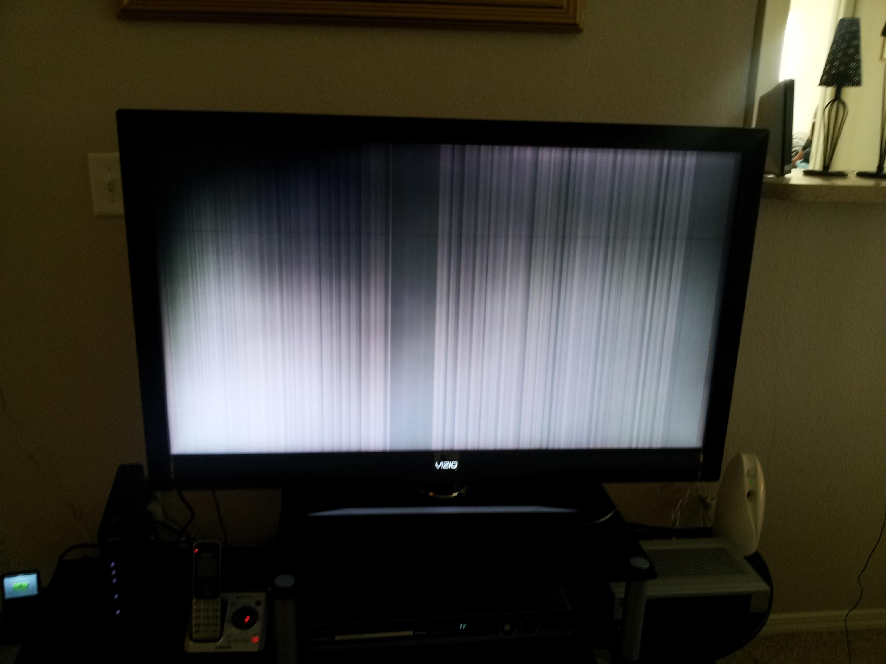

    just turned on the tv and waiting for the issue to develop so i could take pictures or do a short video

      http://youtu.be/gOUU9vKg35s
      youtube link to video,waiting to take pictures

          not at all,this seem a totally different issue(now its scary)

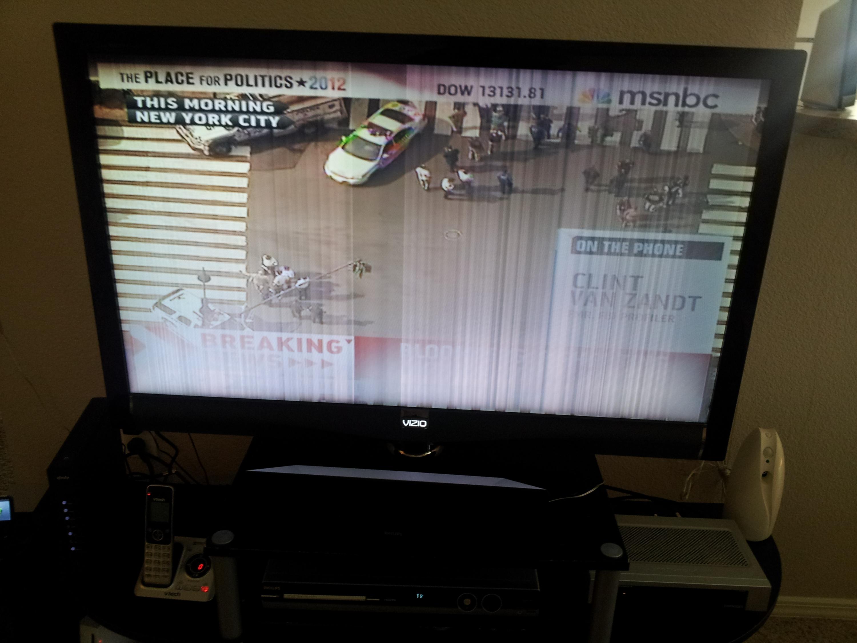

          the vizio logo stays on when the tv screen is blank and it still has sound and sometimes it just freezes but still has sound,have not seen the tv go out cos i am watching an action movie.watching the mayor of NY speech and its doing the same thing

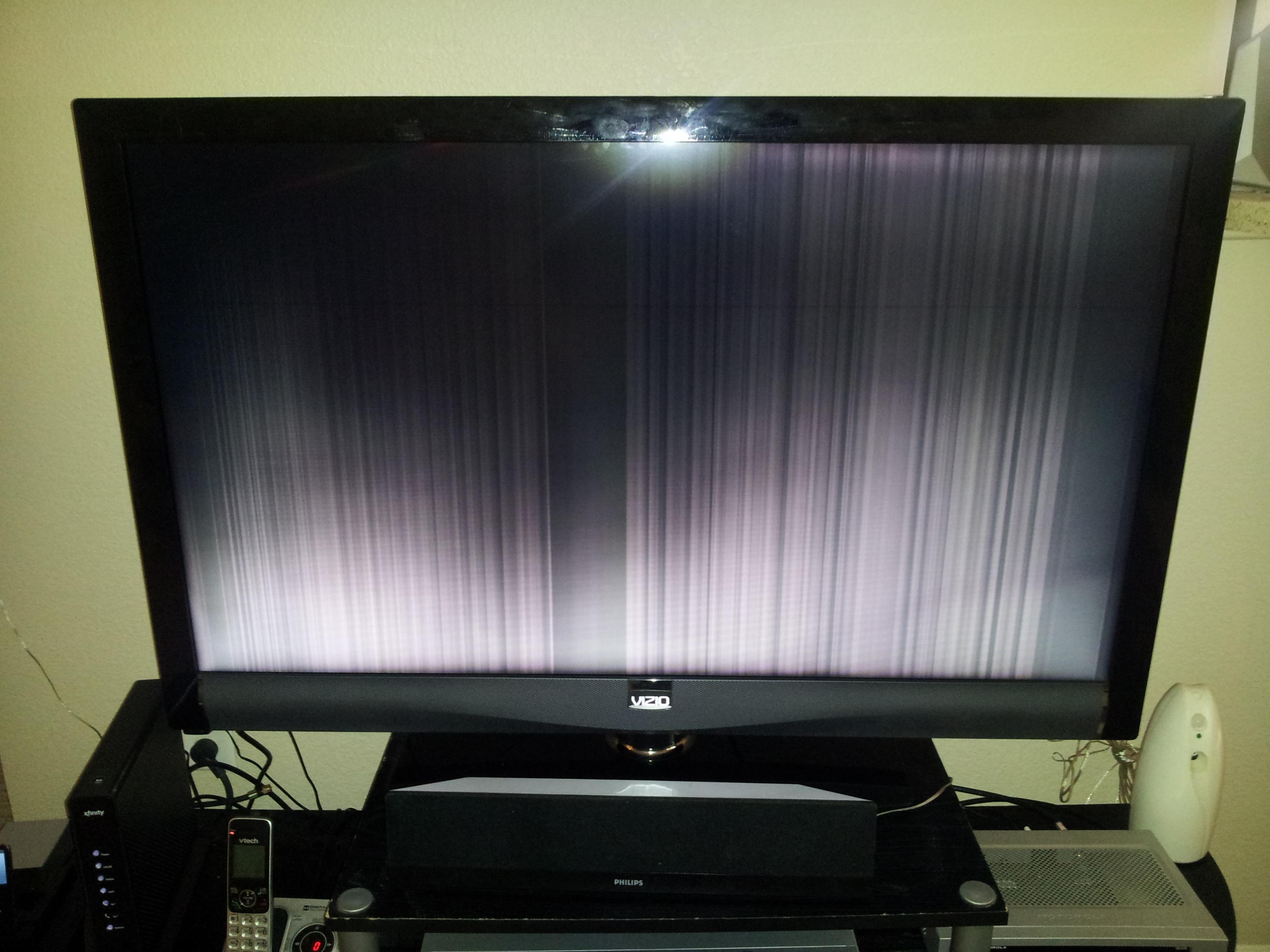

              Re: Vizio led 42inch m421vt screen freezes then goes out
              okay,wierd development,the white lines dance all over the screen and now its working again without me even turning it off,has dont that twice after i took the pictures

                gone off now

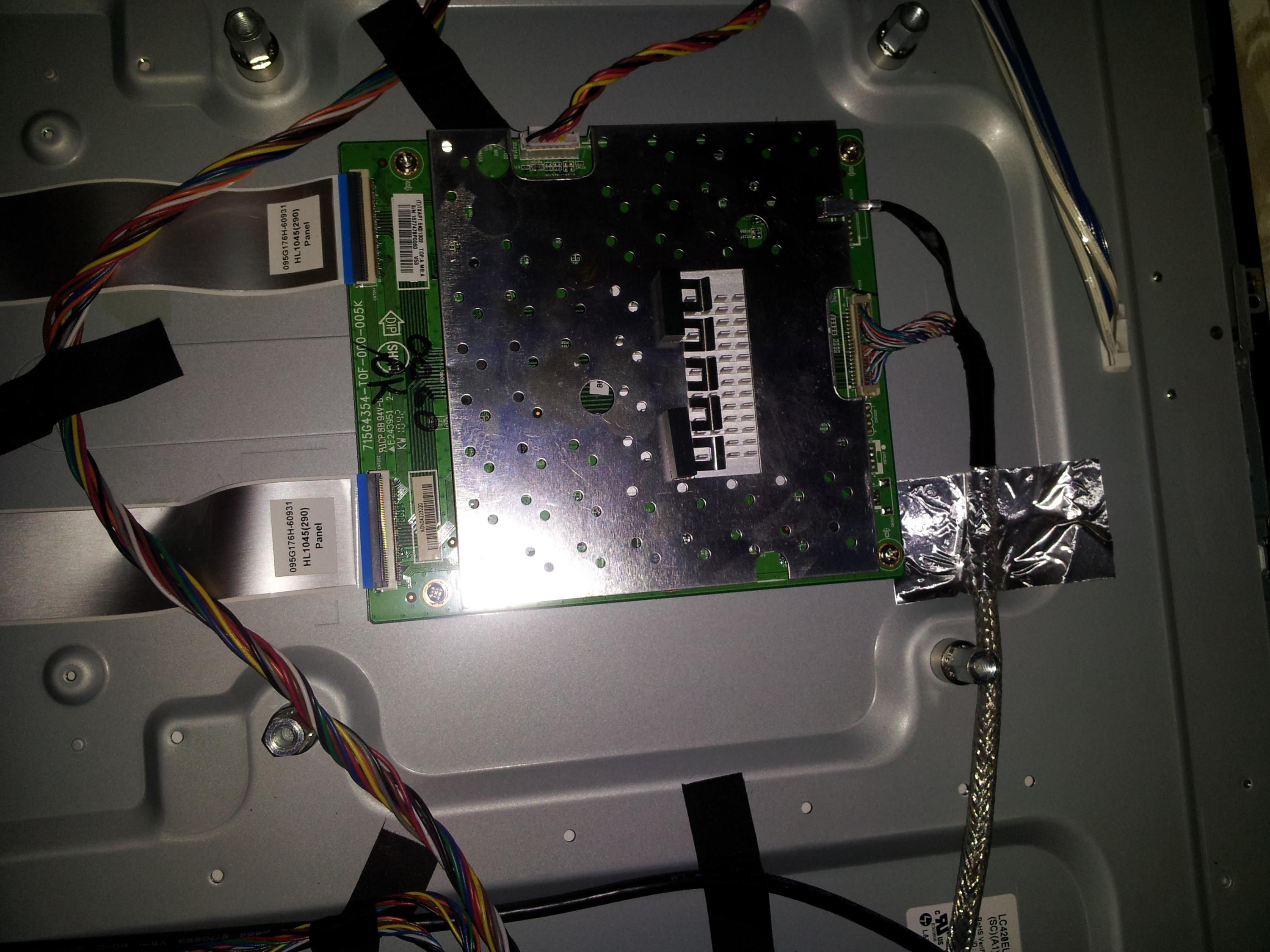

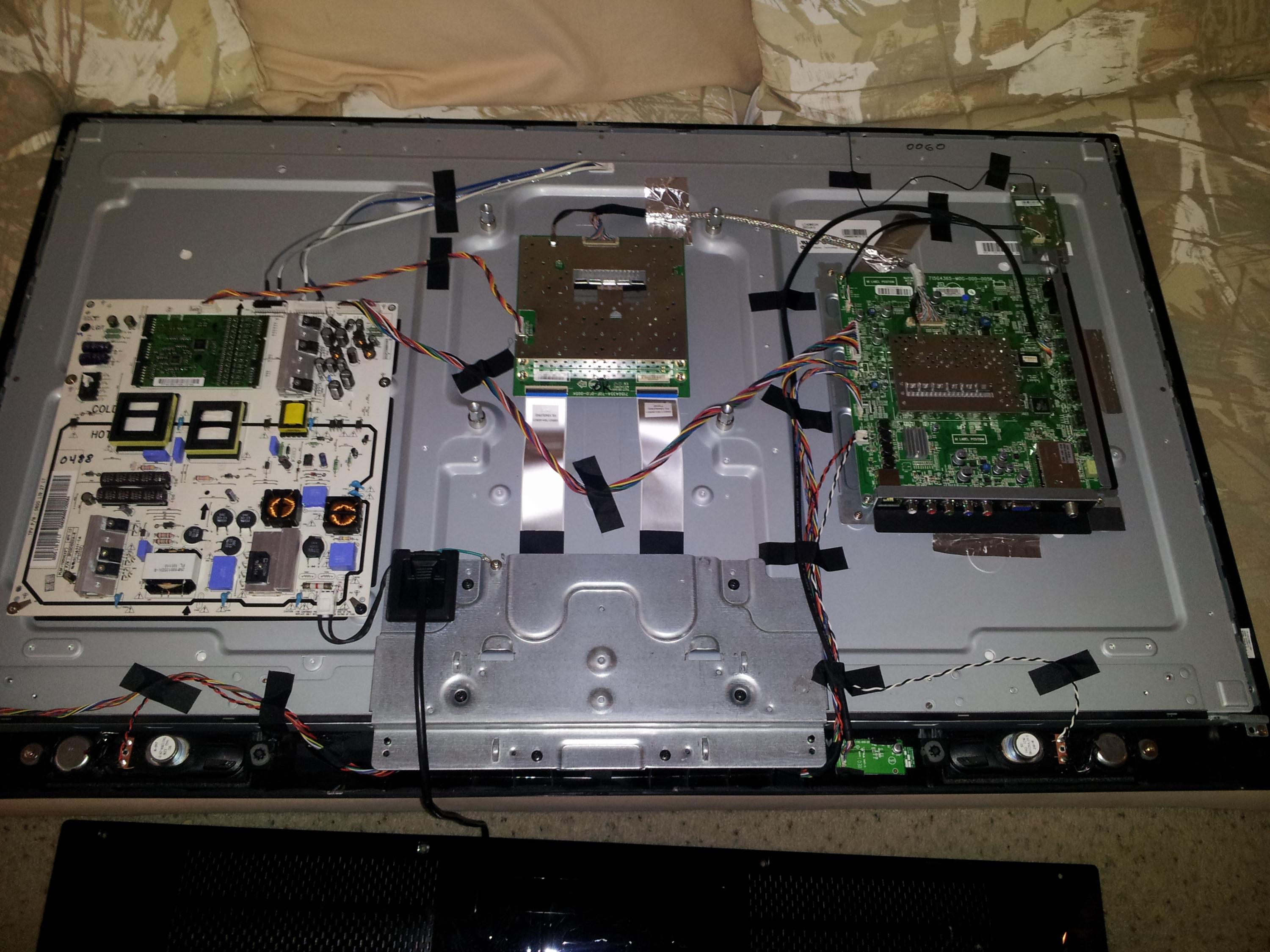

                  You say they replace a panel. Was it the LCD panel or a main board replaced? If they replaced the LCD panel, then most likely the main board is at fault.
                    My bet is a loose LVDS cable hooking between the main board and T-con (board attached to LCD.)

                      I think it was the power panel,will take a pic of the inside and telll you which ne it is

                        will also take a pic and let you see

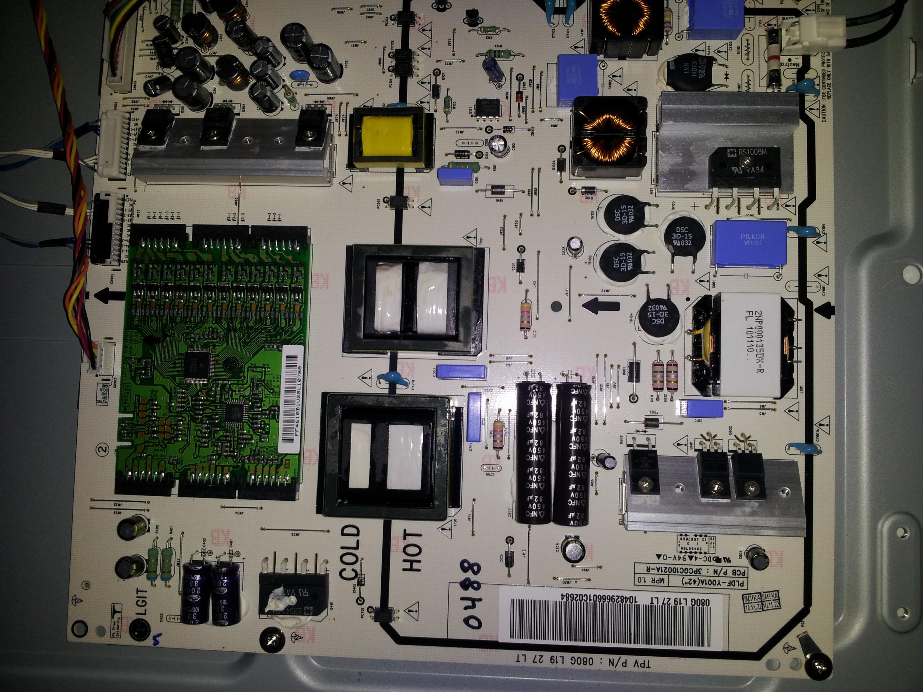

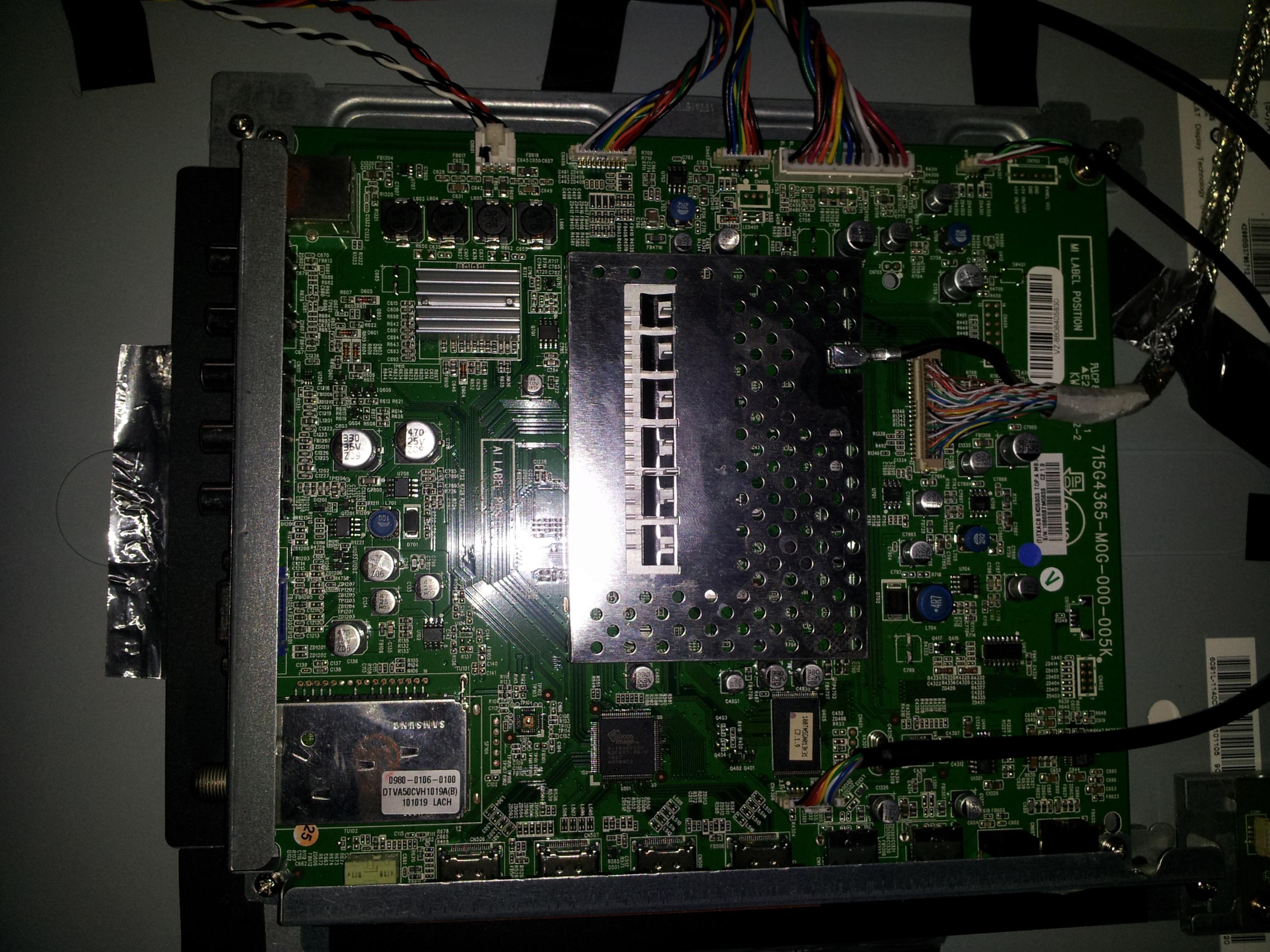

                          pictures of the inside,what was changed is the 5th pic,the panel in the middle
                            Is this a full LED TV? That board in pic #5 looks like the driver for it as well as the LCD T-con (perhaps a two in one function.)

                                Some TVs and the design is retro fitted and sold. Meaning they replace the CCFL and inverter with LED light bar and driver board.
                                Ain't that some shit.
                                Also pic 5, bottom LVDS cable, gold contact is exposed.
                                EDIT: NVM closer look it looks correctly seated.

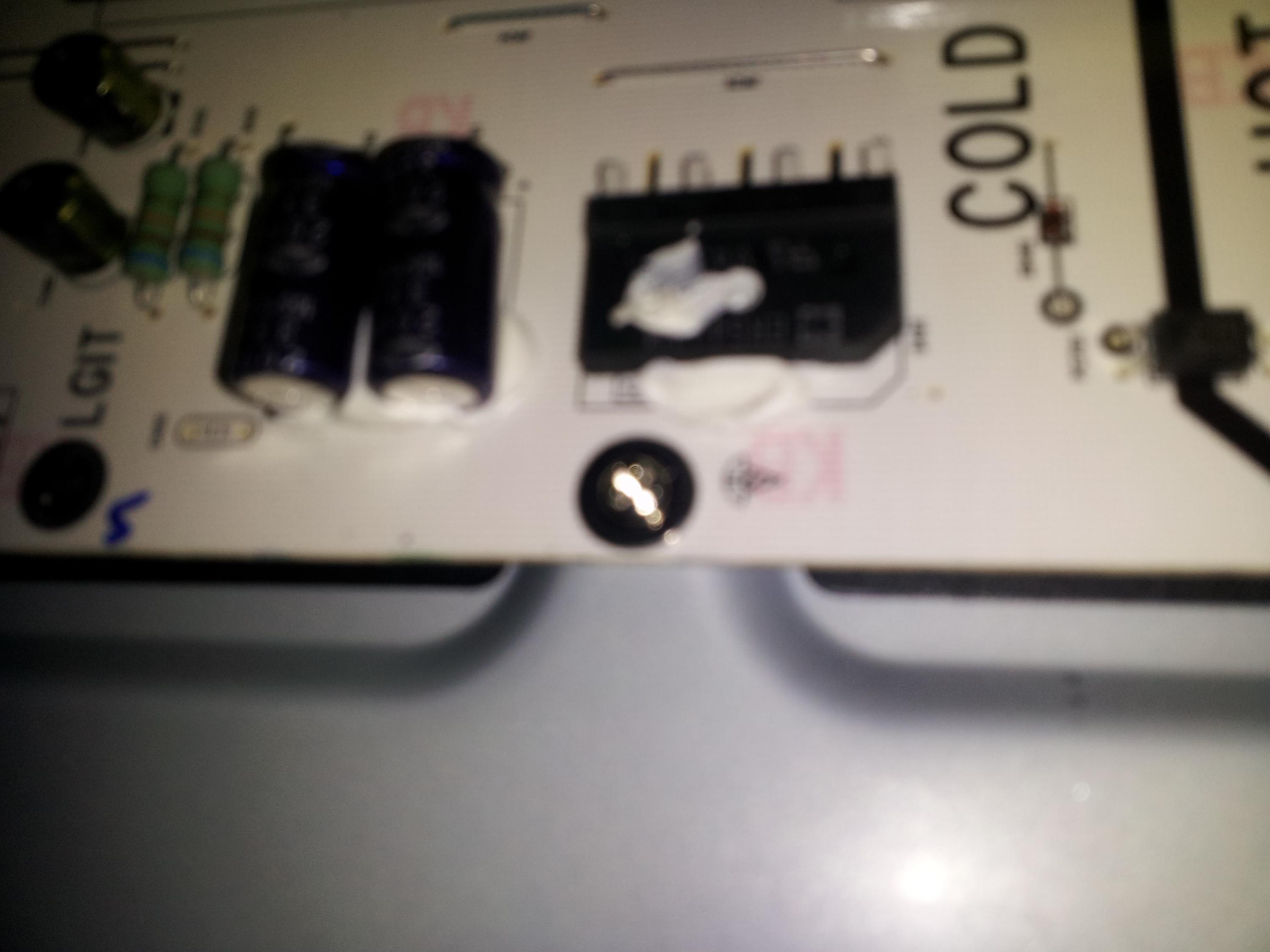

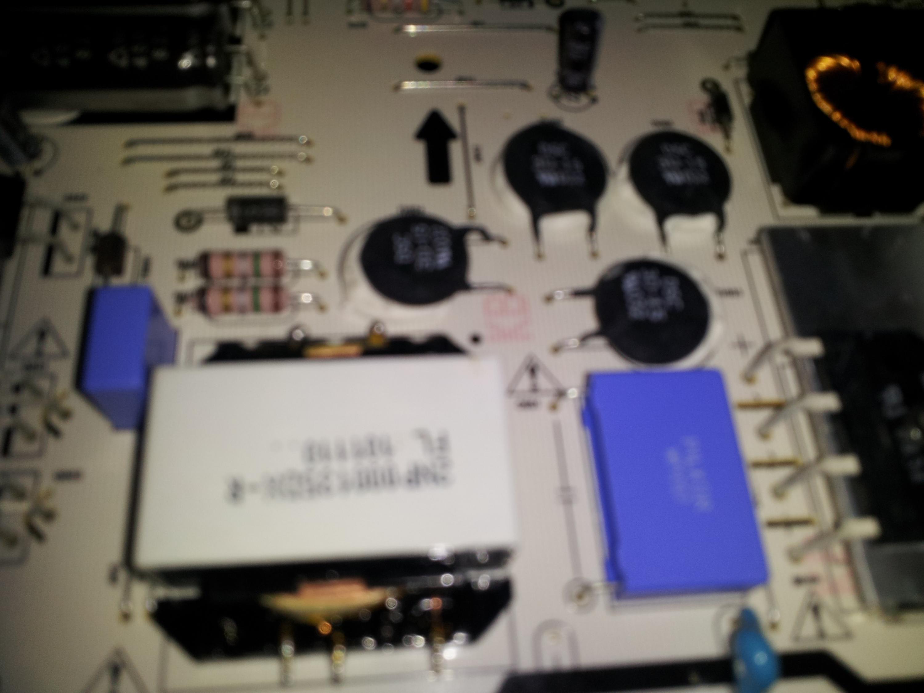

                                    was looking at pic 1,2 and 3 and it looks like some capacitors(hope am right) are busted on it,white stuff on the sides,
