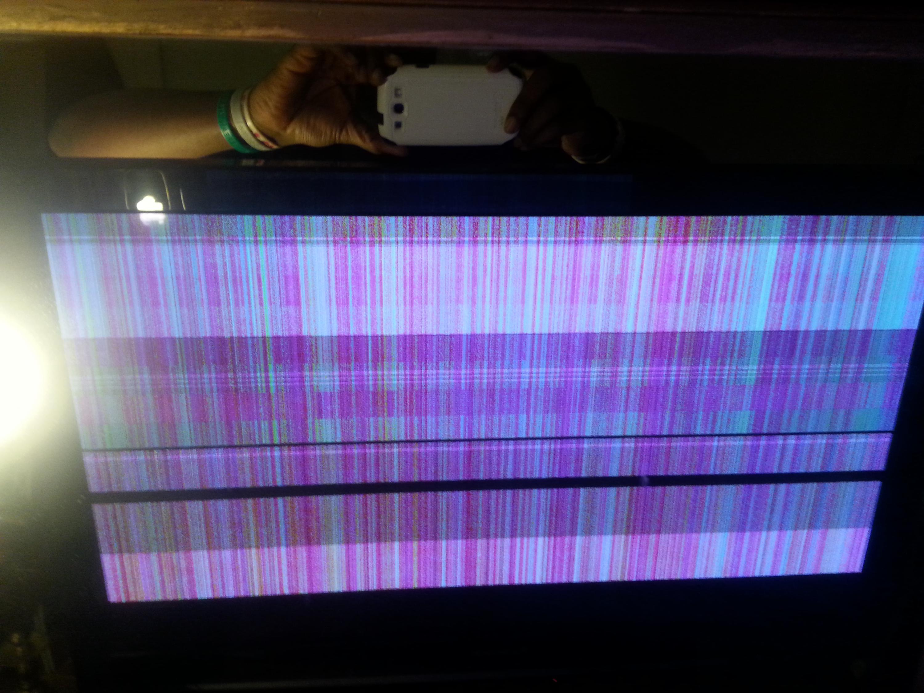

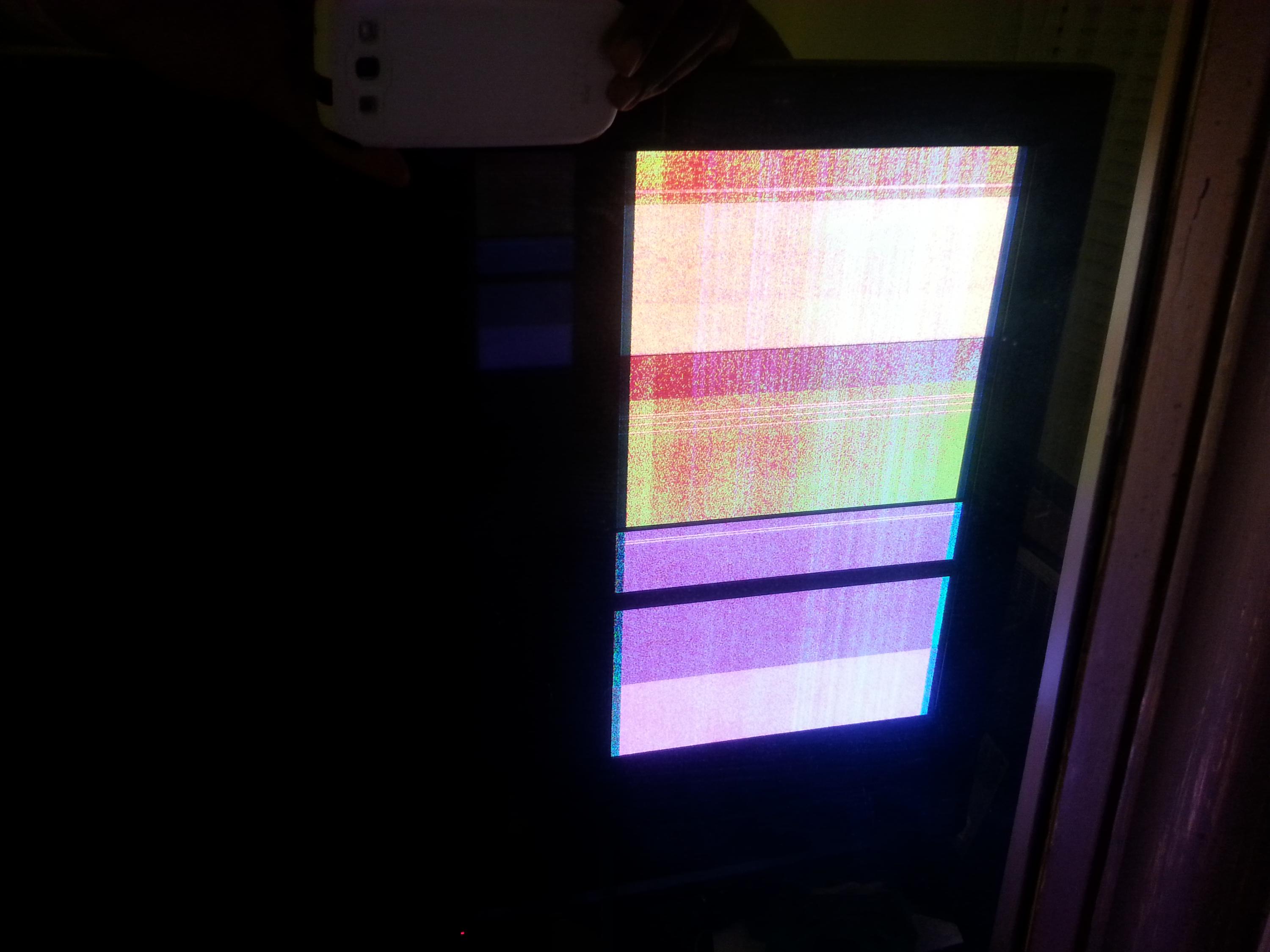

            Hey guys,
            New to badcaps so forgive me if there is another thread I should have posted in.
            I have a TCP42S1. It recently blew on me. SC board(loud pop and fizz). I eventually got a new board and fired the TV up and it looked like a glitched out NES game. I have attached the pics of what I'm talking about if it's not entirely clear.
            I figured it could also be bad SU/SD boards so I replaced those as well. Fired the TV up and it was the same. At the time, I was adjusting the panel ribbons to at least fix the horizontal black bars when the TV shut down and I now get a 10 Blink code when the SC board is connected. When I disconnect the SC board, I get the 6 code, so I'm assuming I blew my good SC board again.
            Anyway, i'm looking for any help I can get. If you have any ideas as to what's actually wrong before I dump more money into this thing, that would be great. Thanks.
              Re: panasonic tcp42s1 from 10 blinks to 7 blink
              The fault before it failed with 10 code looks like the -Vad voltage is bad so your new board was probably bad (this is fairly common with scrap pull boards, esp. from eBay, as they are untested.)
