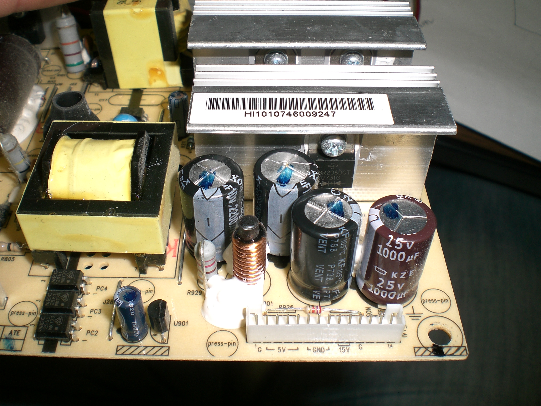

    I was given a 26" Visio that was found in the trash. No picture or standby LED when AC applied. Inspected the power supply and noticed two 2200uF caps that were buldging. Replaced them with some used ones I had lying around and fired it right up. Caps replaced were C902 and C903. 2000uF @ 10V and 105 deg.

    CapXons bulging? Those never fail!
    Also, I'm not certain but that Chemicon KZE looks fake to me! Font is totally wrong.
    What is the manufacture date of the TV?

      Re: Visio VW26LHDTV10F - No picture or sound
      My guess is 2007. The Capxon date code is P738 work year 2007, week 38.
        December 2007
