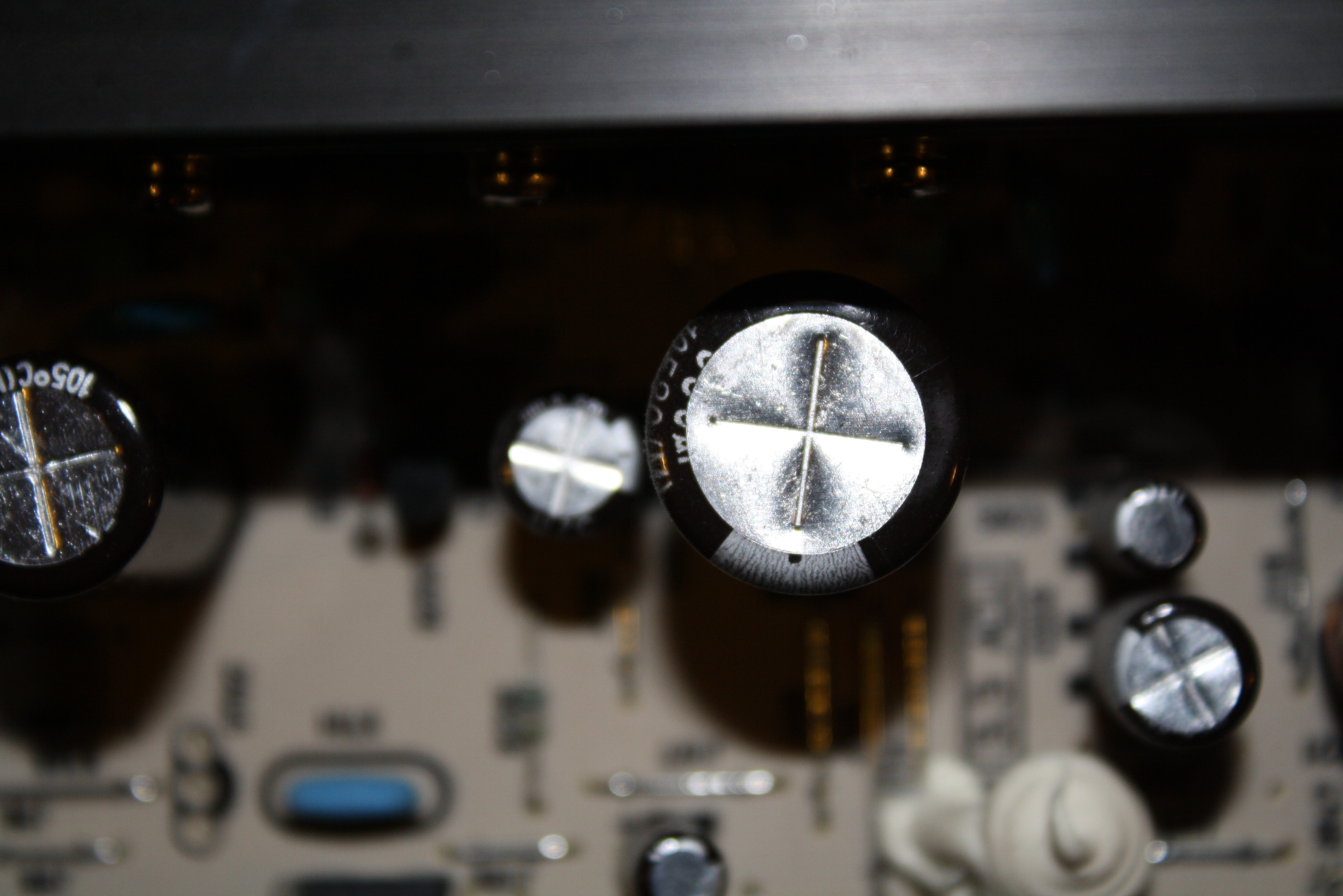

    Okay after staring at the thing for two hours, I may be going crazy, but I think I see a few caps starting to go bad. They are a pain to get a picture of, but is this one on its way out? The top isn't completly flat, but the thing isnt bursted yet. Let me know. Thanks!
      Re: LG 50PC3D shuts off... bad caps?
      Those caps are fine.

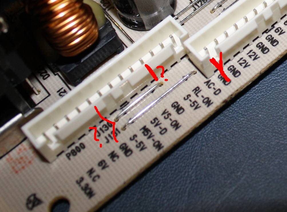

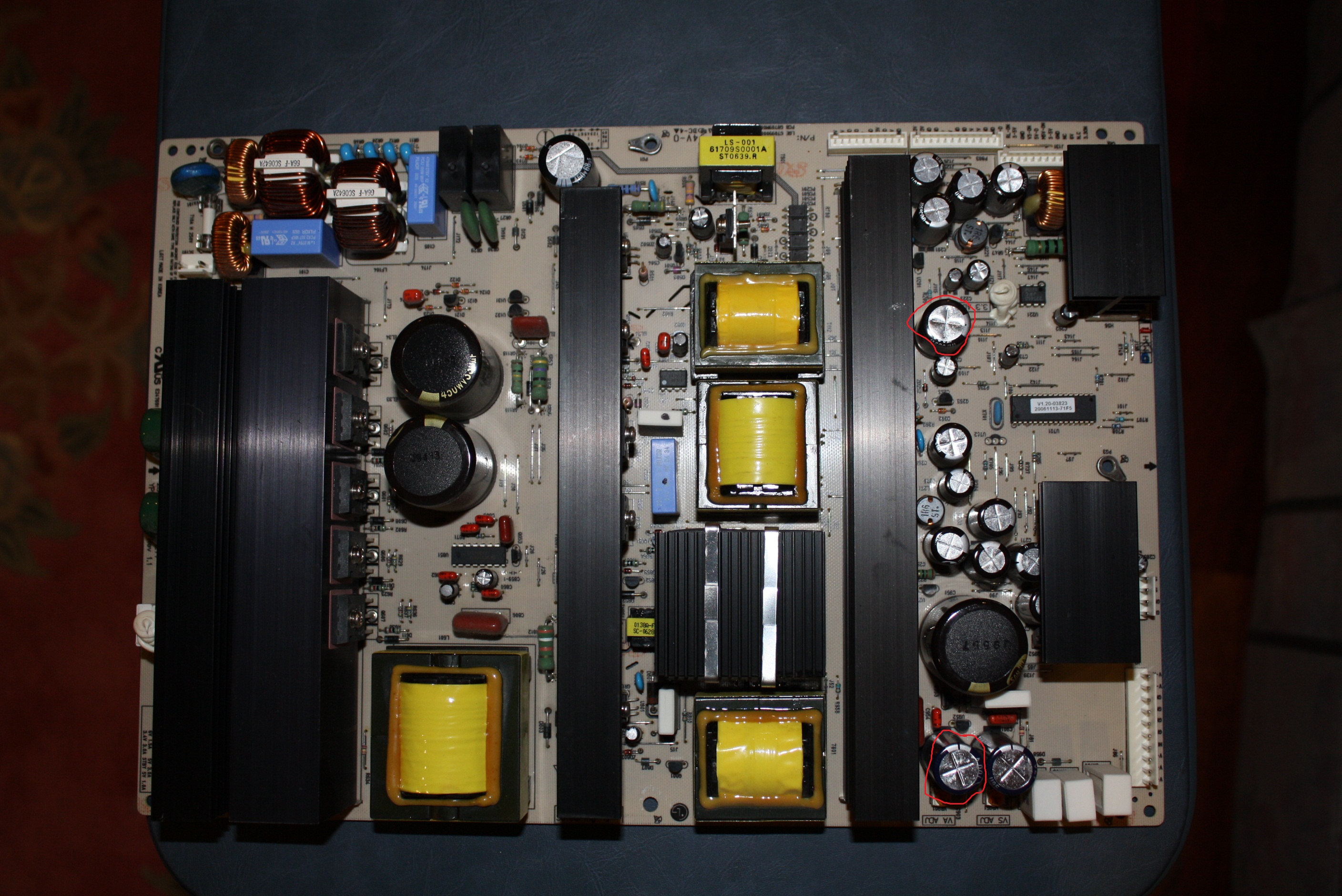

            Ah yes I do see pins for those voltages... top right of the board if you look at my picture of the board.

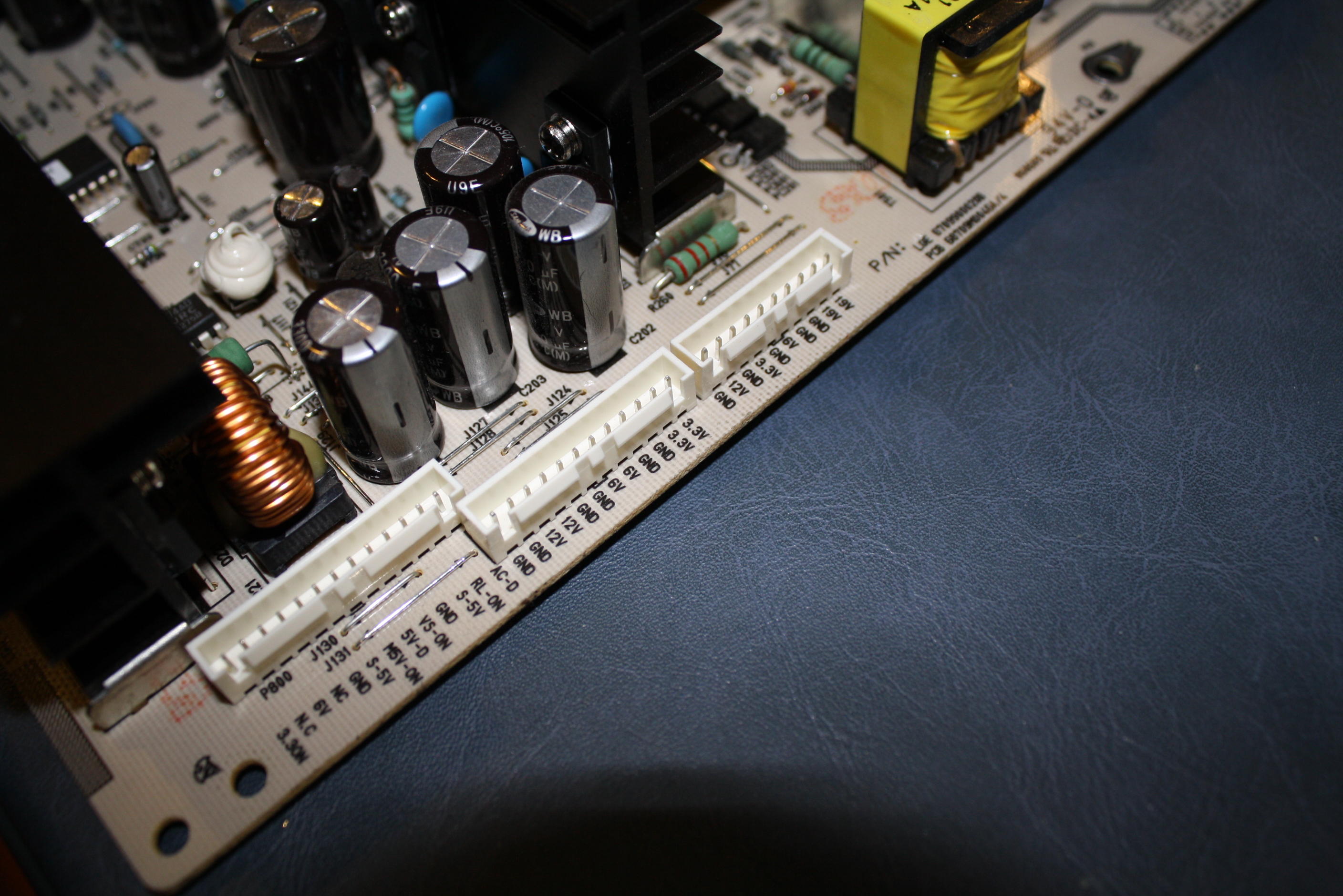

              Can you get a closer pic - can't quite see them.
                Here it is. Let me know if you need more pictures.
                  Ah - okay - on this one they call it AC-D for some reason.
                  You will need to install the PSU in the TV with all connectors connected as they should be. Then, plug it in and check the AC-D pin with your meter. If it goes low when the picture goes out, this is your problem.
