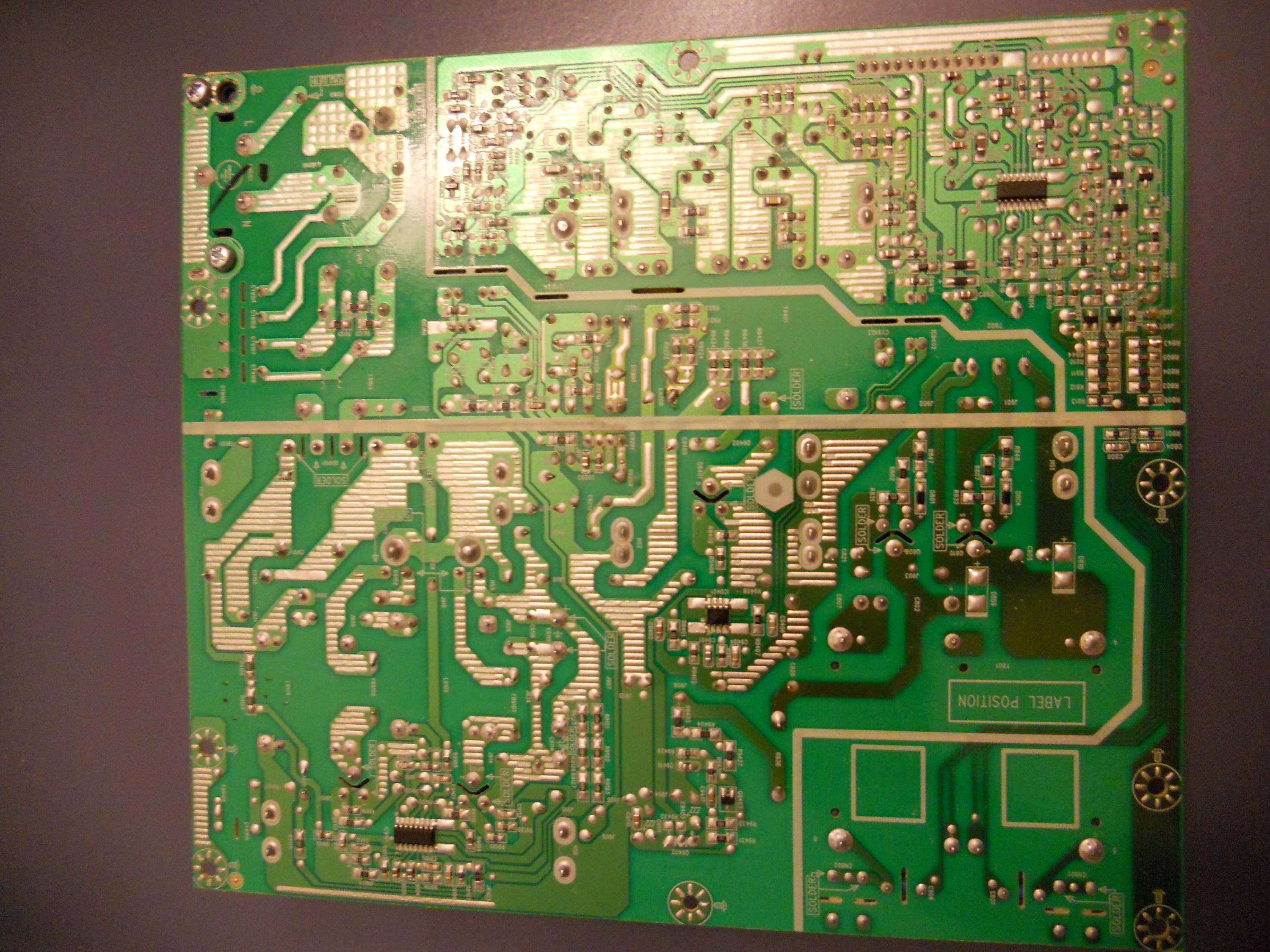

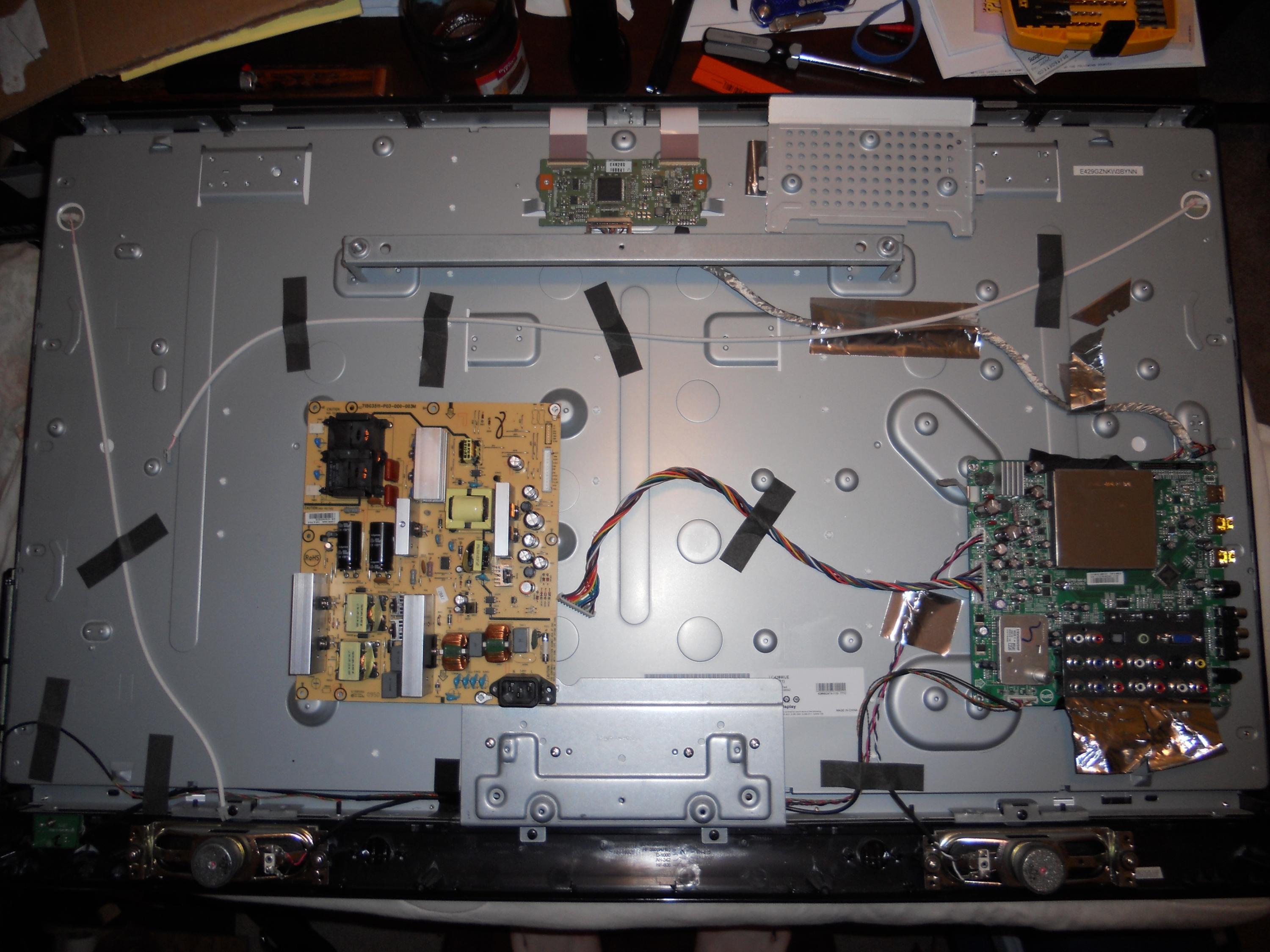

    Like wiatery, I too have an Insignia NS-L42Q-10A that has no indication of power (other than a blue LED on the inside of the TV behind the back panel). The Red/Blue LED on the front does not come on when there is power.
    I followed the troubleshooting steps provided by tom66 and these are the measurements I was able to get.
    The fuse measured .5 ohms.
    The NTC thermistor (the green one next to the fuse) measures at 4.1 ohms.
    The AC Bridge on the back of the board measures 125.7 VAC.
    The DC Bridge measures 167.9 VDC.
    Now I tried measuring the volts of the big Rubycon capacitors, but I must not have done something right because I couldn't get anything near 6V to register on my multimeter.
    I was also able to measure continuity of the big Rubycon capacitors, but only on the negative leads. Again, perhaps I did something wrong.
    Any help would be greatly appreciated. Thank you!

              Can you do the test on the BIG caps again - you may need a helper or
              aligator clips as retired caps suggested as I wany you to do the test as
              you press the power button - I think it should jump the voltage up.
              Care as high voltage.
              Next with it all connected up and on check the voltages on the long connector
              on the right hand side of the board (in your picture.)
              Meter on 200v DC or autorangingDC Black probe on ground screw red probe on each pin in turn. ( Sometimes difficult to squeeze in don the side of the wire or some connectors you can see the pins in the side.

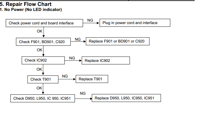

                    It's a different service manual... just sent the correct one for your set (NS-L42Q-10A) to tom66... I'm sure it'll be on his site when he has a chance
                    While you're waiting to upload, attached is a snapshot of the flow chart for a "no power" scenario. The LED indicator referenced is the light on the front of the TV... not on the actual board itself

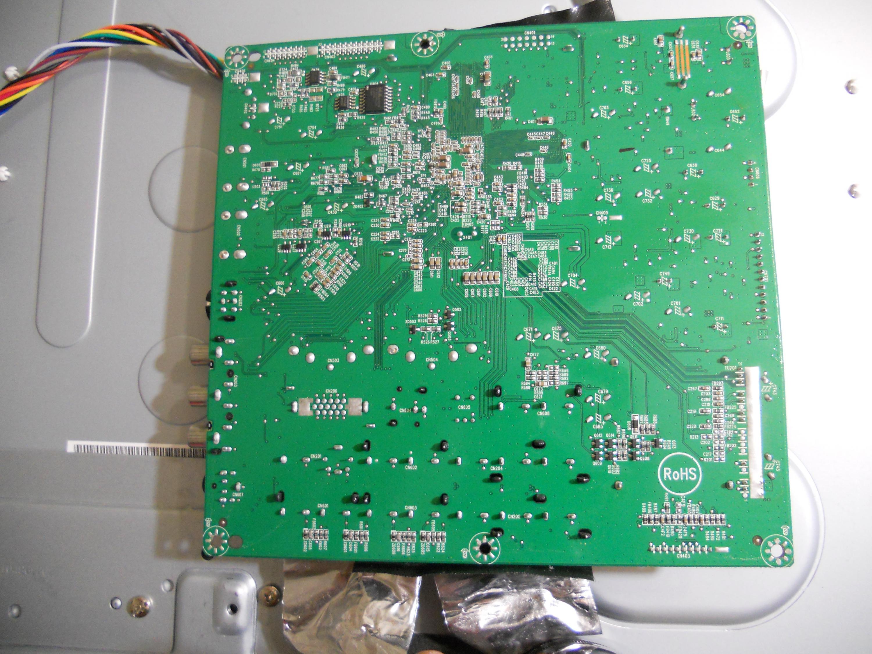

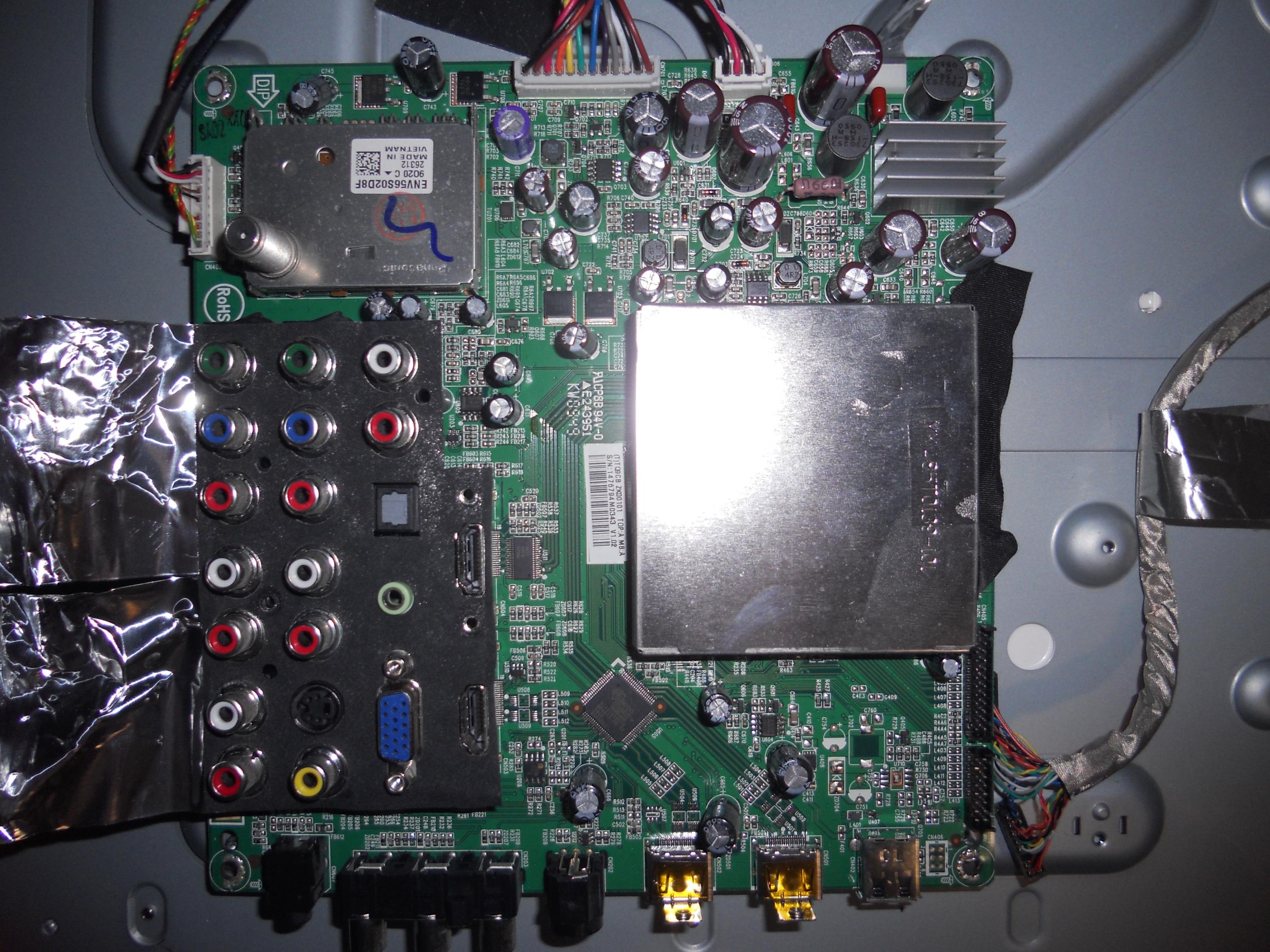

                      Just what I was thinking - Can you post a picture of your main?signals board front and back and a general view in the back of the set and any
                      other boards in there.
                      • SalemHermit
                        • Aug 2012
                        • 11
                        Re: Insignia 42" NS-L42Q-10A No Power/No Red/Blue LED

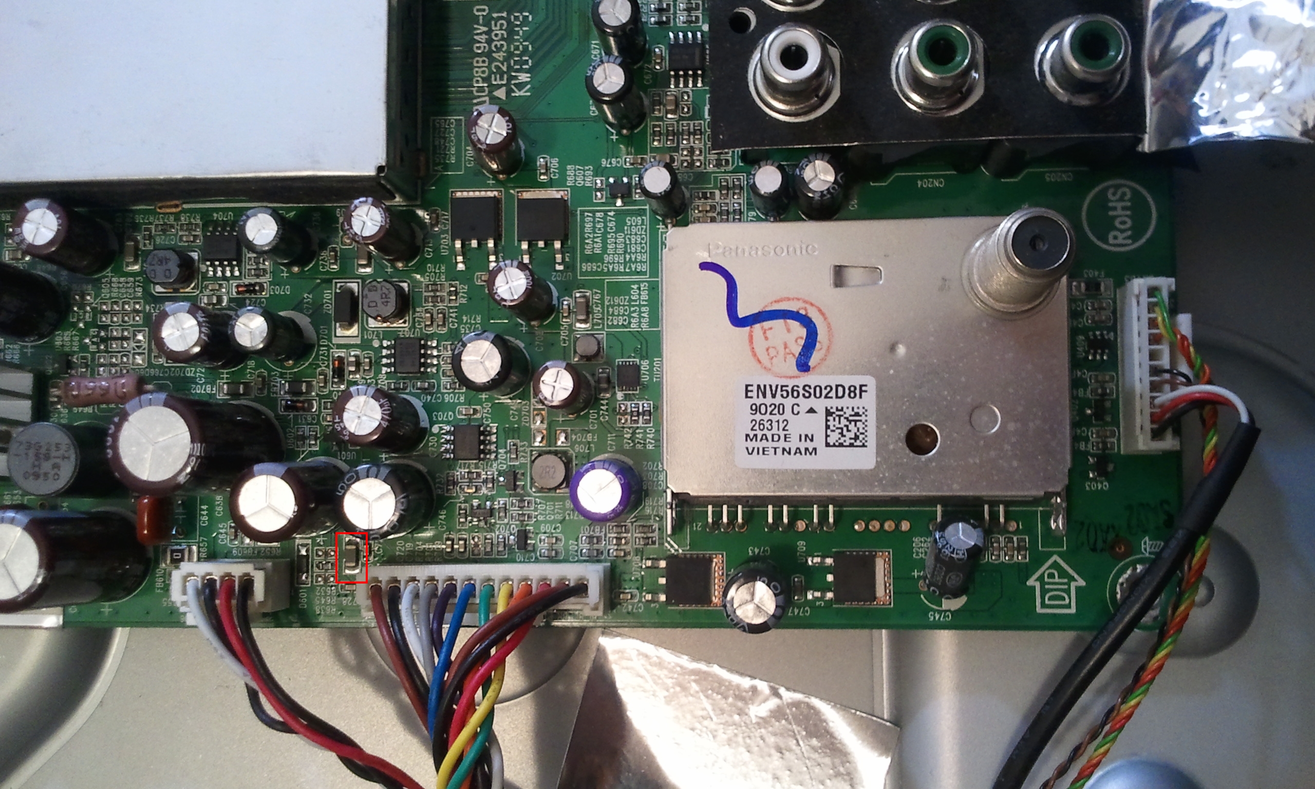

                        Here you go. Hopefully this helps. I assume by main/signals board you meant the AV board?
                          The PS_ON is working, the PFC is working. Is there a label 'BL_ON' on the power supply/Inverter board combo?

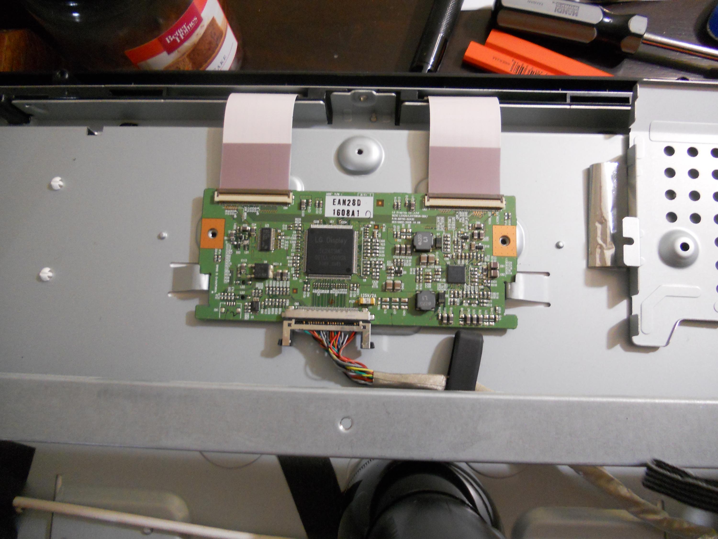

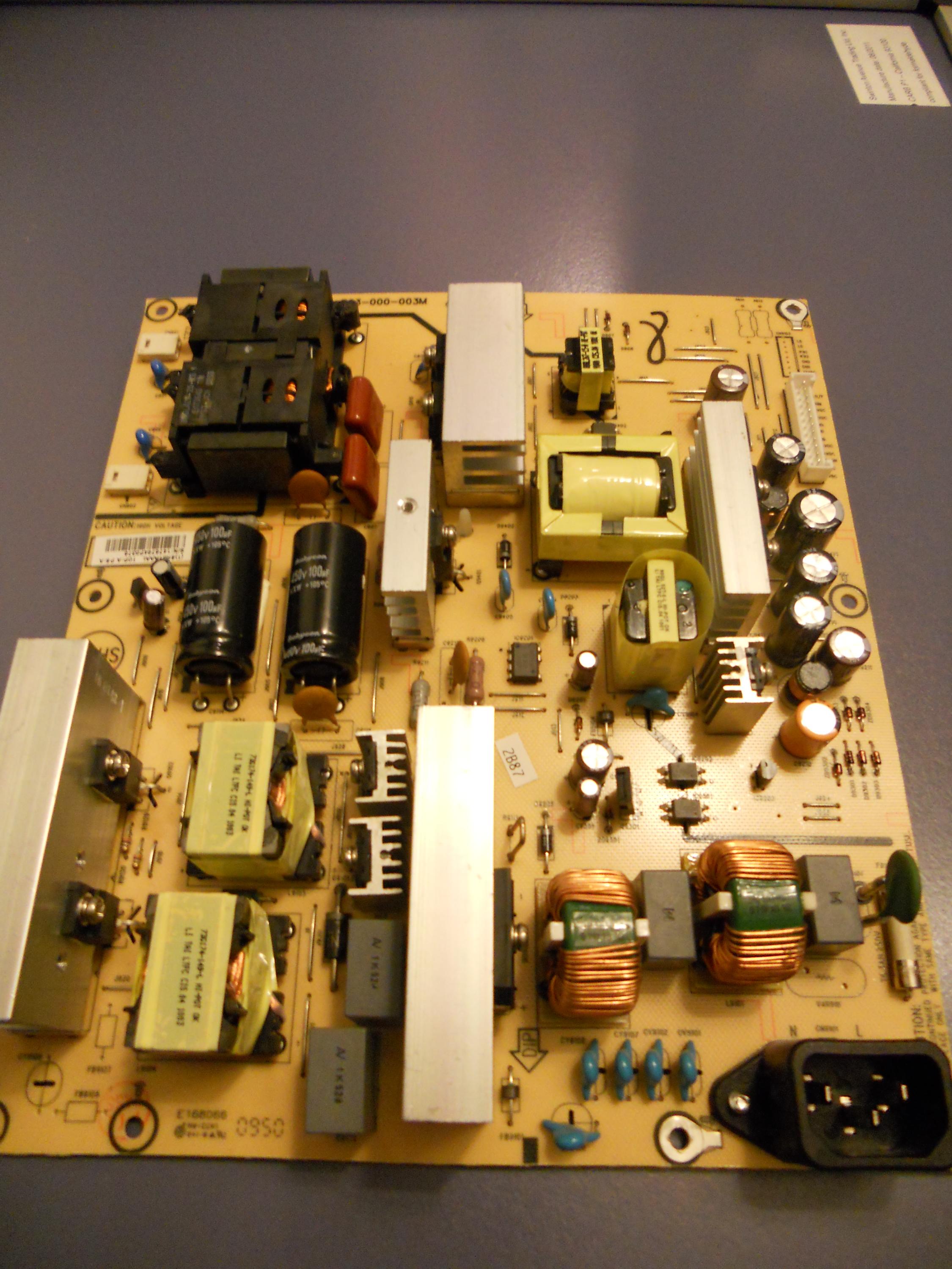

                            OK in pic 3 there is a white fuse on the board just above the bottom connector.
                            Can you check it - meter on ohms - probe on each end should read the same as touching the probes together. Also can you check the voltage at each side of the fuse.
                            Next on the AV board there look to be 4 voltage regulators U 702 702 708 709
                            can you list the part numbers.
                            If they are voltage regulators you can test them:
                            Voltage regulators (U designation) can be bad. They can be shorted or output the incorrect voltage. The test described below only tests the former.
                            If you have a manual range multimeter, set it to 200 ohms (two hundred). You can test voltage regulators "in circuit" for shorts by (power off and unplugged)
                            a) black on pin 1- red on pin 2 - record ohms
                            b) black on pin 1- red on pin 3 - record ohms
                            c) black on pin 2- red on pin 3 - record ohms
                            If any ohm reading is less than 30 ohm you might have shorted voltage regulator. Remove from circuit and repeat the tests to verify.

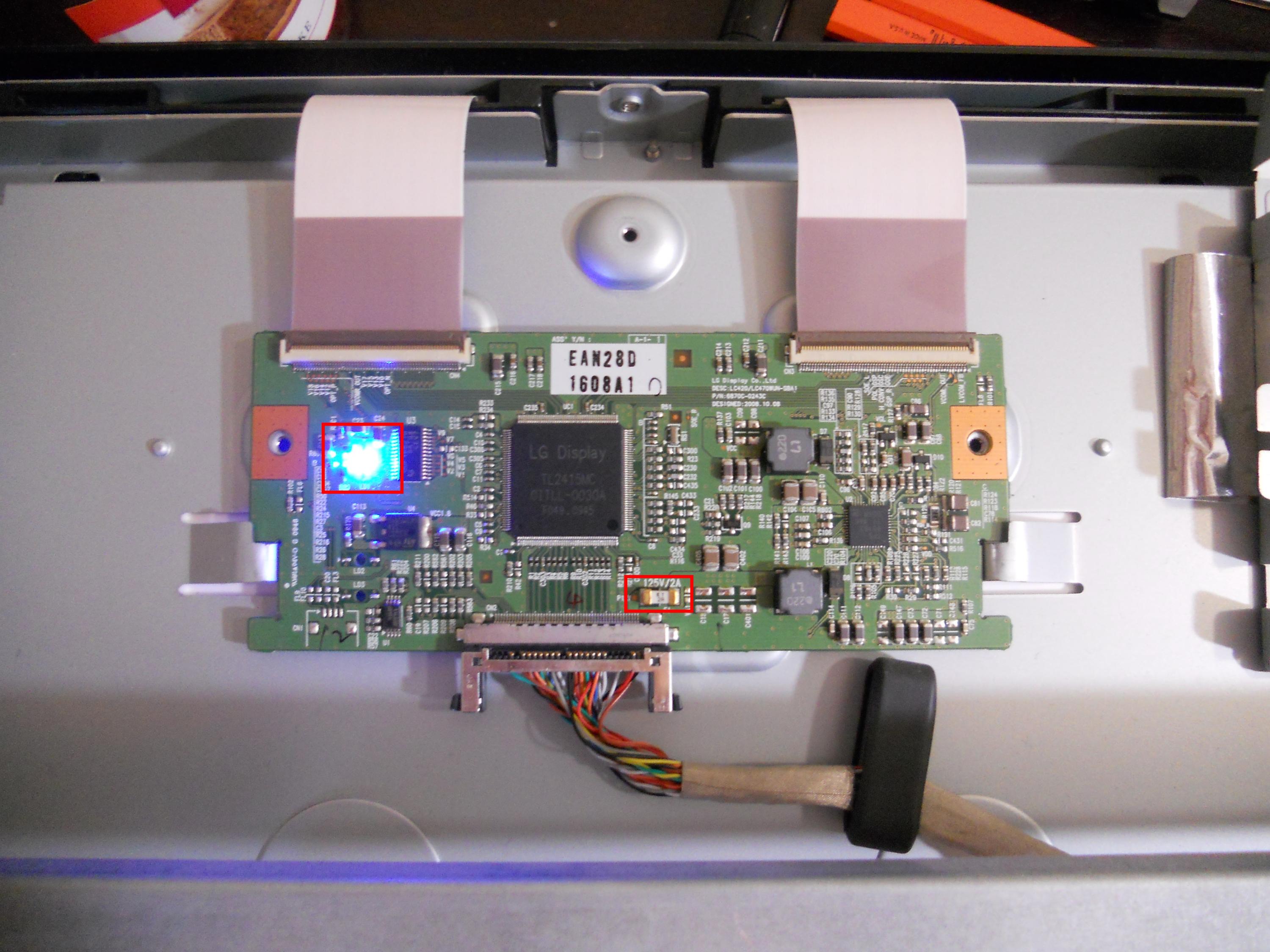

                              The fuse in the 3rd pic (I have highlighted it in the attached image) measured at .5 ohms, which is what I got when touching the probes together on my multimeter. Also, The blue LED that is highlighted in my attached image fades after approx. 25 seconds and is gone. I'm not sure what the purpose of this board is, and if that is how the LED is supposed to work.
                              Unfortunately, I don't have a manual range multimeter. I have a Craftsman 82139. Is there any other way to test the voltage regulators?
                              Here are the part numbers for the voltage regulators.
                              U702 1084-18PE 955E7R
                              U703 L401 G1084-33
                              U708 L331 G9084
                              U709 AZ1117D 50E1 943J74
                              U709 might also be AZ11170 50E1 943J74, I can't be sure. It was really hard to read it.

                                      The fuse I have highlighted measures .5 ohms and 1.1 m V with power. I had the multimeter on DC and left it on auto tune. Just doesn't seem right to me.
                                      • selldoor
                                        Slow Learner
                                        • Dec 2010
                                        • 7870
                                        Ha ha Ha two wrongs dont make a right.
                                        1 That is not a fuse
                                        2 I told you the wrong board - I meant the Tcon
                                        Can we try that again - Its a white fuse F1 125/2A.
                                        Also - just to the left of your "fuse" there is a 4 wire connector and just to the left of that is a
                                        black resistor with a 0 zero on it - can you check that for continuity as you would a fuse.
