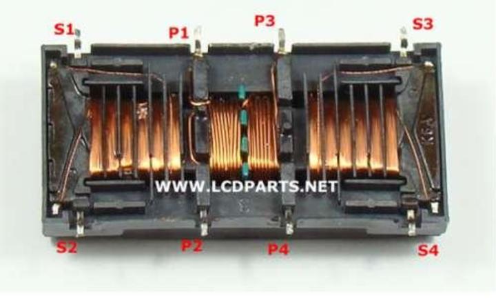

Hi pictures would always help?, if it has "normal" darfon transformers you can test them on board - meter on 2000 ohms S1>S2 and S3>S4
Post results as
T1 S1>S2 =XXXOhms S3>S4 = XXXOhms
T2 S1>S2 = and so on.

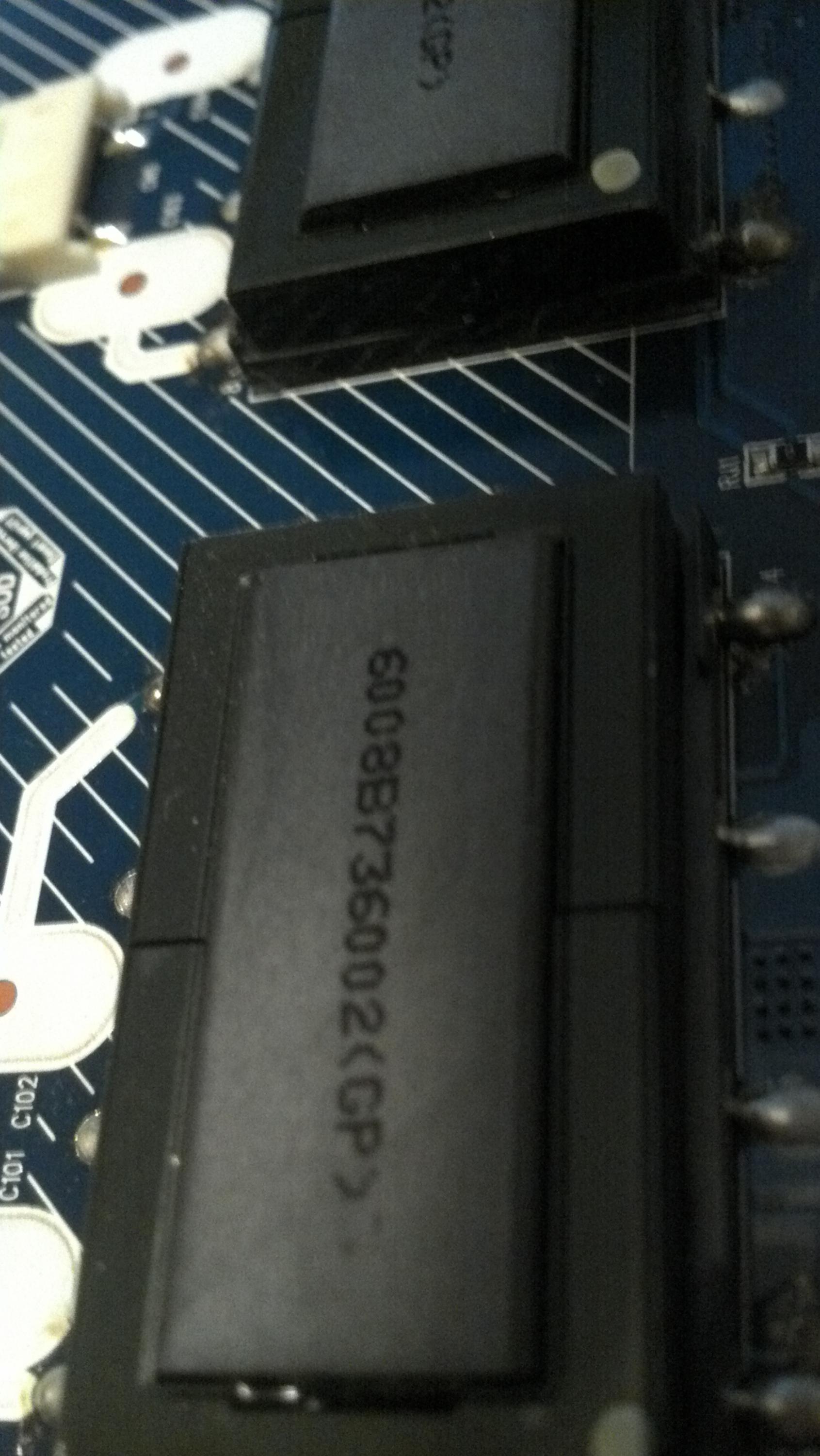

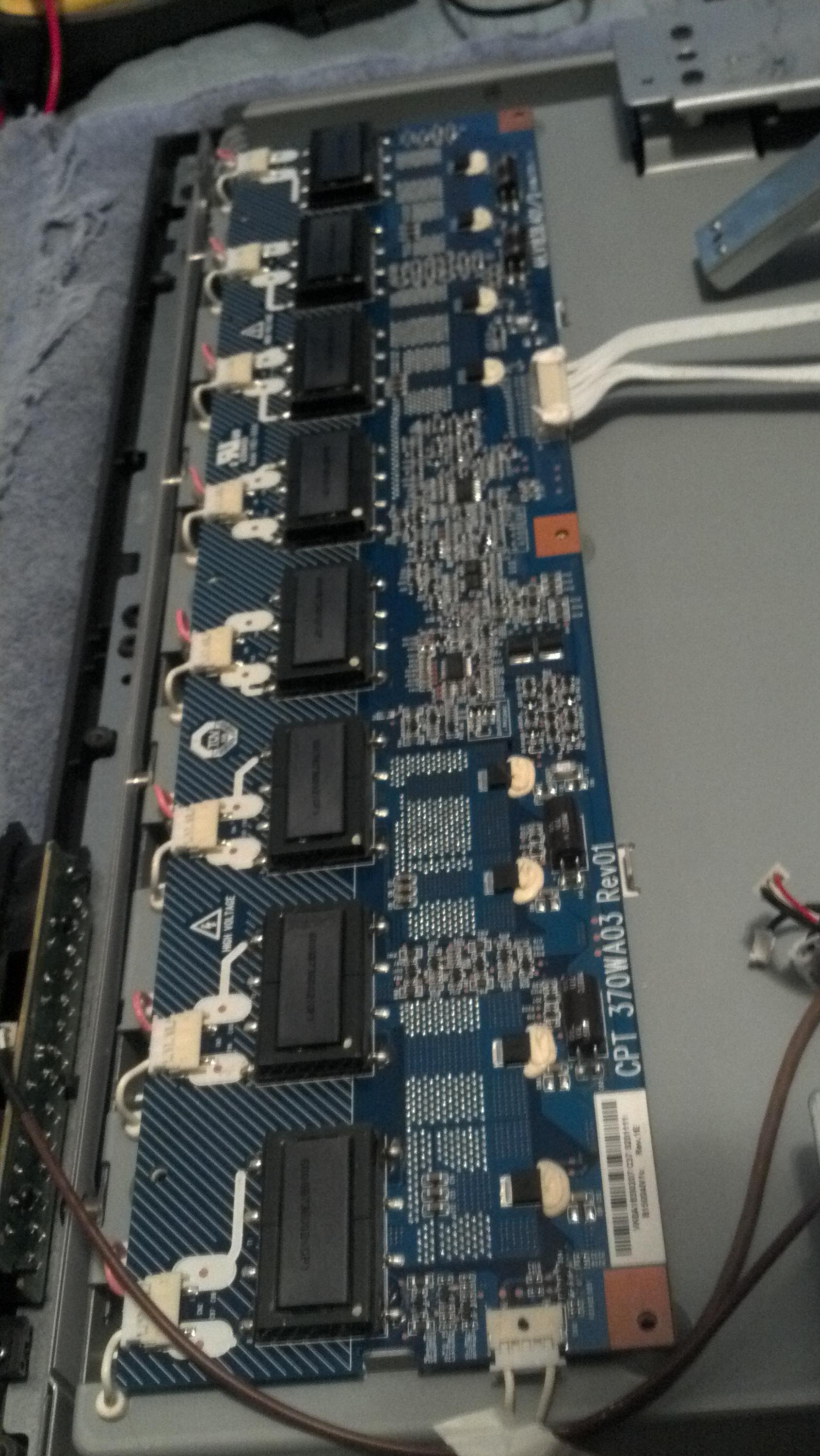

Can you post a picture of the inverter board?
It's half burried under the mainboard. Once you get a picture of it post the numbers on the top of the transformer. I ordered my transformer from ebay since it was only $7 and a used board was in the $40 range but it depends on which board you have. There are i think 3 different inverter boards used in this tv.

Hi Just been looking at transformers - if you click on buy it on the lcdparts it gives info
(does not mean you have bought it) Sec winding is over 2kohms to you will need your meter on higher 4K? 20K? ohms or autoranging if you have it.when you do the test.
http://www.ebay.com/itm/6008B-Invert...item25739de922
http://lcdparts.net/TransformerDetai...ProductID=3269

results
T1 S1>S2 =2.2k Ohms S3>S4 = 0k Ohms
T2 S1>S2 =2.2k Ohms S3>S4 = 2.2k Ohms
T3 S1>S2 =2.2k Ohms S3>S4 = 2.1k Ohms
T4 S1>S2 =2.2k Ohms S3>S4 = 2.2k Ohms
T5 S1>S2 =2.2k Ohms S3>S4 = 2.1k Ohms
T6 S1>S2 =2.2k Ohms S3>S4 = 2.2k Ohms
T7 S1>S2 =2.1k Ohms S3>S4 = 2.1k Ohms
T8 S1>S2 =2.2k Ohms S3>S4 = 2.2k Ohms
Looks like I just have one that is bad T1 has an open winding.
