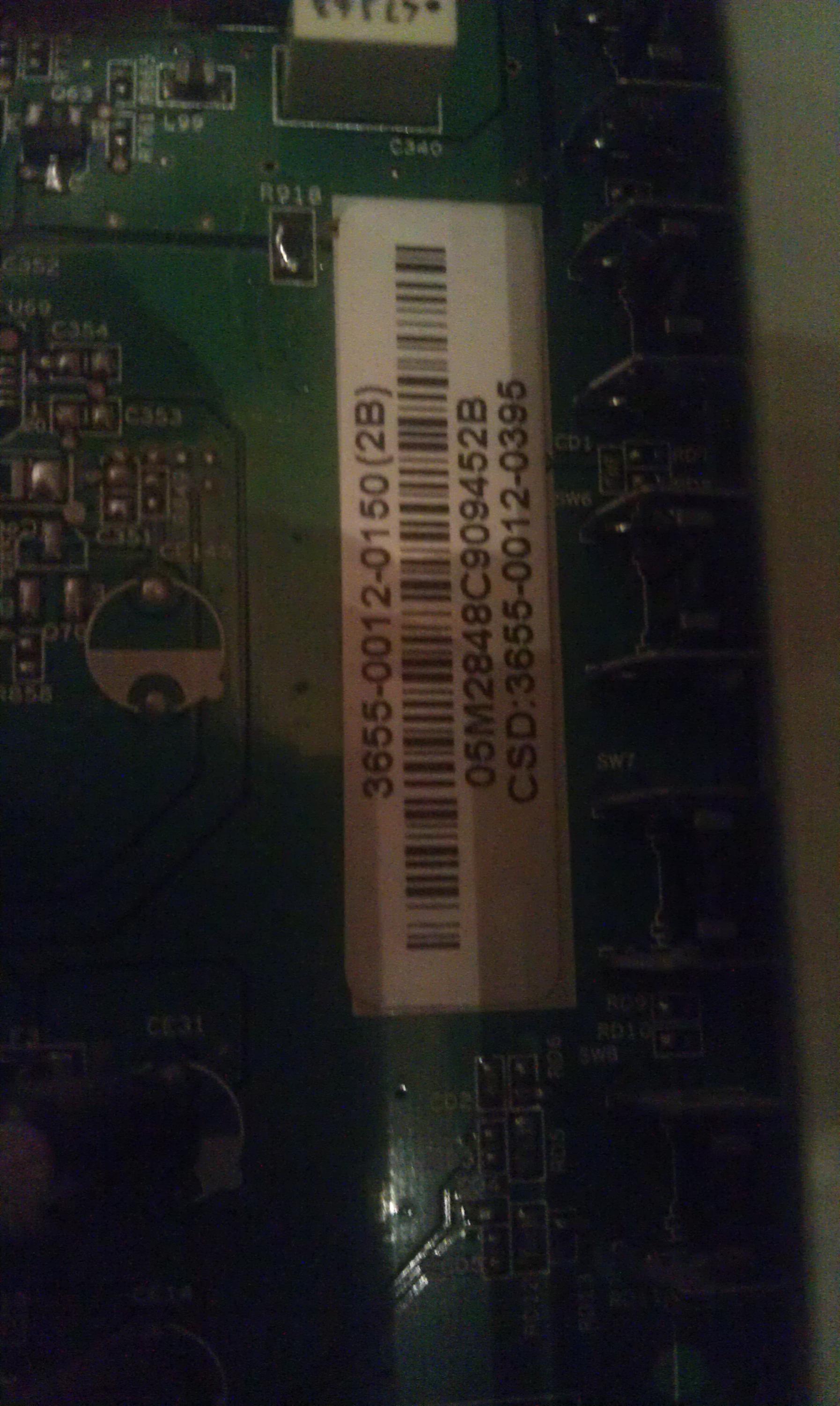

    I have a Vizio VF550XVT1A - Had a pretty good lighting storm today TV was on and power cycled very quickly, "VIZIO" flickers continually, unplugged for 10 min. no help. everything i have read online says the main board needs to be replaced - main board 3655-0012-0150(2B)
    I am good with a soldering iron but only have multi-meter. I am willing to replace the board but would like to be certain it is the problem. 5V to main board is good.

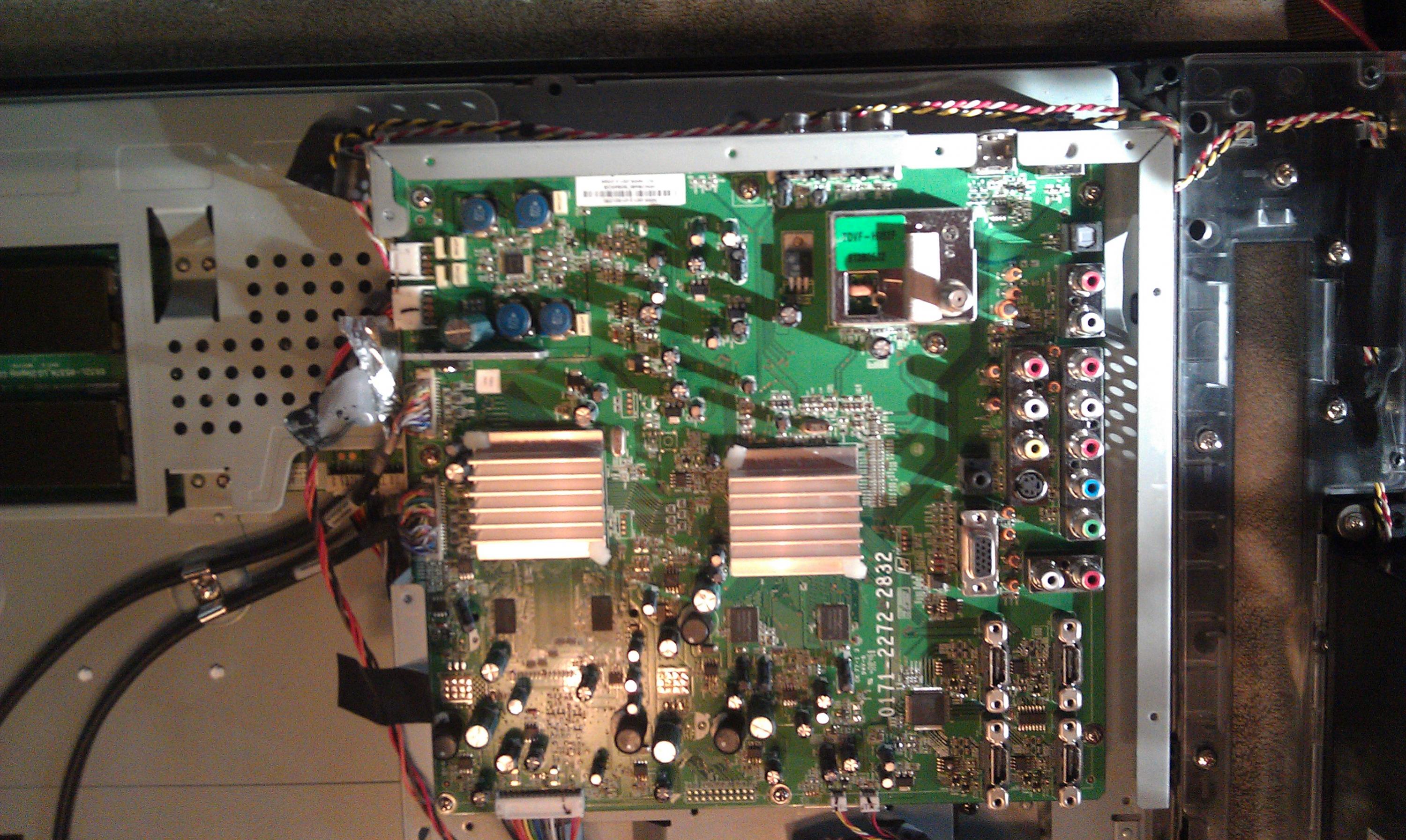

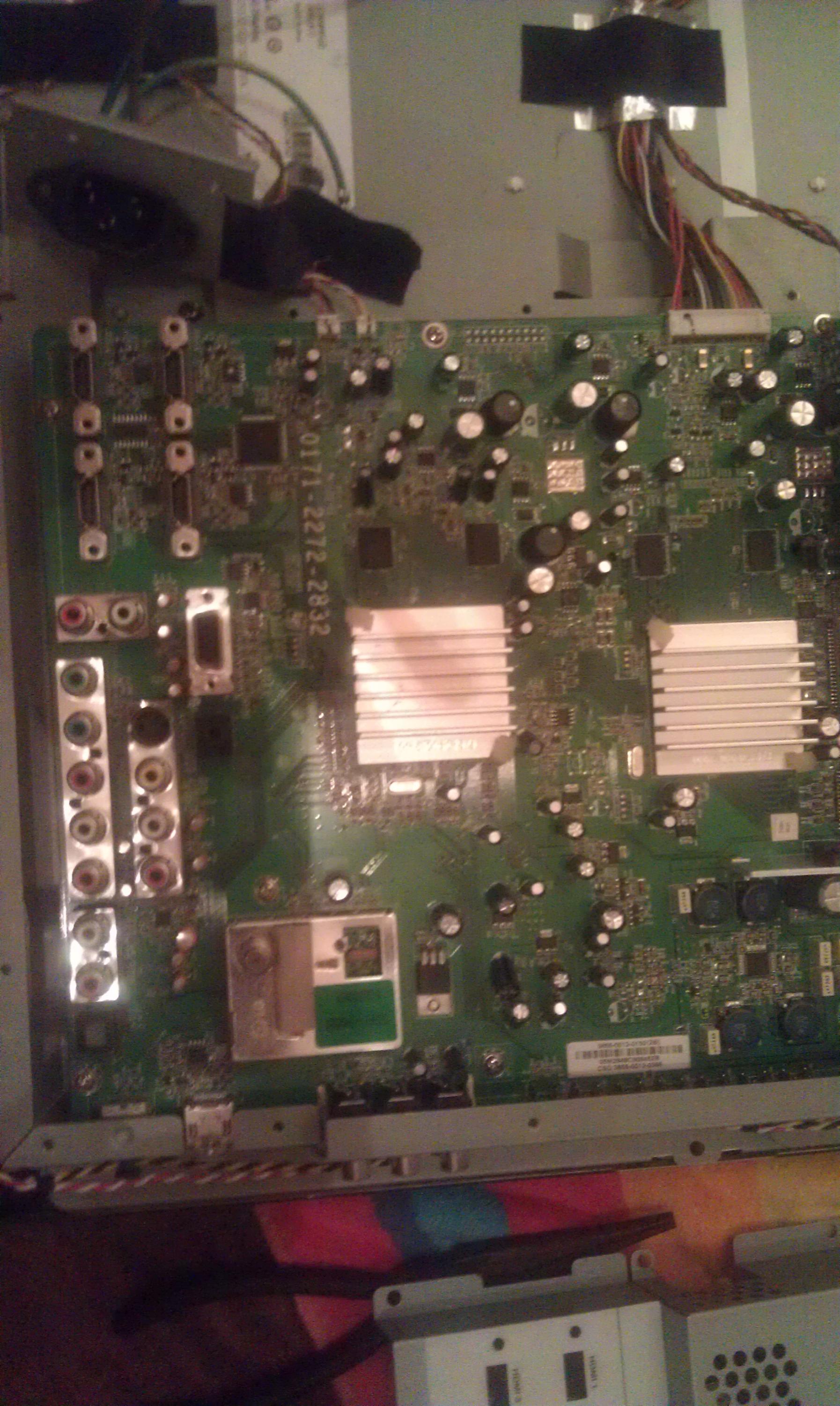

          here are some pics of the main board
            Re: vizio vf55 power surge
            There are two fuses near the power connector. With the metal caps on the end. Check if they are okay.

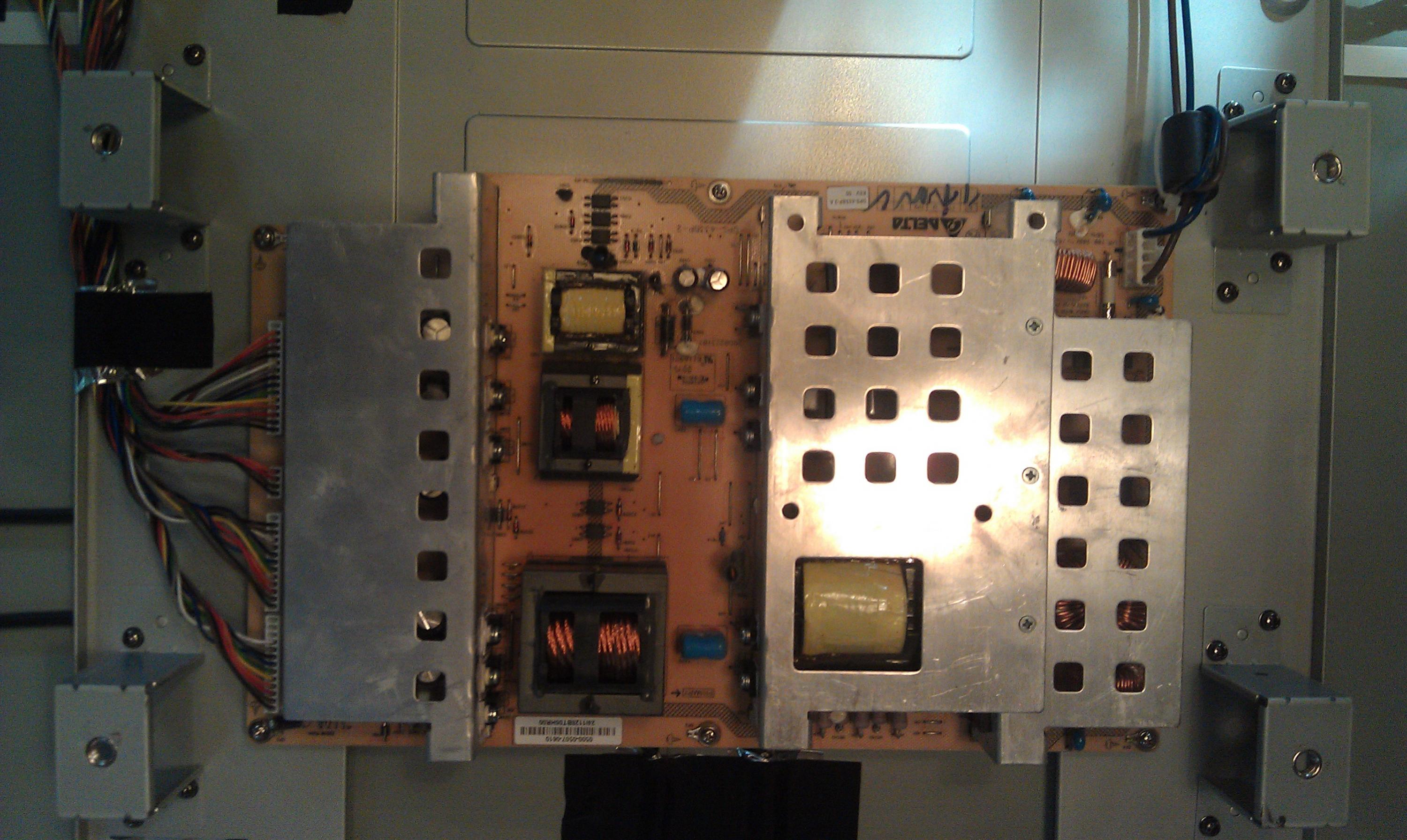

                  found 1 fuse near pwr connector it is good, here is pic of the power board and another of the main board
                        1 is 5vdc the other is less than .1vdc. s/b 24vdc correct?
                          So you have your problem here, 5V standby is up (hence Vizio logo working), but 12V is dead. Probably 24V too. Is there a pin marked PSON on power supply?
