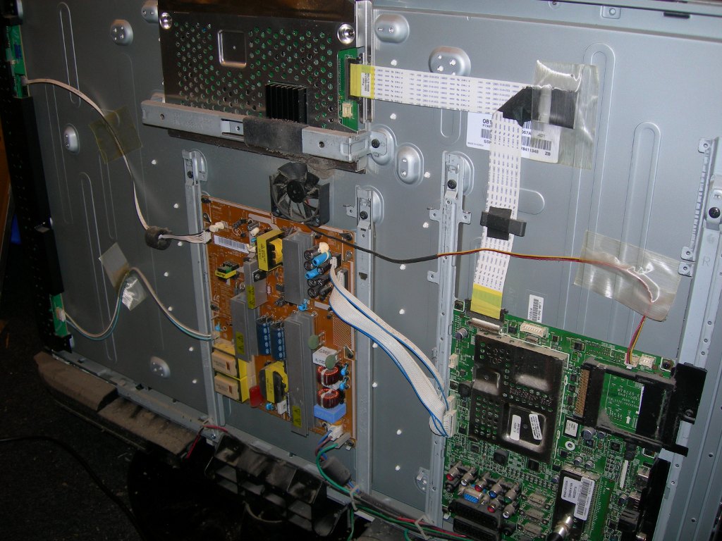

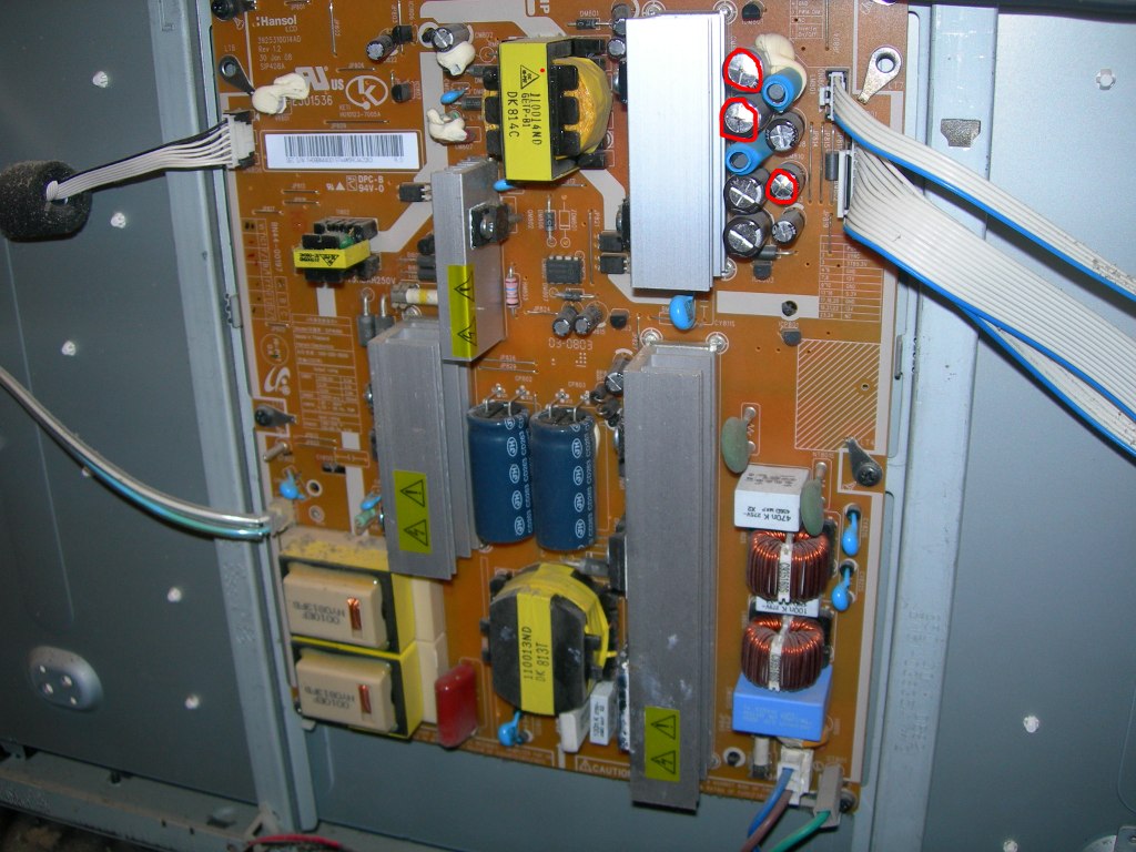

    Got this TV for £40. I've already repaired the same model but with a different fault - it had a T-con issue.
    Fault: Power LED blinks intermittently. No sign of powering up.
    Anyway upon opening it, the problem was very apparent. It has at least three bad caps.
    I will replace them all - and consider keeping this TV for ourselves and replacing our old 42" 720p (dumpster find too. ) This is 40" (so a tiny bit smaller) but 1080p and with 100Hz motion interpolation, 4 HDMI and USB.
    Heating the caps with the hair dryer for 3 minutes made the TV power up with a perfect picture.
    Would you believe what Currys (crappy electronics retailer in the UK) said it was? A starter motor!!!! I kid you not!!
    Video will be up soon on diagnosis.

    those inverter transformers look like, LIF42-001 SC-03B's ?,very simular to the power supply used in lg lcd tv's, EAX55357701 ?.dont like the way the ccfls are wired as a block with those transformers.
    makes it hard to troubleshoot 2 secs to black(swapping individual ccfls).

                                  New caps in. Fixed.
                                  Video soon...
                                    Re: Samsung LE40A656 - Power LED blinking
                                    Video: http://www.youtube.com/watch?v=CjrrZ...ature=youtu.be
