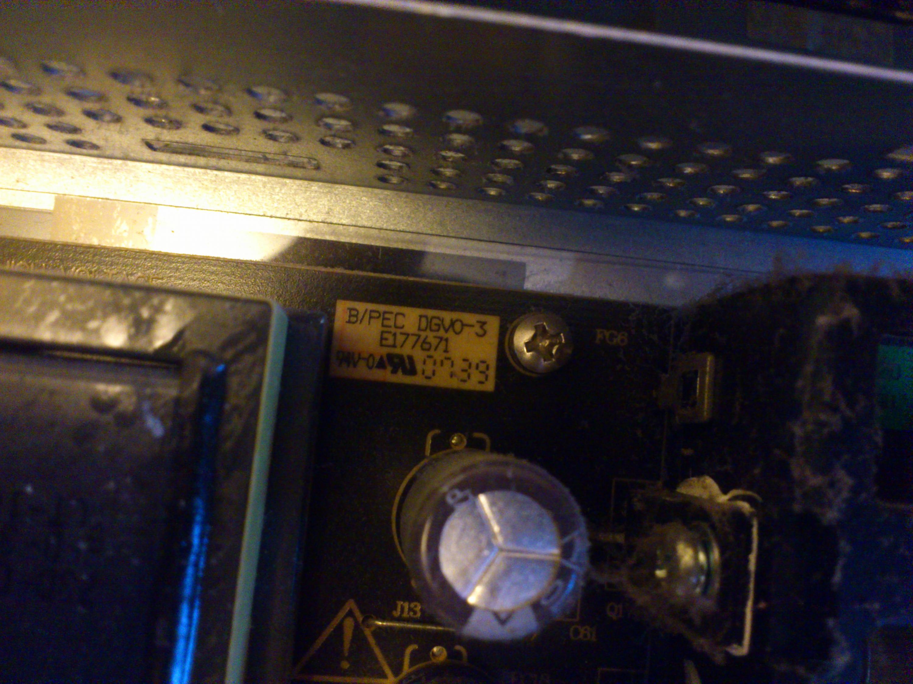

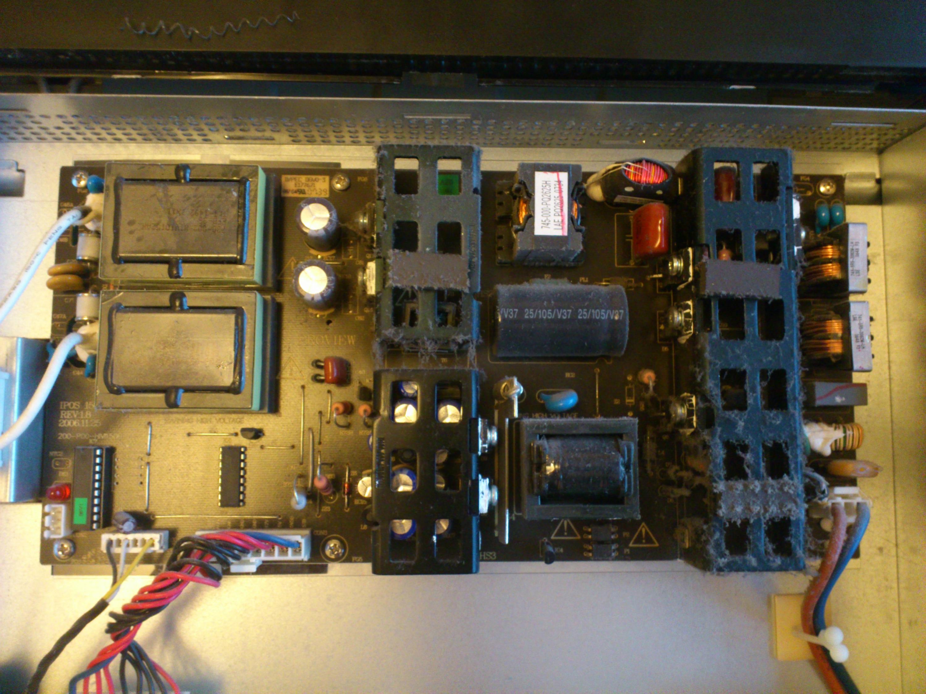

    hi all, just picked this tv up and ive not managed to get the fault, however the picture and the sound cut out for about a second every now and then, not often enough to check the voltages for faults
    all voltages are stable and correct
    is there any parts that i should just swop anyway, like on the vestel them dodgy poly red caps?

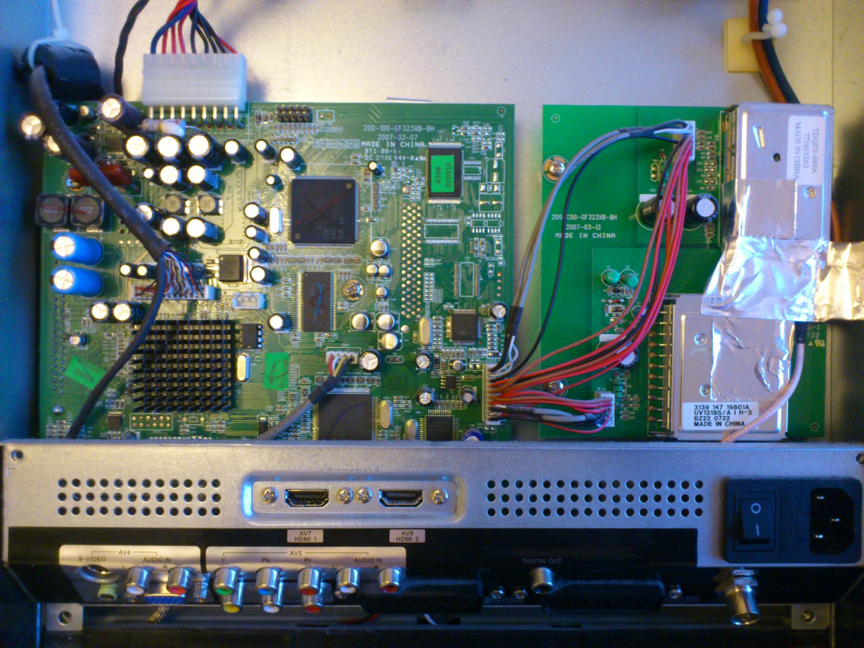

    Check the LPT connector on the main board - big one looks like an oversized parallel port - check it is seated properly.

      It has a severe case of dust? - a good clean will help it run fractionally cooler.
      There is a current thread on a polaroid which looks to have the same PS. perhaps you could look in on it.

        ye ive cleaned it out, and ive reseated all the connectors, its still on since earlier so still no shut down!
